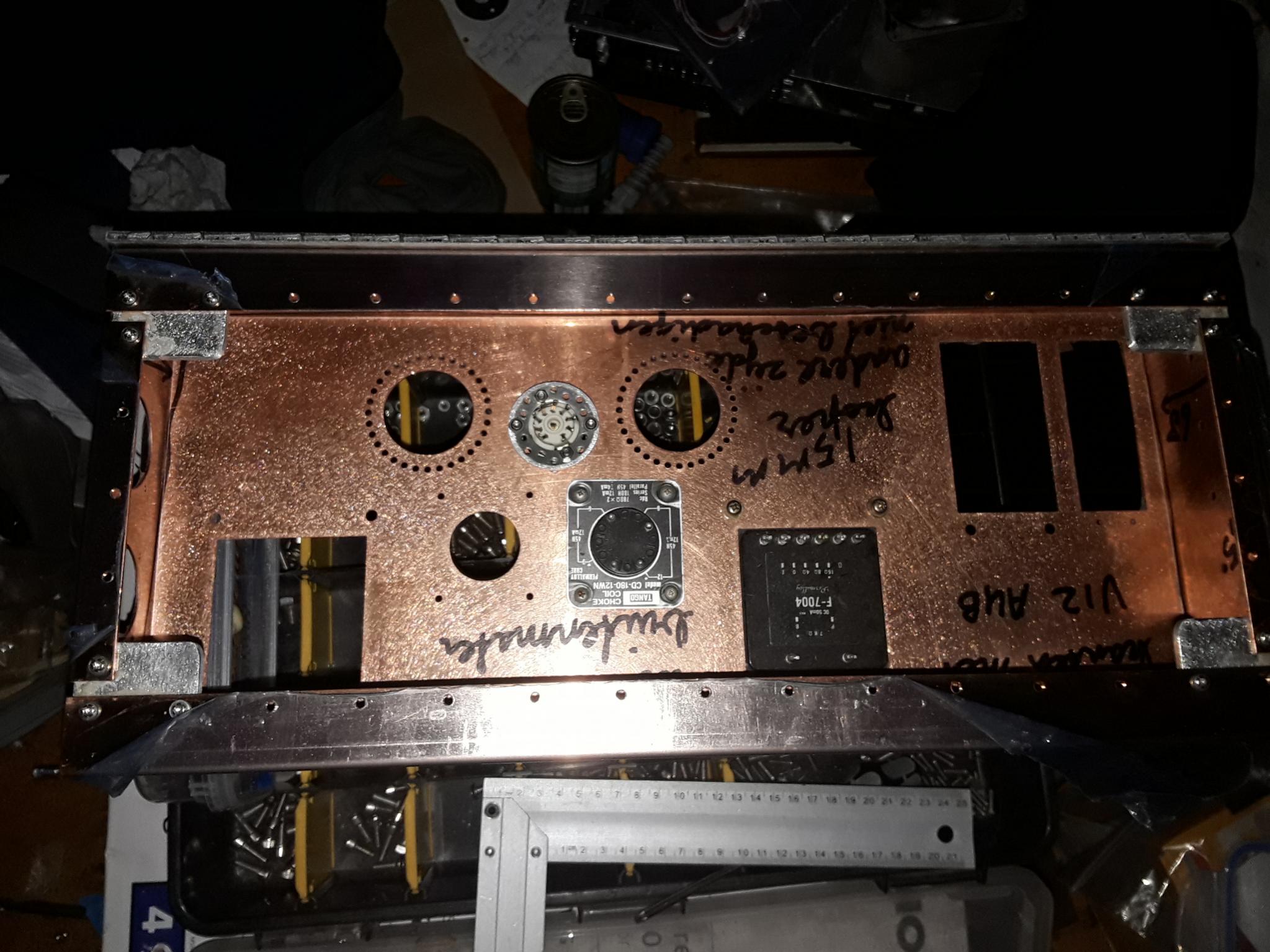

Hello,
I am trying to construct a DRD ultrapath amplifier.
It has one power supply for two channels however after the input choke and first cap there is an LCRC network for each channel. The output tubes are vt25A and the input tube is a single E80cc/6085 where both des are used one for each channel.
The vt25A have both there own Roc Coleman regulator. These wires will run close to the chassis in between the anode choke and the output transformer.
The E80 cc has a separate 6,3 volt transformer for the heater. The transformer is located in the center of the power supply from there it will run towards the row of 4 caps, run along the twisted black/blue wires and then enter the signal part, running in between the two anoade chokes ( in the picture only one channel has the Tango and the Tamura mounted) and go towards the noval socket.
The wires going from the final power supply cap and the ultrapath cap will enter the signal part for one channel close to the upper part of the chassis ( because there are no heater supply cables running there) For the channel at the downside of the photo they will enter close to the other corner ( where there are the threaded holes to mount the bottom plate)
The loudspeaker terminals are one the right side ( the 6 holes 13 mm now covered by a piece of alumium. The xlr inputs will be near the rectanglar hole at the right corner.
Would it be good to let the '' inner loudspeaker cables'' to move straight up from the solder tags and let them run close to the bottom plate?
What about the cable from xlr to the noval socket.
The 3 tubes are close but are there parts that needs some extra space to avoid '' interference''?

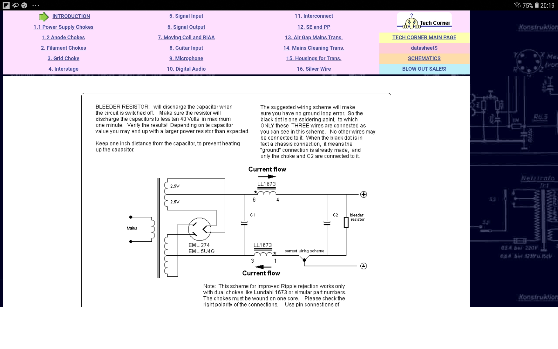

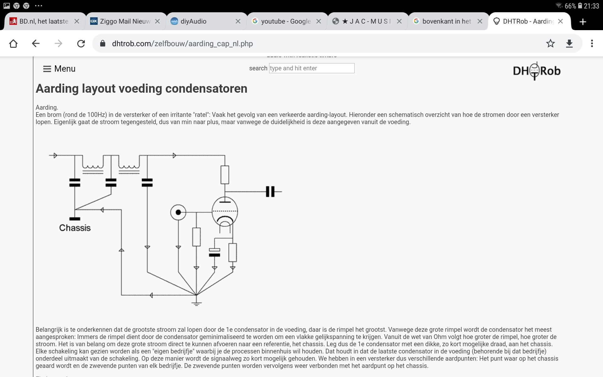

I am using Lundahl chokes with a separate winding for the plus and the return. The Dutch website shows us how to connect the '' earth '' but not sure how to do it exactly. Any advice would be helpful. greetings, eduard
