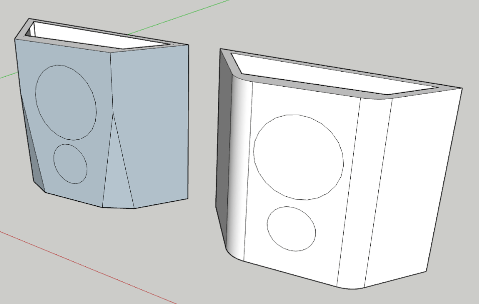

Hello,
I have built several speakers from kits and proven designs and I would like to design and build something more specific. I have been using commercial on wall speakers in my living room for a couple years and they can provide a better sounding and balanced lower end when speakers cannot be placed 2-3ft out from the wall. BUT, there are also potential issues at both ends of the frequency response.
The bass response should account for boundary reinforcement, and the treble response can be limited by placement. Wall mounted speakers cannot be toed in and out to balance the treble and the location of the speakers on the wall may be limited by the location of wall studs, fire places, TVs, shelving, etc. Placement near-wall on stands might be a solution for some, but for true on-wall speakers these limitations require some combination of the following “solutions” to get the treble “right” (whatever that means to you).
Goals:
Maybe something that will look like these R speaker concepts:

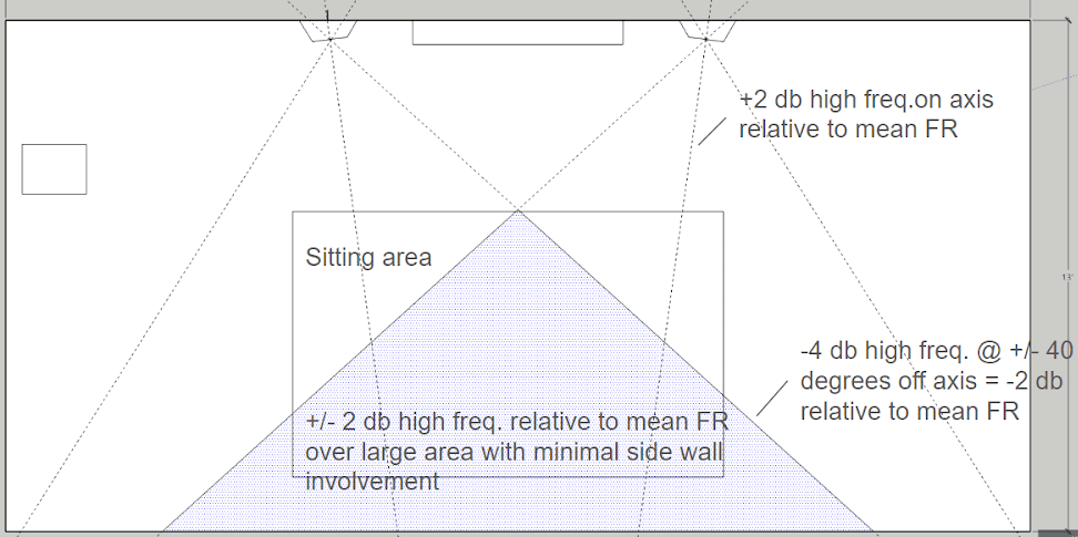

Room integration concept of the “sweet spot” for mid and high FR:
- An angled front baffle
- Wide, controlled dispersion
- Bright on-axis frequency response such that the off-axis is more ideal

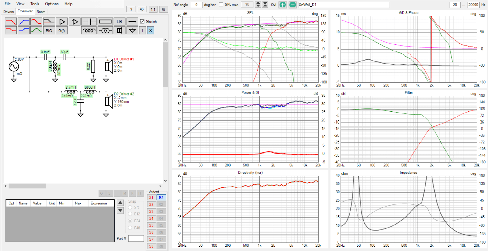

In your scheme I notice quite some baffle step correction (see the electrical transfer function). You don’t need that with on-wall designs. I see you’ll measure the acoustic output before designing the crossover. That‘ll be ok then.Hello,

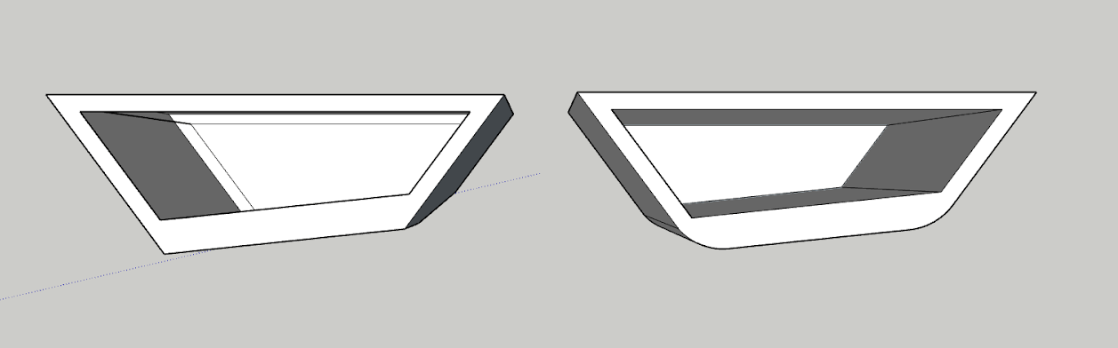

Vituixcad may have a problem with this non-freestanding design so you may need to do some of the calculations by hand, and verify the output you get.
The faceted cabinet will have the least effect on the drivers response other than a hemisphere.

Since you're on the wall, the effective baffle area is large potentially giving good stereo imaging. If you can have it, it's a good setup considering the space occupied, works for cinema as well, with minimal modifications, whether screen or not.

If I give the SS Illuminator 1 in (25mm) behind it, it should fit well in an enclosure with the front baffle 6 in (150mm) from the wall. This is within the range that I see in on-wall designs. My understanding is that I shouldn't hear any difference in timing as long as the front baffle is within 10 in (250mm) of the wall. I have considered the SB Acoustics SB17CAC35-8 and Wavecor WF182BD which are slimmer and should give a similar bass response in a 12L sealed box, but with less SPL than the Illuminator and marginally higher distortion. So, if the SS Illuminator's only tradeoff is that it needs a deeper box, 6 in (150mm) vs a 4.5 in (115mm), that seems like a good trade. Are there other considerations I'm not accounting for?SS woofers…….dude…..I know you already have em but the chassis is super deep!…..and pole vented so you’re going to have to allow clearance for that too or you’ll wind up with power compression issues as well as a possible resonance inside the box…..that IS NOT a shallow/on wall driver. Better off to sell em and use the $$$ for a more suitable driver
The transfer function magnitude suggests closer to 70 Hz f3. In my current setup the sub is crossed at 90 Hz, and you are correct, it is locatable. BUT, I wouldn't say easily. I spend a lot of time just listening in the dark, and the location of the sub very rarely pops out at me. Maybe because there is a chair between my favorite spot and the sub, or maybe because I'm a pin head and the distance between my ears is so small. In any case, the sub can't really move, so I'll be happy if I can drop its crossover by 10 Hz.80hz f3?………you’re gonna need more than one sub and if you’re diagram showing a box on the left as the location?……no go……two subs on the front wall within the soundstage phase pattern…..if not, the sun will easily be locatable.

Perhaps. The reinforcement and cancellation due to the reflection off the front wall will requires handling in a high quality on-wall design. With a 3 way there are several ways the issue can be designed out but a 2 way is more limited in what can be done. If the complexity, size and inefficiency of a passive cardioid cabinet is inappropriate then making the cabinet shallow and wide will raise the frequency of the cancellation dip and weaken it. Making a cabinet deeper for a deep driver is going to make the cancellation worse. Note that cancellation dips cannot generally be equalized out in the crossover they need to be designed out. The reinforcement can generally be equalized out which I think you are taking on board?

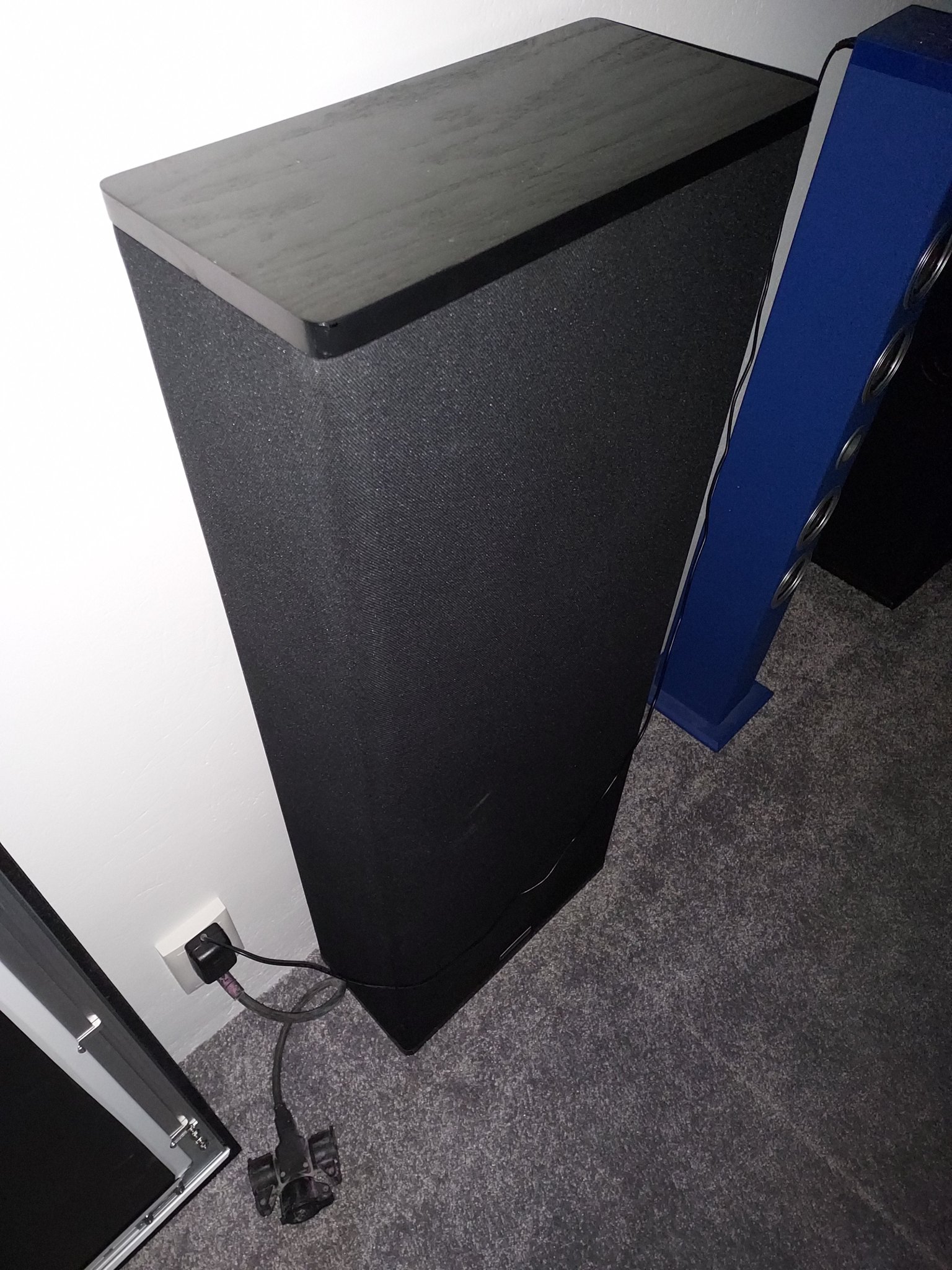

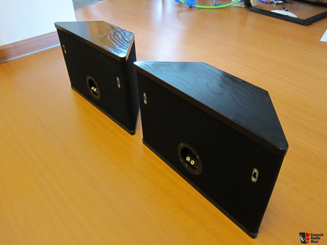

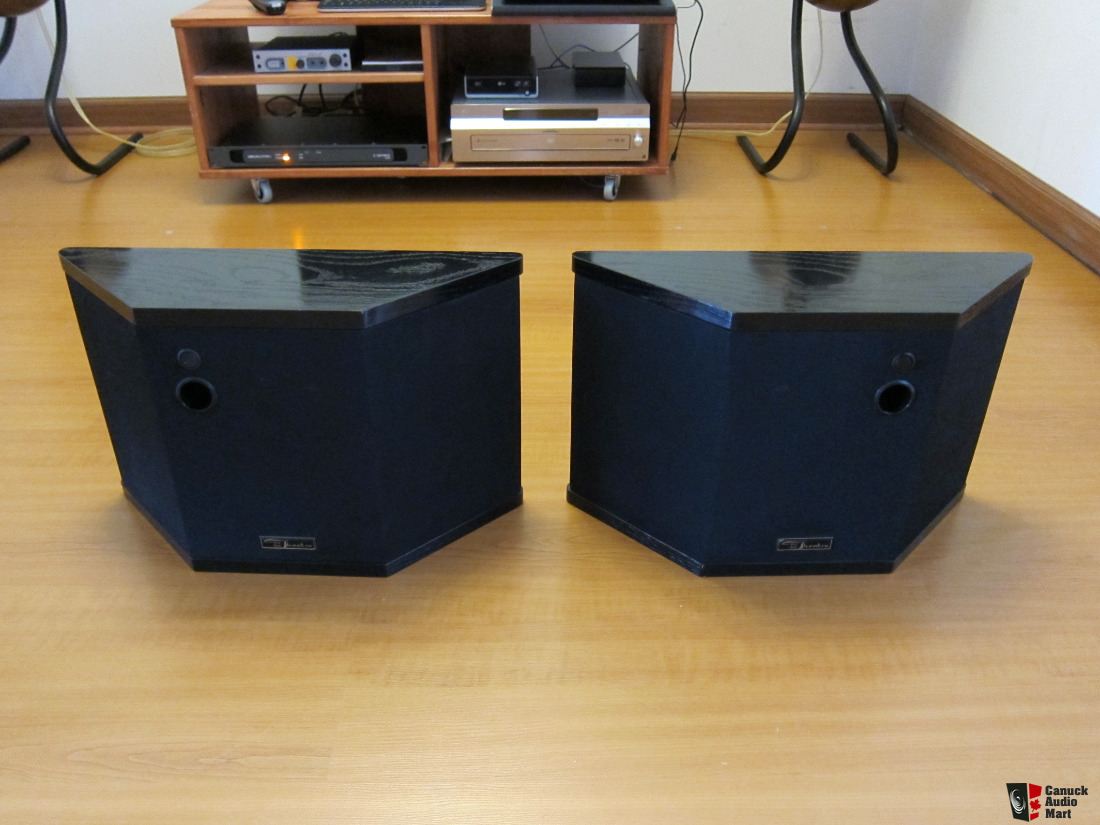

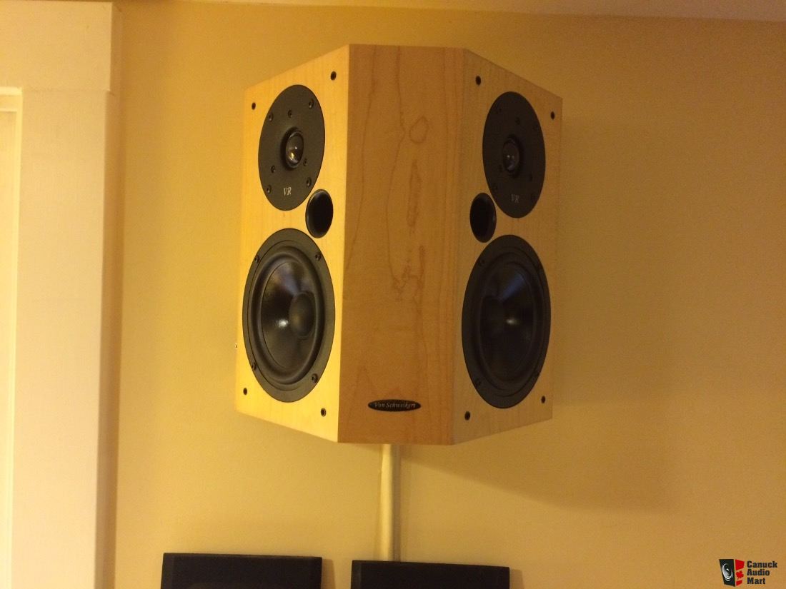

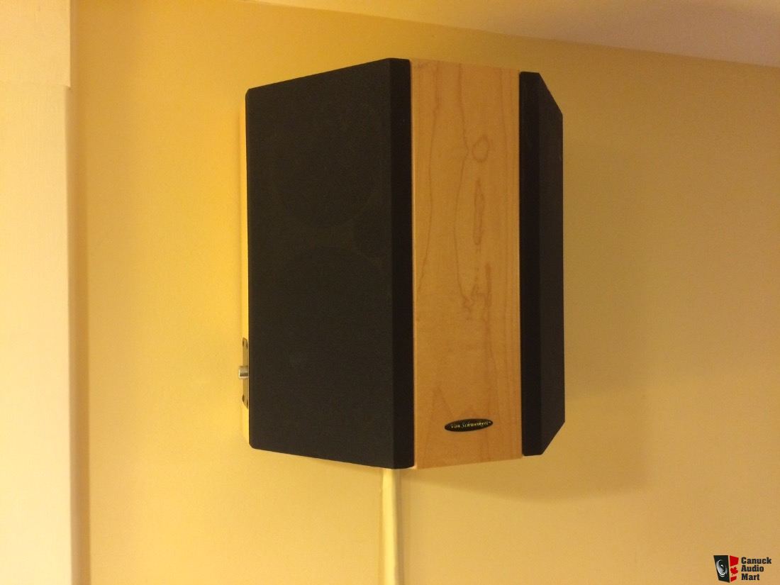

Here is the designmaster Albert Von Schweikerts surroundspeakers from around 1995, i have all of this modell "Virtual Reality series"
A fantastic wall surroundspeaker and i have real high demands.......and they go quite deep
The modell TS150 and the big TS200 surround speakers (Virtual Reality series)
They are switchable between monopole and dipole operation via a switch, which allows tailoring the expansiveness / openness of the sound depending on the program materials.

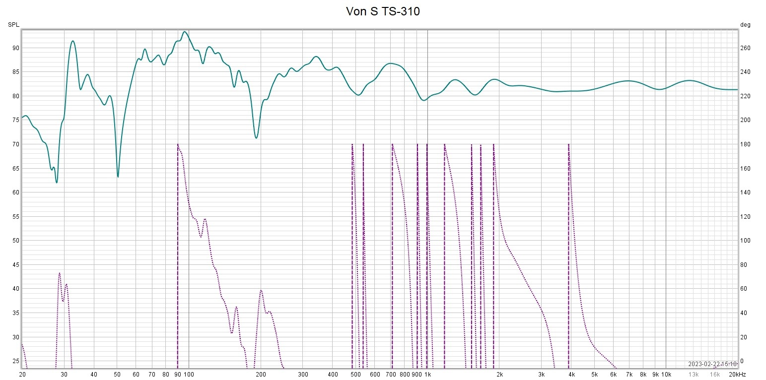

Also have 2 pairs of their "big brother" the TS310 floor surround with 3 x 5 inch mid and 3 x tweeter with a 10 inch woofer, and i mesaured it once without preperations.
Regards John
Regards John
1836650-a-pair-of-von-schweikert-ts200-monopole-dipole-surround-speakers.jpg69.1 KB · Views: 52
1836648-a-pair-of-von-schweikert-ts200-monopole-dipole-surround-speakers.jpg81.7 KB · Views: 51
1292667-von-schweikert-audio-ts150-dipolemonopole-surround-speakers-in-maple-finish.jpg66.6 KB · Views: 49
1292666-von-schweikert-audio-ts150-dipolemonopole-surround-speakers-in-maple-finish.jpg52.2 KB · Views: 51
The thought is that it will balance the boundary reinforcement at low frequencies and balance the off axis listening at high frequencies. With a slightly bright frequency response the 40 degree horizontal listening window might be +2 to -2 db at 10 kHz. With a flat frequency response and the same dispersion, the 40 degree horizontal window would be 0 to -4 db. In my crude test using integrated amp tone controls and my current speakers, +2 db to treble was barely noticeable, but -4 db was obvious.Why do you prefer a sloping response curve of about 4dB rise from 200 to 20k by the way?
That is the idea, but I'd like to hear other opinions or experiences. Maybe I will get a mini-DSP to test FR options in room before designing a final passive crossover?
If you’re serious on this, polar measurements (0-90 degrees, in both axis) are almost mandatory. But that requires some measurement setup: you’ll have to rotate the microphone in a quarter circle around the loudspeaker.
Alternatively optimize flat response at 15 degrees. Lots of designers go this easy way and something has to be said for it.
