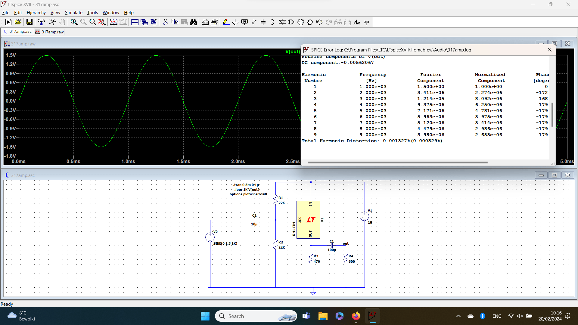

This is the 317 version:
It fits the bill and has vanishingly low THD. In reality, some small capacitors or RC networks might be required for stability
I missed this extremely elegant circuit
Thanks so much for suggesting this. I only have two questions
1) will any LM317 provide good results? (the component used here is quite rare and difficult to get)
2) is the dissipated power given by (Vin -Vou) multiplied by the current Iout? up to what power will there be a need for a heat sink?

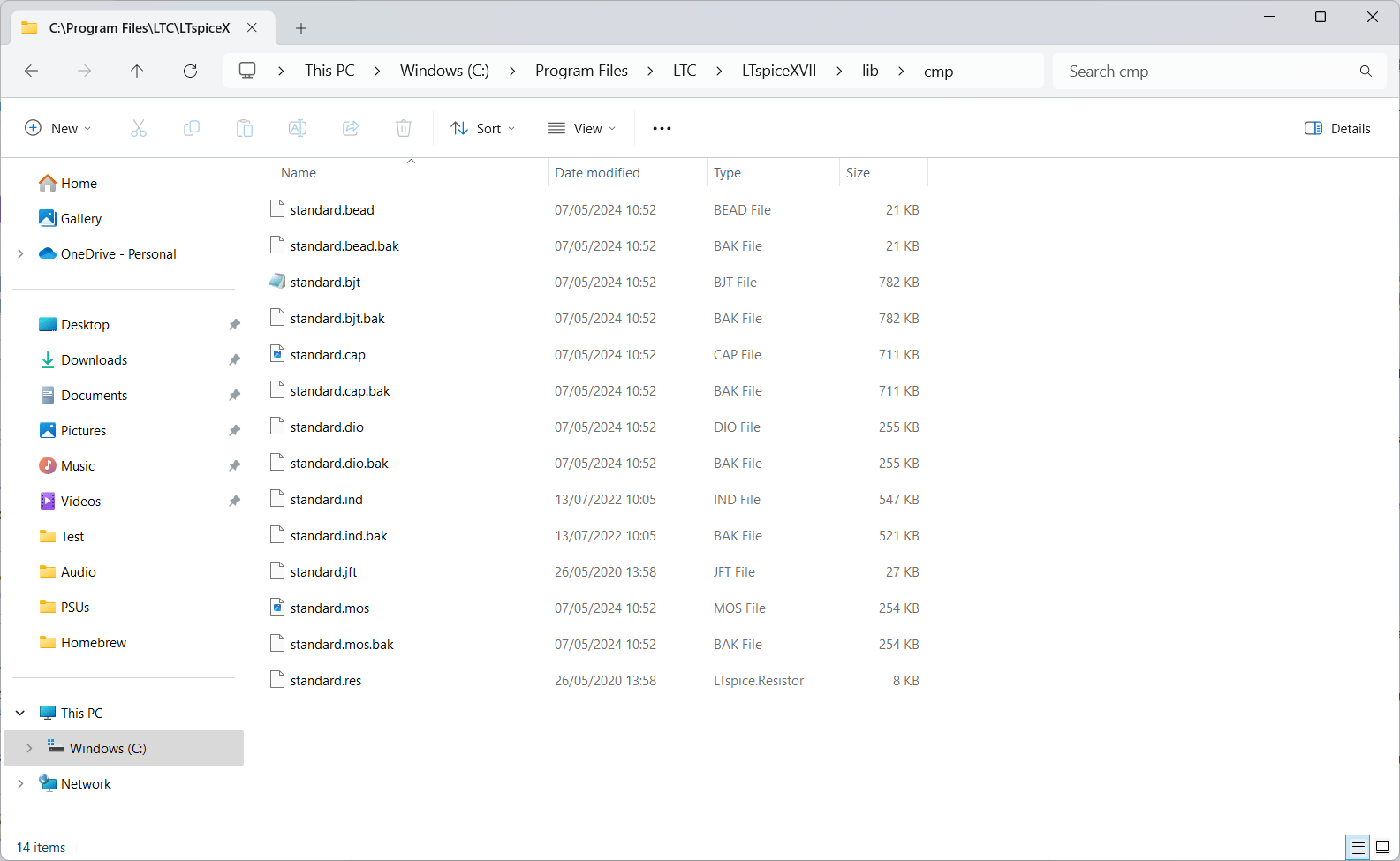

Hi ! sorry again but i cannot find this file on the pc o_O I have searched and found nothing :unsure:
This is the biggest issue now
I understand that once the file is found i can just copy and paste the model and save the updated file
But again the file seems missing
Maybe it is hidden ? i am getting mad
The previous version was so much more straightforward I have seen tutorials and the library showed up very easily
They have complicated the sw imho
To add a new model to the library should be the easiest thing to do I guess
This shows you the complete path to the file in question on my PC. If you have opted for a non-standard installation, it may differ:
  • Thank You
Reactions: 1 user
Joined 2009
Hi thank you so much again :giggle: The folders were hidden and i could not see them :mad: Now i see all the folders/files
I have then added some bjt models taken from the Cordell's file but the program cannot let me to save the mods I mean i edit the standard.bjt file > i save the mods > when i open it again the mods do not show up And when during the sim i pick the bjt the added models of course do not show up in the list
Maybe there is some kind of protection of the original file I will try again soon
The CFP will have a lower noise than the 317, but the THD of the 317 will be lower.....
Hm. This gives me second thoughts. Thanks for aforementioning it.
I'd rather try my luck with fresh new design from scratch using opamps, if improvements are needed. So far not.
Don't know if ANY will do, but my own experience is generally Yes.
Still, better check with LV or Marcel, much more prominent and super-heavy class experts for LM317 among other important related topics too.
There's an easy way to add models without editing the stock file. Copy your file (e.g. Cordell-models.txt) to folder ...\lib\sub, then add to your simulation the directive .lib Cordell-models.txt, that will look for the file in that folder and add all models it contains to your simulation.

Thank you very much again I confirm the sweet spot you recommend with 18VDC supply
with 1V input the 2nd order harmonic is at -120dB More than enough
Considering how cheap are these chips is a mystery that they are not more popular as buffers

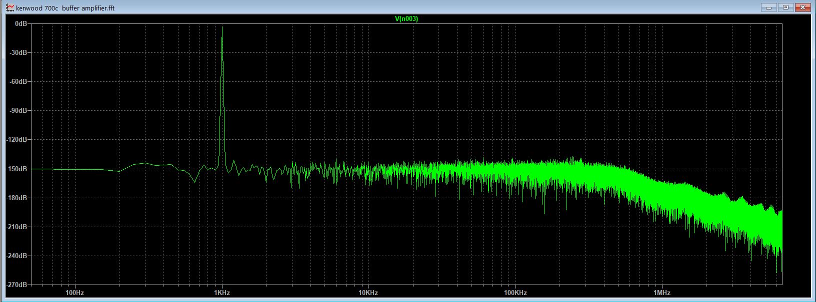

Personally the best performance in terms of THD i have obtained has come from the circuit attached
It is a CFP taken from the buffer stage of a vintage Kenwood preamp
I have not been able to find a low THD CFP with some gain ... the circuits i have found are all noisier than when used as unity gain buffer
Can I replace BC556 with BC560 as drop in?
Can I replace 2SC5876 with a general purpose type as drop in?
How much impact from these changes for stability and performance wise?
  • Thank You
Reactions: 1 user
I simulate with 21V, using BD560 and BC550 (or a GP like BC237):
- by change R4 to above 10K (I use 50K)
and will produce a THD better than 0.005%, which is okayish.
About noise I am not sure if simulation results are valid, so it needs a small test.
Surely, more voltage will improve this, but I am limited to 21V.
I am completely not sure if the trannies operate in their best low noise range. Can someone help with circuit optimizations?
Better BJTs and more calculated low noise regime?
