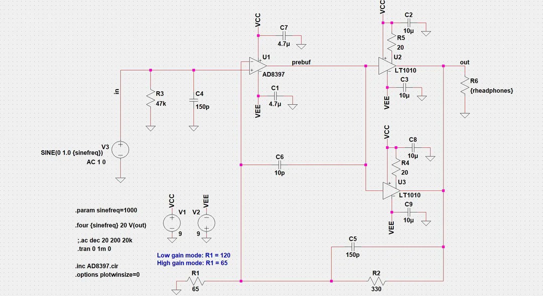

The LT1010 buffer chip is available in a thru hole package. I found the schematic below on reddit.com in a thread called "A Pretty Decent Headphone Amplifier". It uses a pair of LT1010s {2 x 150 mA !} per channel ; I have no idea whether the circuit sounds great or works well. But here's the schematic.

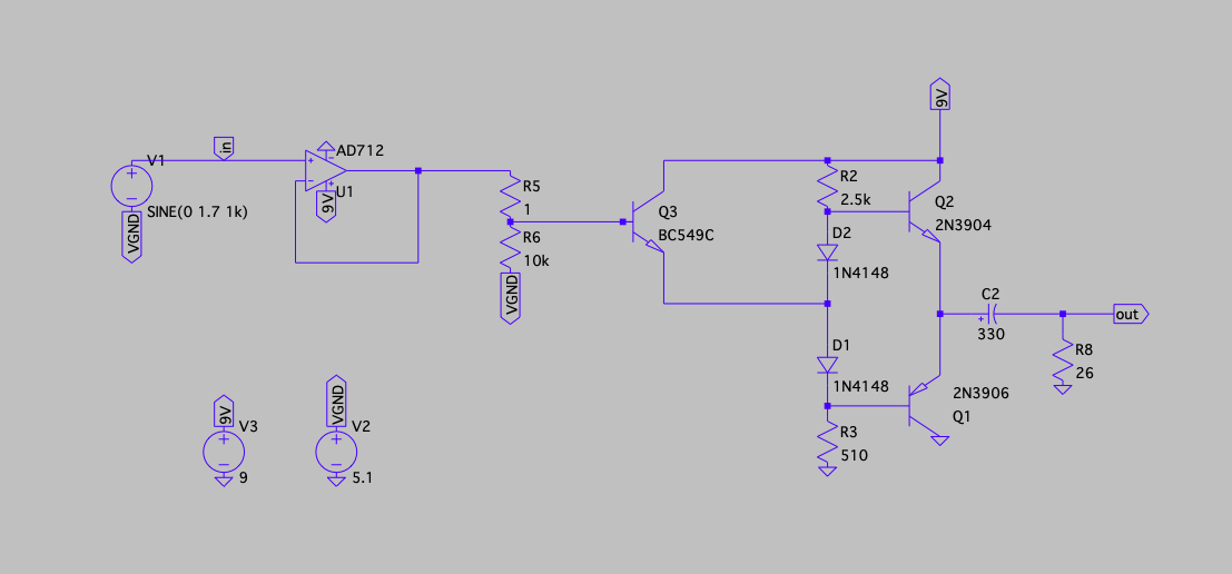

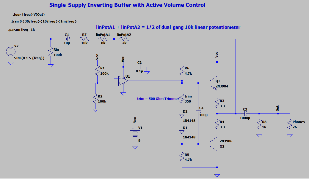

I designed a simple discrete AB amp for it, because I'm running on batteries. Distortion is a little high, between 1-2% on Spice. I had to include a buffer emitter follower between op-amp and the AB amp for volume control. The input signal is a DAC, so I couldn't put it before the op-amp.
Please feel free on any comments or suggestions. I haven't tried the circuit yet and I'm not all that knowledgable, so something relevant might be missing.

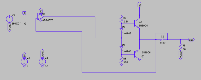

I tried enclosing the AB amp within the feedback loop and distortion went down to 0.04% :)
Is there any creative way to introduce volume control within the loop? I would much prefer to leave the second opamp for the second channel and keep it minimal/discrete.
Also, if I remove the output cap distortion goes down to 0.001. The question is then how to build a sturdy enough VGND for the phones to sit on.

You could use the virtual ground approach, although I always use traditional single-supply designs with input and output caps for headphone drivers powered by a single 9V battery.
If it were me, I would include a trimmer so I could adjust the bias current through the discrete output stage. If you bias it at about 4.5mA then it will run class-A up to 100 dB for 26 Ohm 100 dB/mW phones. That is loud enough to permanently damage your hearing in short order. Of course you can use less bias current to prolong battery life.

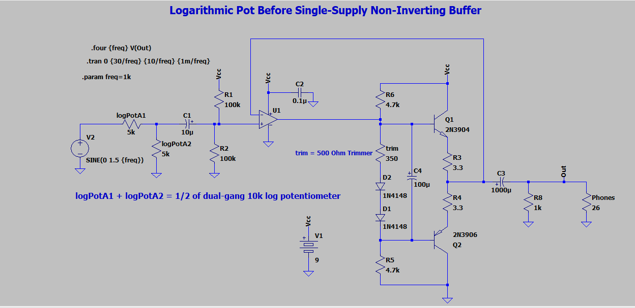

For the volume control, the basic options are probably a logarithmic potentiometer before the opamp, or a linear potentiometer as part of the feedback network.
Below are a couple of examples, where I am assuming you do not want any voltage gain. There is nothing special about them - I am sure many improvements could be made. But they should work fine as long as the opamp is unity-gain stable. You could simplify the buffers below by eliminating the trimmer and C4 (and even R6), but I would suggest including the emitter resistors to avoid thermal runaway.

Dear @jasonRF,
I really appreciate taking the time to share your experience and knowledge with me.
How did you calculate this? 100dB/mW phones will shout 100dB at 1mW, which is not very loud right? That's why I'm biasing the ABamp transistors at around 200uA. Guessing 220hFE transistors, they would deliver 44mA on the output. 26 x 0.044^2 = 50mW. This should produce 117dBSPL on 100dB/mW phones, which I'm estimating as a bearable threshold of pain (maybe I'm wrong).
If the ABamp is biased at 4.5mA as you say, according to the same calculations the phones would produce 131dBSPL and everything including my head would explode. Just trying to understand what did you mean, I'm not so used to maths.
If you bias a class-AB output stage at 4.5 mA, it can deliver 9mA peak current to the load in class-A mode. So for a 26 Ohm load, the AC power delivered class-A will be 9e-3 * 9e-3 * 26 / 2 = 1e-3 W = 1mW. It can of course deliver much more current in class-AB operation.

I'm still not fully clear on the correct values for the resistors at the base of the transistors of the ABamp (in series with the diodes). I measured with an oscilloscope different values on the ABamp alone, not enclosed yet inside the feedback loop, and the minimum resistor values to get a 1Vrms sinewave without distortion with a 26ohm output resistor was 1k (for both NPN and PNP).
If I try 4.7k as in your example I get a lot of distortion, but yes without enclosing it within the opamp's loop–the loop is complicated to prototype for me right now, I want to test it independently for a while until I print a new PCB.
Anyways, what would be the base resistor values to bias the output at 4.5mA, as you seem to recommend? If I simulate your schematic with 4.7k at the bases and without load, which I suppose is what you mean with bias current, I measure only 73uA from peak-to-peak. With 1k resistors I get little less than 1mApp.

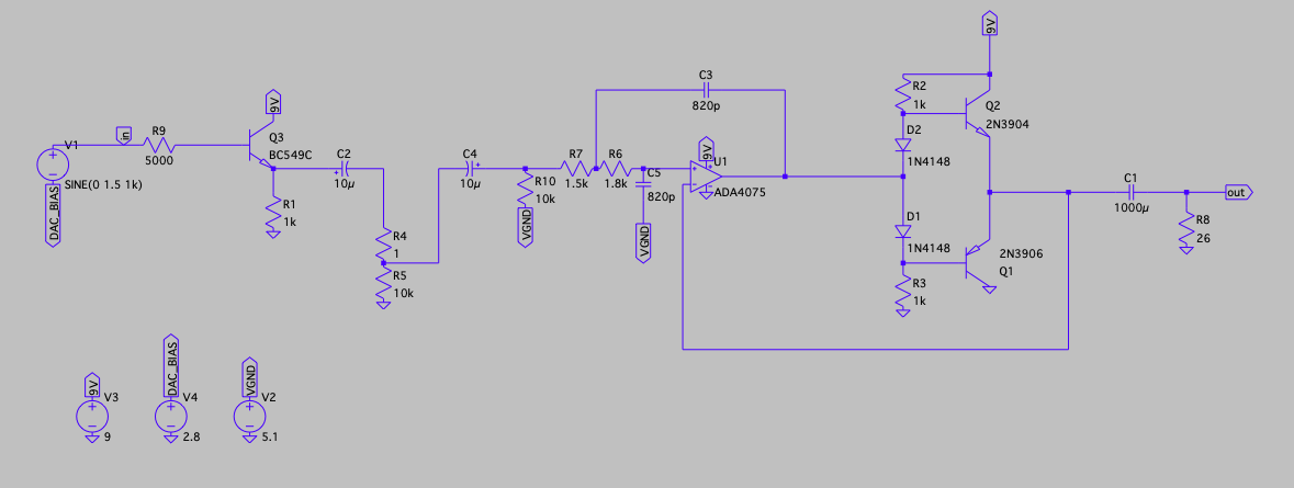

This schematic seems to work the best to me, due the circumstances.

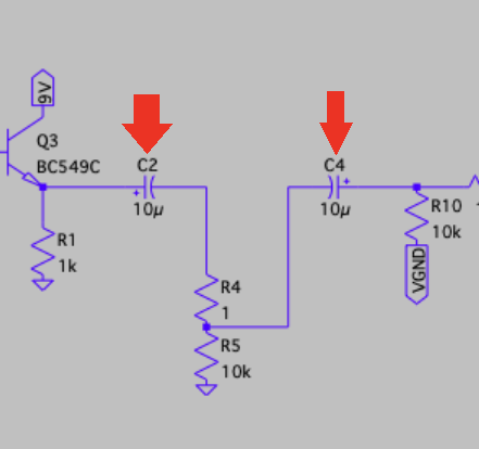

The input is buffered because it is a DAC (w/ 5K output impedance). I place the volume potentiometer between DAC and the reconstruction filter, isolated with coupling caps.
Without the potentiometer I would save two caps and the buffer transistor, but can't find a more effective way to do it. Unless digital volume, but that's not possible for me currently.

Here I will refer to part numbers in the schematic in post 16. Also, when I have been referring to the bias int he output stage, it is the DC current through Q1 and Q2 when there is no AC signal present. This bias current is controlled by the voltage drop between the bases of Q1 and Q2. The distortion will be greatly effected by the output stage bias current. If it is too low then you will see a lot of crossover distortion.
For this experiment, did you include the extra trimmer resistor in series with the diodes D1 and D2? If not, then I am not surprised that you need R2 and R3 to be fairly low in order to get enough voltage drop across D1 and D2 to provide an acceptable bias current in Q1 and Q2. Without the trimmer and with R2=R3=1k, you probably have more bias current through D1 and D2 than you do in Q1 and Q2. For good battery life you will want to spend your current in the output stage (Q1 and Q2) where it has the most benefit for reducing distortion.
With the trimmer included, you can increase the DC voltage between the bases of Q1 and Q2, which is what increases the DC bias current through Q1 and Q2. In this case, you can have higher bias current in Q1 and Q2 than you do in D1 and D2, so you are spending your battery more effectively. The capacitor I added between the bases of Q1 and Q2 is really needed with the trimmer, though, so it adds another part. It helps a lot with reducing distortion.
I would set the current through D1 and D2 according to the maximum current you want to deliver to your load; for example, if you want 1V rms into 26 Ohms, then the peak current in the load is 1.414 V / 26 Ohms = 54 mA. If Q1 and Q2 have a gain of 100, then you need at least 0.54 mA bias in D1 and D2. In my example I made it a little higher at about 0.8 mA. With this current through D1 and D2, you then adjust the trimmer to get the desired bias current in Q1 and Q2. It can be fun to adjust the trimmer while looking at the signal on your scope or audio interface to see the distortion levels change.
Finally, I strongly suggest you include resistors between the emitters of Q1 and Q2. Without them the output stage can be thermally unstable, and it is possible to get a condition called thermal runaway. When this happens, the current through Q1 and Q2 keeps increasing and increasing until something bad happens. In my example I used 3.3 Ohms since I know for sure it will be very stable with a 9v battery. I have seen thermal runaway on the breadboard before - it isn't fun!
jason
I should add that you of course can eliminate the trimmer and the capacitor and keep your circuit as-is. You will just need to make the current through D1 and D2 higher (more current through the diodes increases the voltage across them) to get the output stage bias that you want for acceptable distortion levels. In this case I wouldn't be surprised if R2=R3 needs to be 1k or even smaller.
jason
Thanks a lot @jasonRF. I think it is now very clear and I really like your design. I simulated it again and it draws much less power, especially when headphones are not plugged in. It makes all sense to direct current to the load as much as possible, I just have to include the extra parts for a future PCB design. At the moment I'm just trying to modify a board/device I made and I don't have much space there, but I'll basically follow your idea exactly when I start again. (y)(y)
Why do you use a trimmer instead of a 330R resistor? Would it be to find a sweet spot, how do you determine it?
