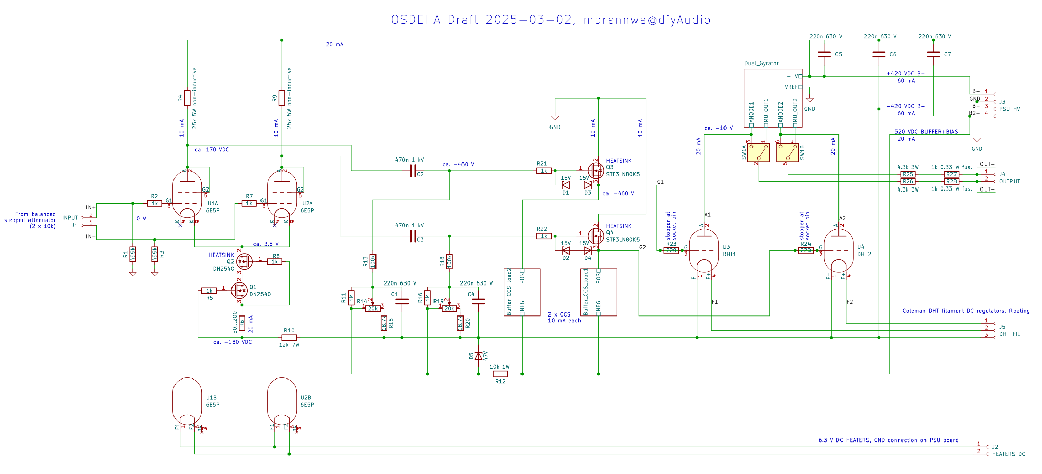

However, the real issue is that the DHT grid bias really shouldn't be so sensitive to small changes in the rail voltages. Looking at the current circuit (see post #63), I see that if B- drops but B2- stays stable, the DHT grid bias will not move along with the B- / cathode voltage. This throws off the grid-cathode voltage and hence the bias of the DHTs. To prevent this from happening, I revised the bias voltage circuit to use a Zener that provides a fixed voltage relative to the B- rail / cathode. See attached (yes, there were a few other small changes in the circuit, but they were not related to the DHT grid bias).
It would be great to get some feedback on this from the brains around here before I start messing with the build.

As I interpret the above, your latest board revision is perfectly buildable though the grid bias might need watching, so might go ahead and order some boards, and then I will shoot you a PM about tubes.
The boards are working fine in my prototype. No more issues with grid bias (solved a few months ago).
