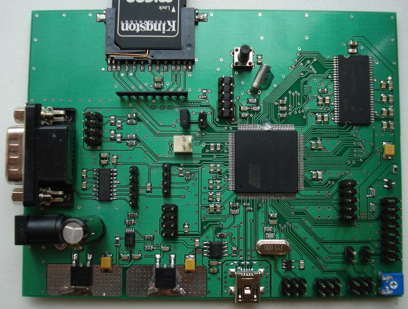

I work with another avr32-based device for usb-audio (and in future as standalone player). My firmware code is based on asf 2.0 with USB Audio code from sdr-widget project.
I tested my device on Windows with Thesycon USB Class 2 driver from Wavelength USB Dac (i found only one UAC 2.0 driver for Windows for tests). With some modifications from sdr-widget code my device is working successfully on Windows.
I will glad to help writing open-firmware device and Windows driver.
schematic my device
Nikolay
P.S. UAC 1.0 also is working on Windows with my device (44100 and 48000 Hz)
Hi Nikolay,
Excellent !!!
The audio-widget firmware source is hosted at github. Let us know if u are interested in joining the development work and help us test against the Thesycon driver 🙂
It will be really nice to have an open source win uac2 driver. U might like to start a repo at github as well and we in the sdr-widget/audio-widget will be glad to help out.
Your project looks very interesting and it is our hope that many uac2 devices will be developed in part encouraged by our open source firmware 🙂
Alex
Hi Alex!
I am ready to help the owner SDR-Widget with debugging on Windows. Unfortunately my device is somewhat different from the SDR-Widget, therefore, requires code changes are not related to USB Audio.
I have no experience in driver development, so I can't take the development itself, but I can help in testing and debugging.
Nikolay

Hi Nikolay,
Yes, please help with the uac1 async coding. Email Andrea to put your name in developers list at the github repo and u can start 🙂
Our unified firmware supports uac1, uac2, multiple boards, different ADC and DAC's etc, and the image that is booted can be selected via a GUI program on the PC host, or via a rotary encoder/LCD screen connected to the widget.
Alex
