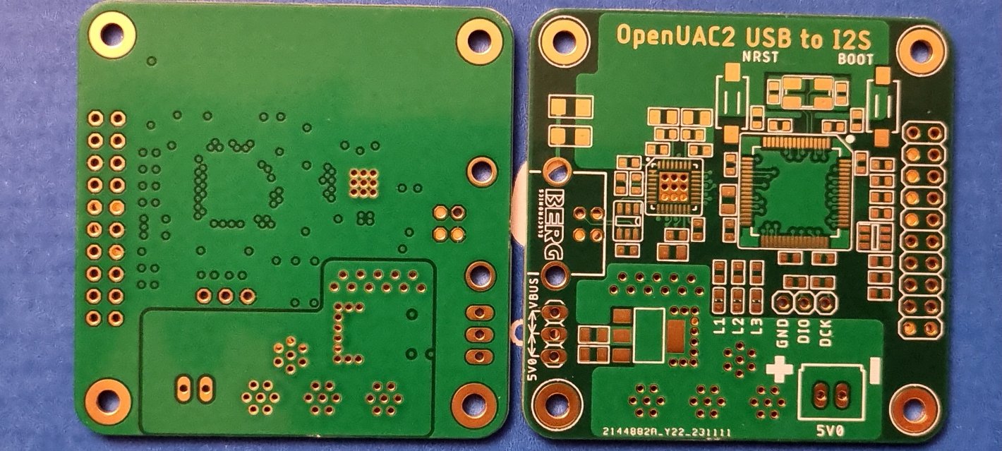

Boards arrived today. I considered this project to be a good oportunity to also test JLCPCBs 6 layers & Via_in_Pad PCBs. They look great.
Waiting now for some little hobby-time to solder the parts.
