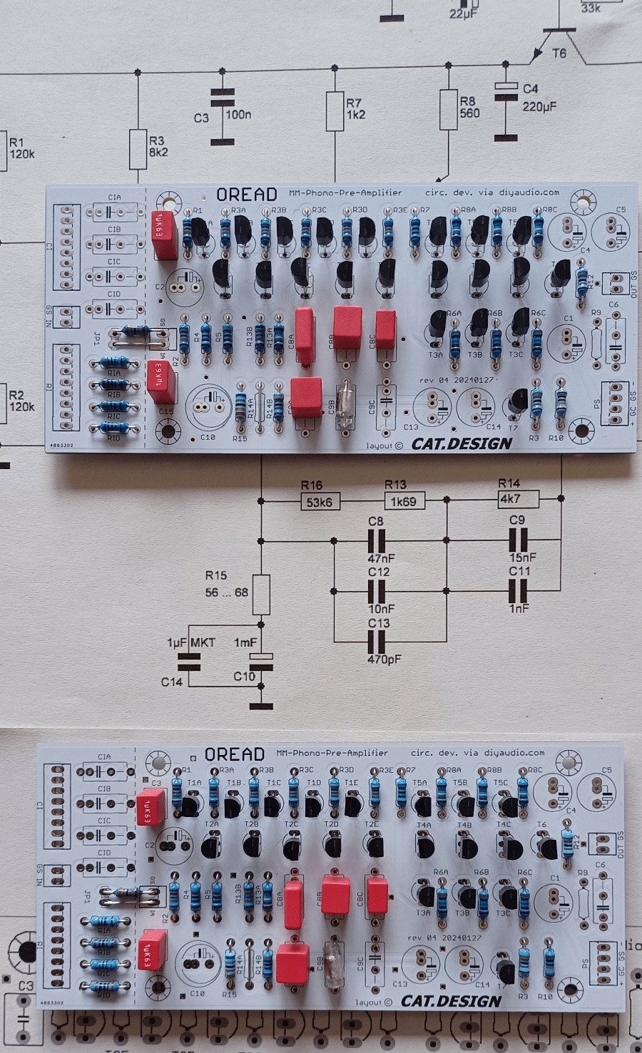

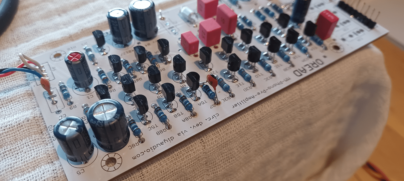

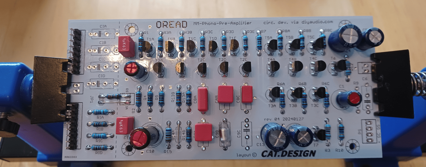

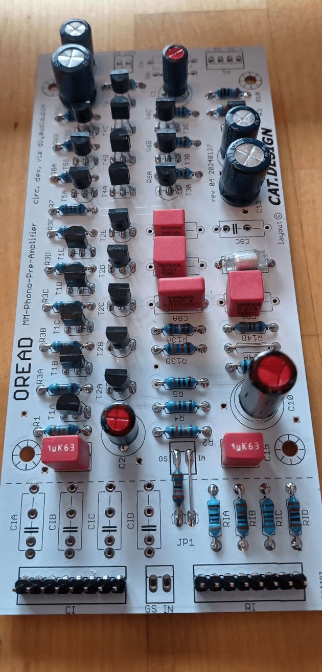

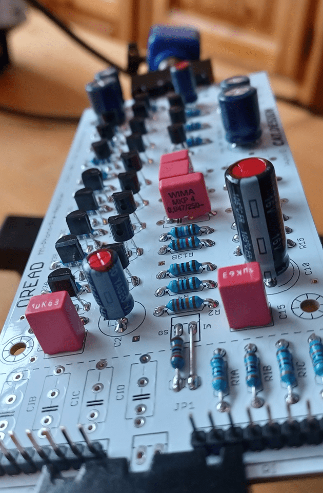

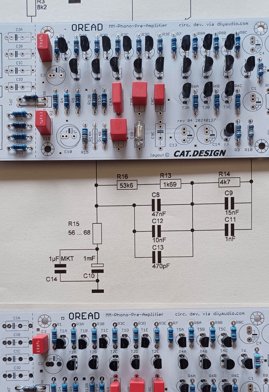

Tomorrow I will solder the components (up to the current assembly point - nothing is finished yet!) and test the circuit for the very first time - define R9 and C6. C1A to C1D will be done at the very end, after the input capacitance of the functional circuit has been determined.
Let's wait for the final result before we release the fire for the overkill version, what do you think @catd ? After all, the quick idea of a simple EQ should be able to compete with the pearl3 !

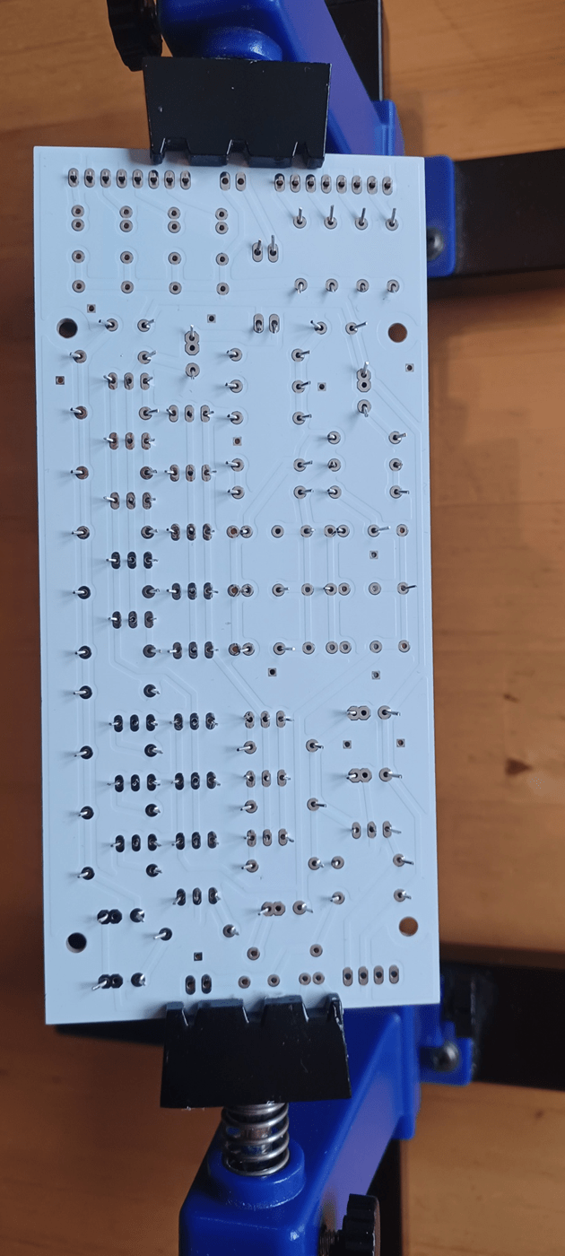

Hopefully the Asian production facilities have also produced the through-hole plating in an exemplary manner, otherwise I'll have problems - because now you can't solder anything from the component side.
greetings,
HBt.
Reactions: Airhead

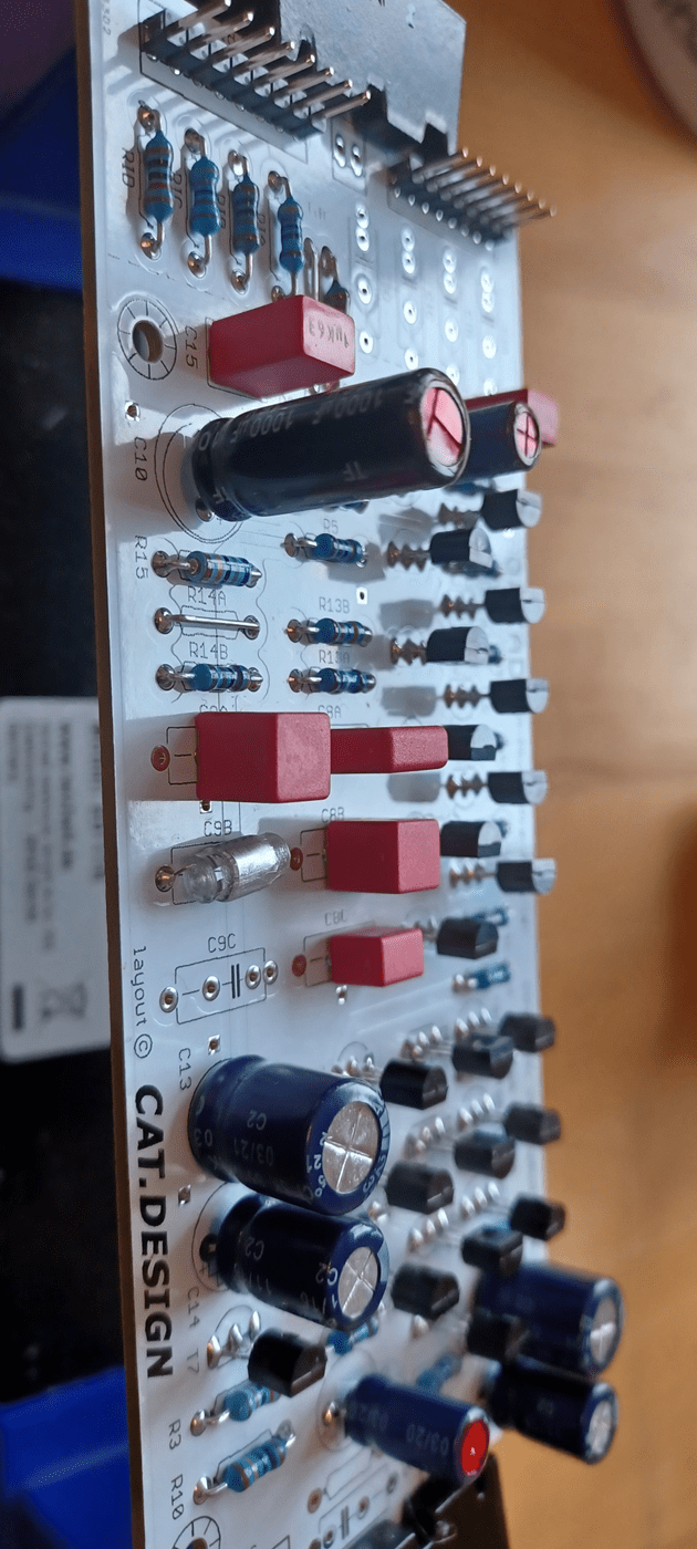

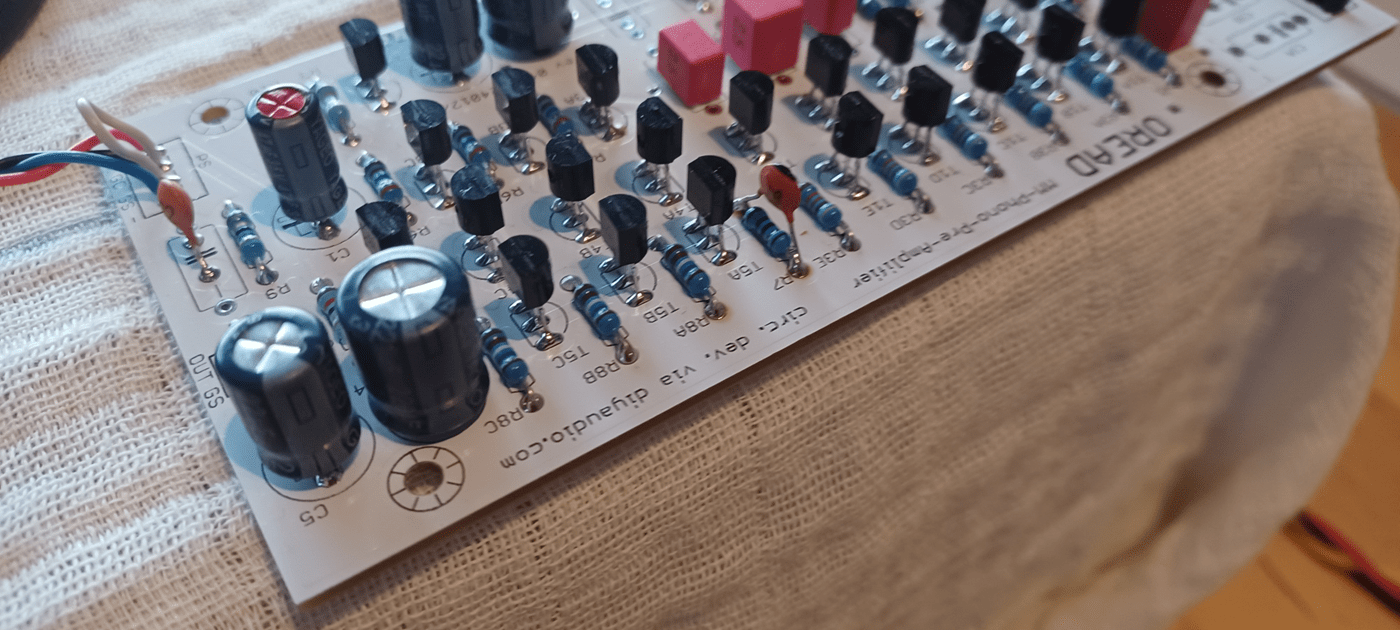

No difficulties with soldering
The capillary effect pulls the solder upwards ..!

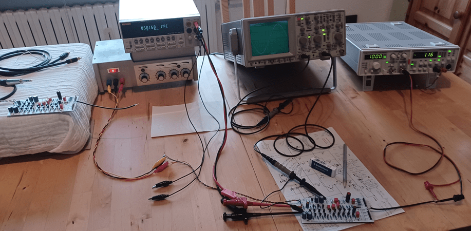

Our joint "simple RIAA-EQ" passed the first test with flying colors.
Statically:
everything is fine, all DC working points are as expected.
-VCC = -9.9Vdc
+VCC = 9.9Vdc
Soft start -> approx. 5 seconds; resulting in +/- 9V rails.
Dynamic:
with R9=47Ohm and C6=2.2nF ceramic and in parallel to R7=1k2Ohm a small compensation C with 18pF ceramic (together they prevent a 10MHz oscillation, at least on my board and the Overkill version) the following fast data results.
Input capacitance C_ip = (60pF plus a line section RG 174 with 15pF) 75pF.
Well, this is our most extreme assembly - so you shouldn't be surprised about a rather large parallel capacitance.
Output resistance, impedance at f=1kHz and u_o > 400mVrms approx. 76.6Ohm.
Maximum undistorted excursion 14Vpp, without external load at f = 1kHz.
Maximum output voltage 8.2Vpp at 50Hz and a load of 10kOhm. As long as Rload remains >= 10kOhm, we can dispense with an impedance converter on the output side as already predicted, otherwise not!
All we need now is a housing and a listening test.
I wish you lots of fun and enjoyment with this small, discrete EQ.
Bye,
HBt.
Measuring devices used:
HC-5010EC
MIC-4070D
LCR-400
HM8018
Keithley 2015 THD
HM407
HM8030-6
and WSS1986-PSU
Pencil, calculator, eraser and various load resistors.

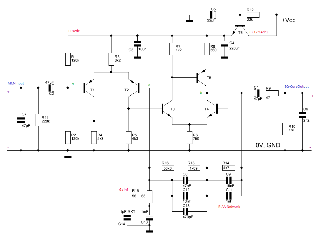

If there is still a need for clarification, I will use the attached schematic with its nomenclature.
Notes on the current state of affairs:
C7 can be omitted as well as the 16 discrete setting options for C_inp (here formed by cat's C1A,B,C,D). It makes little sense if in the overkill variant our input capacitance is already (with wiring) <100pF, with really bad luck the value is much greater than 100pF - but don't panic.
You are welcome to test the symmetrical power supply, but it is definitely not necessary, well, the board provides for it - let's just try it, but then I would also connect R1 and R2 in parallel and to ground, away from the rails.

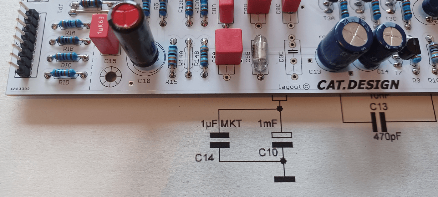

C3 (&C15 cat's) also want a 7.5mm pitch, C10 definitely likes a parallel 1µF film capacitor as an assistant.
If we are satisfied with the final sound result and have not forgotten R11=220kOhm, then we solder a 100nF MKT / MKS and a 10nF FKP film capacitor in parallel to our coupling capacitor C2 & C1 = 47µF / 63Vdc types each (but it doesn't have to be, it's all about the so-called DA and the ESR) ..!
For frequency response compensation (the phase reserves) we try the wooden hammer method (there is no other way to call this method than with a wooden hammer - it works better) and solder either a small ceramic disk capacitor in parallel to R7 (18pF) or perhaps a 10pF between point b and point c, i.e. de facto in parallel to our RIAA network.
In order to be able to see oscillation tendencies and all possible other interferences, deformations and spontaneous oscillations on the edges of the actual useful signal, you need an analog oscilloscope - perhaps a nice old "Tektronix". The cheap DSOs are not suitable for this.
Statically everything is fine, the first stage shares 203.2µA per pair, a total of 1.016mA flows in the left (507µA) and right (507µA) branches. The second stage is very similar, where the pairs share 699.1µA and both branches are perfectly balanced with equal currents, adding a further 2.097mA in total. The total quiescent current requirement is 3.12mAdc -> 56mW per channel; almost ideal for battery power.

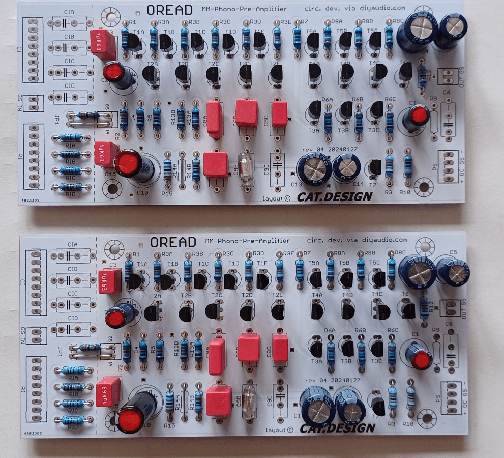

I have completed a circuit board.
So far everything is fine except for the same output swing you mentioned, here at 16MHz, 5mVpp.
I put the board in a closed metal box connected to ground and the oscillation completely disappears, even without installing a capacitor.
So no problems are to be expected when operating in a suitable housing.

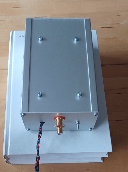

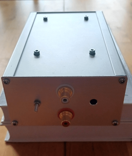

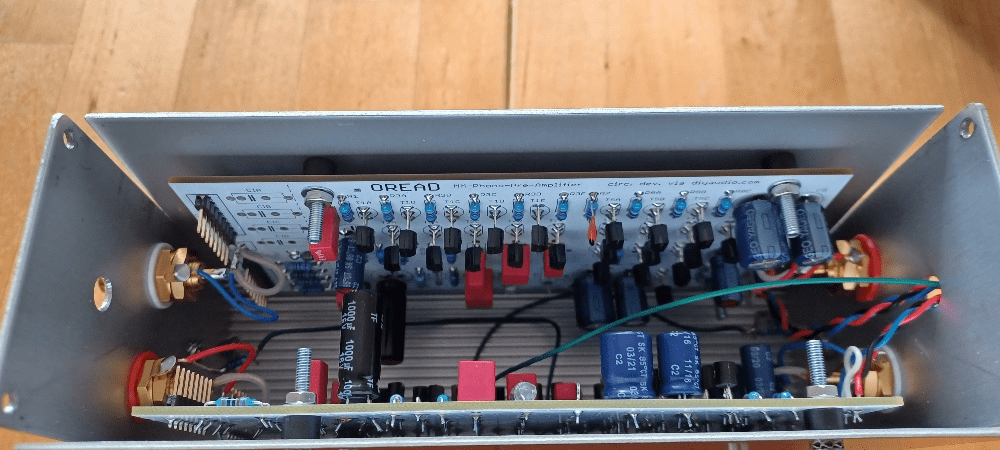

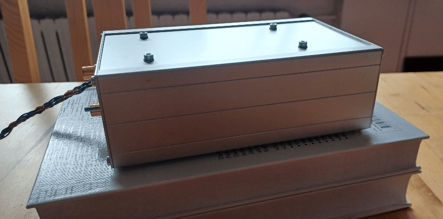

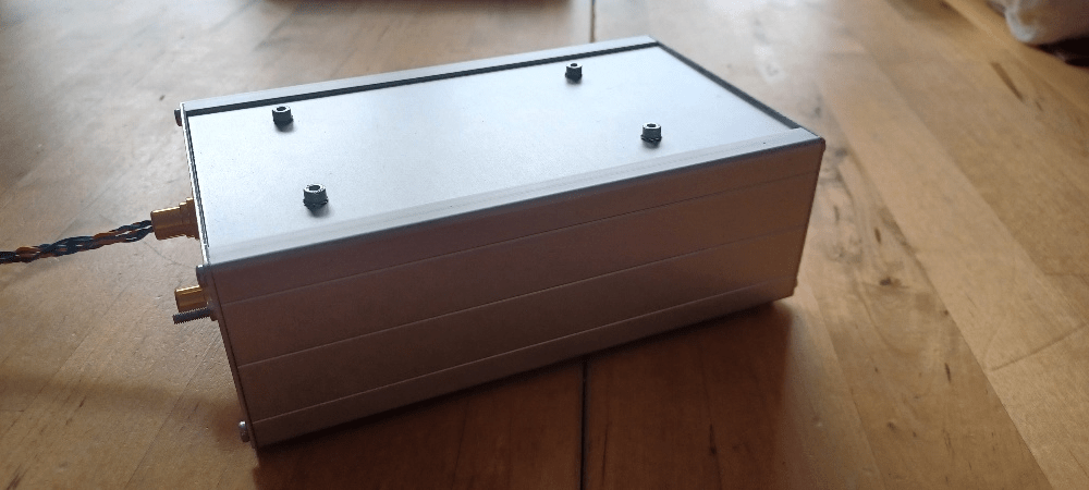

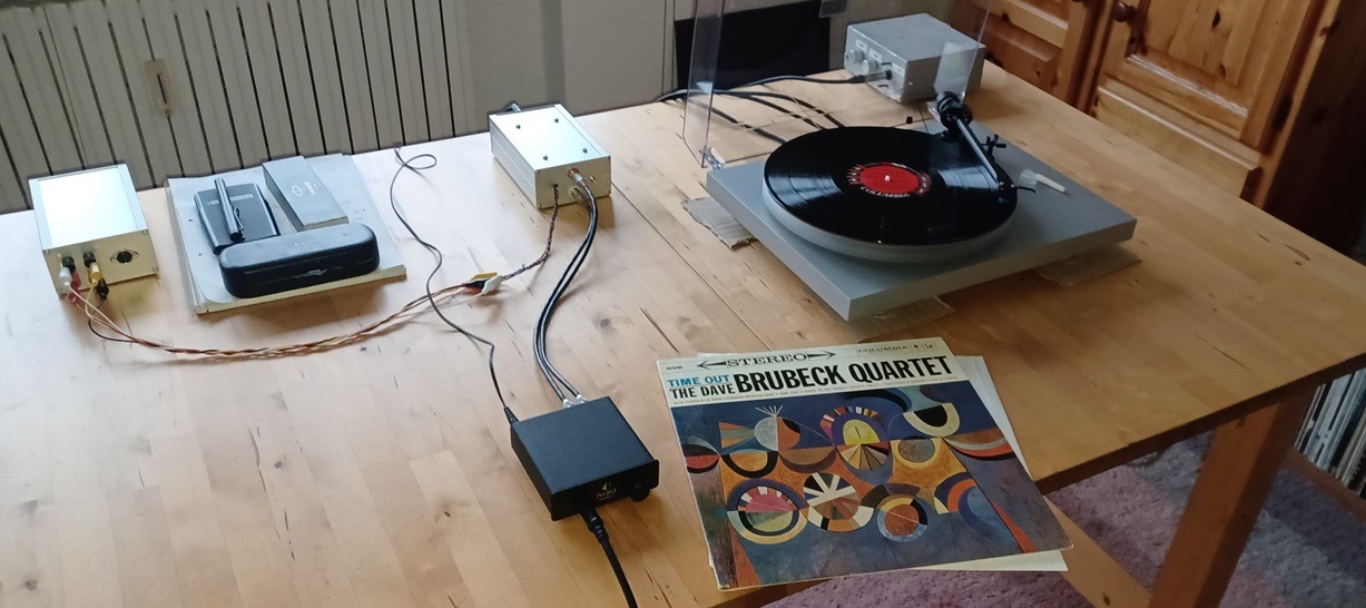

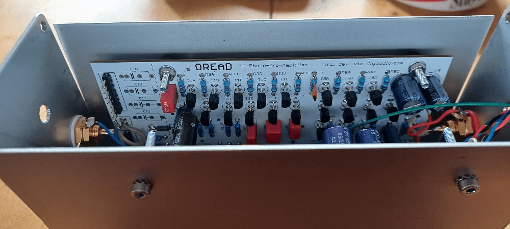

quick and dirty
Ok - I quickly inserted both boards into a standard aluminum housing today. However, the fiddling is no fun at all, no matter, that's where our project will live for the time being - testing.
Which version did you build @catd ? Overkill, PNP-NPN-PNP or NPN-PNP-NPN; for which (dimensioning depending on the) operating voltage ?
Reactions: stv

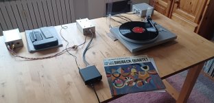

The MM input:
First, R11 (with the original 220kOhm) should be increased, 270kOhm or even 330kOhm ---> I measure 44.4kOhm||69pF in the overkill setup with +/- 9Vdc operating voltages.
The first sound impression:
Practically zero noise, I have to turn my headphone amplifier all the way up to be able to guess anything.
The Brubeck Quartet comes across as extremely black, natural and abysmal, with absolutely no distortion whatsoever.
Madness ...
As if it were a tube, so black - black is beautiful.
