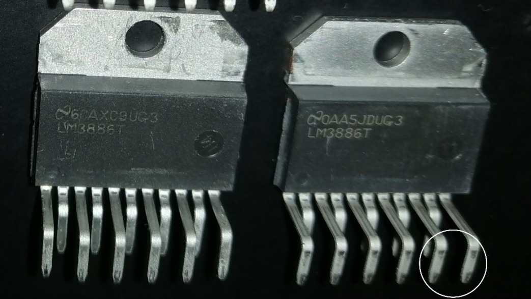

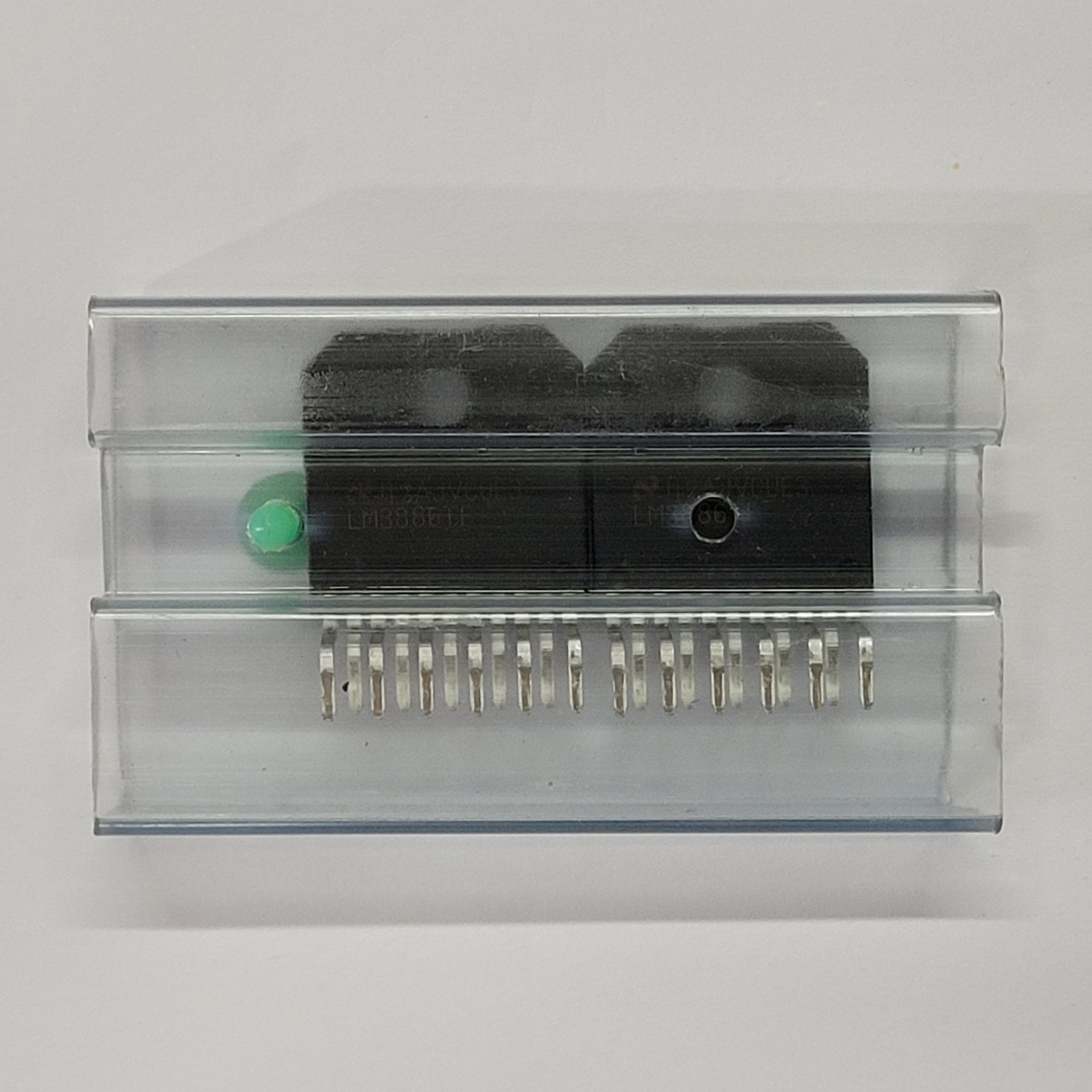

I bought two units of the LM3886TF chip here in Brazil for around $32.00 each.
It was very difficult to find...
I've seen several photos of original chips on this site, these mine look very much like originals, they are up to all datasheet standards.
Any thoughts on its appearance and originality?

They look genuine from what I can tell. But the also look like they were de-soldered from a PCB. There's still thermal grease residue on the back (that's why it's greyish white) and you can see a line on the pins where the solder has been reflowed. That's a bit disappointing given the price paid.

I think the impression of thermal paste residues is due to the lighting.
Pins look clean, no solder residue or clean appearance.

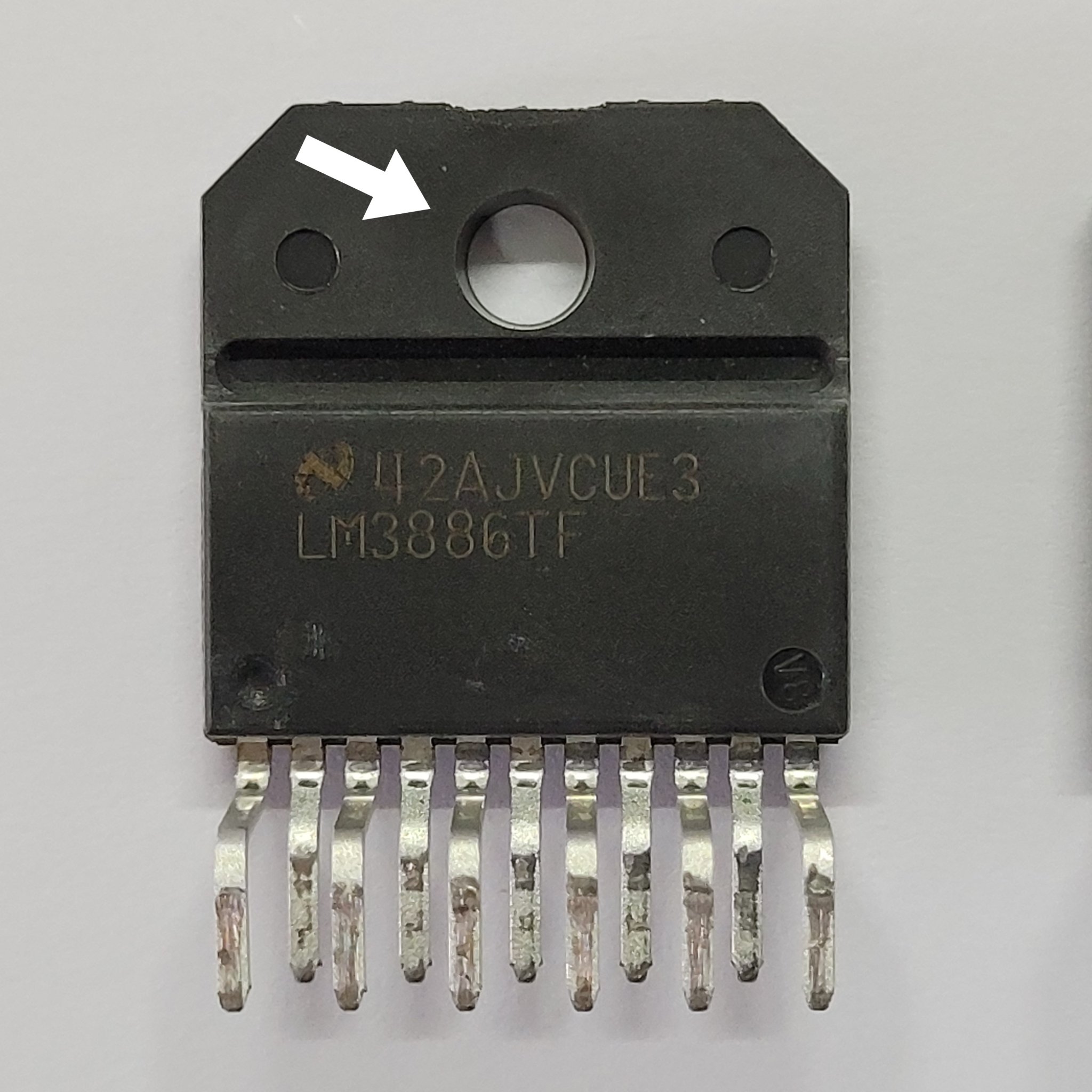

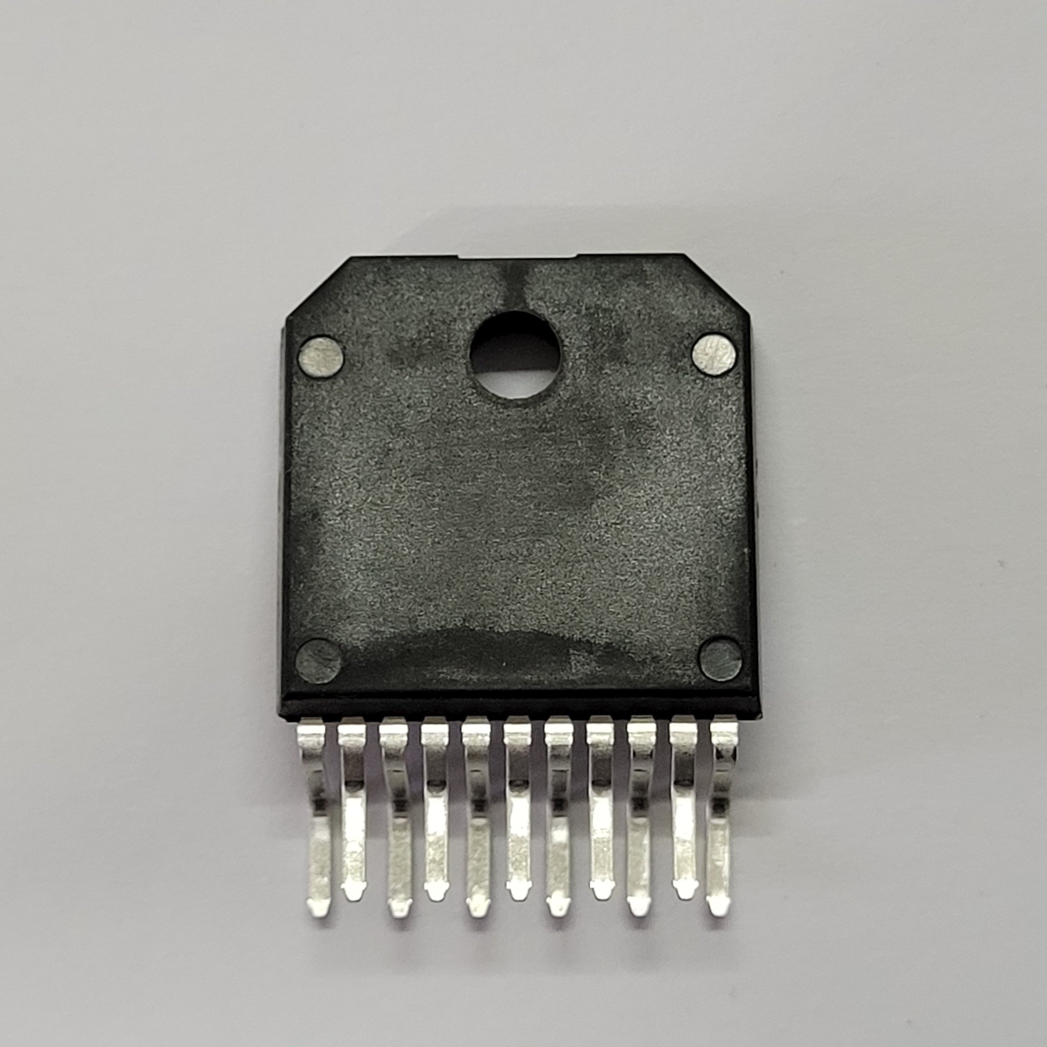

New photos.

I really appreciate your work, if I didn't live so far away and it wasn't difficult to import things to Brazil, I would buy your boards, but your website is a great inspiration.

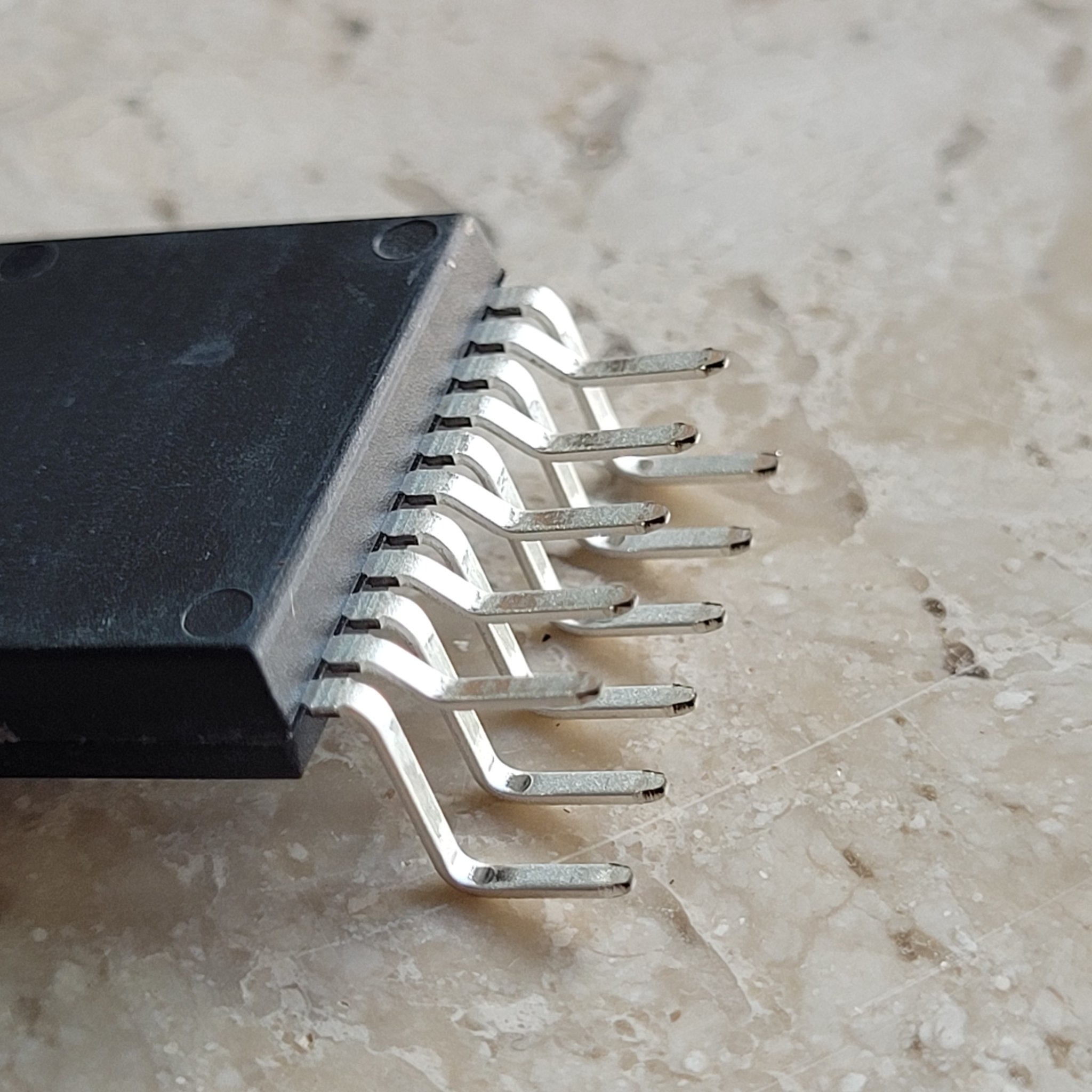

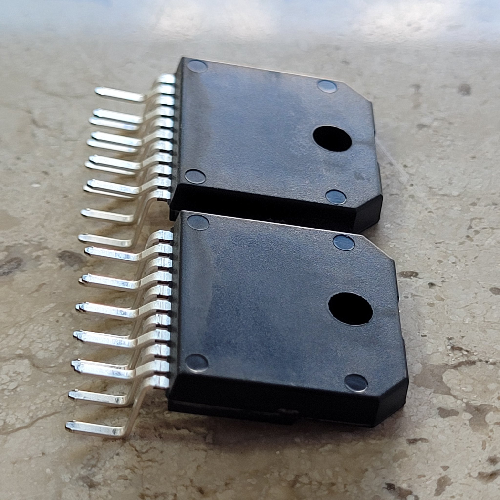

I found several photos on the site of specimens and they all have marks on the terminals, I believe it's because of the machine that makes the folds...
I am convinced that they are original and new.
This is one of them, in the topic it says it came from Mouser:
There are also no marks of screws on the case or any type of support to fix a heatsink:
Ah. That makes sense. You might be right about the marks on the pins as well. Things always look more dramatic under magnification. The inner row of pins (the even numbered pins) all show the original solder finish.
This is one of them, in the topic it says it came from Mouser: View attachment 1173293 There are also no marks of screws on the case or any type of support to fix a heatsink:

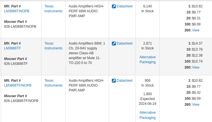

As you can see in the LM3886 data sheet, there are there versions. They all have the same die inside. The differences are in the package.
LM3886T/NOPB - Metal back, lead-free solder
LM3886TF/NOPB - Plastic package, lead-free solder
LM3886TF - Plastic package, leaded solder
They're functionally identical for the DIYer. Just remember to use a thermal pad and shoulder washer to isolate the metal-back version from the heat sink.
