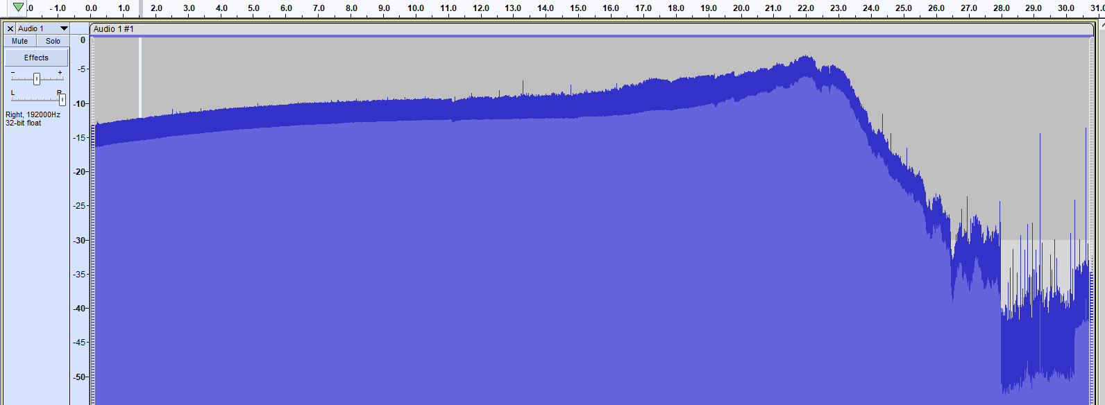

This is the test record with sweep going from 800Hz to 50KHz in 28 seconds, true ?
You mention to be looking in Audacity to the Signal Envelope, but be aware that the sweep is not linear but exponential in frequency, so halfway at 14 sec. it's not ca 25Khz but close to 5Khz.
Much better to get an idea what your Cart is doing, is to apply within Audacity a Anti Riaa operation on the recording under Effect/Filter curve EQ/Factory presets.

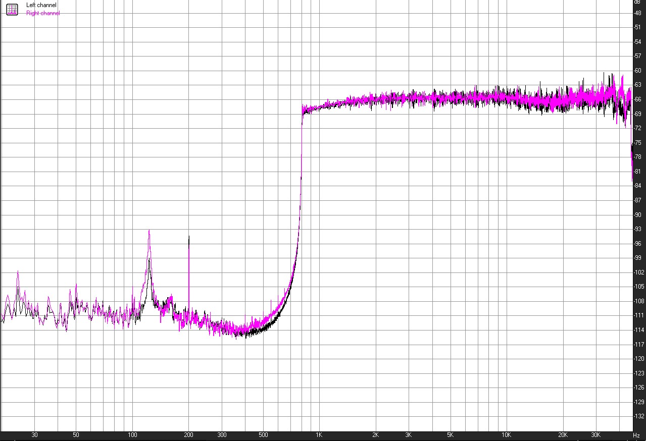

Reactions: ejp
Hi George,
It is played back with an MC cart on a flat preamp.
But because an exponential sweep has a spectrum showing a -10dB/dec downwards slope, I have multiplied the spectrum with a +10dB/dec upwards slope to get a flat spectrum, which is much easier to read.
Hans

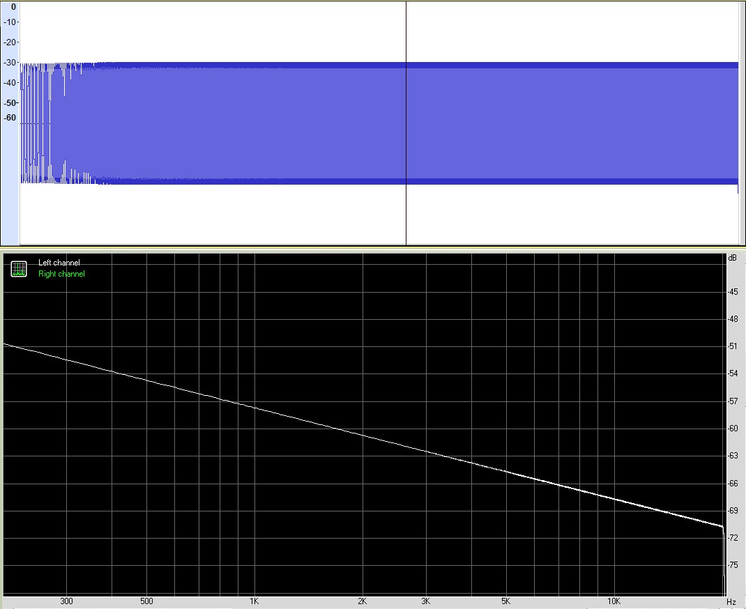

Hans, please give more details. My understanding is that a logarithmic sweep (what is an exponential sweep?) has a frequency interval vs. time interval relation on the logarithmic scale. E.g. a sweep from 500Hz to 1kHz takes the same time as a sweep from 1kHz to 2kHz or from 2kHz to 4kHz, etc.
On the other hand I encountered with -10dB/decade (-3dB/octave) amplitude response at pink noise.
Hi Icsaszar,
A logarithmic sweep is the same as an exponential sweep or a chirp.
And yes, pink noise also has a -10dB/dec slope just because every octave or decade has the same power, just like in a chirp.
Have look at the image below, a chirp from 200Hz to 20Khz.
The upper part the shows the signal envelope, which is what you will see in time when using a constant velocity recording played over a flat preamp.
The lower part of the image shows the spectrum of the time signal, having a -10dB/dec slope.
Hans

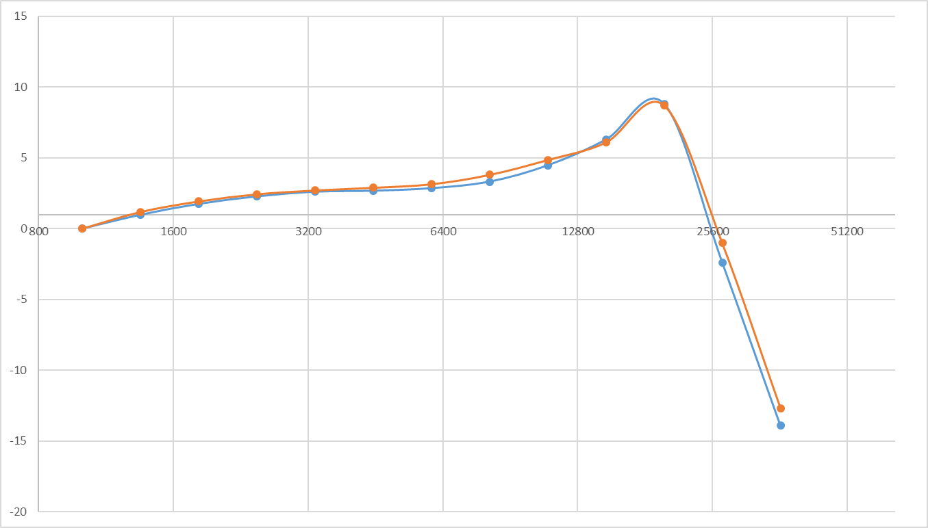

Sweep recorded with linear preamp (192kHz SR)

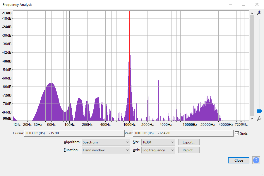

Let's take a pinch of it, select ~100ms somewhere and use Analyze -> Plot Spectrum feature in audacity:

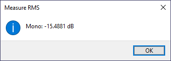

Peak at 1001Hz suggests this is the part of the sweep around 1kHz. Now let's use Analyze -> Measure RMS option.

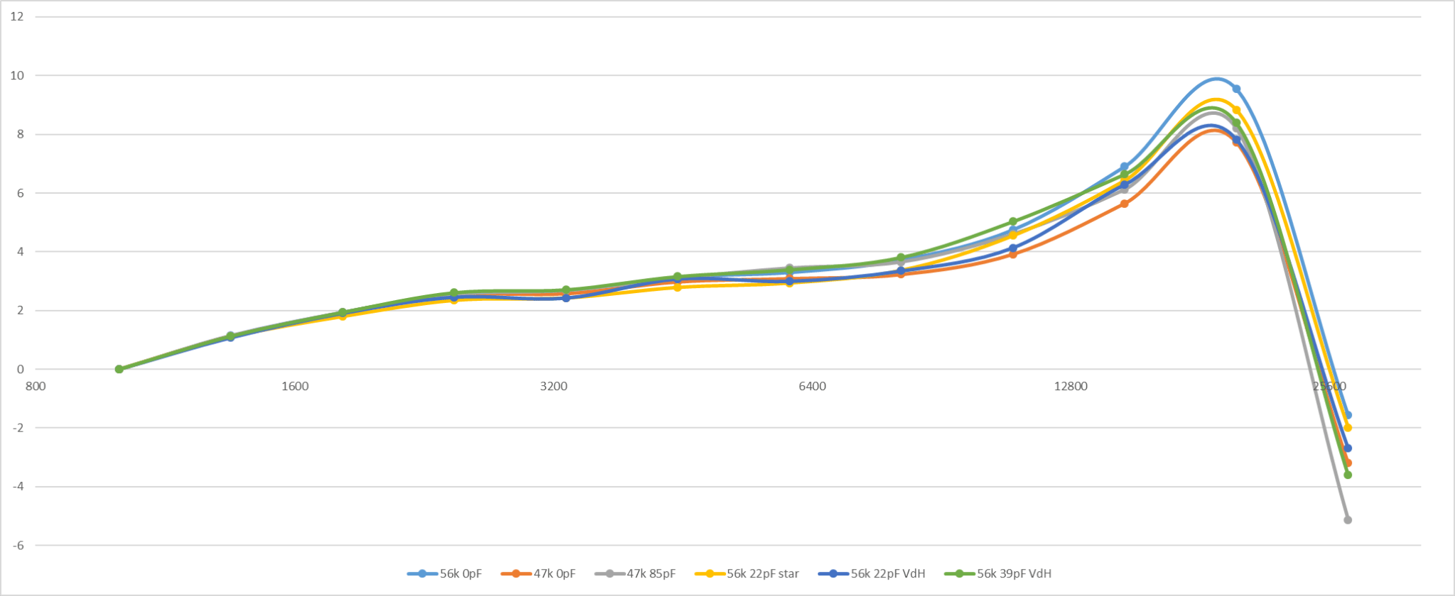

Write down (insert in spreadsheet) that value. Then continue doing the same in other parts of the sweep. With 10-15 evenly spaced measurements one can make a decent plot. Here is one made with 56k || 22pF + 110pF(cable) input impedance with a linear preamp (Left blue, Right red)
What surprises me the most is the deep below 2kHz. I don't know what causes it.
I have to clarify, the sound from LP I perceive as a kind of dull-ish when compared to CD. But it is evident only after comparison. Maybe this recessed mid is the cause of the subdued presentation.
I'm not saying it sounds wrong. It's rather decent playback.
I'm just surprised by the result of the measurement as it contradicts what I hear. Hence, I wanted to check with you my friends if my interpretation is correct or if I'm missing something. And I have to admit, so deviant FR makes me feel uncomfortable.
My initial intention was to optimize cartridge load. Here is a set of measurements I made with various preamp input impedances (cable capacitance is additional 110pF). It appears FR is not much affected by small changes of the load. Recession below 2kHz cannot be fixed by load tuning.
