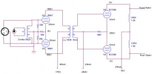

I'm going to build a power amplifier for my Stax SR-404 electrostatic headphones. I've been searching the internet for information and inspiration for quite some time now, this is what I've come up with. Please look at it and give me your opinions about it.
If you recoqnize the first stage...yes it's taken from Lynn Olsons Amity, I should not go wrong with that I suppose.🙂
The same way as in Stax commersial amps, the power stage plates are directly connected to the headphone stators (these drive the ESL membrane in a push-pull fashion, membrane located right between the stators). They should be near 0 V. 580V headphone bias is fed to a separate pin on the headphone connector.
I was thinking about using the Lundahl LL1667 anode choke,
2x135H/15mA. Or do I compromise HF response with such high inductance?, will it be better to use the LL1668 2x50H/25mA?
(both are the same price). 😕
If my math is right I will have a Zout of about 12k with the chokes.
The phones have Zin of 70k@20kHz, 140k@10 kHz (they are like 110pF caps) Do you think a Zout of 12k is sufficiently low?
If I use load resistors (say 10-15k) instead of chokes, then I will lower Zout to about half that, Am I correct?
I've not made up my mind about the powersupply yet..I will post it when I'm done. Suggestions about it are very welcome.
I hope I'm not pestering you with too many questions in my first post, I'm grateful for any input. 😎

Should be OK.
Yes,but than you will have to change the 15V PSU as well and I feel the chokes are a much better solution.

I'll ditto Frank, and add that you can buy 540H/5mA LL1667 from www.diyparadiso.com in Belgium. I haven't asked Benny, but I think they're a custom made for him, as the local distributor here didn't have them on his list.
I also have two pairs of STAX Lambda Pro's and want to do a driver for them, and your is similar to what I had in mind, though I was planning on EL84 / 7189As for the output tubes, basically because I have a lot of them. My guess is it will work well and sound great.

fdegrove: fact is, I was almost determined to build the SRX amplifier but changed my mind. I did some computer simulations of the SRX, without feedback the frequency response was very bad, beginning to roll off at 10kHz or so.

If you want full drive, you need to be able to supply about 15+mA which is quite a lot given these voltages.

I saw it a couple of years back, and didn't like the look of it. A dealer I know (who knows me and the SRX) told me not to bother, and design and build one for myself. The expression on his face said it wasn't good, but he knew where there was a second hand one if I <i>really</i> wanted it.Thom said:Thanks fdegrove: fact is, I was almost determined to build the SRX amplifier but changed my mind. I did some computer simulations of the SRX, without feedback the frequency response was very bad, beginning to roll off at 10kHz or so.

Forgot to metion in my first post, that the ECC99's really love being run at about 20mA Ia. Reduce the negative rail if you need to get the dissipation down, 'cos with the chokes you'll swing plenty at the top, and 350Vp-p (max for the diaphrams iirc) is INCREDIBLY loud with these earspeakers.

Thanks for the advise. You're right that I probably don't need all that 350V Va. My 404 datasheet say that 100VRMS=100dB.

Hmm, bit of a trouble to get the current up to 20 mA..Max plate dissipation is 5W. I will try to work out another bias point with sufficient swing so I can raise the current..this should lower Zout also..
