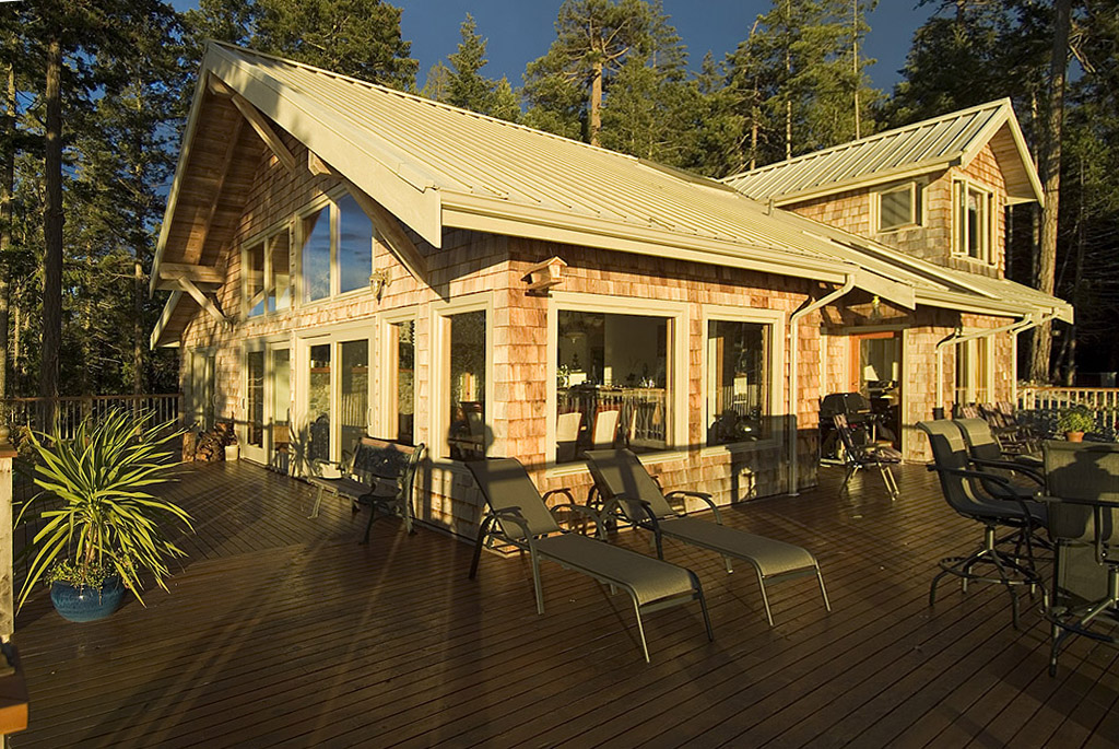

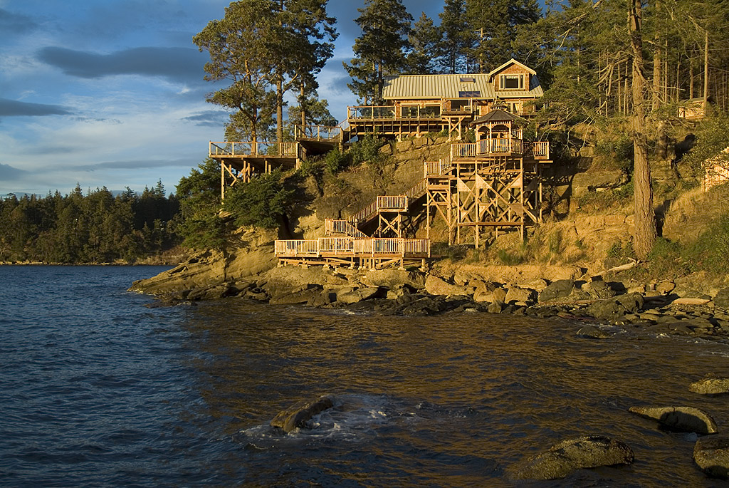

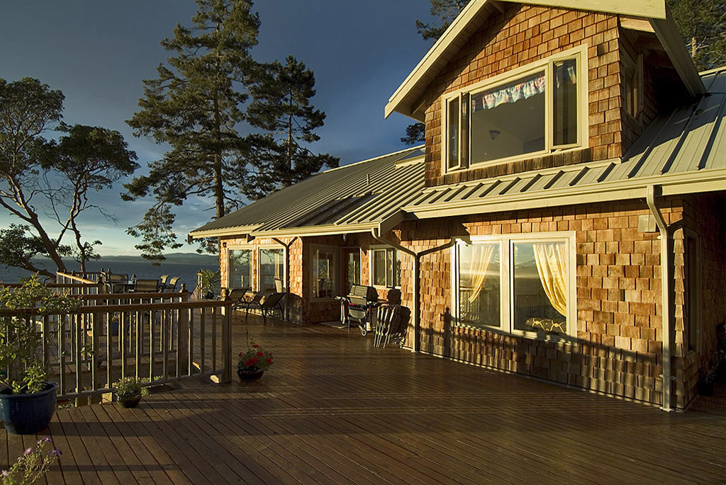

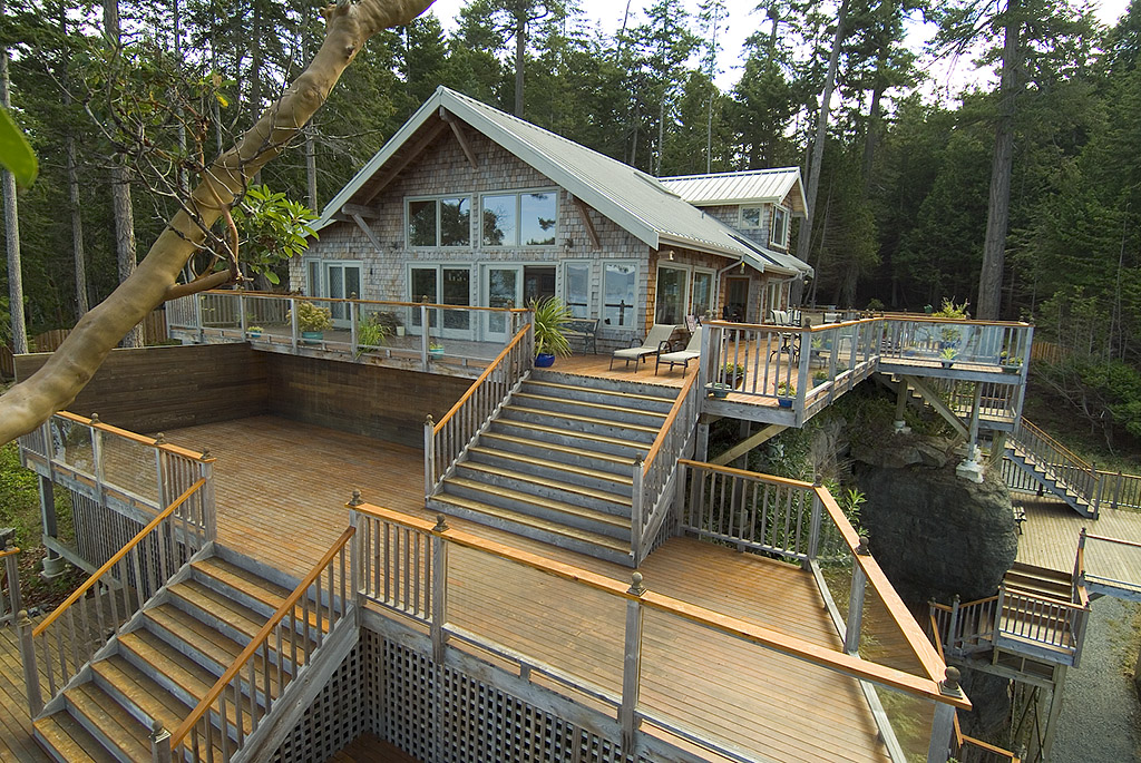

My family just acquired a fairly large cabin on an island near Vancouver. The island is completely off-grid, meaning we have to provide our own electrical power. I am planning on installing a bank of deep cycle batteries, which will be charged by solar panels and a propane generator - all of this will power the cabin self sufficiently. The size of the overall system will be about 4 kW with a battery bank capacity of about 1350 Ah.
The cabin is perched on a cliff facing the ocean (see pics below) and has about 2000 sq-ft of interior space and 5000 sq-ft of deck space (pretty ridiculous). Its situated at the end of a dead-end road with only a neighbor on one side, so I'm not too worried about sound levels (if they are in the right direction). The front of the cabin faces off into ocean so sound can carry out that way.
I'd like to design a PA-style sound system that will provide enough power to fill the air outdoors and in. I'd like the system to be very robust, as I plan on having some parties up there with a DJ playing. It should be designed to handle DJ-style music and volume, and provide clear, crisp sound at both low and high levels.

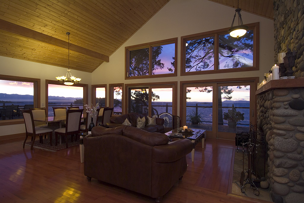

I originally budgeted 600W for the sound system in my power budget, but I am thinking that for what I want I will go as high as 800W outdoors and 100W indoors. The indoor room is fairly small and I'm not too worried about it. It's mostly the outdoor system I am focusing on.
My plan (which could use your input) was to get two separate amps, a smaller one for inside and a larger one for outside. I then want to build my own cabs for the outdoors which will be weather resistant and rugged, but not to be left outside all year. Take into consideration that there will be lots of salt spray from the ocean.
My question then is what should I purchase and how should I design the system? Take a look at the pictures below and help me out!
There's definitely some options for cabinets. I could go with 4 or more smaller cabinets that could hang underneath the roof, with or without a large sub cabinet under the deck. I could go with two (or more) multi-way cabinets and strategically place them. I could mount the cabinets underneath the roof, or hang them so they can be moved inside when not in use. They could also sit on the deck and not be mounted. As I said before, this should support a DJ playing a party on the deck. I have no cabinet design experience yet, but I'd love to get into it. I don't know what the best setup for outdoor sound is though (style of cab, horns, driver selection, etc). And I'm not sure what I will need to do to weather/water/salt-proof the cabinets.
Budget is not a huge issue right now - I'd like to keep it reasonable, but expenses shouldn't be spared as I want this system to last a long time and sound excellent.
I'd also love help selecting an amp to go along with a 600-800W system, as well as an amp for a 100W indoor system and some speakers for that (probably bought, not built myself).
I'm working on my Masters in EE and have extensive hands-on experience with electrical and mechanical design and tools, so whatever I'm told to build shouldn't be a problem. I have access to PCB fabrication, a full wood-working shop and everything else that goes along with cab building.
Any input is much appreciated!
Pics: 1st one is shot from the ocean towards the front, 2nd is deck facing toward the ocean, 3rd is a further away shot of the same angle, 4th is from the right side of the cabin by the trees looking toward the corner, 5th is main inside room, its about double the size of what you see in the photo.
