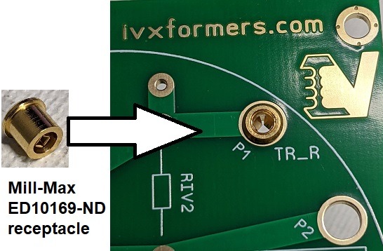

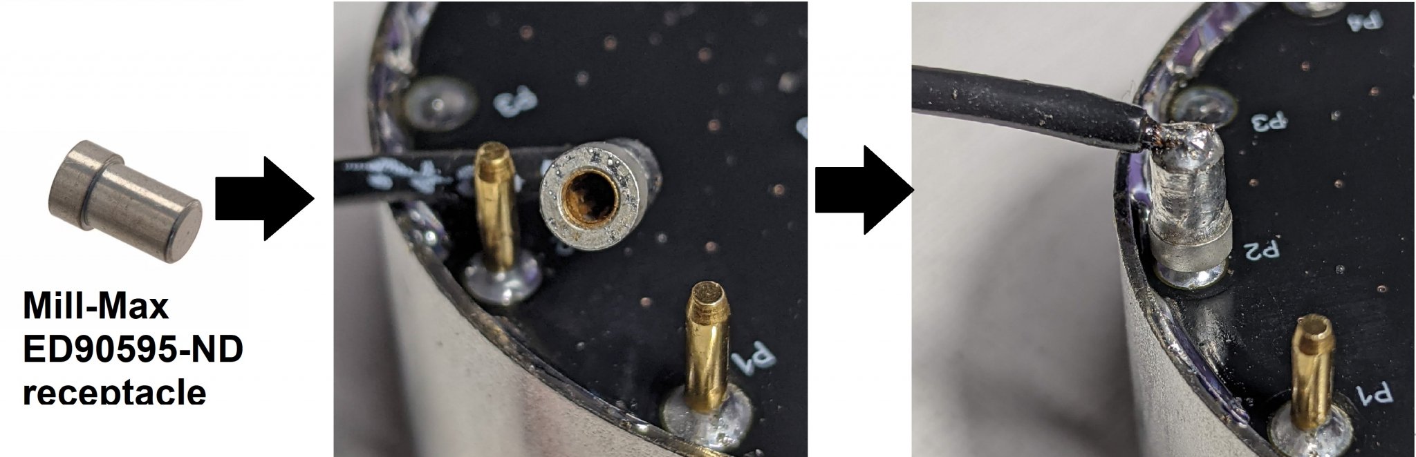

I have attached .step 3D model files for both D46 and D60 trafos in the first messageDo you happen to have 3D models of your transformer.
The simplest way to connect my transformers to your circuit without soldering directly to pins (sometime DIYers wants to try different types in quick manner for example) is to use receptacles from Mill-Max:
1-st way is using receptacles with the soldered to them wires. PN is ED90595-ND
2-nd way is using through-hole type of receptacles for PCB (PN is ED10169-ND)

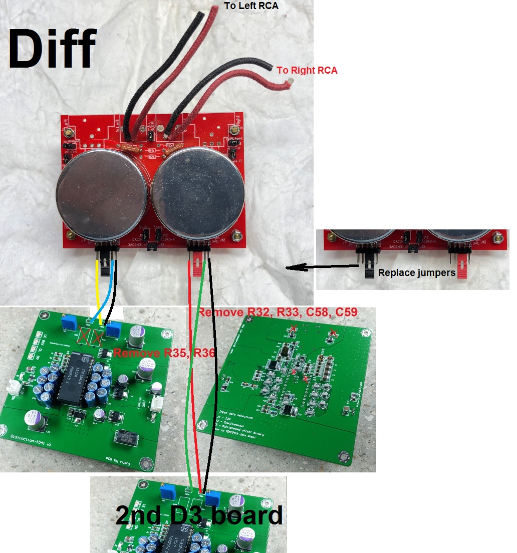

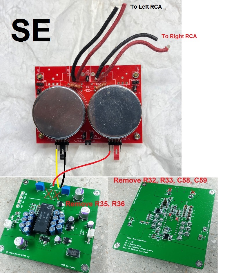

Hi bisesikKevin, I forgot that tubo's version was with two primary coils. That is why the previous drawing is wrong. That is why I was a bit confused regarding your wish to try DualMono setup. I think you mean the differential connection when talking about using of 2 D3 boards, right?
So, to correct the previous drawing, for SE mode (single TDA1541A) it is needed to connect this way:
For dual mono (differential connection) you will need to follow this drawing:
Regarding R1a, R1b, R2a, R2b - there is no need to use them as you have already the installed R1 and R2 resistors 11kOhm. R1 and R2 are the i/v resistors that replaced your R35/R36 resistors on D3 boards. If you want to try i/v resistors on R35/R36 places on the D3 boards, then the exact same signal can be achieved using:
11k/484=~22 Ohm

I had mentioned that I was using two D3 boards in a “dual/mono” configuration. This appears to have created some confusion.
You responded with a wiring diagram that assumed what I meant was to try a “differential” arrangement with the two D3 boards.
This is what confused me as I had heard the term “differential” before, but it always seemed to be associated with someone pursuing balanced (XLR) outputs for their project. That was not my goal as I needed RCA outputs.
I’ve come to understand that the “differential” application as related to the D3 is possible with Ryan’s V2 I2S to Simultaneous board (which I have) but requires there to be an inverted signal fed to each D3 board in addition to a normal signal.
I was NOT feeding an inverted signal to the D3 boards. As I understand it, this amounts to what would be considered “parallel” connection.
