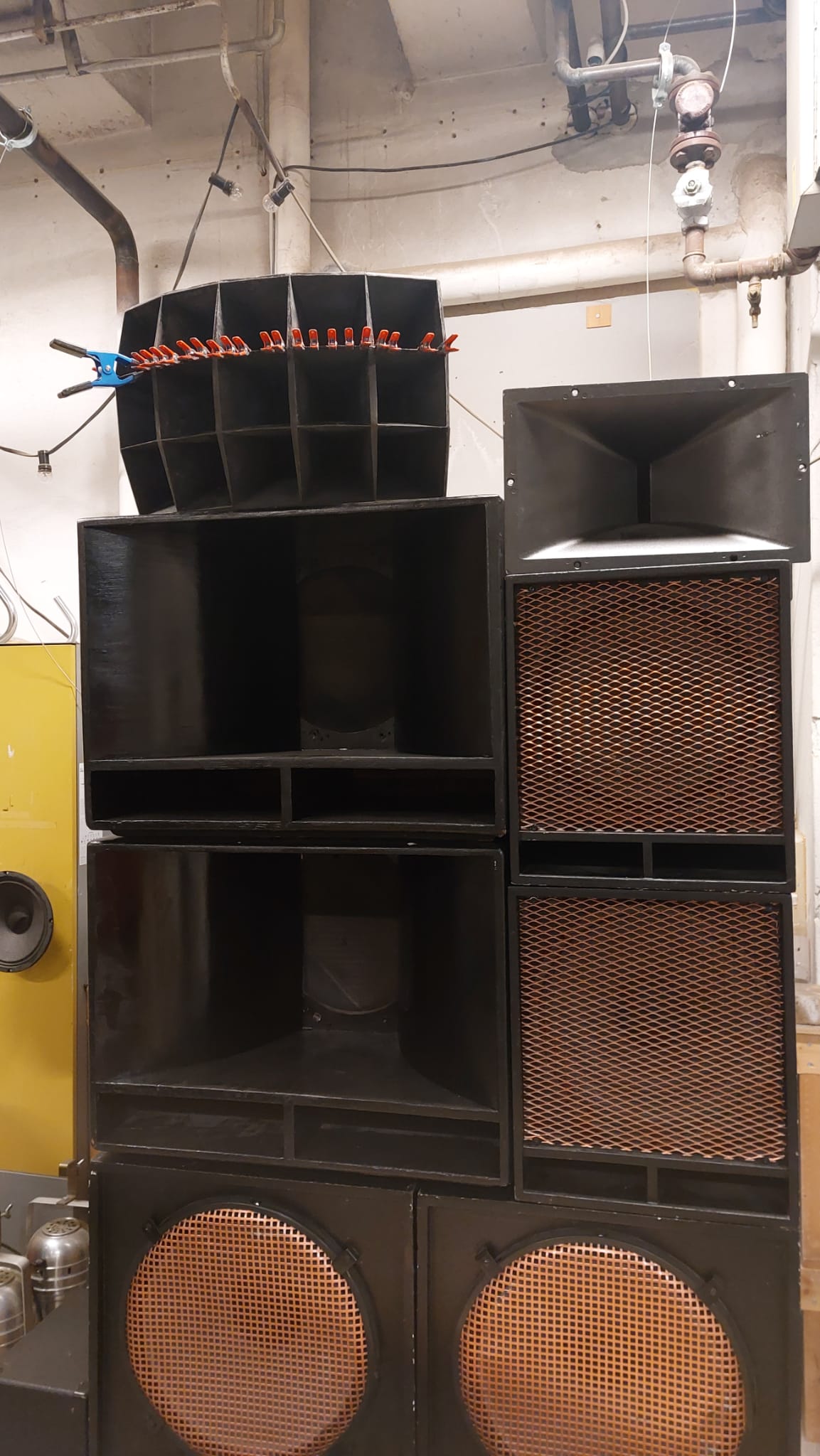

Right now I'm building two more Rhino mk3 scoops loaded with RCF LF18G401.
Soon we'll have a setup consisting of:
4x Rhino mk3 18" scoops
2x Altec 816
2x unknown name 15" mids
2x Thomann 10"
2x Multicell horns with Beyma Cp800Ti 2"
2x RCF 1" tweeters + horns
2x Behringer NX 6000D
2x Crown Micro tec 1200
Don't remember the name of the new 8 channel DSP
Standard 2 channel 31 band Graphic EQ
I'd like to get on e or two smaller amps for the tweeters to get everything tuned properly.
A bit of a Frankenstein system but it works really well!
