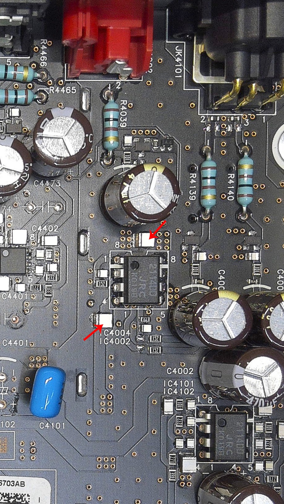

I have been experimenting with bypass caps and accepted the analogue board is small so I have used remote locations and low impedance connections and yes bypassing the filter caps on the analogue do make a difference to the audio, interestingly more so on the +12V than the -12V. No idea why, perhaps the +12v feed to the opamps is more critical
Anyway, I was wondering if leaving the wifi LAN antenna board connector disconnected would reduce any board noise if I never use it. assume there is no reason other than functionality to connect ?

Yes, the decoupling caps it make a difference indeed. They it improve the noise level at the opamps power pins (said in a simple way).
As usual the wifi circuit is not working when not in use. This is by design. It may work the reception part of the module, as it should know when a wifi signal is available from outside, for eventual further communication. If cabled network is chosen in Menu, then the wifi section is disabled (not powered, not RF signals). You can just disconnect the connector of the wifi module from main board, but in this way, also Bluetooth section will not work.

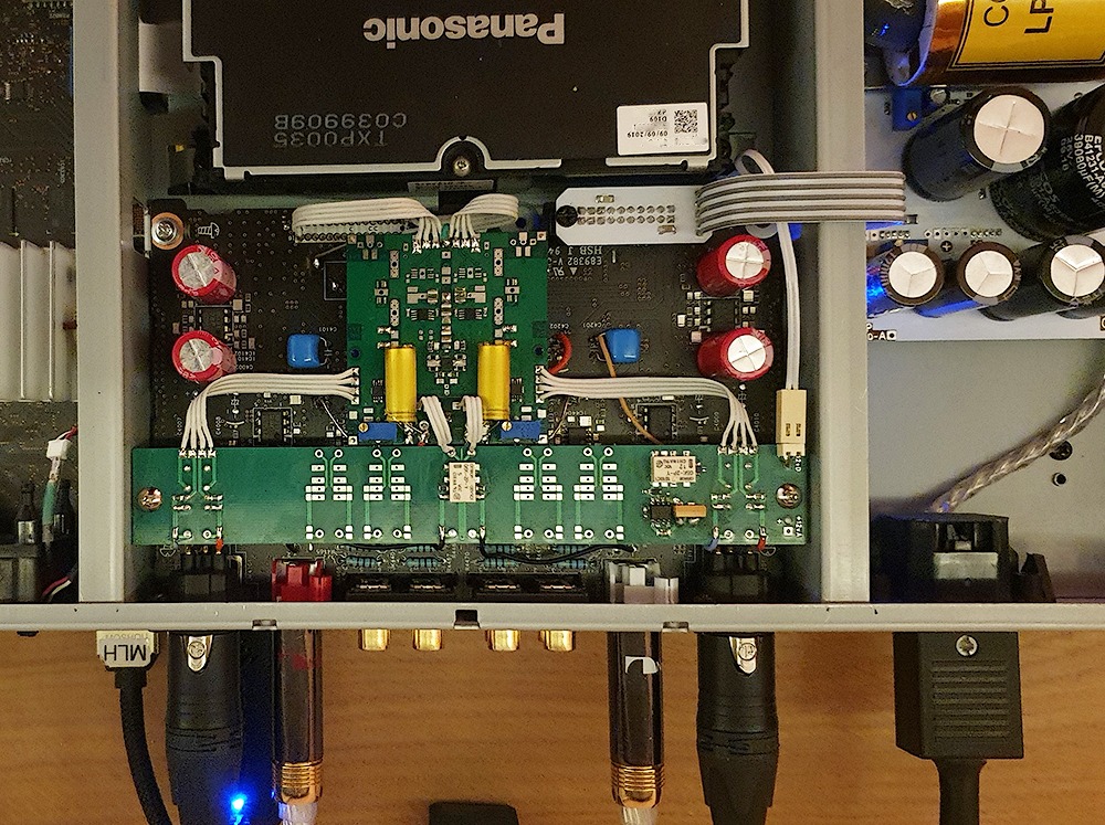

Well, after enough long time since I finished the upgrade of my UB9000, I was able finally to finish the upgrade of the analogue audio board as well. Added mute relays for XLR/RCA outputs, and replaced the original circuits with my fully balanced post DAC module, based on OPA1622 opamps. Also OPA1622 chip for RCA final stage. It sounds really good indeed. Important gain in all sound parameters, comparing with the stock board.

Yes, is right. The added analogue module is about stereo section (XLR/RCA). It is too complicate to do such modification for the 8 channels. Not enough place either. However, the relay mute module/board it fit for both MC and stereo sections (if fully populated).
