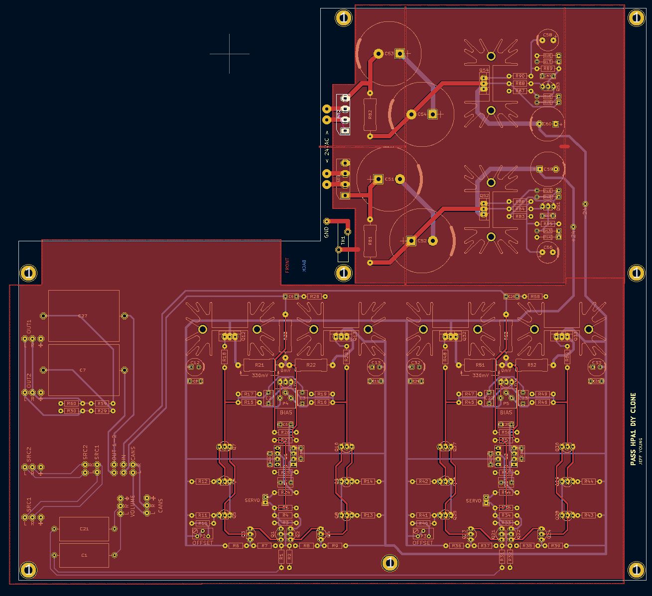

Have you already started the production of the board?Jeff, I assume you never designed a version without the front panel controls?
Have a great day!
Jérôme
I have Jeff's PCB on-hand, but I have not started soldering yet. Still easy (and inexpensive) to make a switch to a different (more suitable?) PCB.Have you already started the production of the board?
I am very proficient with soldering iron, and following instructions, but I am not a EE and have no experience with PCB layout... ;-)Yes, you could have made slight modifications to the PCB to incorporate your selector (Kickad).
My options are using a design as-is, or make small modifications with re-wiring.
@mokaonli - the PCB layout that you show above, was it tested / verified by anyone? Or did you slap it together to show me how it can be done?
If verified / tested - I would love to order this variant and have a simpler and cleaner build for sure!!

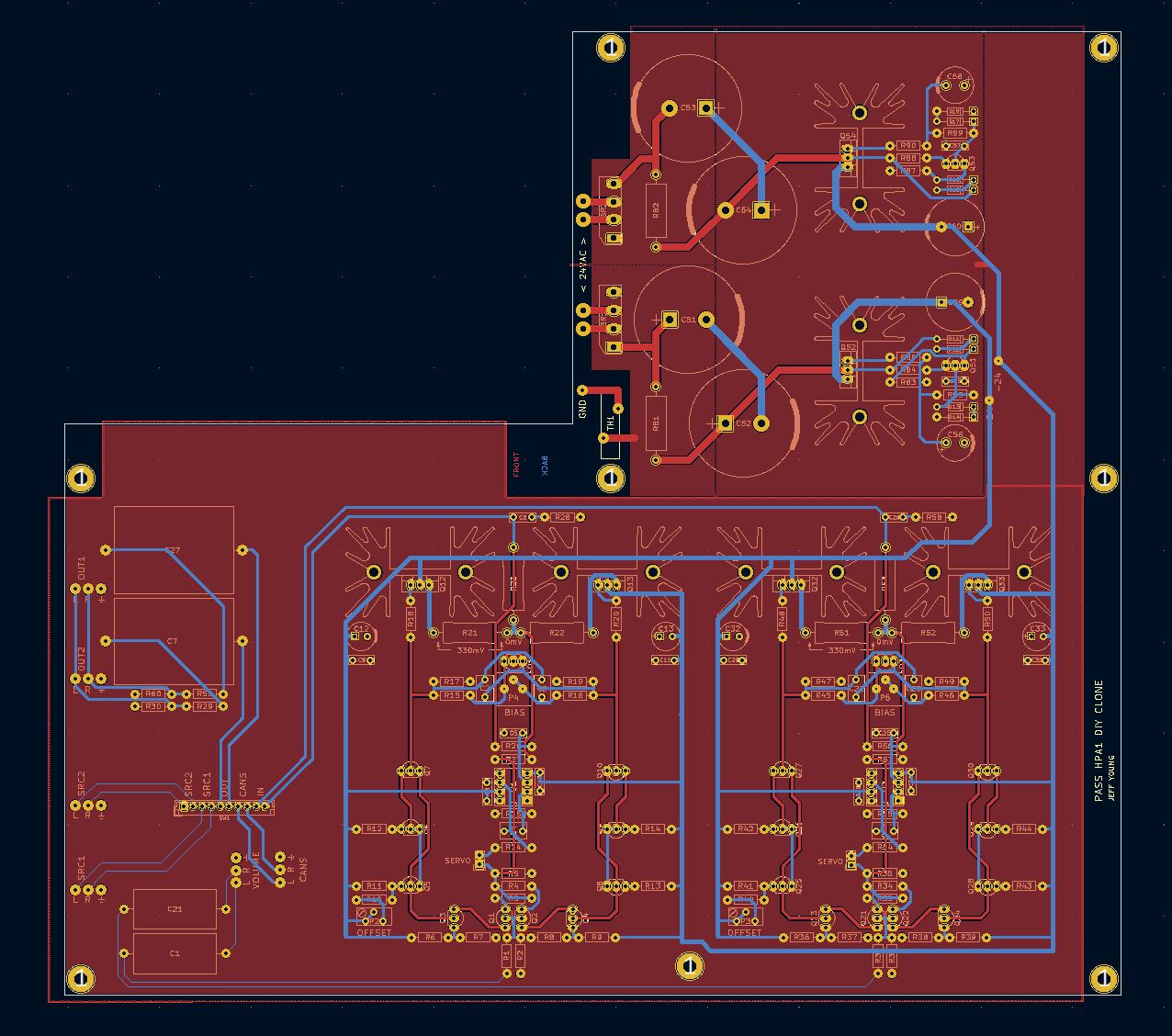

Hello,
A V2 version with pads for cable soldering. The first version was equipped with a JST connector.
For verification and real testing, all that has been done is the removal of the 12V power elements and the addition of pads to connect your cables. You just need to check the wiring, which is very simple.
Pay attention to Jeff's comment regarding the delay of the output. Without it, you will need to unplug your headset before turning it on/off.

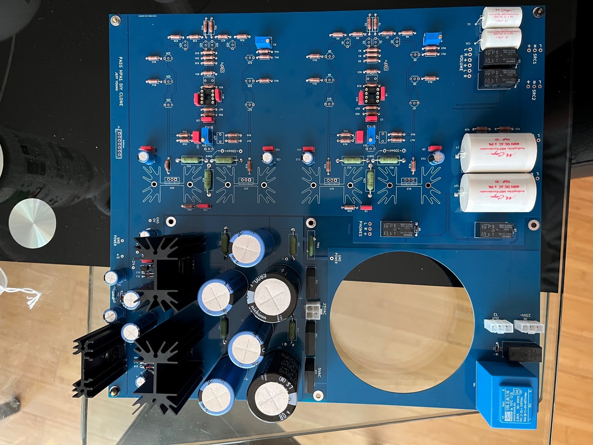

All the parts have been ordered and are on their way. The relay I finally chose this:
V23105A5303A201. After much consideration I finally chose AEC RJ-129 cinch connectors. I am still thinking about the AC connector, whether to choose a common one or this one with an emi filter.

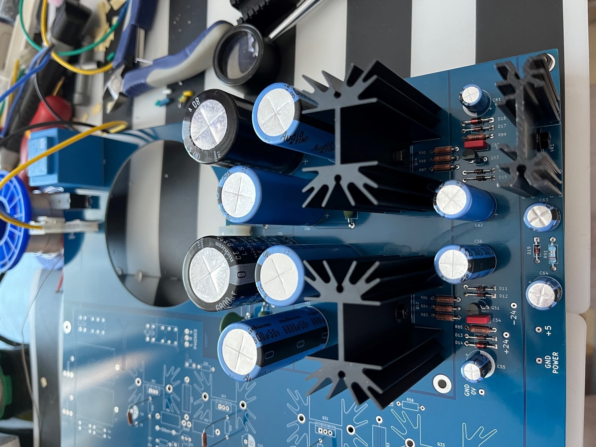

Hello all,
Here is the progress of the work:
I haven't received my Toroidy 2x25V yet, so I powered it with a 2x23V transformer I had in stock. I have a stable 24V output with a small load to simulate the amplifier.
I have modified the design, integrated the 5V transformer into the circuit, and now I only need the 1uF capacitors to test the whole system and program the ARDUINO for the inputs/outputs.

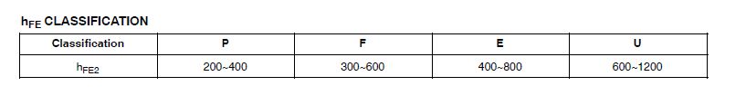

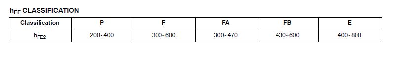

Which types (hfe) would you recommend?
Mouser and Digikey only have "F" from the KSC1845.
Mine are around hfe 400
Unfortunately, I only have "FA" from the KSA992, which are a little lower at around 350
Do you think that fits, or should they be better matched (P - N)?
Then I might have to get some KSA992 F
