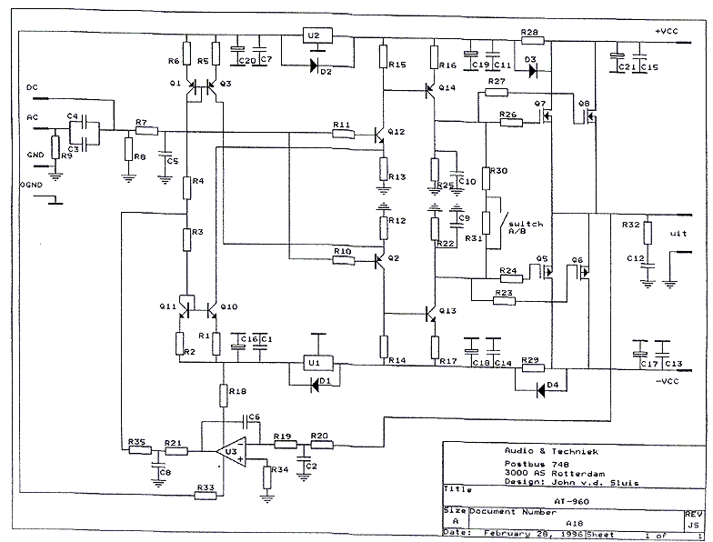

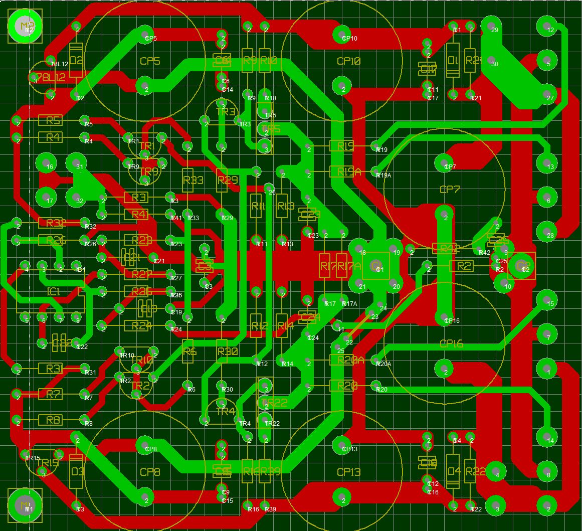

PCB for the HAWK A18 amplifier (+ FETs if required)
I came across an old A18 amplifier with one defectice channel. After repairing the amp I found that the sound was open and transparent as well as the sound stage wide and in 3D.
As this was with my nearfields I use in the studio I wanted to go on a n adventure to use these for my Orion and designed a PCB so I can build 8 channels.
The beauty of these amp is a high quiescent current and about 30W output without feedback.
You can find the schematic idea on the web.
As I'm planning to build 8 channels and 2 reserve I could order some more if there is interest. The price would be around 7 euro's per channel for the PCB.
2mm FR4 and 2Oz copper.
Do not worry about the 2SJ162 and 2SK1058 as I have plenty NOS parts I only want to sell with the PCB's.
The 78x12 regulator may oscilate when using the indicated 2200u cap on the output. Oscilation disappears when reducing the cap to 47u.

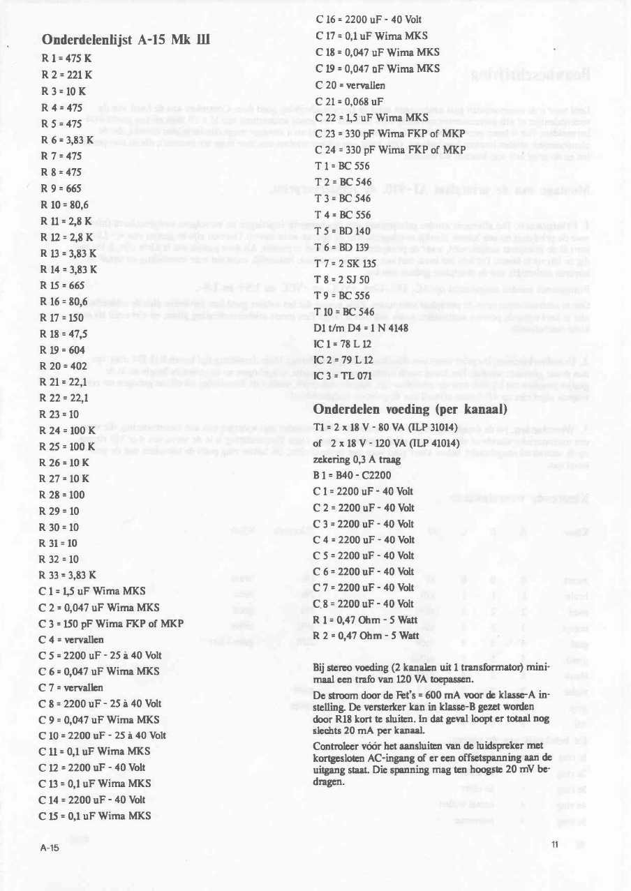

Another year later, 1991, A&T came out with an even less costlier design, the A15, valves exchanged for a complementary differential input stage with 5 cents each BC546/556
Couple of years later he beefed up the A15 by doubling the number of output stage devices and adding a class a/b switch (as in the A80)

The A18 reminds a bit of the K.Lang amplifier : 2 pair Lateral MOSFET output stage and high quiescent current.
I've assembled a number of the A&T amps and agree with Tarasque, good sounding amplifier for the cost/ease of building (a great choice for active purposes)
According to the info received from John, there is also an A19 with more refined stabilized power supply for the first and second stage separately.
I could not really hear the benefits of this and my favorite is the A15 MK4 with double fets
(Basically the A18 MK2)
