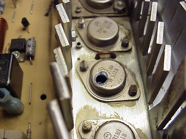

This is what happened to a CS800x.
The blower got defective, the whole thing heated up and the battery of output devices blow up.
How is that CS400 going BTW?
/Hugo 🙂
