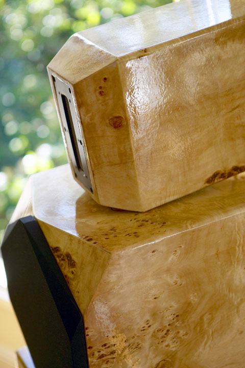

The sound is great, I am really happy. They are just more pleasing to the eye now while the veneering is done.
I tried the very same Behringer set up, minus receiver and I likied it a lot. I am planning on ordering Apex remote control unit in order to do atenuation after all the processing is done. What a blast of possibilities, for such a low price. Just digital EQ is miracle. No noise and distortion added at all, unlike typical analog EQ.
Good luck with youur project.
