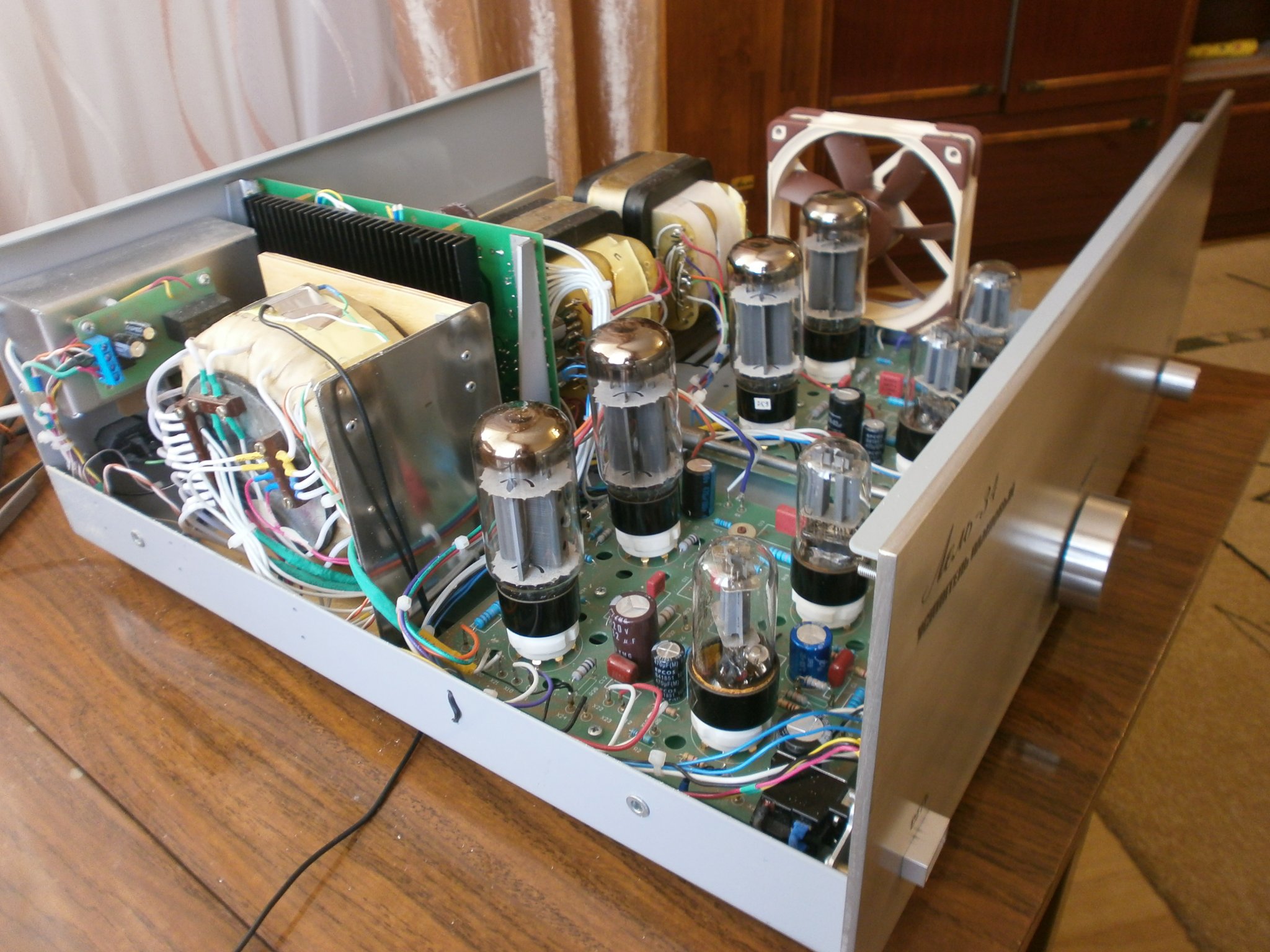

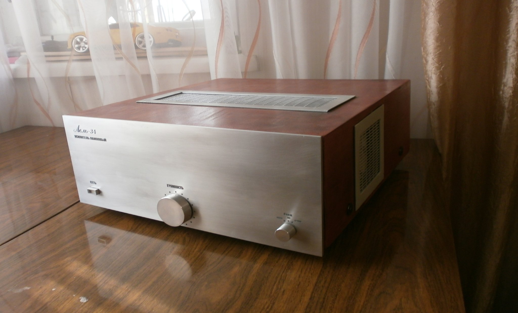

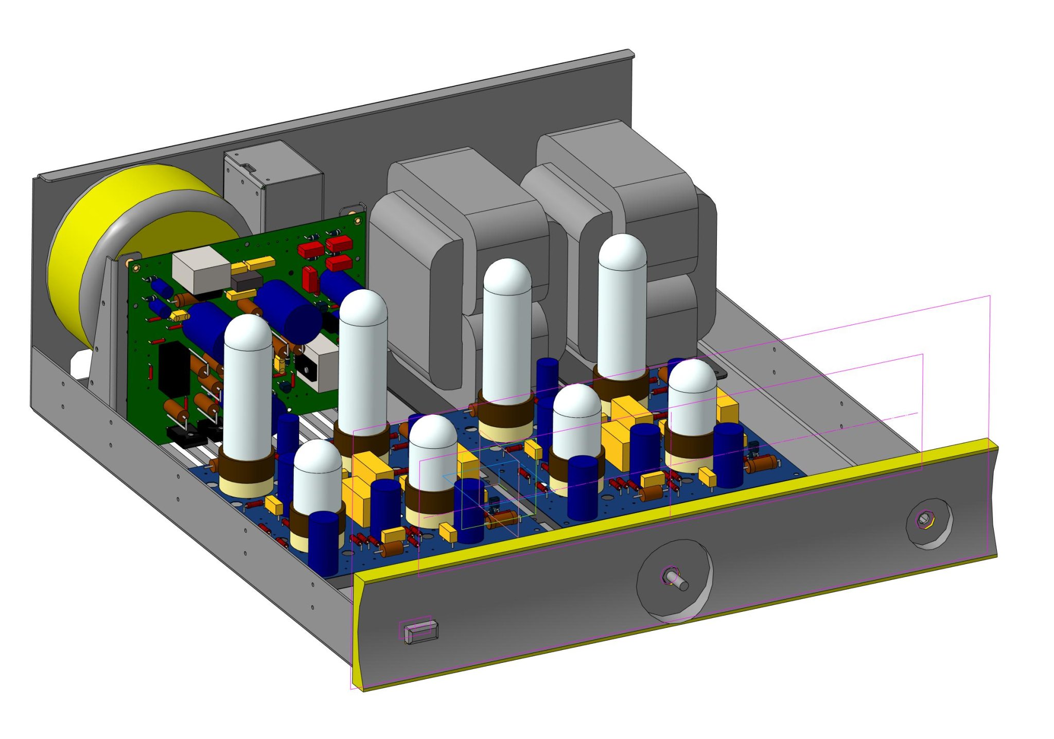

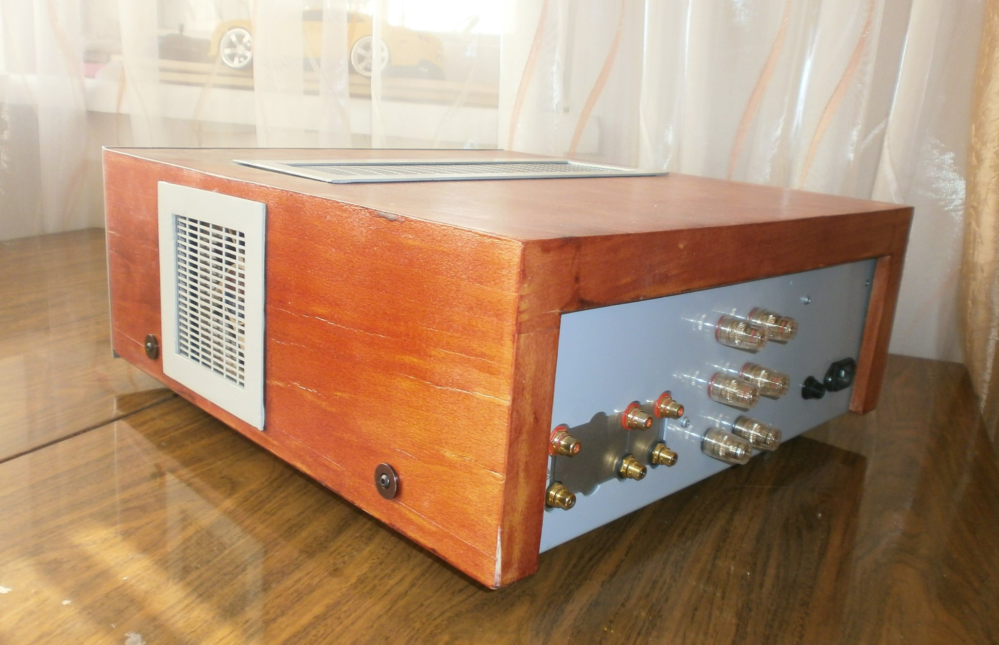

I want to show one of my latest works with tube EL34

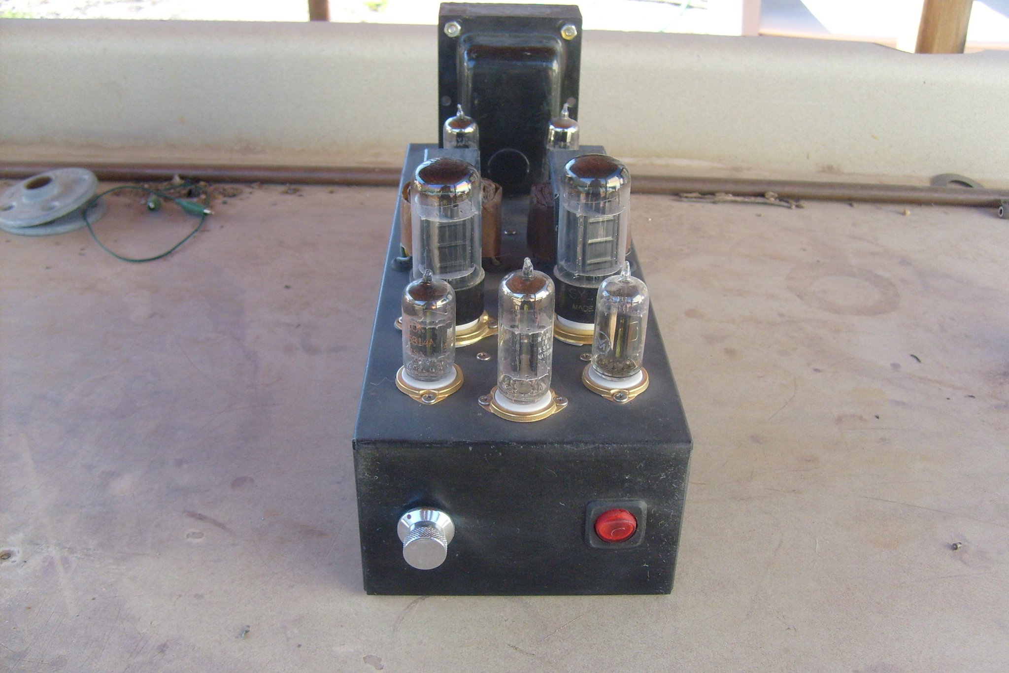

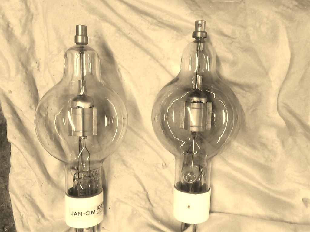

I have a lot of tubes and Iron along with plenty of components. The input is a 12BZ7 and half of the 12AU7's are used as followers into a 12AU7 Cathodyne. The output tubes are 6BL7's. I use 2 rectifiers( 6X4's) split so I effectively have 2 power supplies. The other version uses 6X5GT's for the rectifiers. I really like this little amp. The highs and mids are really clear and present with no harsh edges and it will reach down in the bottom just fine. I actually have 7 amps within reach of my computer. I like to build. I will post more pictures as I can. Another favorite is my SE EL34 with a 6SN7 input and a 5R4WGBY rectifier. That amp can be switched between Pentode and quasi Triode mode. Any amp I build that has multi-grid output tube, I always make it switchable. Another one I really like for it's size is a 6CG7 input/follower going to 1 of 3 tubes. 6K6GT, 6Y6GT and 6W6GT. It could also use a 6V6 but, I really don't like that tube. I am retired, a Widower and I live alone so, my time is my own and I have collected a lot of stuff. When I get a whim , I act on it. I keep looking at this matched pair of 100th tubes and I really want to build an amp with them. The only issue with that is for those I would have to buy a set of output transformers and I still have 2 other amp projects with chassis cut and all major components mounted. I guess I will finish those first..

Jamiemunz,
Are those Transmitter Triodes?
Check out Shishido's unique circuit, that uses a single ended non-air-gapped interstage transformer.
The driver current of the driver tube's primary current x the primary turns is the same as the output tubes quiescent grid current x the secondary turns.
A lot of Transmitting Triodes work best with quiescent grid current.
With the two DC currents in opposite directions, there is no quiescent magnetic field in the interstage transformer, so there does not need to be any air gap. That makes it easier to use smaller laminations, tigher coupled primary to secondary, less turns, and lower leakage inductance from primary to secondary.

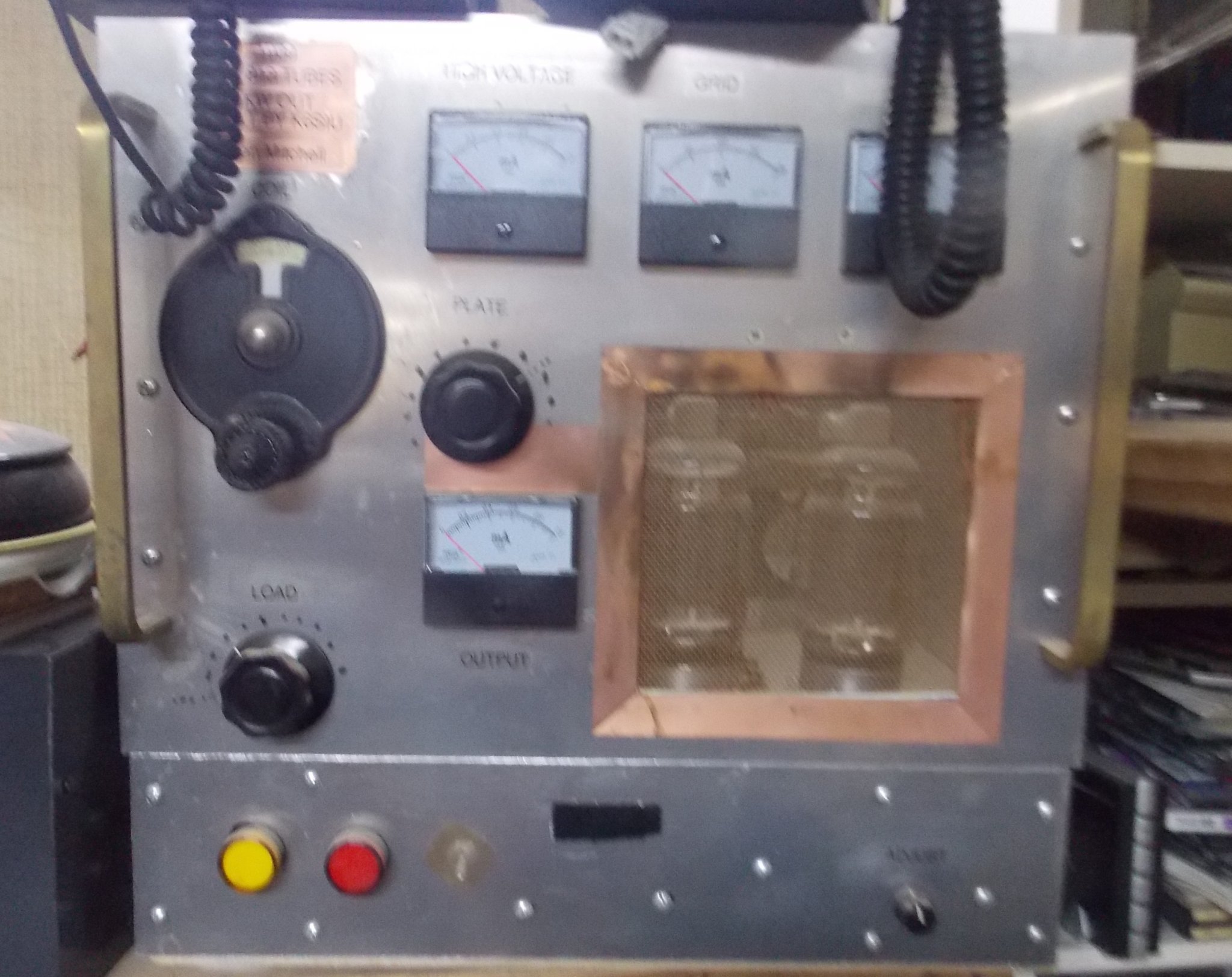

I have seen a design using these tubes.One of the biggest issues with these tube in Class A SE is that you have to have a high voltage. Like at least 2000 Volts. If you look at the curves when the B+ starts to approach 1000 V the tube will not even turn on without a positive bias on the grid. And then there is the problem of getting a transformer made. The breakdown voltage has to be close to 4000 V in order to survive that high a B+ and since Peter Dauhl is no longer around, I don't know where to find one and I draw the line at winding my own transformers. I will check out Shishido's work. The other real big issue I have with these tubes in a Home audio amp is although I live alone, I do have cats around the house so I would , at the least, have to encase the amp in glass. I have a number of Linear Amplifiers I have build for my HAM Radio station but, that's easy. You want a R.F. amplifier to be shielded. The picture is the Little amp. That's a pair of 813's running at a little over 1850 Volts. It does a cool 850 Watts output. That's just the RF deck. The power supply is on the floor and weighs over 100 pounds. Again, that's the Little amp. The BIG amp is a pair of 4-1000's running at a B+of over 4000V. The output is over 3KW. Yes, that is over the legal limit but, it wasn't at the time it was built and actually there was a reason it had to be powerful. I was into a form of communications known as SSTV or Slow Scan Television. It is a 50% duty cycle mode of operation. So, in order to send signals around the World at legal limit, it had to be able to do twice the power to run sustained legal output.

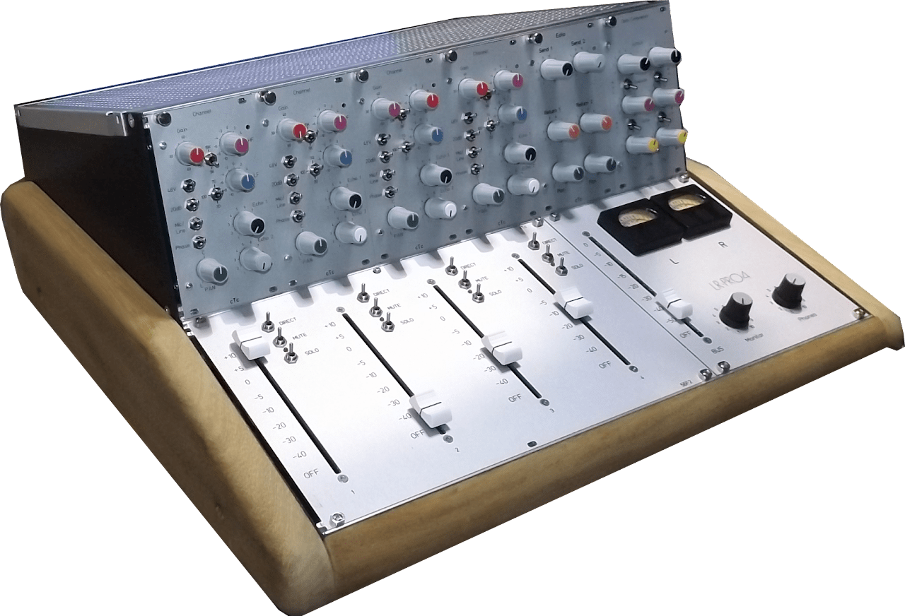

My most recent four channel all tube mixer build shipped to a customer in Pasadena:
Four mic pre channels each with stepped gain control, stepped HF and LF EQ (three frequencies on each band) , phantom, phase, pad and mic/line switches, pan and two echo sends. Echo return module and twin channel bus opto compressor module. Fader section includes mute and solo switches; faders by ALPS. Headphones amp is (unfortunately) semiconductor.
Meters by SIFAM. 18 tubes (12AX7 and 6922). External power supply.
