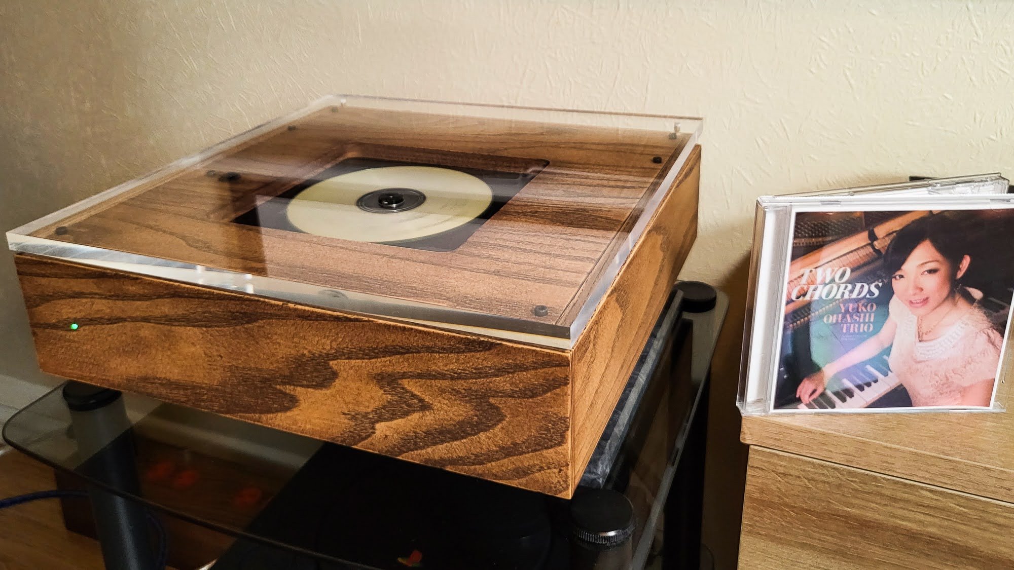

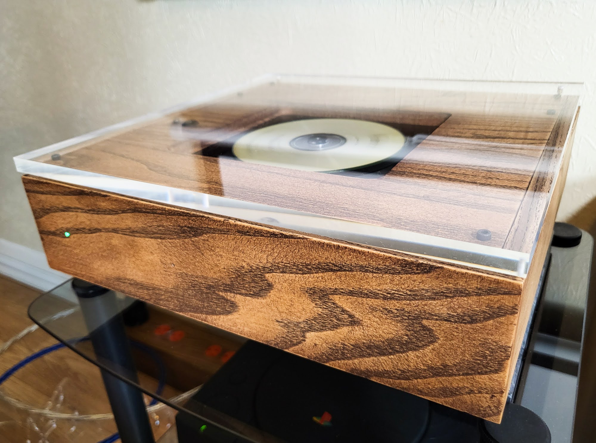

Playstation as CD-player

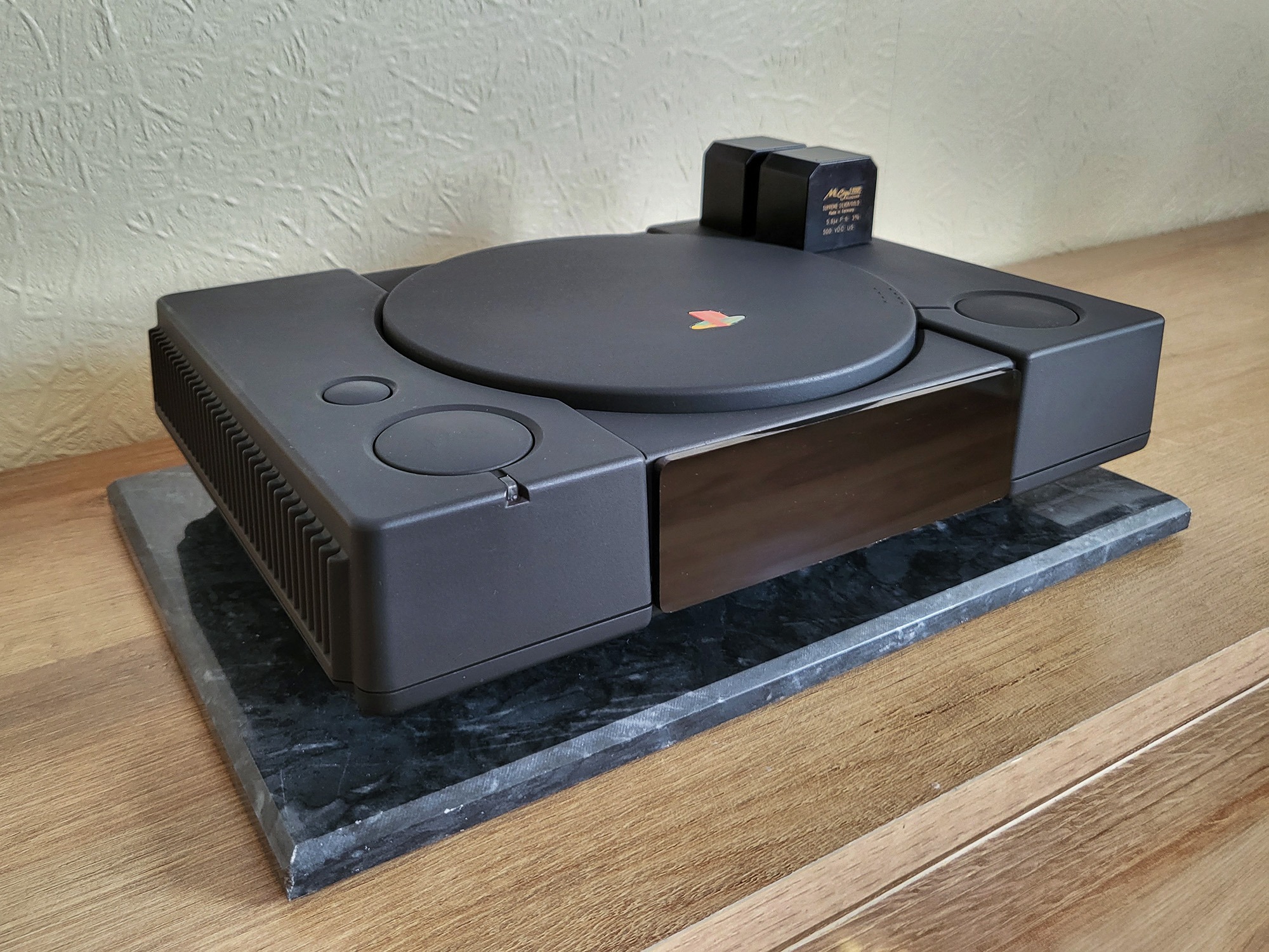

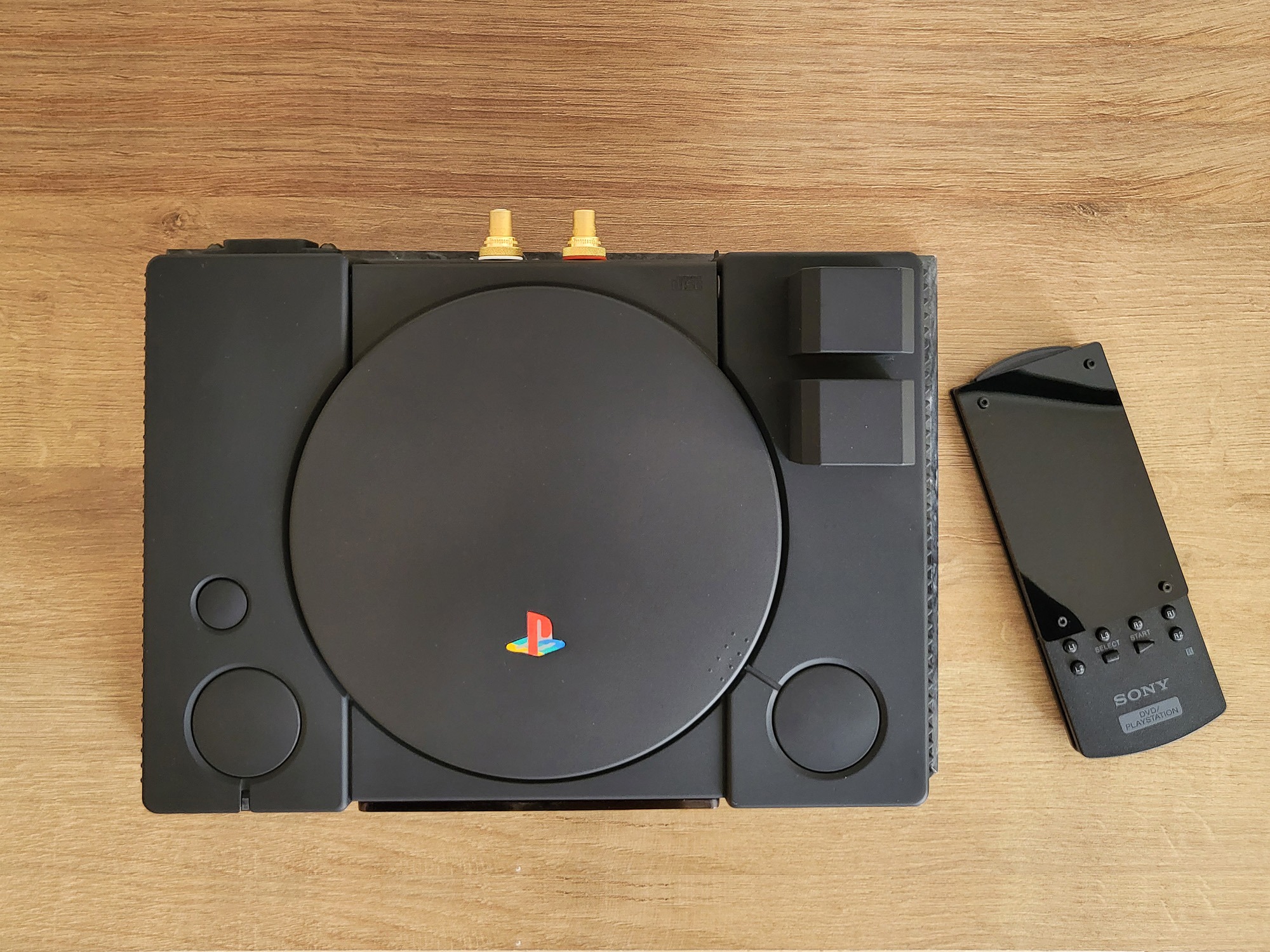

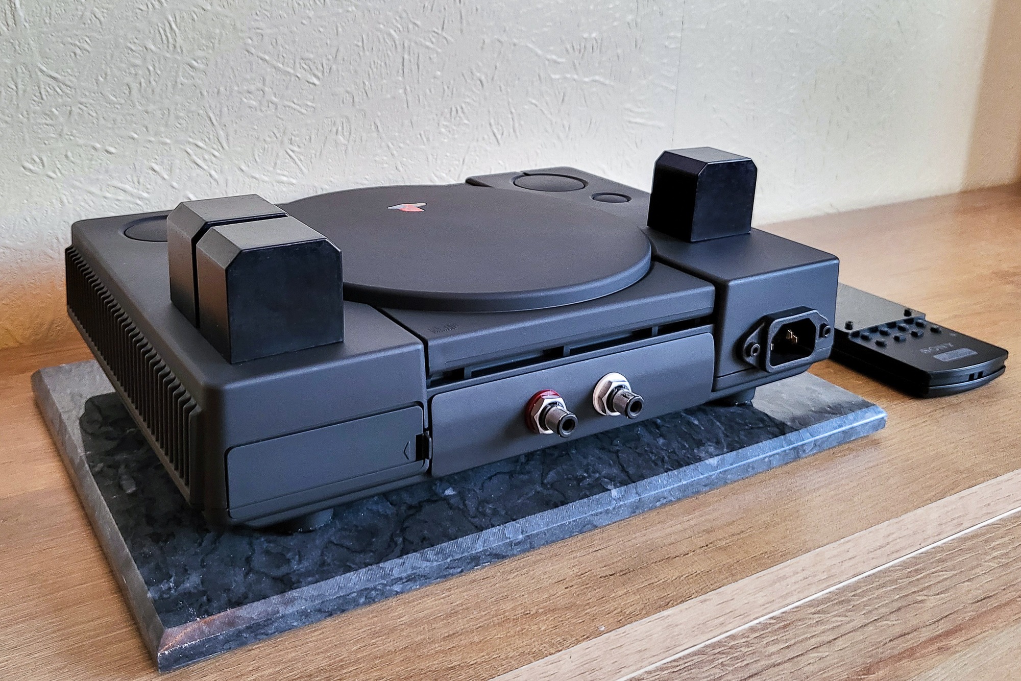

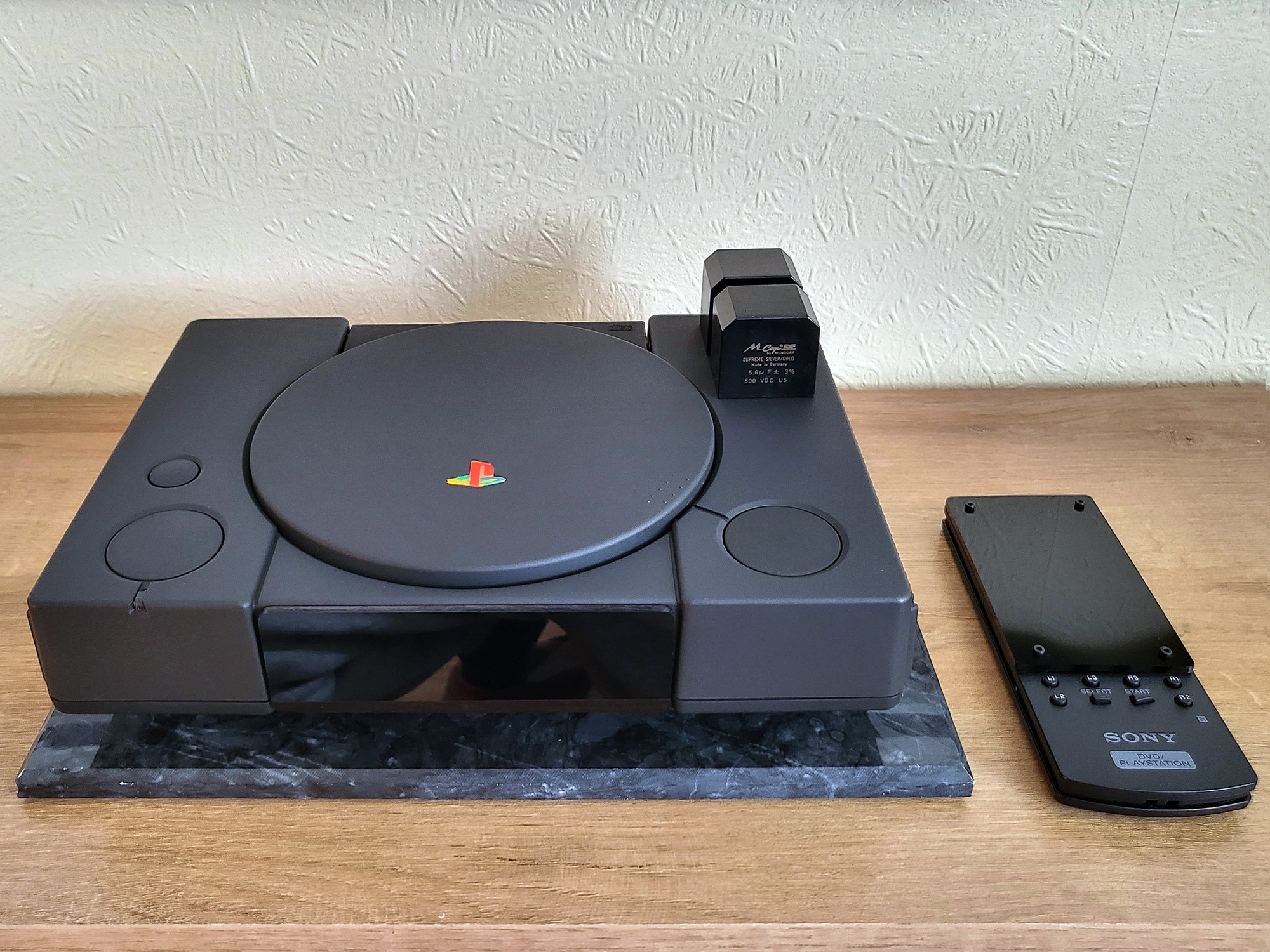

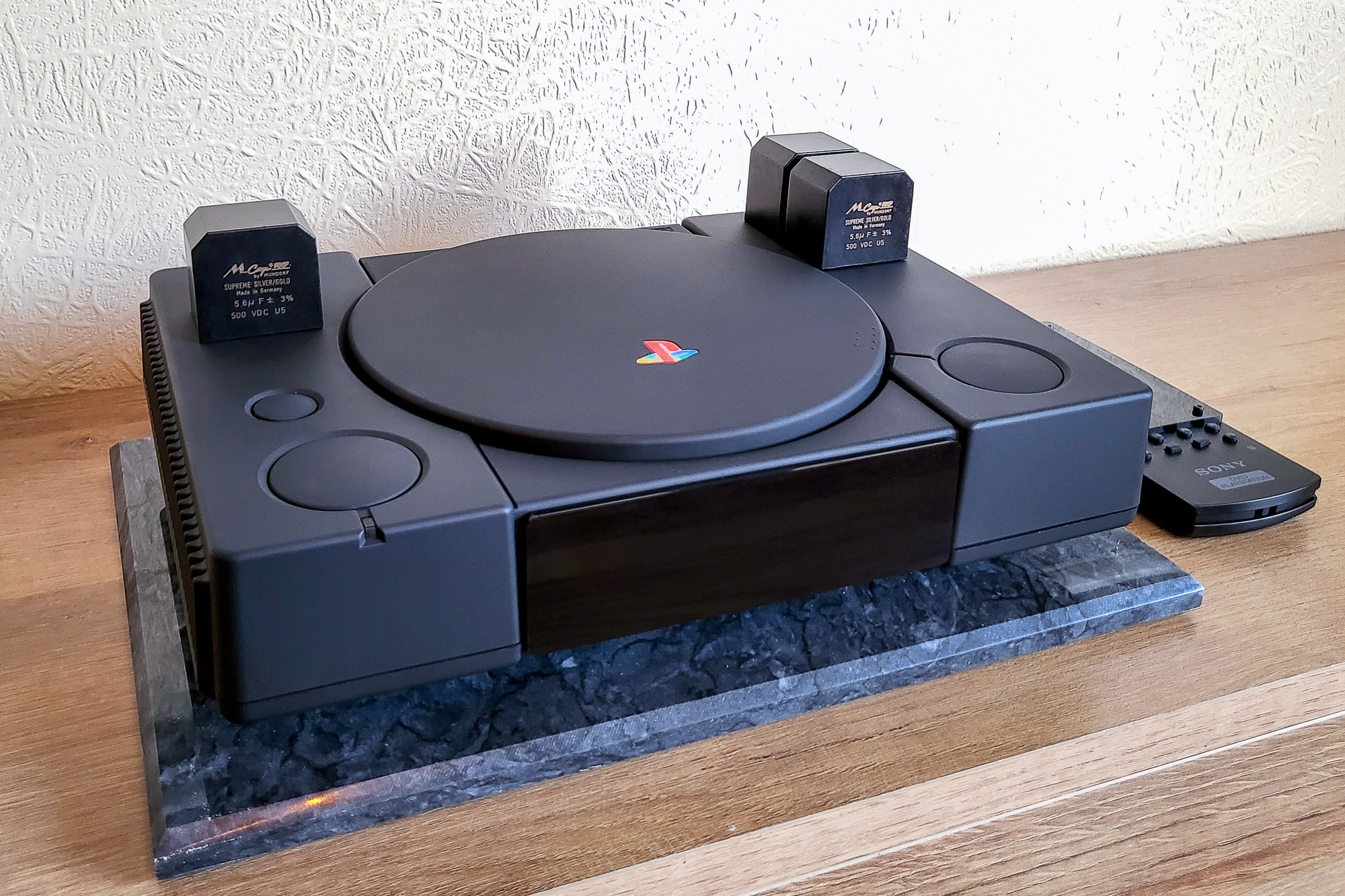

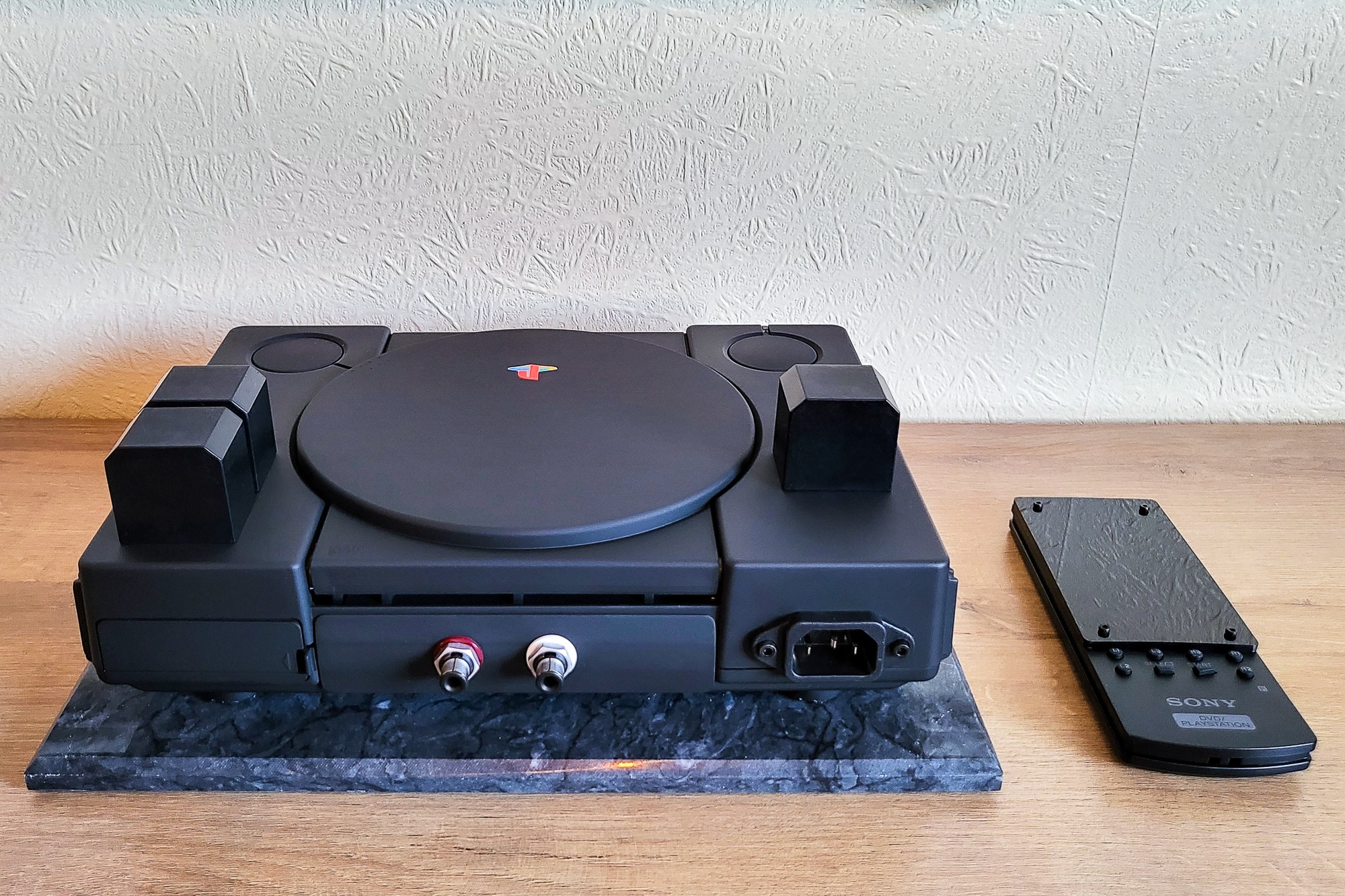

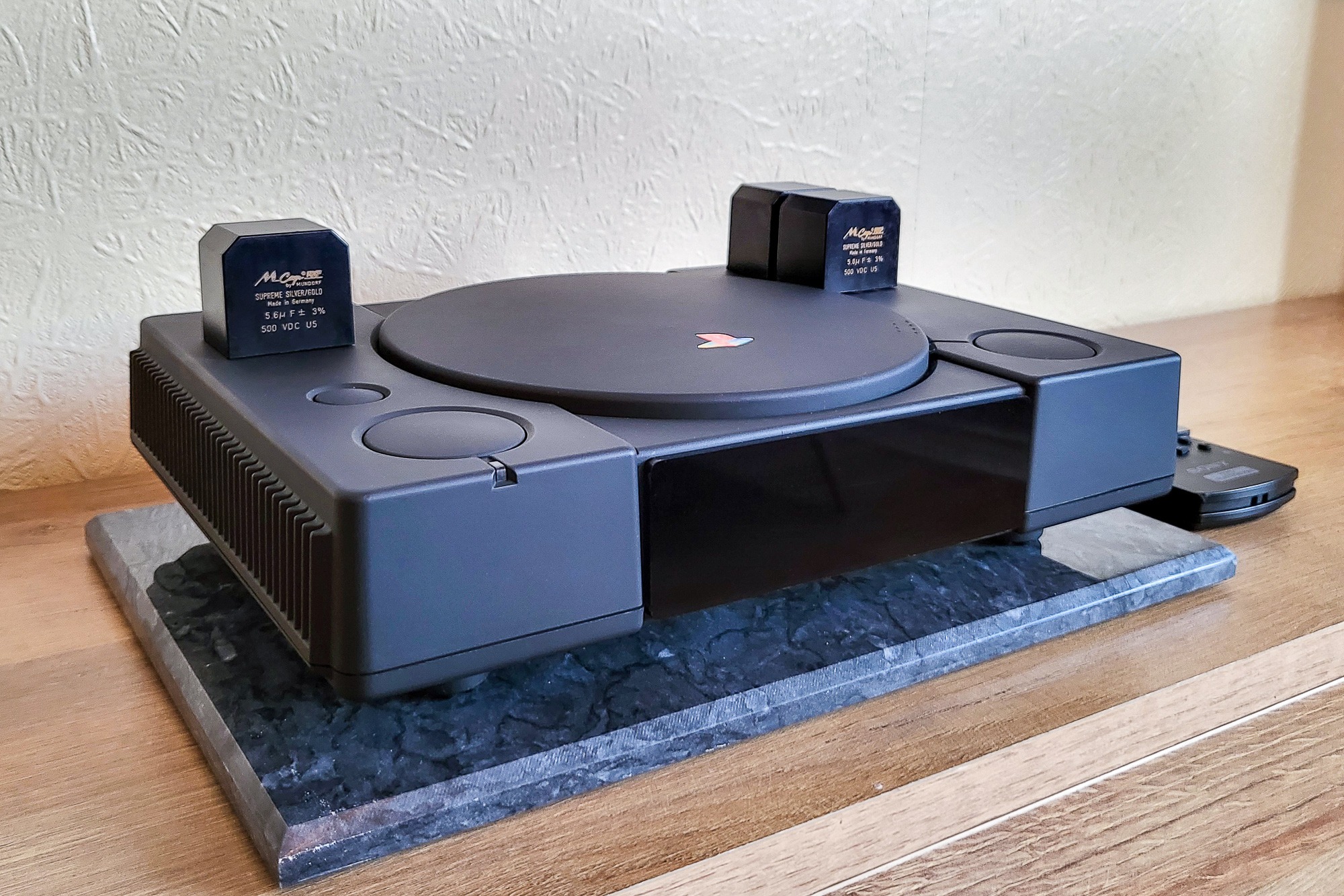

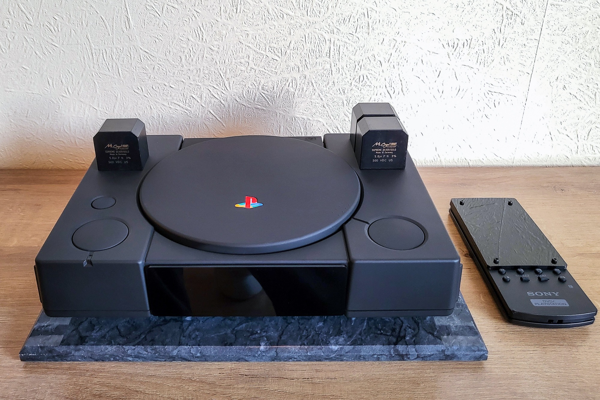

It turned out something like this

By the way, it was noticed that increasing the input HV capacitance neutralizes the influence of the power cable. That is, you begin to hear not the power cable, but the capacitor presentation itself. So I would not recommend greatly increasing the capacity, since you are depriving yourself of the pleasure of using different power cables.
If laser generally reads normally, but sometimes gets off track, try increasing the gain voltage (from 1.7V to 1.75-1.78V) with same offset on 1.82-1.85V.
Overall I would stick to a slightly higher gain 1.73-1.75V.

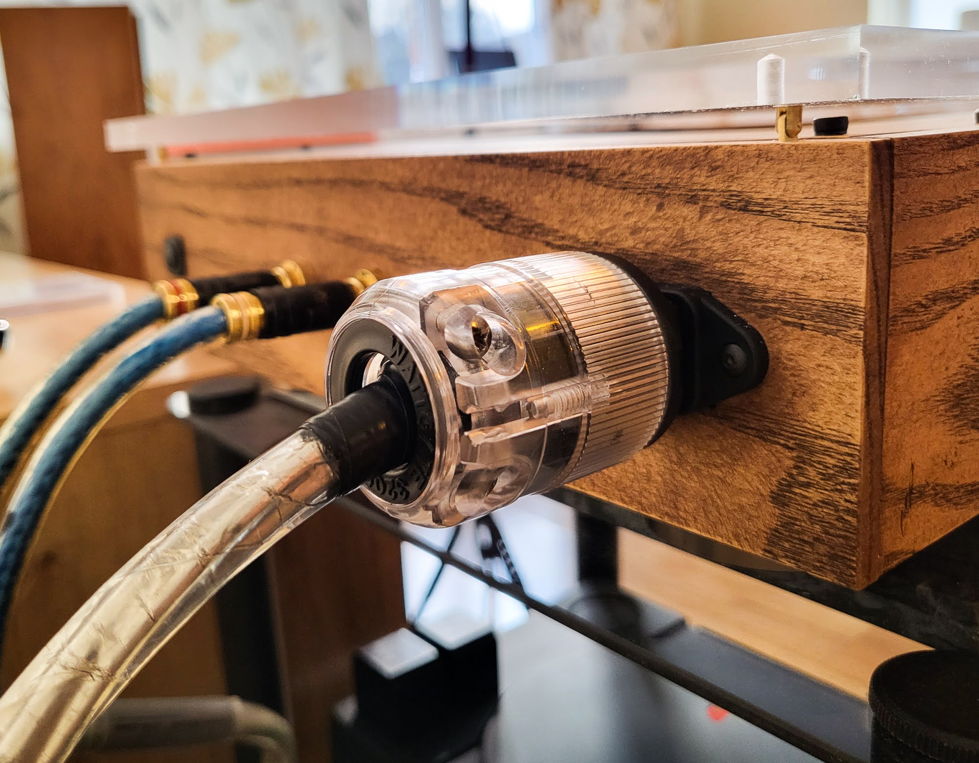

Also, for those who want to equalize the tonal balance, I recommend changing the cross-section at the power input from IEC to power supply board. It is recommended to use at least 20AWG conductors for neutral balance. To achieve lower tonal balance (downward bias) with extended bass and lower mids, 16AWG is recommended.

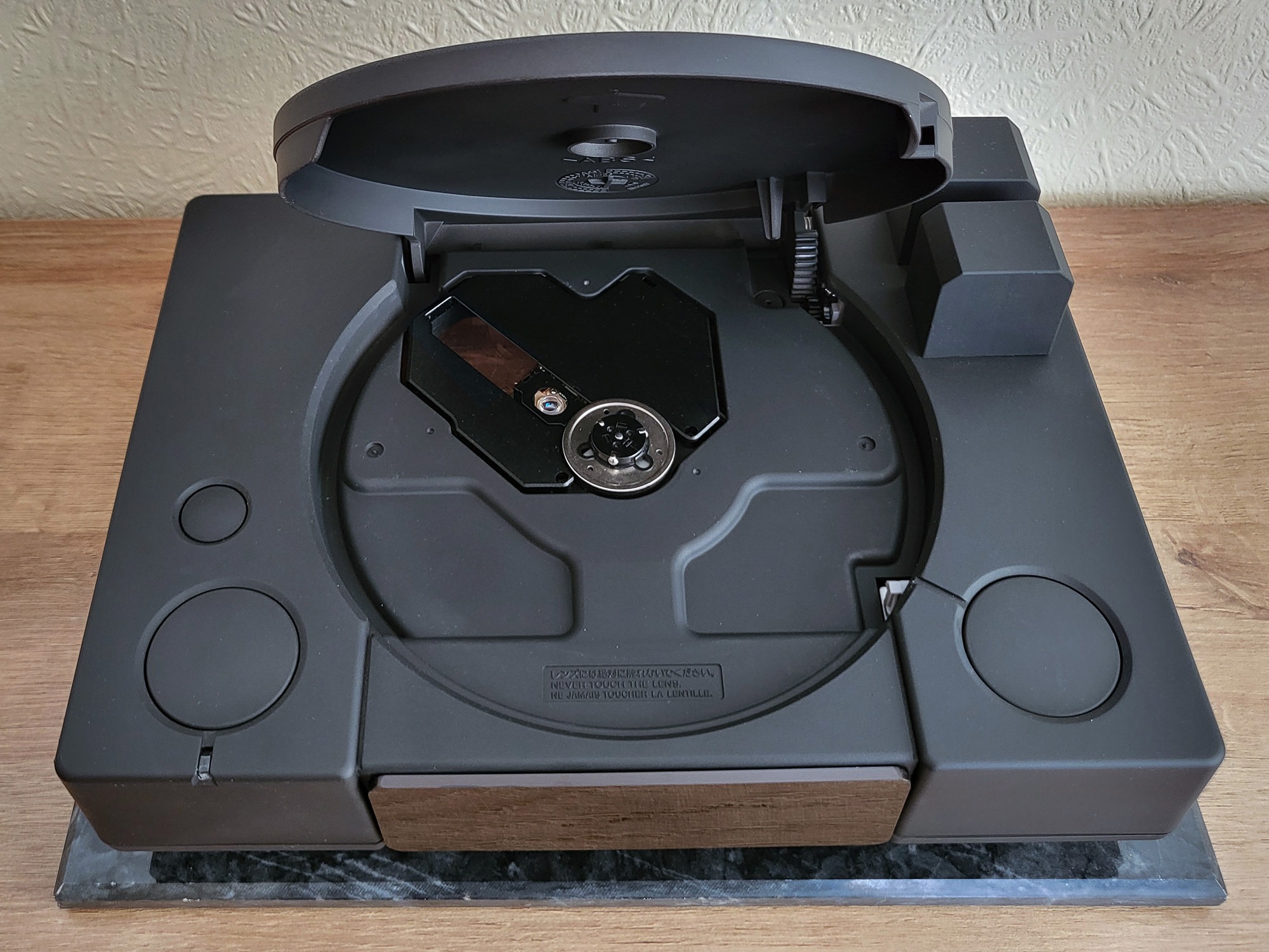

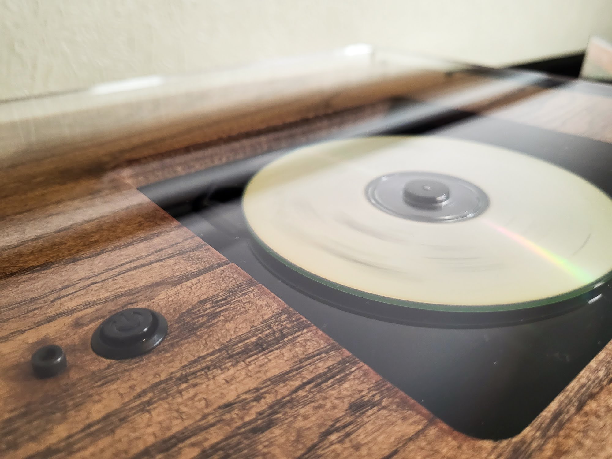

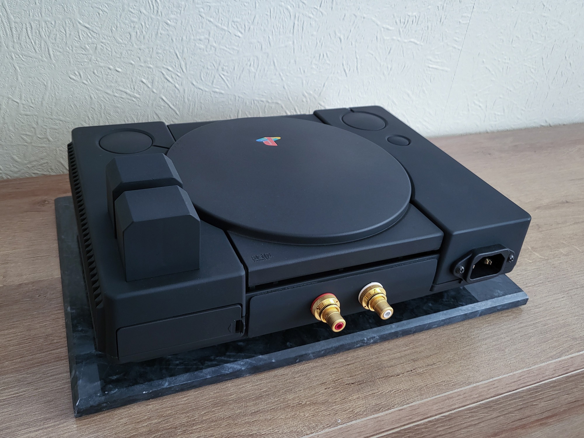

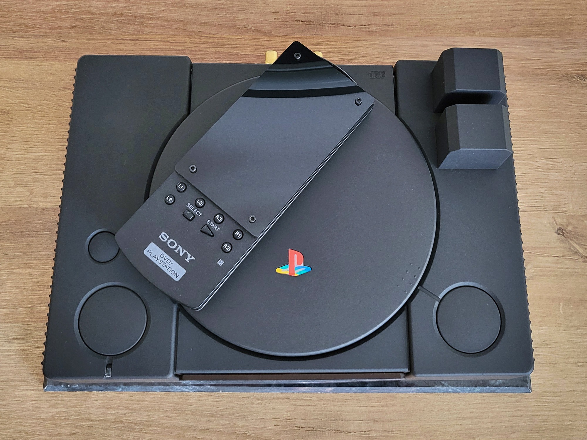

Short list of modifications:
  • Case painted matte black
  • Chassis coated with copper foil for improved shielding
  • The power supply casing is covered with copper foil and additionally grounded to the main shield
  • The input socket was replaced with Furutech copper gold plated
  • Power wires replaced with Neotech UP-OCC multistrand copper and copper silver plated wire, also Neotech UP-OCC copper solid core wire
  • The buffer cap has been replaced with Mundorf MLytic, also bypassed with Mundorf Silver-Gold cap
  • The power supply has been upgraded with capacitors of the following series: Wima MKP10, Nichicon KA, Nichicon ES Muse.
  • Factory fuse replaced with audio grade fuse
  • Factory audio video connectors removed
  • The analogue part of the output has been removed
  • Signal wiring replaced with Neotech UP-OCC silver solid core wire
  • Blocking capacitors have been replaced with Mundorf Silver-Gold cap
  • RCA Connectors replaced with KLE Innovations
  • Kiwame resistors installed
  • Installed Duelund ground wire
  • The remote control transmitter is integrated into the case
  • Decorative front panel installed
  • Damping supports replaced
  • The remote control has been modified

I accidentally purchased this paint (Halfords Camouflage Spray Paint Black 300ml), and I liked it so much that I have already used many cans, and I think I will buy more in reserve while they last. This paint is unlike any matte black I've seen before. It has a very interesting shade.
It absorbs light, but isn't so charcoal that it looks like a stain. It has a soft touch effect. No primers are required.
But it is still advisable for you to use fine sandpaper (400+) before doing this if you want to achieve a perfect surface without scratches.
Also (due to the soft touch) it like scratches, grease and anything that can damage the coating. But if you use it responsibly, it is difficult to damage it.
It's worth it.
You can also reapply layers on top of previous ones without any visible differences. In other words, refresh the coating (so it’s worth having a spare one).

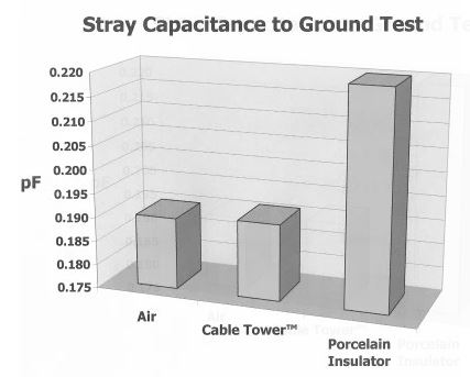

Hi mfgroup,
Can you explain the 'cable lifters' and perhaps what advantages they have over placing cables on the floor, like I currently have.
Thanks Richard

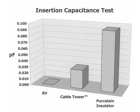

Hi, Richard. I know that many here like numbers, so I will provide data from the manufacturer.
It seems to me that the whole point is in the additional capacitance, which works as a filter (together with the inductance and capacitance of the cable itself).
On my own behalf, I’ll add that a cable lying on the floor feels dull and indistinct, more blurred, and loses dynamics and its airiness.
Accordingly, decouplings towers give good resolutions improve clarity, focus, and remove some blurriness. Peak sounds in the dynamics are handled well, and high frequencies are separated very well. An even bigger advantage is that they normalize the tonal balance. In general, this is what good decouplings should do.
The funny thing is that it even works on cables that are just hanging in the air (although this is the best option if there are no decouplings). Apparently the point is that the cable under its own weight has nonlinear stresses along its entire length due to weight or touching something. The uniform arrangement on the supports compensates for this. And yes, again, this sounds funny, but they also improve the sound of a cable hanging in the air (I mean those cases when the cables are twisted into rings or something else to prevent them from touching the floor). Of course, this does not work on short cables that do not require supports.
