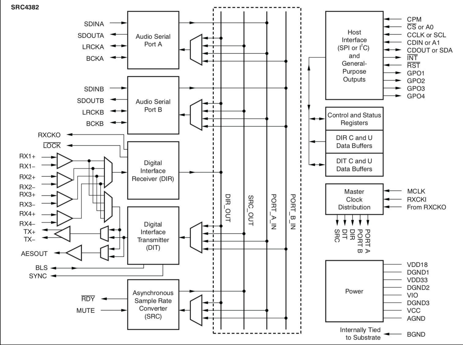

The DSP section for crossovers Eq and room correction is really superb.... But the A to D and 6 channel DAC's are not great. There is no digital input, only analog, so all sound sources are compromised both on input and output.
I am looking for someone with PCB trace cutting skills so I can access the digital input and digital output and allow me to use my own high end AKM A to D and 6 channel AKM DAC's.

Seems to me that you'll need more than just a cutter. Said candidate will need to know where to cut and how to add digital i/o in some form of enclosure. As an example, if you tap in after the onboard ADC output you will need to need to add an SPDIF receiver for the outboard ADC.

Hi Alex-San,
I recommend Just cutting the I2S line from ADC and inserting the TI SRC4392 between them. You can use the S/PDIF Digital Input and Original ADC Analog Inputs after modification. Some I2C control requires but it's not so difficult. A small PIC uP and the source selector switch are enough for your purpose.
There is considerably more involved than trace cutting. I2S typically is only good for a few CM of length. Also there is LVCMOS I2S as opposed to LVDS I2S. Moreover, MCLK is not an I2S signal but proper management of clock domains is critical, as is management of MCLK jitter effects. You already know all this stuff, or you are asking about trace cutting because that's all you know about so far?
Thanks everyone, just to update:
I ended up with a compromise and just used the PA2 for set up to get a good idea of whats going on acoustically in the room, the PA2 / DBX software is really great for that and its been a great education seing graphically Vs hearing what changes = what benefits or compromises.
For music / movies I bypass the PA 2 and use a modified (battery powered) Danville crossover with AKM DACs .
