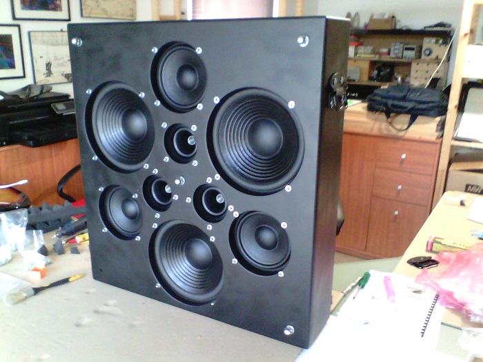

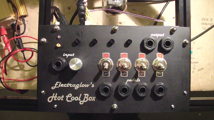

Ciao a tutti !
Here are pictures of an effects box ... based on the famous ADAU1701
and of a 3 ways loudspeaker.
These items are used with the Glowstar 8 tubes "radial" amp
posted here at the end of March.
All will be on demo this week-end at the European Maker Faire
in Rome, Italy.
An Eko Sunblaster italian guitar will be the signal source.
Marco

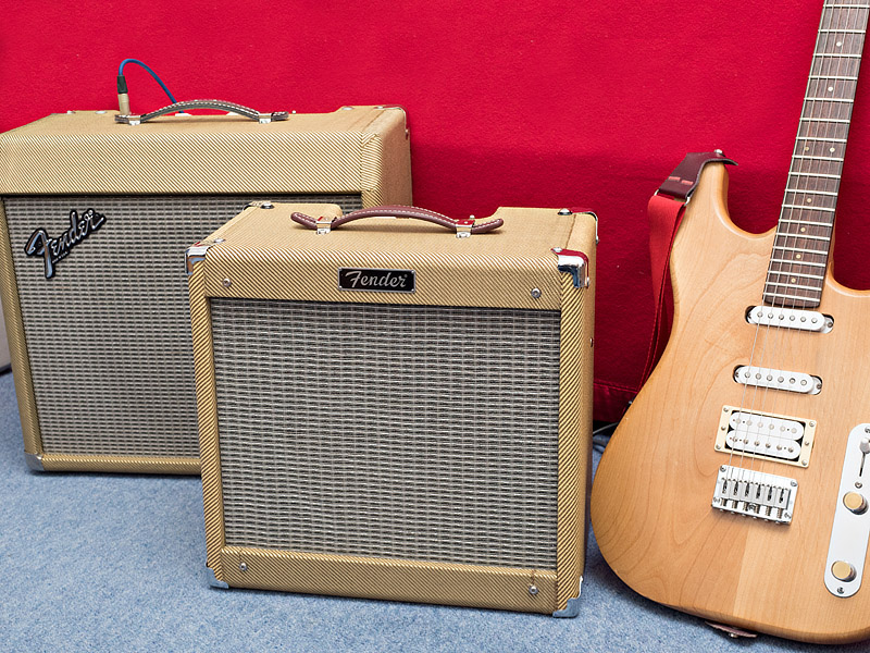

Here's my hand made strat built by a luthier friend. I customised the switchgear to allow bridge coil tap, Telecaster mode and all three pickups. (one of the knobs is also a pull switch)
The small amp is a Fender Pro Junior I modifed. The big one is a ground up build of 5F2 like circuit with twin 6V6 grafted into a 1990s Princeton cabinet. Both covered in tweed so they sound better...

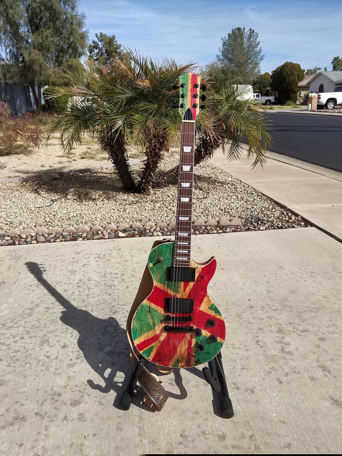

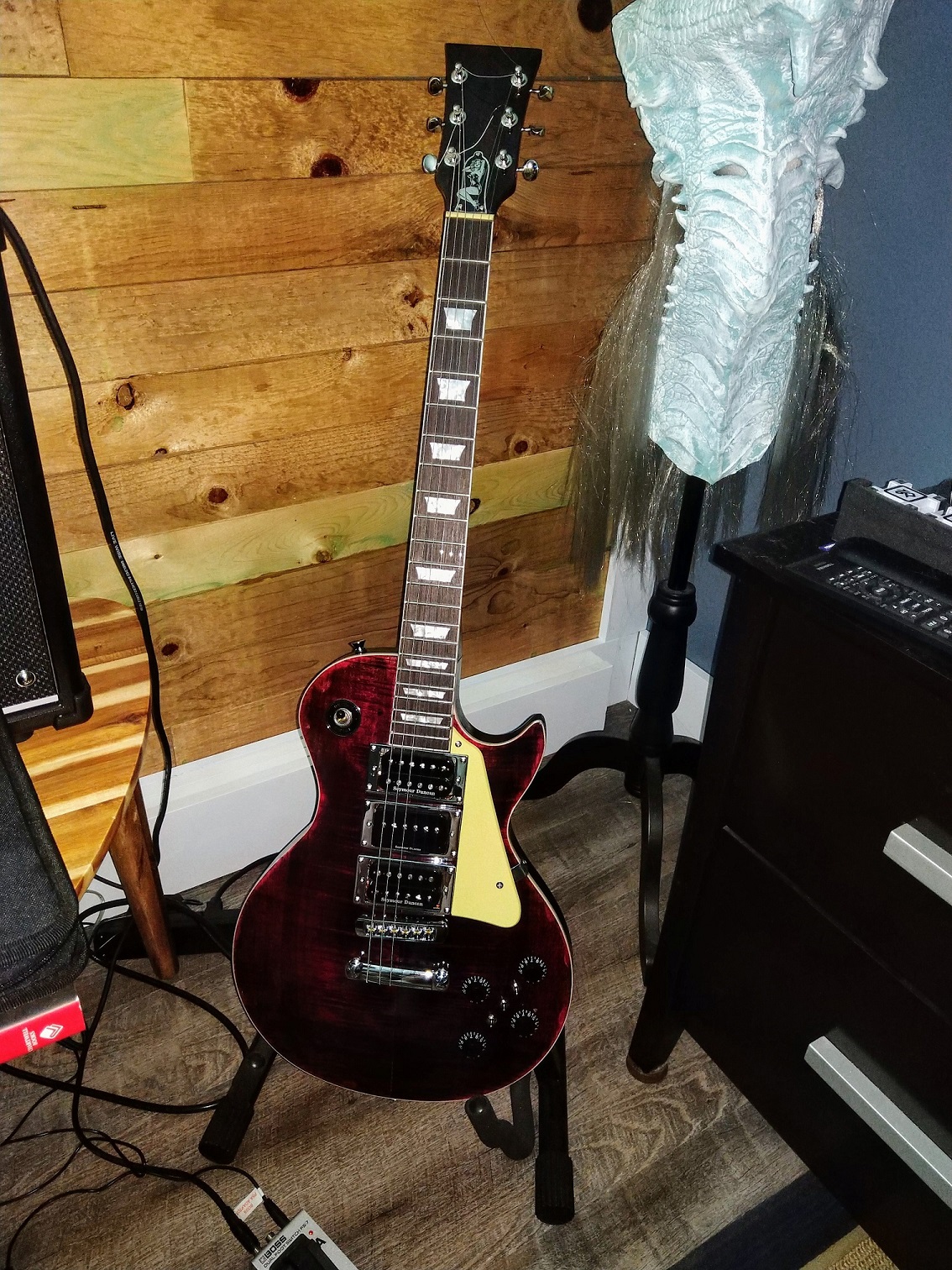

Black Sunshine and the British Invader....
Both are kits that I built and customized.
Black Sunshine has a Free Way selector switch, neck and bridge pickups are Seymour Duncan Distortions (with Series / Split / Parallel toggle) , middle is a P-Rail (with Rail / Humbucker / P-90 toggle). CK pots.
Designed to sound like a Strat / Tele with an LP soul. Still waiting on the White Pearl Pickguard as the cream one just doesn't look right.
British Invader has Seymour Duncan Invader pickups (with Series / Split / Parallel toggle) and CK pots.
Designed as a very versatile LP (Heavy Metal, Jazz and in-between).
Both have many hours of hand rubbed oil finish, no poly whats-a-ma-call-it goo on these.

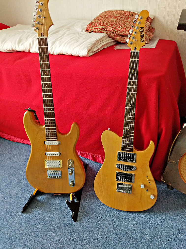

My two electrics.
On the left a hand built HSH Strat with Telecaster look and pull switch coil taps. This includes "Bridge+Neck" and "All three" 5 way switch positions
On the right my Luthier customised Tele with three pickups working as HHH or SHS with second mini tap switch. It includes a "Bridge and Neck" 5 way switch position.

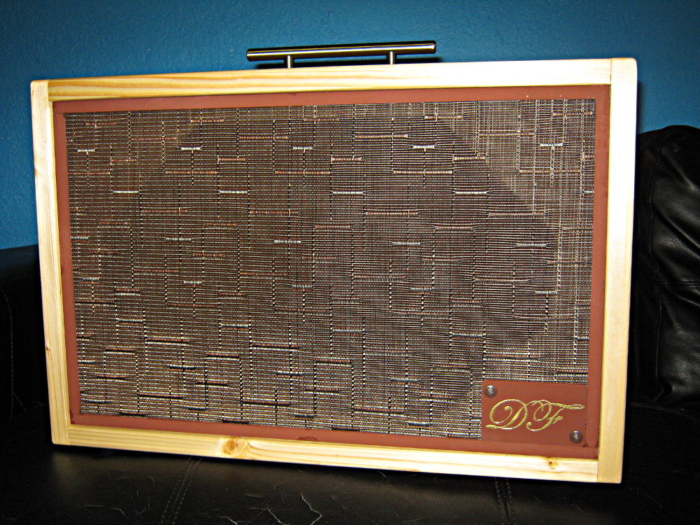

I built this little solid-state amp as a gift for a friend. He's a senior citizen with a physical handicap, so the amp had to be relatively light.
This amplifier is unconventional in a few ways, with a class D power amp board, and a discrete front end with a mix of JFETs and bipolar junction transistors. There's an active one-knob "tilt" tone control, and a permanent EQ curve built in to the preamp to remove most of the usual solid-state harshness.
The speaker complement is unusual too - it uses two boom-box 6.5" speakers in a ported enclosure, both for light weight, and because my budget for building the amp was very tight. The grille-cloth is a dollar-store place mat. The handle is a Home Depot drawer-pull.
The monogrammed letters (the owner's initials) were 3D-printed by a friend, and I spray-painted the resulting print, then went over the raised letters with a metallic gold marker pen.

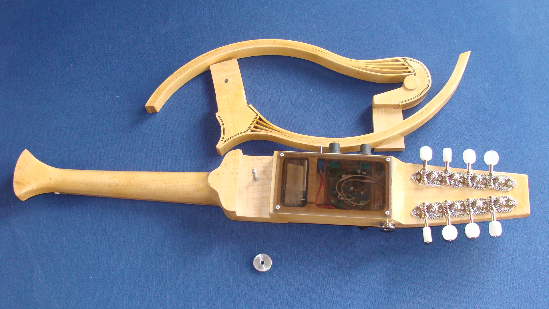

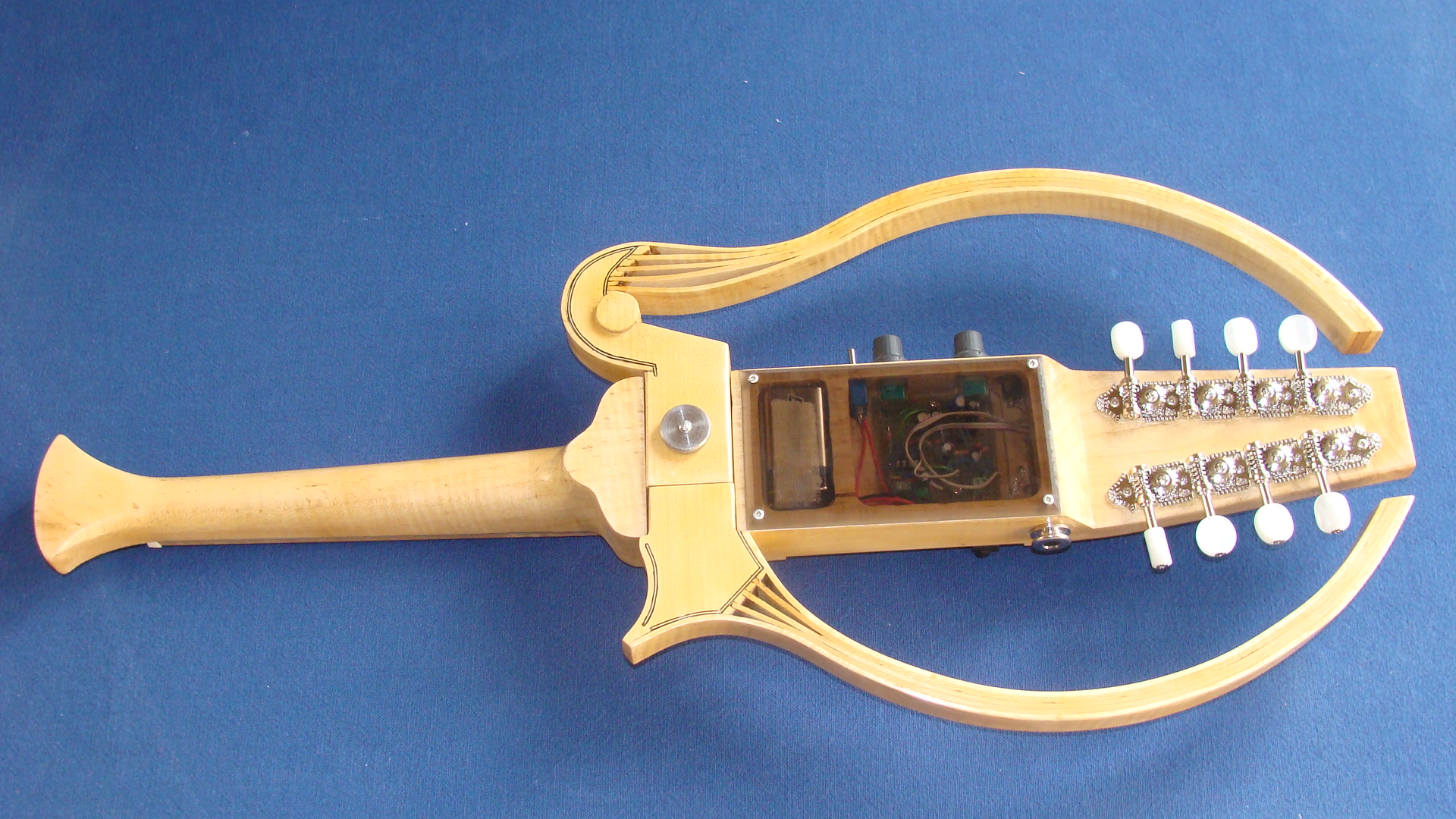

Travel mandolin

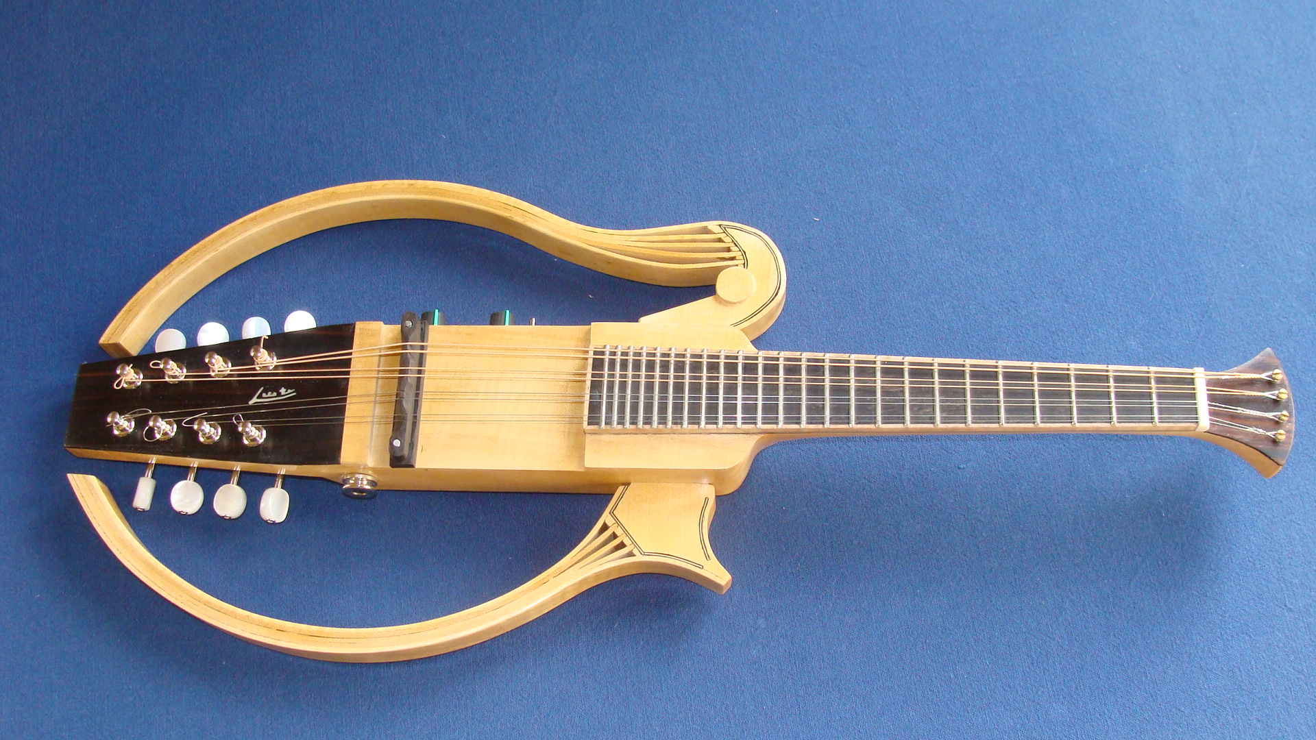

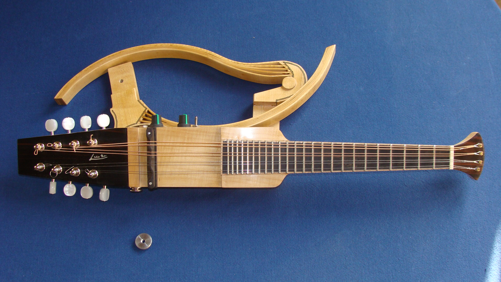

Hi all ,
it's my very first post here in this forum
My last build is a travel training mandolin , I can connect headphones on the 3,5mm jack and play it with no noise around
or plug on a guitar amp on a 6,35 mm jack for playing on stage for example.
Side are removable if you want to put the instrument in a small bag to carry it everywhere .
Tuners are back from the bridge for a good weight balance and reduce the total lenght of the body.

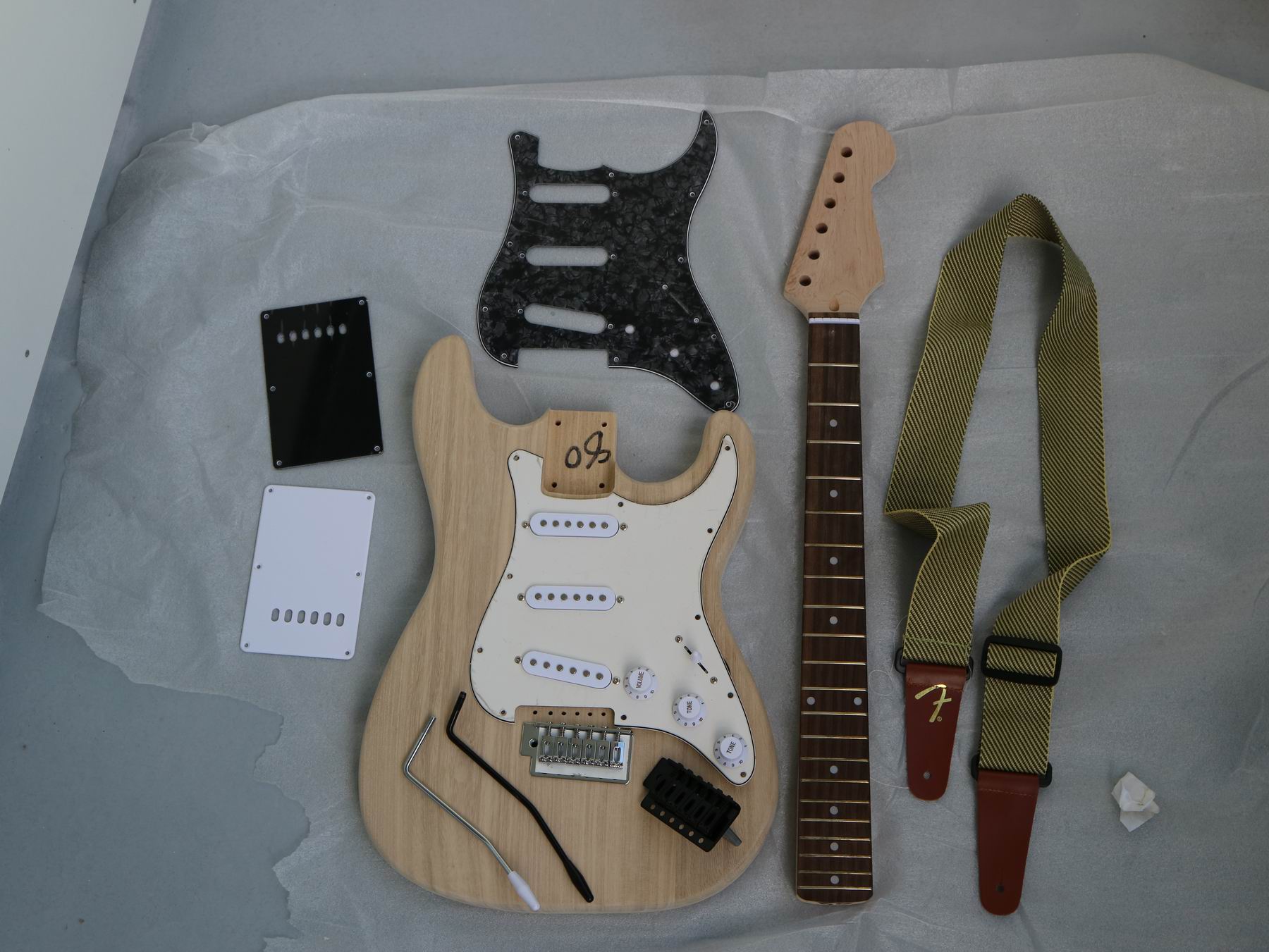

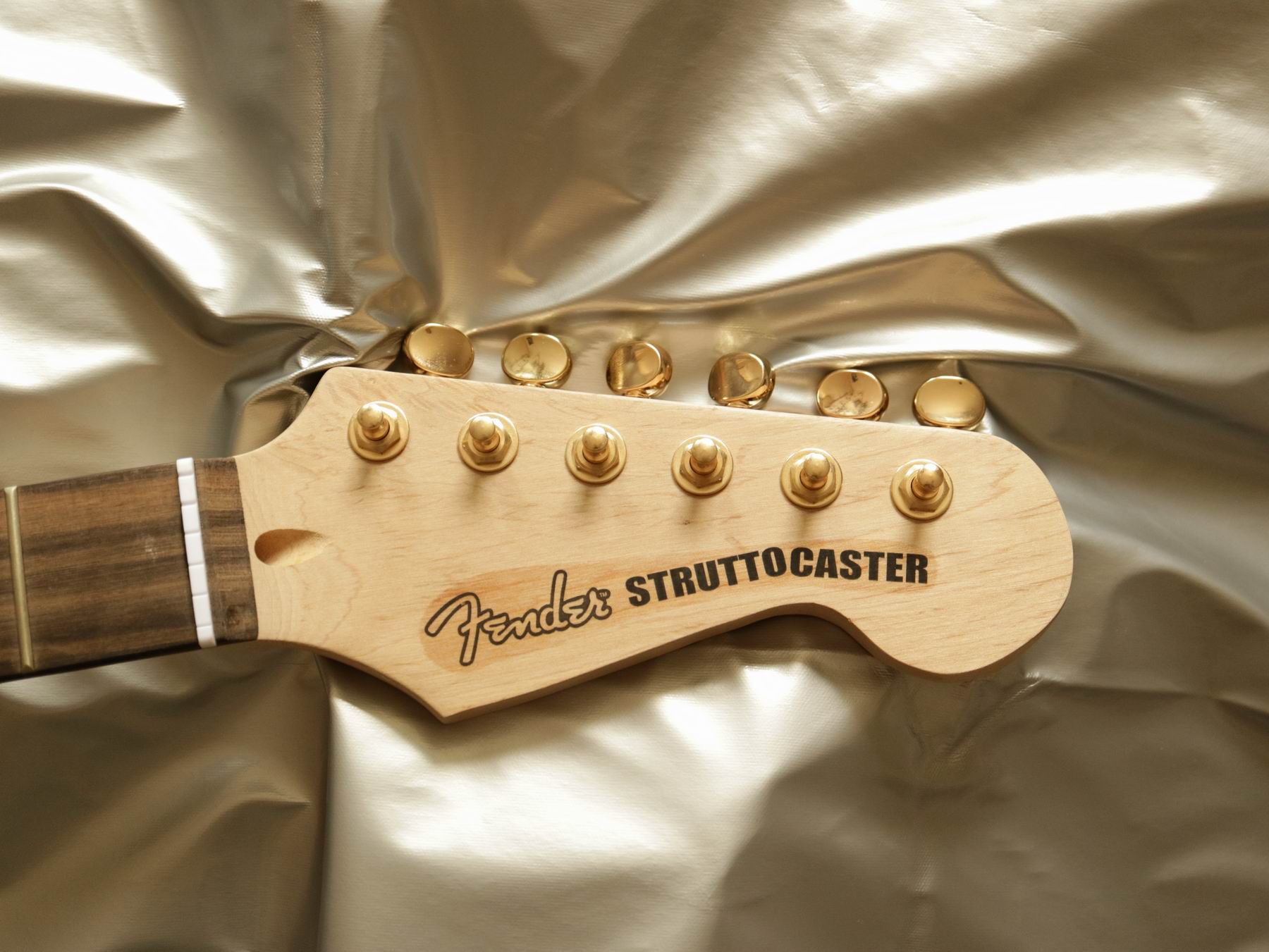

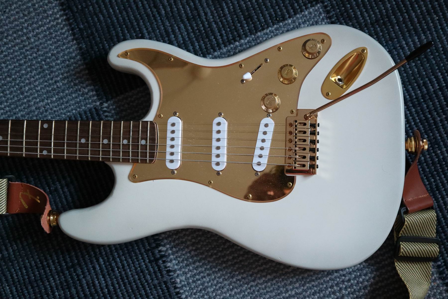

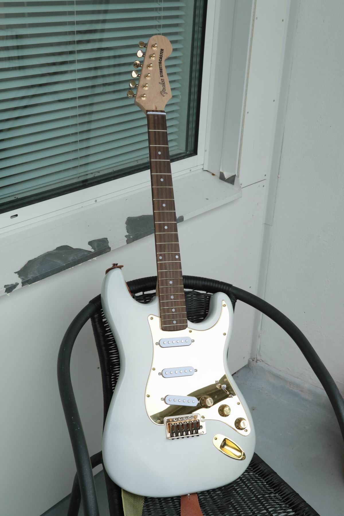

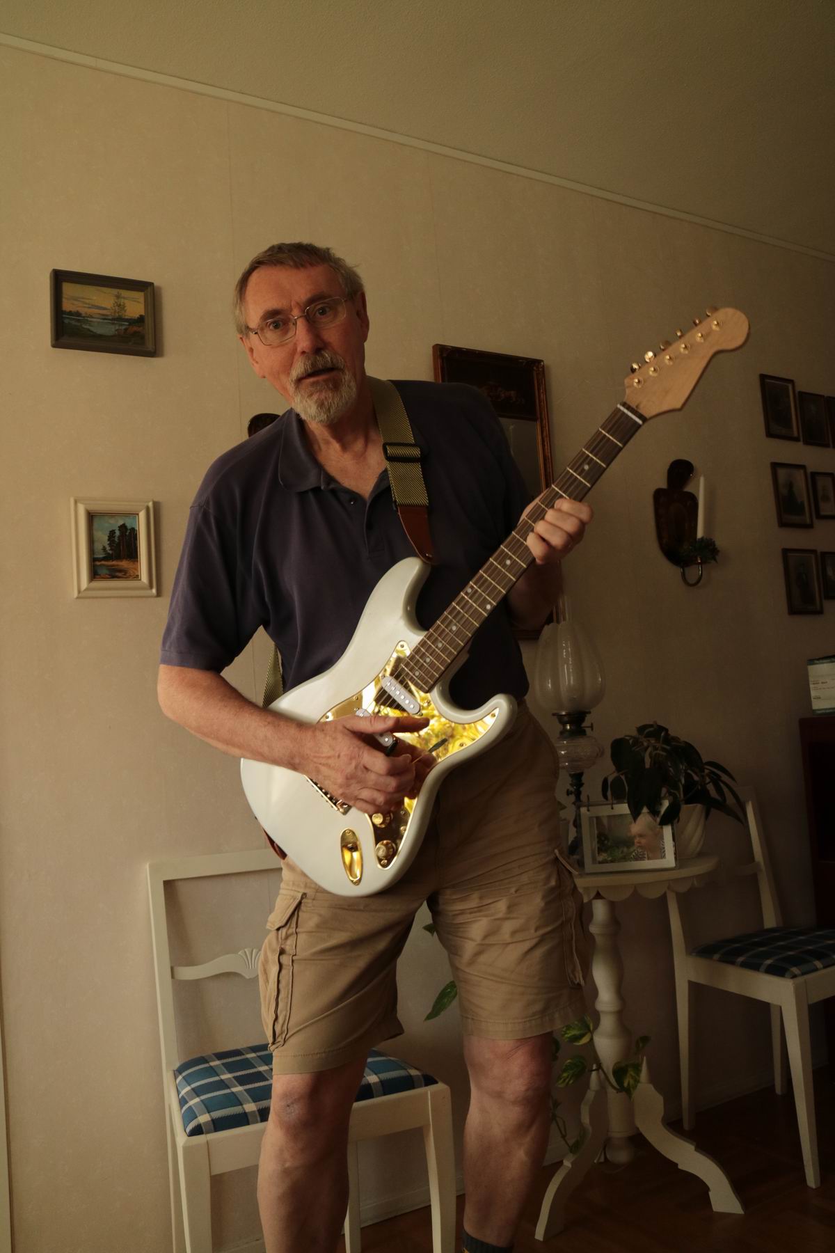

Five or six years ago I bought a guitar kit from Rochler and it took me a long time to finish this build. Two years ago I had access to the job workshop and could freely paint my new speakers as well as the guitar, which just happens to be a Stratocaster-clone (isn't that original??).
I wanted it to stand out, so I picked the golden details :cool:.
