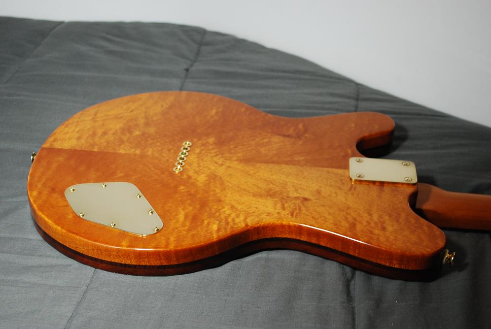

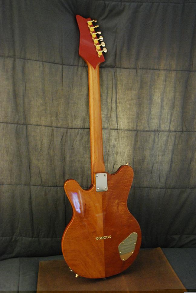

Hi folks, I found DIYaudio through links from other audio places and websearches related to multiway speakers and crossovers, but I saw this thread and thought members would appreciate a DIY effort of mine from ten years ago:
http://web.archive.org/web/20020411030711/www.mindspring.com/~benbradley/
I have a bunch of guitar-building books, and the most influential was "Guitarmaking:Tradition and Technology" by Cumpiano and Natelson. I've tweaked it over the years and it's as playable and good-sounding as ever.

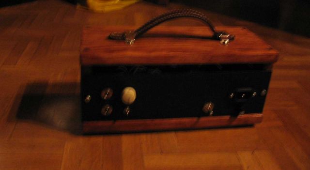

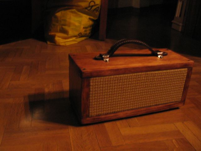

Hey, nice thread. This is my DIY Champ:

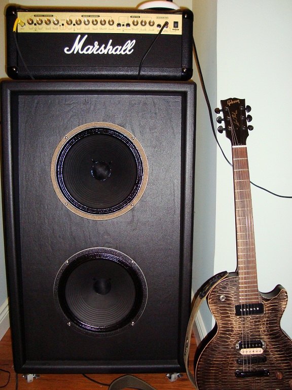

Here is an update of my gear.
I installed a Celestion Vintage 30 in the lower sealed section and a Celestion "GreenBack" in the top semi open part.
Thats my '09 Gibson BFG Les Paul, I absolutely love this thing, practically plays itself.
I have some burlap to make a grill cloth for this, just got to get around to making a frame for it.

A zebra and a P90 in that Les Paul? Great, with respect to a grille for your cabinet, what about this stuff:

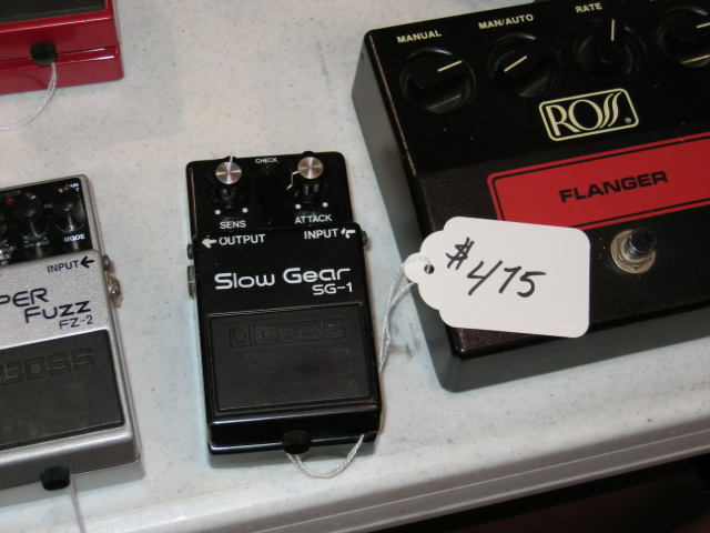

Not sure why I'm posting the Boss Slow Gear, but
The SG-1 has become a cult and highly collectable item (hence the $475 tag for a 2nd hand one).
It is an envelope shaper of sorts, check the net for what people think of it, it's a bit different.

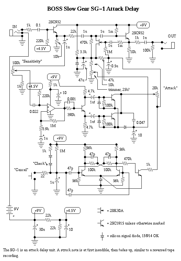

There are clones of the SG-1 about (see PDF, the 3rd thumbnail, I changed the file extension to .ZIP to allow it to be uploaded, as it's quite big. If you want to look at it just change the file extension back to .PDF and open with Adobe reader as normal !).
Also check out diystompboxes.com as most of the stuff there is powered by 9 volts.

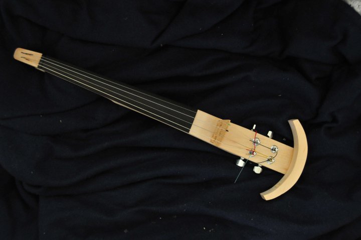

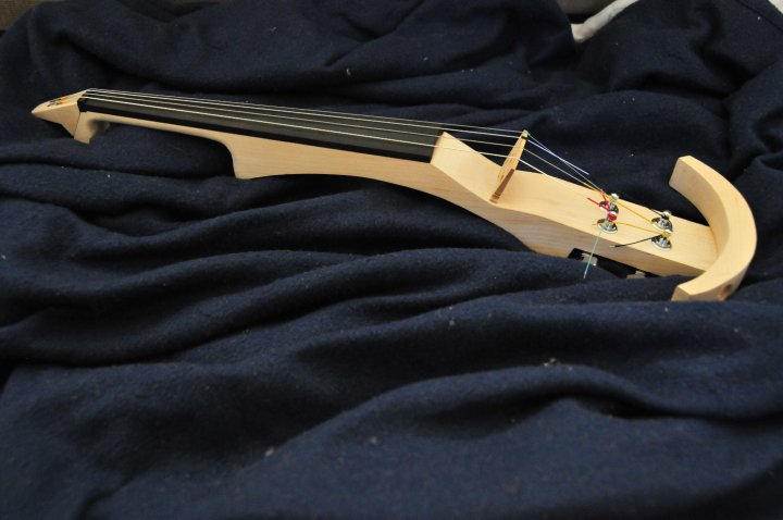

Thanks! In those photos there's no pickup installed yet. It now has a PVDF pickup under the bridge foot. I put a JFET source follower on the violin too, which helps reduce noise, hum, and HF rolloff when using long cables.
I'll see if I can make a picture this weekend.
That violin looks great! What kind of pickup is in there? I would clip the stringends a bit shorter, or they'll take out an eye 🙂

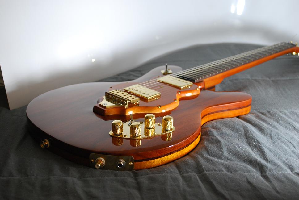

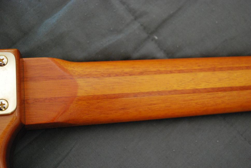

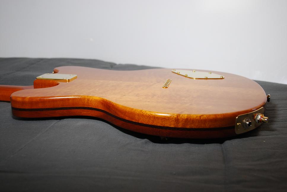

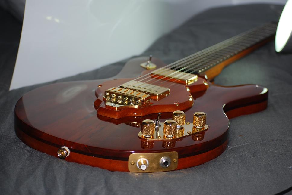

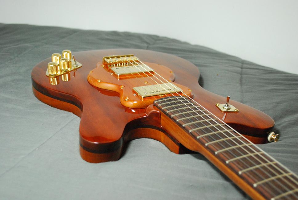

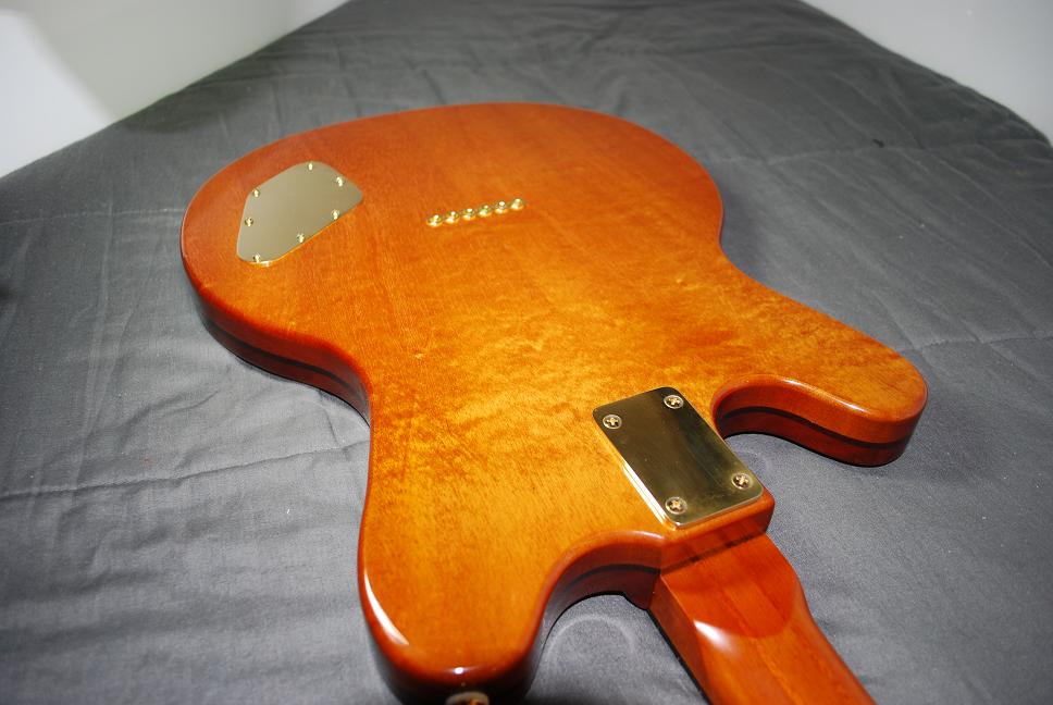

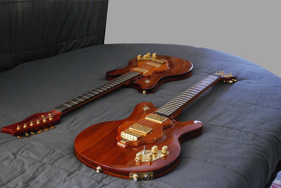

Gday Everyone,
I noticed this is the place to put some pictures of my guitars.
I am a Luthier of many years, the Guitars are my Signature Series hand crafted from Australian timbers dated in the thousands of years.
The timber was felled in about 1914 by the soldier settlers returning from the war.
They have very unique tonal qualities, the angled head Guitars are for Blues with very warm tones when played clean or any style through effects pedals.
The other style shown is especially suited for people who prefer to play with the fingers rather than use a pick. These also have a very warm tone & can certainly be used with a pick through effects pedals etc.
These are designed to be very bright so when played with the thumb & fingers it tones them down about equal to someone else playing with a pick on the angled head style.
Both styles have a lot of harmonics & a great natural Timbre.
Hope you like them.
All designs & Pictures are copyright of course.
Cheers
WDCW
Linguist Guitars
hey, I hope you dont mind a helping hand to present your work better
heres your pics again 🙂
