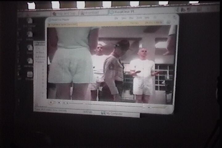

Someone asked for a video sample of video games on my setup, so I made another video. I had to encode this one to Windows Media because the original file was 12GB (it's from a MiniDV camcorder), and the MPEG1 was 45MB. The space I'm using is owned by my girlfriend, and I don't want to waste her bandwidth unless it's people visiting her site. The sample is available at:
http://www.fallenrose.net/robert-san/cyberlien-vg-smp.WMV
The video sample for a projection of Ghost World is available at:
http://www.fallenrose.net/robert-san/cyberlien-proj-smp.mpg
Picture samples are available at:
http://photos.yahoo.com/cyberlien
Look in the DIY Home Theatre folder.
Many thanks to my girlfriend, for letting me use her http://www.fallenrose.net webspace.
Any recommendations on how I can simulate a better contrast ratio would be great. I usually don't play video games on the thing because when something is bright/white in a game, it's virtually invisible onscreen.

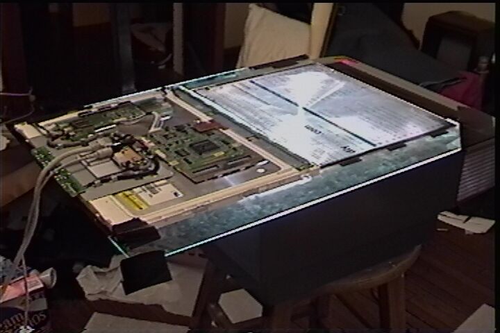

I just wanted to post some of my results. Im using a shower curtain after trying blackout cloth and seeing that the curtain was brighter. Im using a 3M 9075 4000 lumen overhead, my lcd is a I-O data 15". I have a few more pics but I cant figure out how to post more than one pic per message. and sorry for the quality of the picture its from my video camera...
heres a pic of my setup... I modified the top of the overhead, and enlarged the whole to expose the whole fresnel. and Im just using a piece of glass to hold the lcd and the rest of the components on the other side, all I really did is remove the metal part that holds the panel in place and flip it open like a book, very easy.

yeah all your really have to do is take the plastic outer case off, then pry the little tabs open to get the metal from around the screen. of course you have to be really careful. and pull off the sticky aluminized paper shielding off the back. But I wouldn't say any of it was hard to do.. all of the components on the board stay in the same place, this makes the whole setup more stable, just unplug the CCFLs. just be careful when pulling the panel up, " when you open the book". I really cant think of an easier way to describe it than to say it iis like a book. hope that helps..
