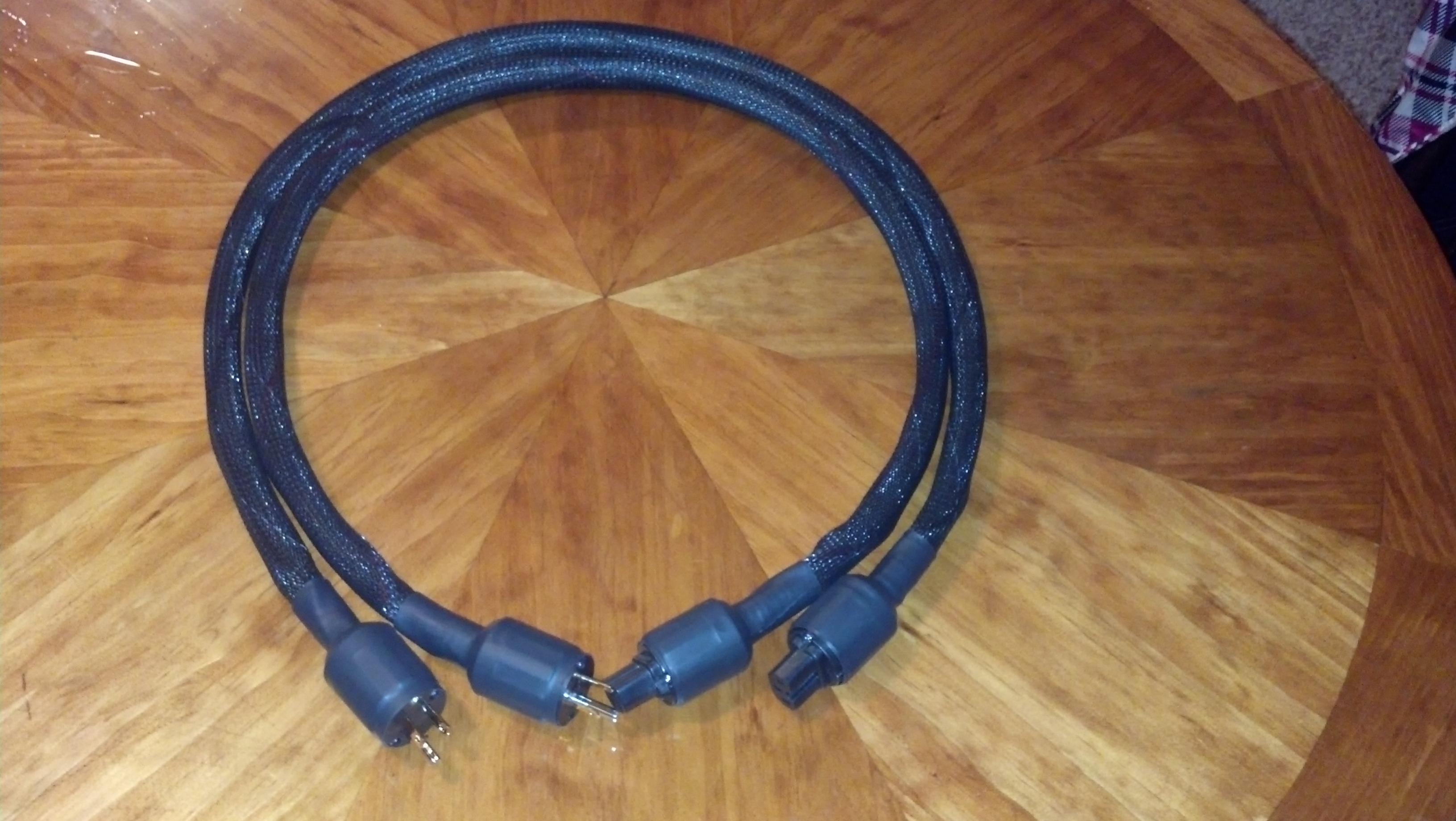

ALRIGHT! i got them all done!
here's the low down.....

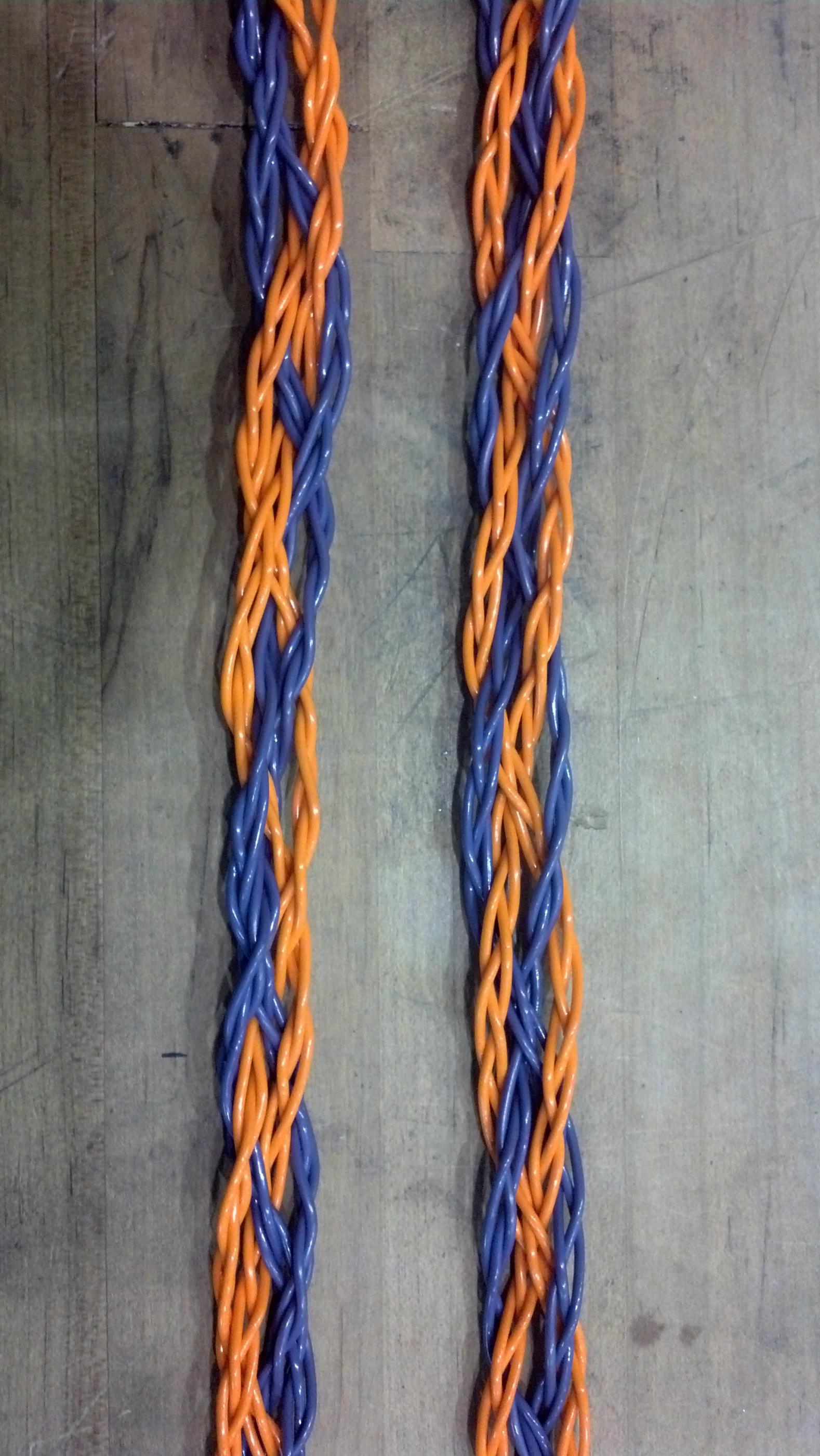

i used a mil-spec 18 awg cu/ag plate teflon wire. used 6 runs for each pole (10awg) and 4 runs for the ground (12awg)
i did a braid 3 then took those 4 assemblies and then did a braid 4.
used a 5/8" tube from Lowes (i think this is it. after you braid the wire, take it there and check to see if it just barely fits. {hint, when it gets a bit tough to slide the wire in, pour a small amount of isopropyl alcohol down the tube and they will slide in. the alcohol evaporates for no mess.}
1/2" tinned copper shield (95%) rated
Neotech NC-P311
Neotech NC-P302
Wattgate 350iHC (i needed a 20a for my Furman 20PFI)
teleflex
heatshrink
you need normal tools to construct this, however, a heat gun is needed for the heatshrink. those can be expensive but there is a few cheap ones on the market. a talented hand and a butane lighter, can get the job done. also depending on the teleflex you get, will depend on the sensitivity to heat.
i had to do is use a step-up bit or uni-bit to open up the backshell to 1". on the NC-P302 (iec) i would recommend only going to 3/4. at 1" it's a touch loose. on the NC-P311, you can only open it up so far. they are made different and you start to cut into the mounting screw holes.
i might buy some 3M 1181 copper foil tape to make this cable as close to 100% shielded as possible.
i also did something different. i used some aluminum tape to completely cover the backshell. if you do this, the aluminum will provide 100% emi/rfi protection. you just have to make sure the harness is wrapped or shielded past the back of the connector. if you can get it to work, use some thicker aluminum foil and heat shrink, does the same thing. (side note: even if you do this and you are 100% perfect in your construction, the cable will not be 100% protected, simply the way the plugs extend past the backshell allows emi/rfi. this just gives you the best possible construction with these types of connectors. besides, it's not like you will have EMI pulse pumps aimed at your gear. the foil wrap and aluminum cover will give you more than enough protection in the worse possible conceived situation.
i only had 2 cables built for my first listen. the connectors were on back order, and i will say this, they arrived only a few days after the first order came in. good job on the super quick shipping!
keep this in mind, i only plugged in my Furman cord and my processor cord. i was streaming netflix watching a normal show.
i was surprised at the audible difference. first off, it was louder. i had to turn the volume down a few numbers to get it back to "normal" volume. what i heard was a bright, clear, and very detailed sound. this is with ZERO break in. in fact, i'm not going to do a true audition until i believe this are broke in. the last cables i made, which are for sale 🙂, were very good and i got good results. they did make an improvement, but i don't remember them effecting the volume at all. this go around i used much better connectors (upocc + gold vs. brass + gold and cu/ag plate + teflon vs. 4N cu + pvc). the other items are the exact same.
my personal opinion is this: cost + performance = amazing deal. the total cost to make these cables was not much at all and they really sound great. i won't spent too much on cables because i believe you should spend more on gear and speakers and tune them in with cables. also depending on what level your equipment is, should reflect the level your cables are. i don't care if you have the "best" possible cable in the world, it won't make a low end system sound like a high end system. improve it yes, but you have to consider cost vs. outcome. besides if you can spend $1500 on a power cord, you won't buy junk equipment!
here are some pics of the wire. the white is the ground (braid 4). for the final braid of the poles i went with the "cross" pattern. i actually did this on accident. i braided one, then the other and noticed they were different. i chose the cross based on i thought it might be better. it looked like the pole's stayed away from each other and the other braid it looked like they ran together. i hope i chose right. the pic of the completed cables is not the actual cables. those are plugged in and i'm too lazy to pull them out. however, this pic shows the same tube, shielding, and spiraled ground. my current cables look the same as these.
