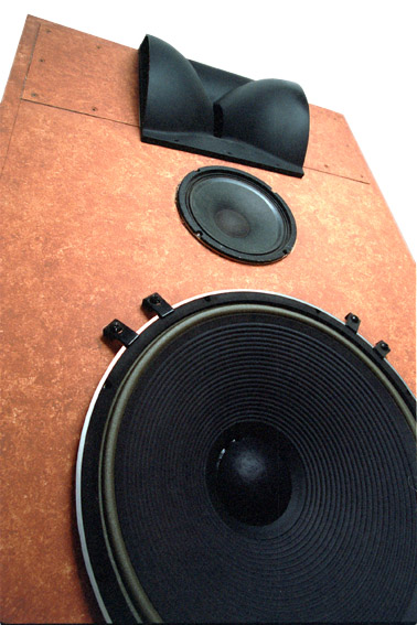

Gabriel,
Its about 1.00 am in the morning so like keep the result short.
Using the approach as per our previous posts (ie like your diagram it works! No hum or buzz.
If fact I had to turn off the fridge in the kitchen to hear the noise from the speakers... only a very faint hiss and very minor hum with my ear about 4 inches from the woofer ( all eighteen inches of it @ 96 db).
I will be delighted to hear (and see) how your Aleph 4 project turns out.
regards
macka
