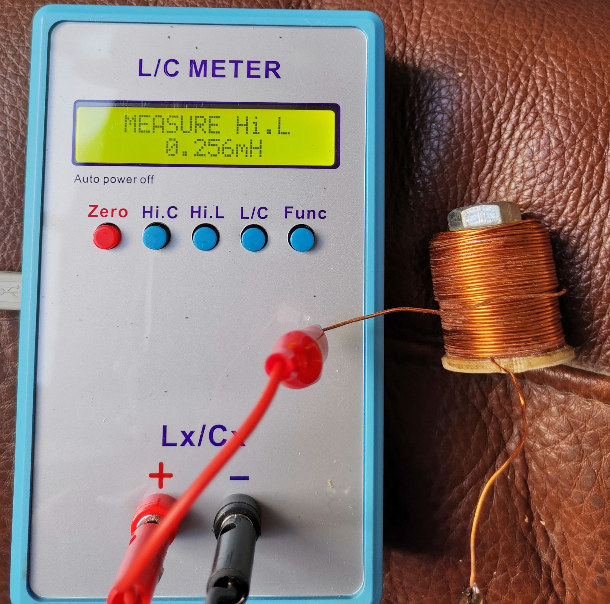

But if you want your tweeters to last longer and be safe , I would build a 2 order filter, at least just for the tweeter. it's easy to built.
Wire you can buy or get from transformers, other crossovers, etc.
anything at least 0.4mm thickness is ok for the tweeter. " thicker wire is recommended 1mm or so " ( you can use two wires in parallel if it's too thin ).

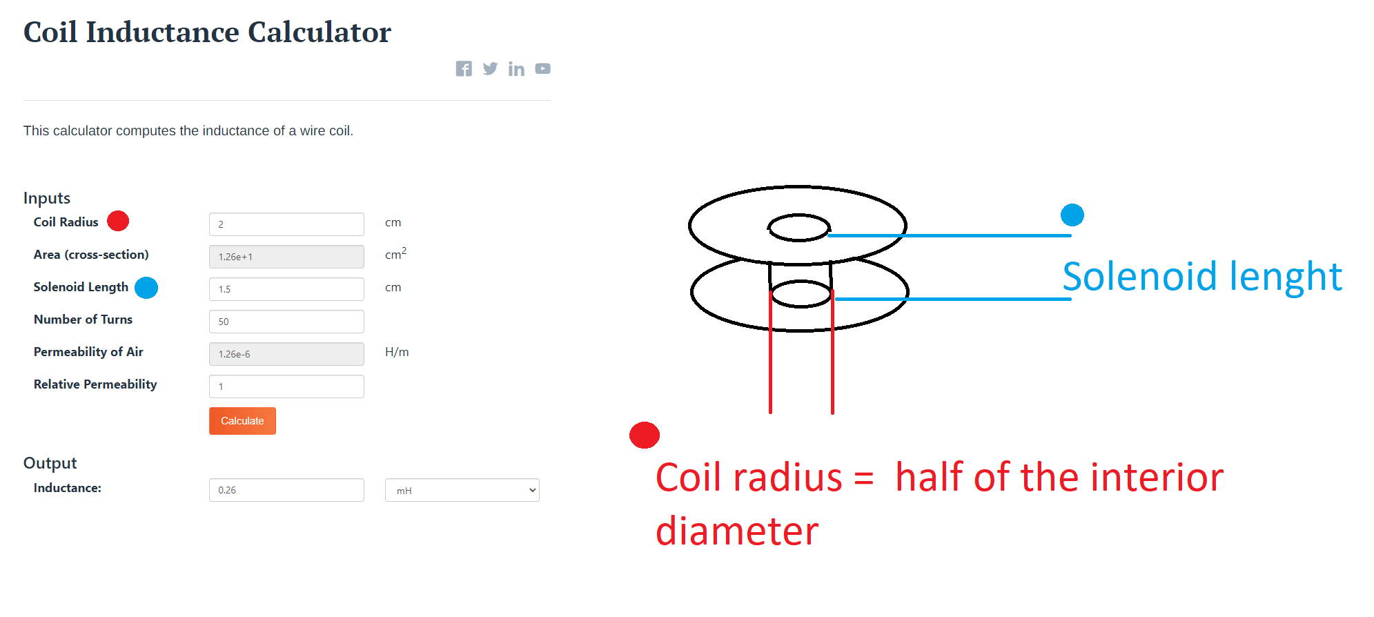

Online Calculator for the coil:
https://www.allaboutcircuits.com/tools/coil-inductance-calculator/
Coil can be made out of styrofoam, cardboard, Fishing line :
Wood, etc.
Value of inductor can be calculated in the online calculator , value depends on the size of the coil and how much wire is used.

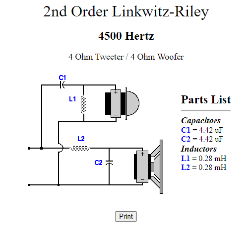

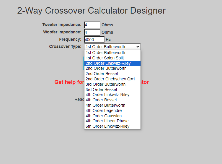

Something like this if you build the crossover only for the tweeter.
the 4.4uF cap could be a 4.7uF.

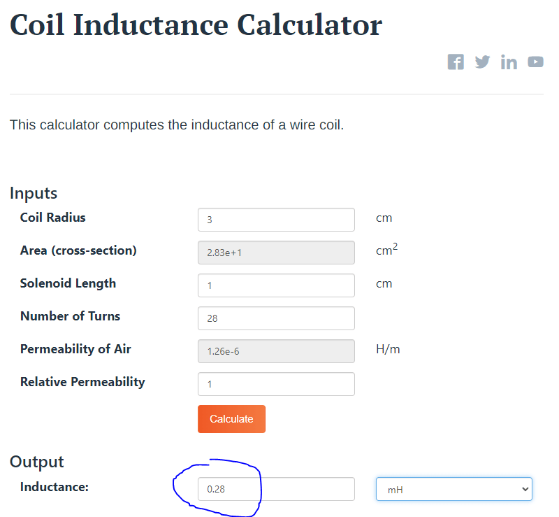

and the 0.28mH Coil you make yourself with that online calculator.
Put the size values of your coil , change the number of turns until u get the desired value " Output, Inductance: by default it is in H u can click it and change to mH . Change the value of turns until u get 0.28mH .
I calculated the values of capacitor and inductor for 4.5Khz .
You can use any other cut frequency you like.
here is the calculator :
https://www.diyaudioandvideo.com/Calculator/SpeakerCrossover/
Just put the speakers impedance ( 4 ohm for example ) the frequnecy you want . Select 2nd order Linkwitz-Riley, and you get the values for your crossover.

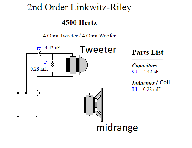

The inductor connects across the tweeter terminals.
The added inductor causes a sharper rolloff of frequencies reaching the tweeter.
If you use a 12dB/octave crossover (inductor and capacitor) do NOT operate the system without having the tweeter connected to the crossover.

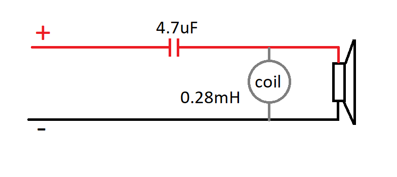

hello @xXBrunoXx thank you for your explanatory explanation. let's see if I understand correctly. if I make a coil with a value of 0.28 mh, I will prevent frequencies below 4500 hz and below from passing to the tweeter. so my question is; will I connect this coil in series to the positive pole of the tweeter?
Coil must be in parallel with the tweeter. And also a capacitor before the tweeter ( 4.7uF ) for around 4.5khz
