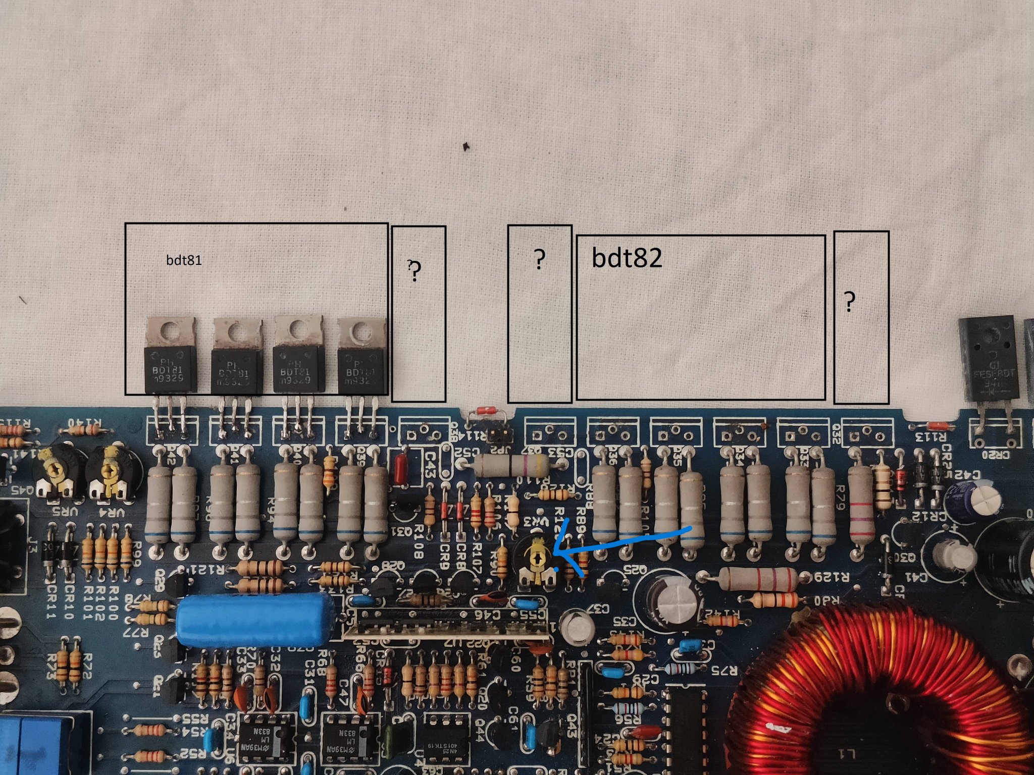

Hi guys, I have a problem on a precision power a600 amplifier.
Basically the amp came to me not working, I saw that one bank of transistors had components the other totally different, not having an original schematic to refer to.
I think the 4 npn bdt 81 and bdt 82 are original (the other bank mounted bd711 and bd712).
I would like to know what original amps it mounted ee above all it did not come to me complete, but transistors were missing.
I enclose the photo of the amplifier by circling the parts not present of which I would like to know the abbreviation in order to install them corettamente on the net I have not found anything about it.

thanks perry, then I saw from the picture that the last transistor (sulvulator side) are different from one channel bdt 81 and of the other bdt82 .
the 2 drivers are 2sa1011 , 2sc 2344.
now sourcing these finals is very difficult for me, I saw as equivalent:
btd81 equivalent 2n6488
btd82 equivalent 2n6491
equivalent for the 2 sa1011, 2 sc2344 on the other hand I have many doubts about it.

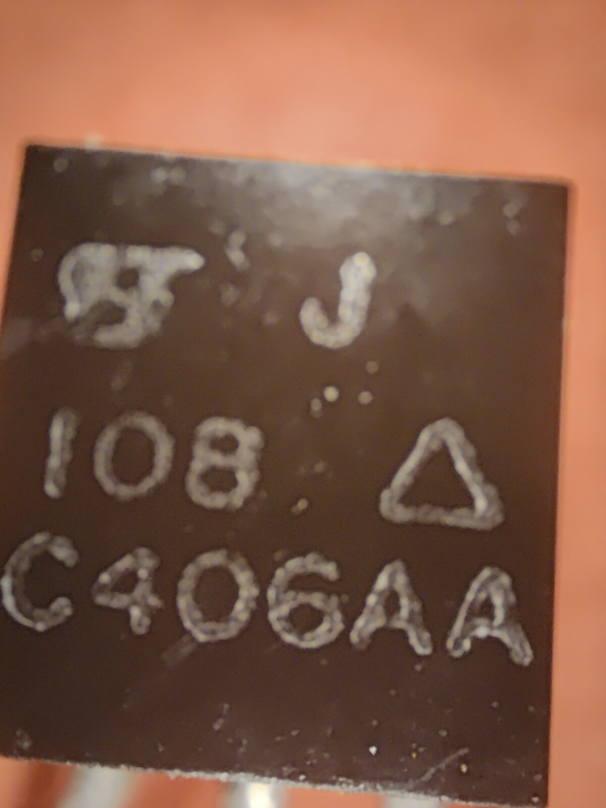

Hi guys , I update you , I replaced the 2 zener diodes cr13 and cr3 as I had no power on the lm833 , now the amp turns on , I verified that the q29, q23 q21 q19 were damaged, I attached the picture of the components, but I can't find them on the net , they are if I'm not mistaken de jfet n, could I adapt others easily available?
JFETs cause a lot of techs to believe that they're defective.
From gate to source, they should check like a diode.
From drain to source, they should read whatever resistance is given in their datasheet. For this JFET, expect to read approximately 7 ohms, drain to source.
^^^ all of this is with the JFET out of the circuit.
