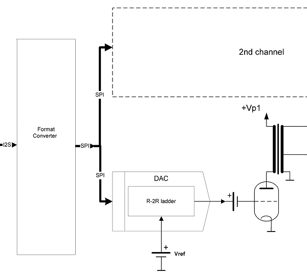

For DAC section I have selected 20-bit AD5791 (or 18-bit AD5781) chips. The reason is that since 2003 I love to use the following topology in my DACs:
It allows me to built a DAC with no feedback in any part of sound path, including reference and output buffer. Decades of intensive use has proven very good musical characteristics of this topology. And AD5781/91 chips have unbuffered R-2R matrix with no OP amp on the output.
Nevertheless, current PCB is allowing to use traditional schematic with high-quality OP amp buffers.

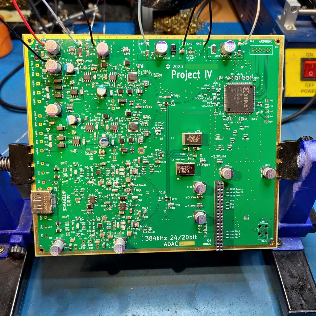

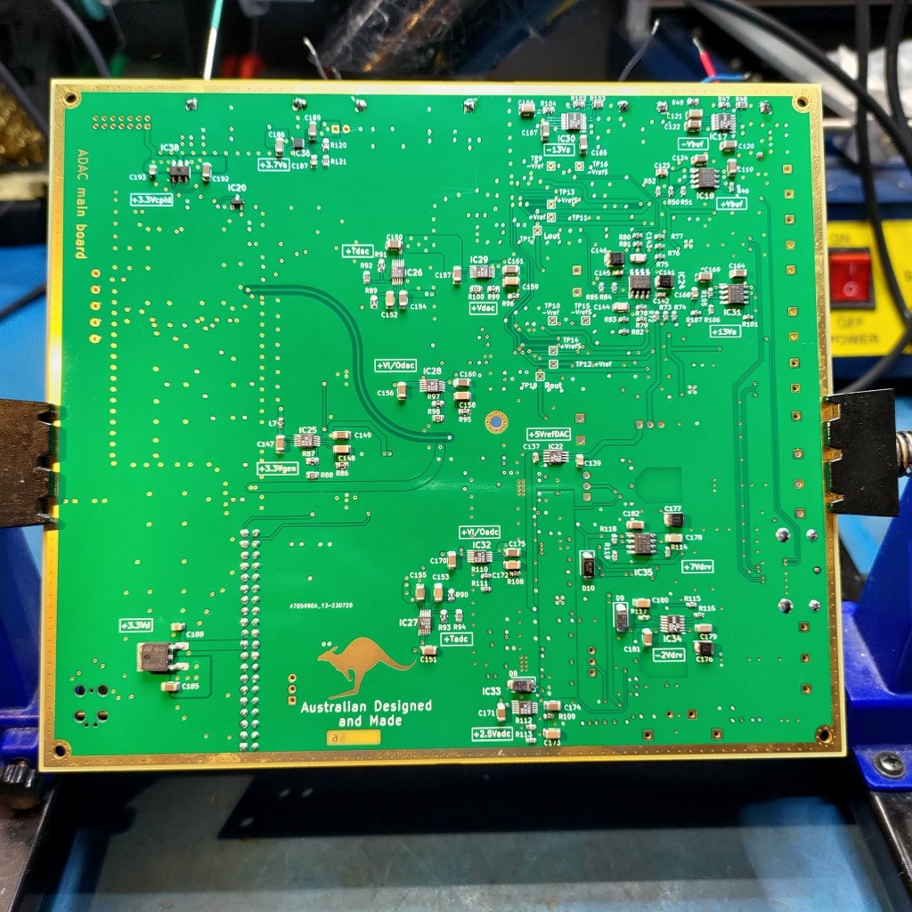

Overall view of the finished board is shown below:

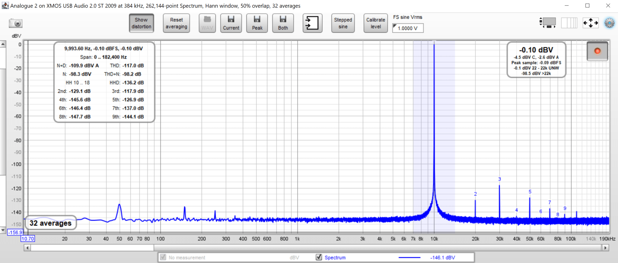

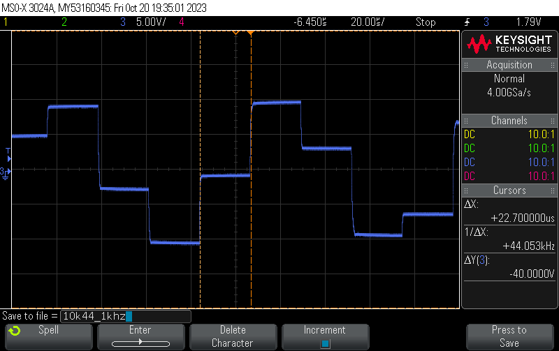

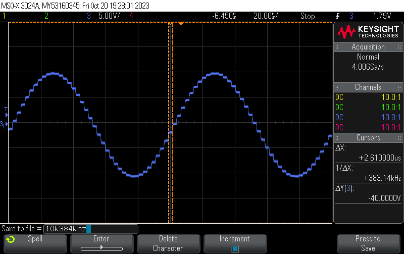

After a few days of reading manuals, forums and tinkering generic software I have found a root case of my troubles with 384kHz playback. It turned out that USB-A port on my MS Surface 7 wasn't good enough! Switching to USB-C +HUB solution fixed the problem!
Now 10kHz@384kHz sampling rate looks very nice, especially, compared to 44.1kHz rate
Nevertheless, I am under opinion that it's incorrect device enumeration to blame. But at this point I am quite happy with an outcome as XMOS programming is a pure nightmare considering amount of information you have to absorb and digest.

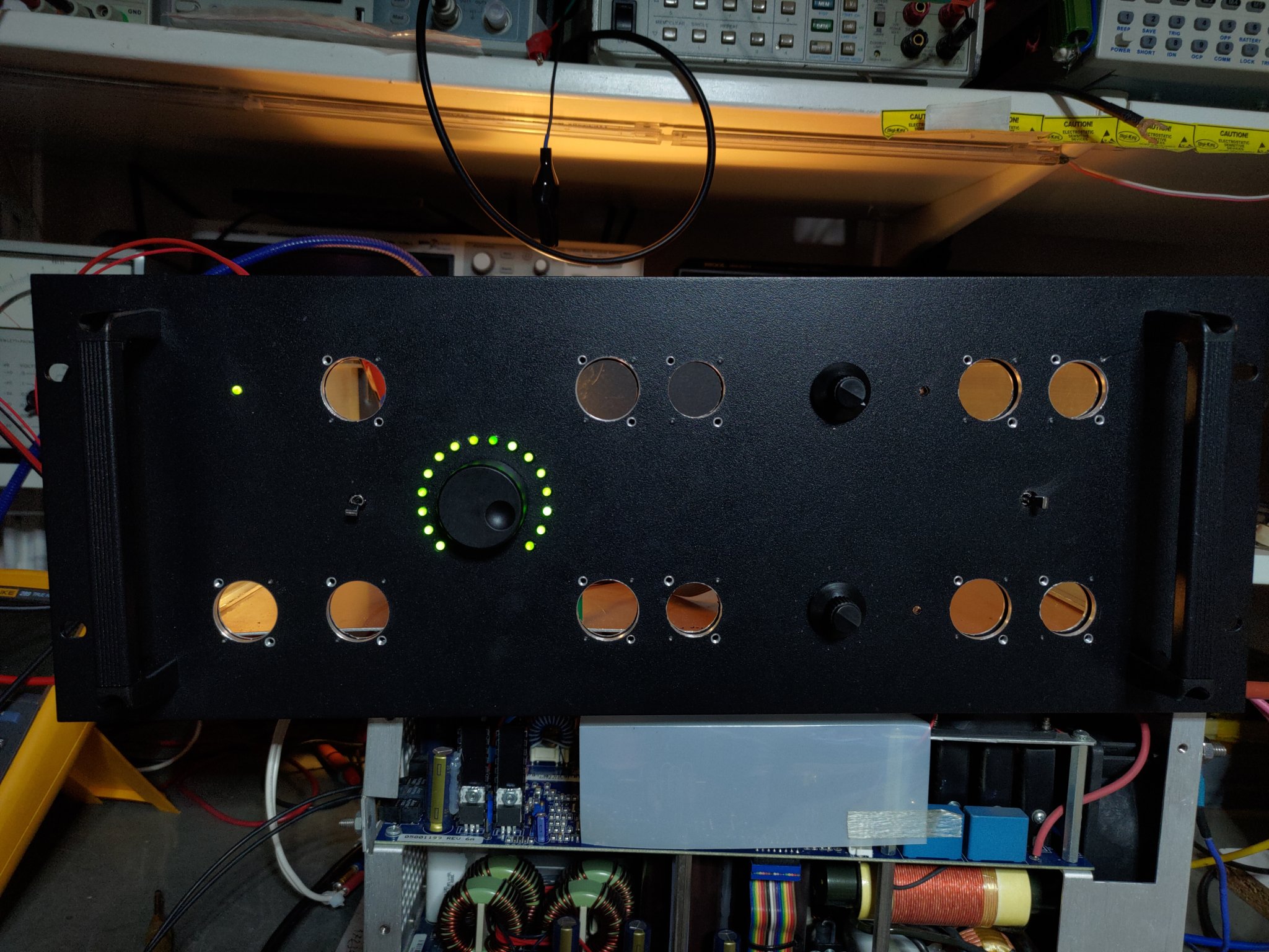

Hi folks, wow, time flies - it's already more than a year since my last update.
Sorry to keep you waiting but I was quite busy with a various stuff moving slowly this project to the end.
So, what has been done?

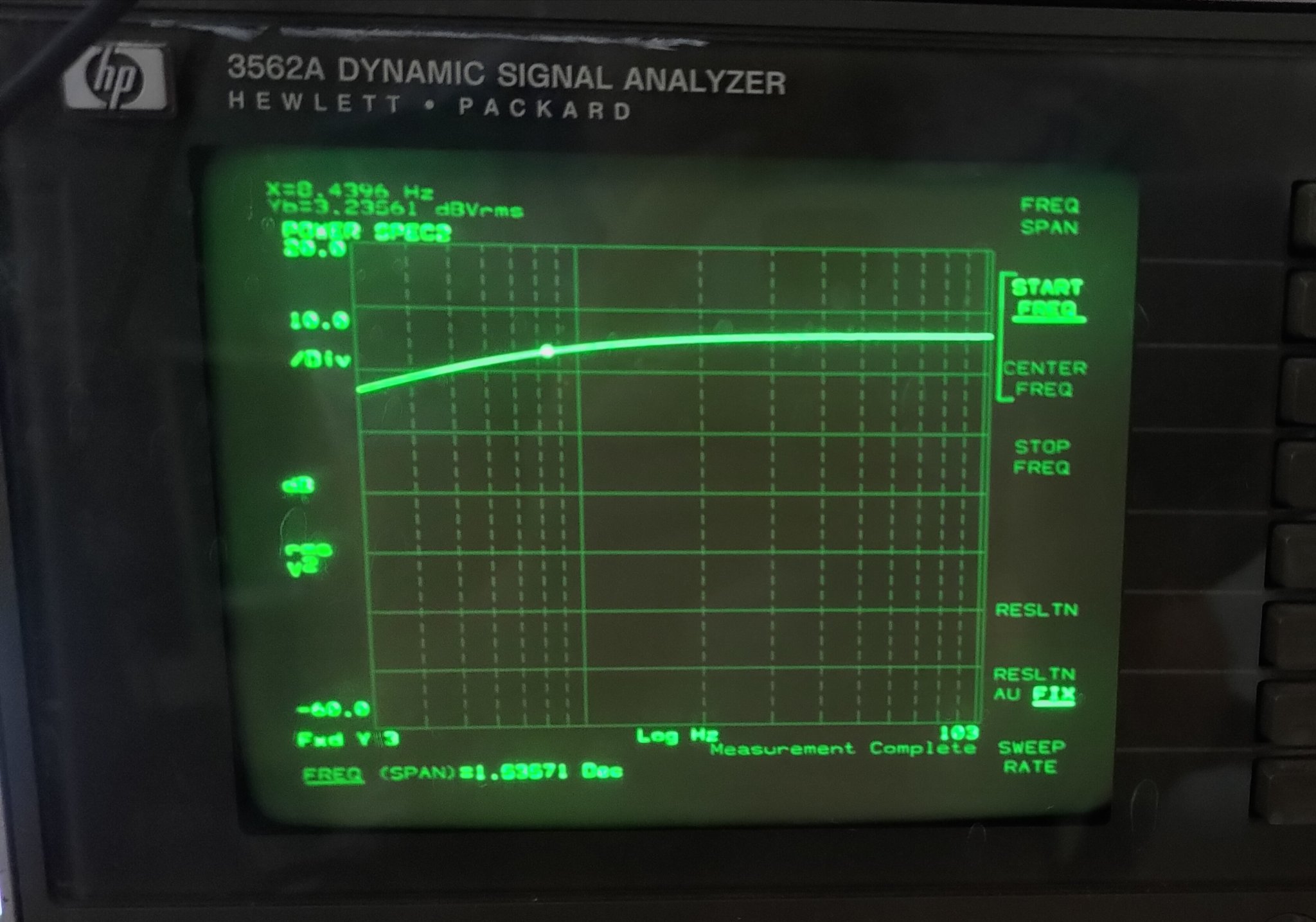

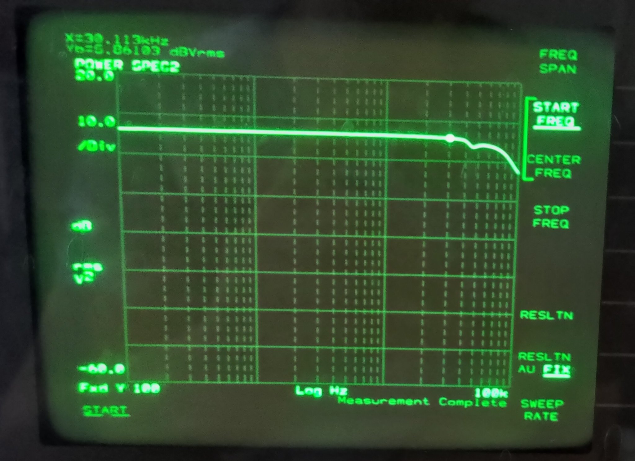

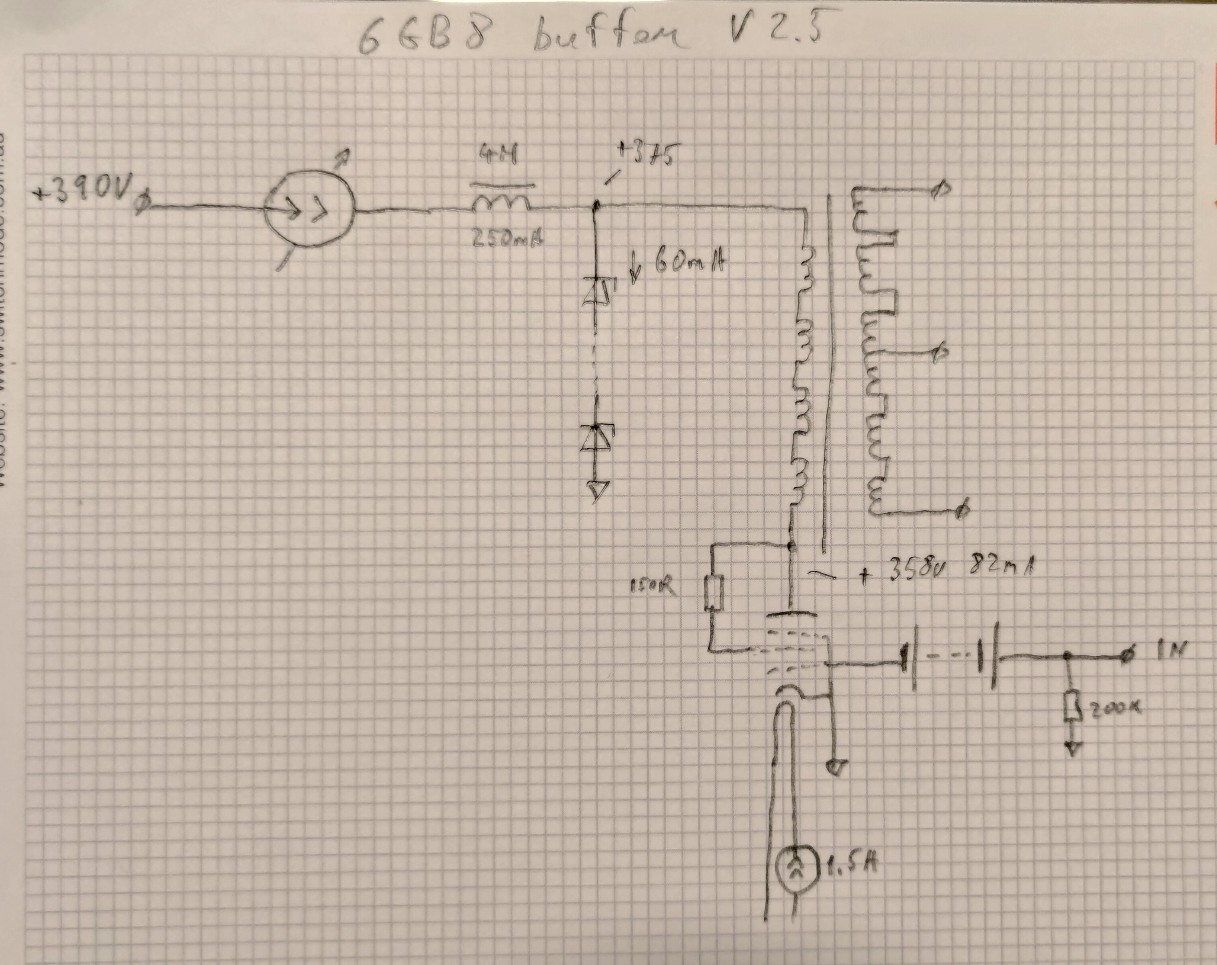

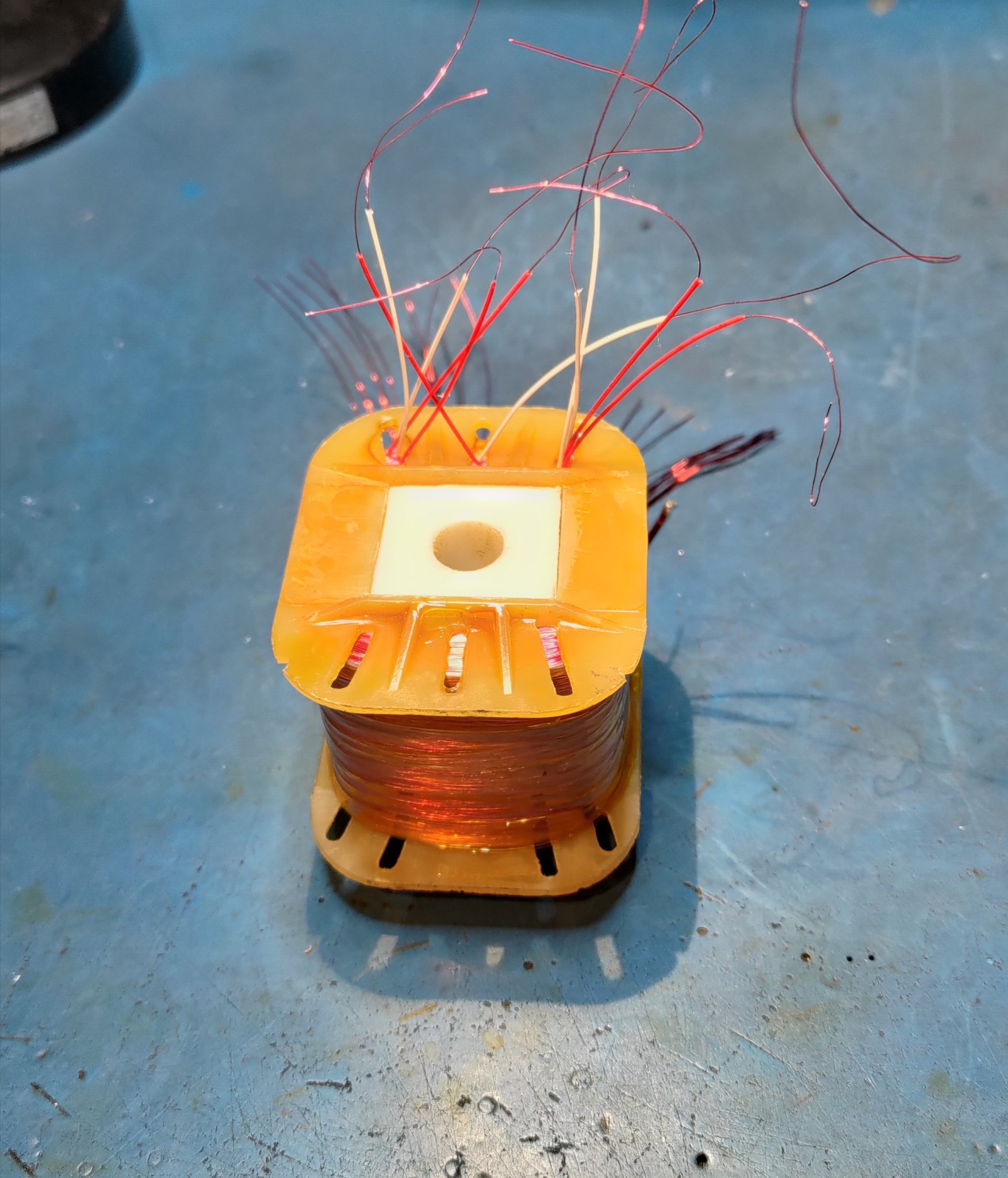

1. DAC tube buffer was developed using my favorite "Single Ended push-Pull" topology with 6GB8 tube in triode. I had to make 5 different output transformer designs until got happy with bandwidth and linearity.

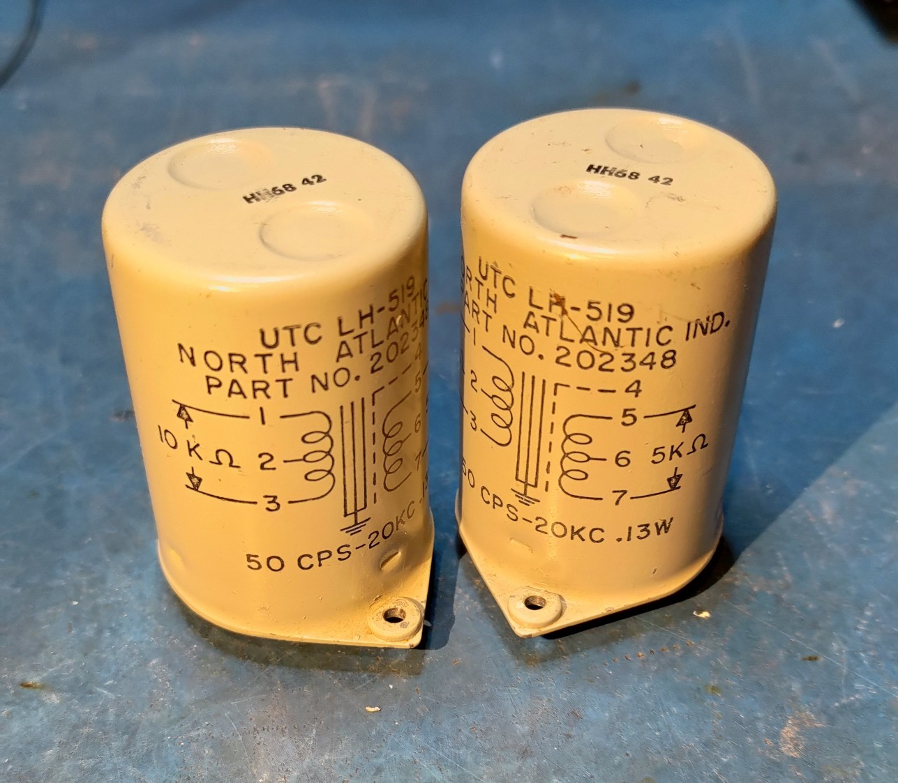

2. To save development time for ADC buffer, a passive SE to BAL transformer stage was used based on UTC LH-519 transformers. All amplifications is done by ADC driver op amp.
3. For input and output level adjustment I have developed a versatile balanced binary step attenuator with constant input and output impedance plus SPLD-based encoder to binary code control circuit to avoid usage of noisy uCU. It's an exiting project by itself, and if anyone is interested, I can make it an open-source in a separate thread.

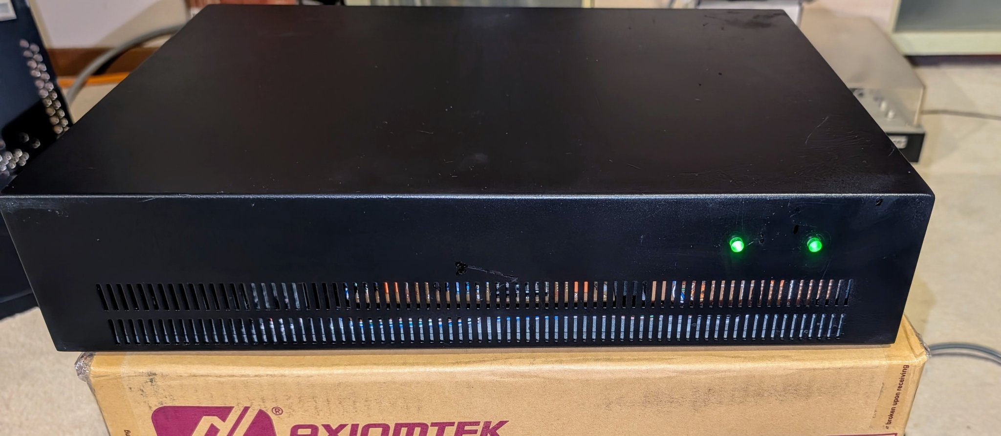

4. Due to noise pick-up had to move a power supply into different enclosure. I am using separate constant current sources for tubes filaments (to match tubes gain) and batteries for fixed bias.

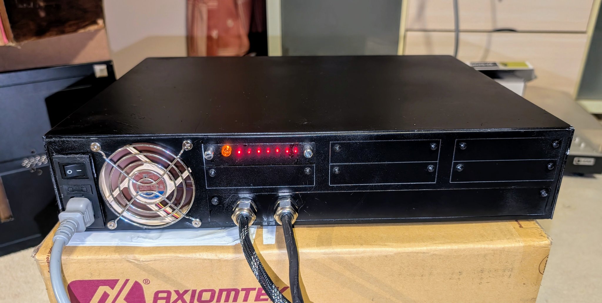

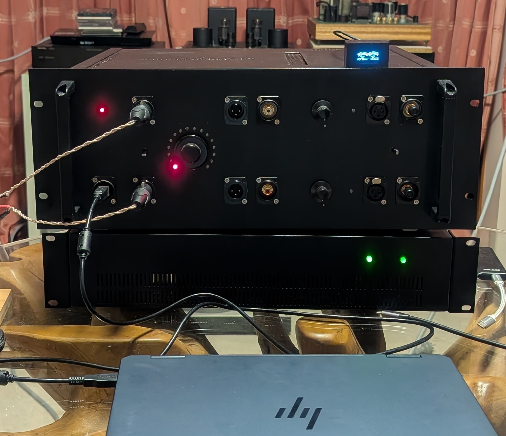

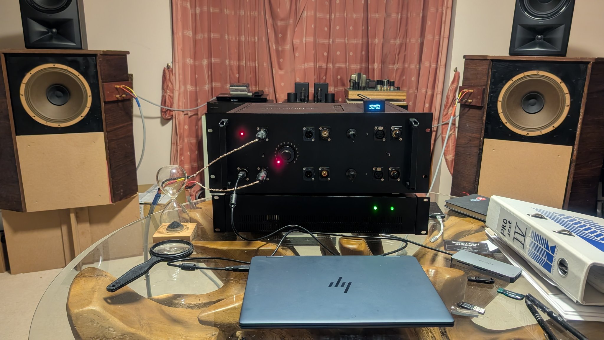

Complete project:

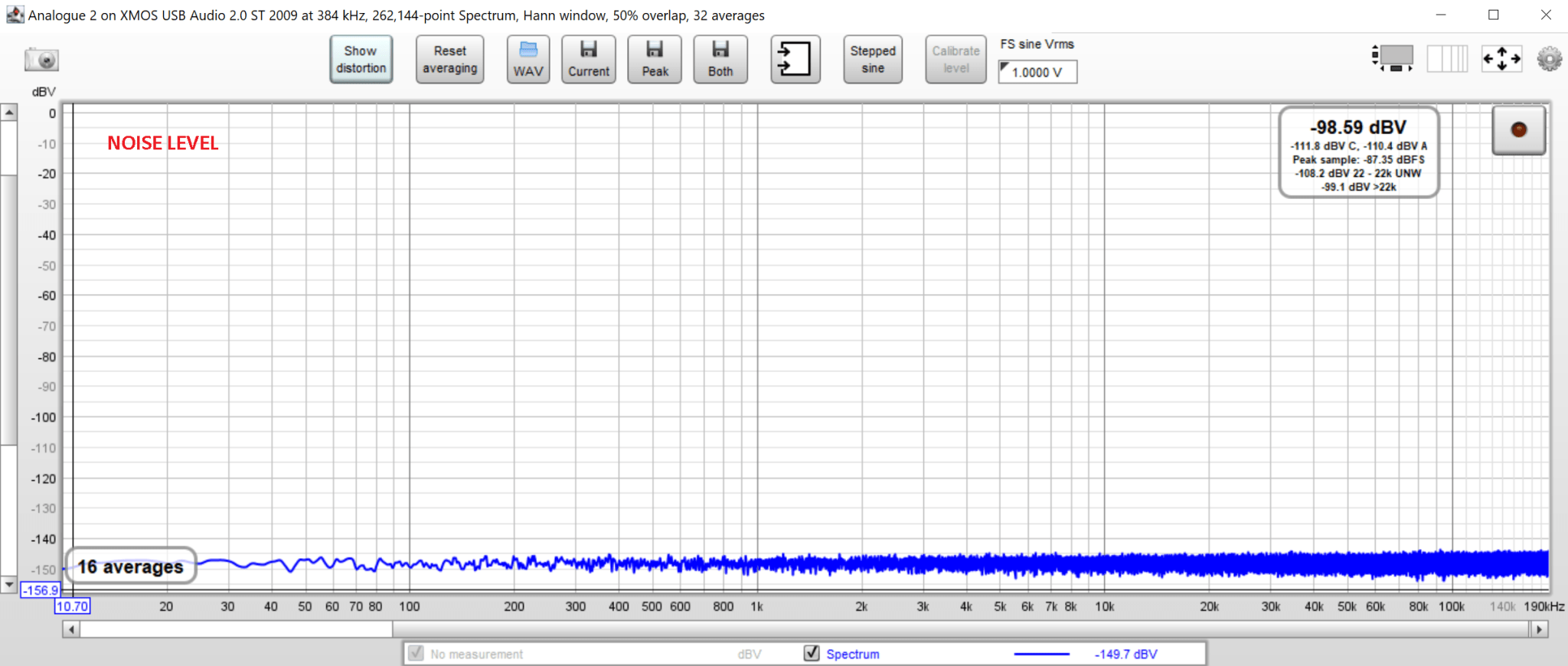

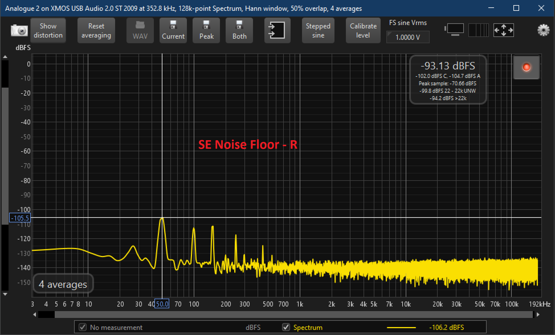

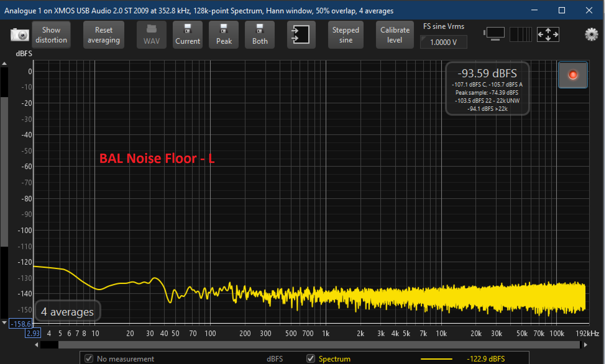

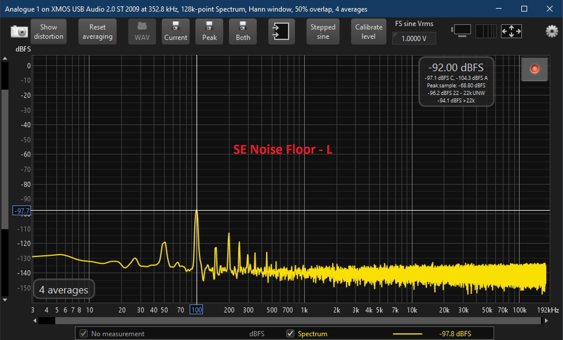

Now I am at measuring performance stage. My target is to reach or exceed studio reel-to-reel tape recorder performance.
So far did noise floor measurements, not disappointed!
