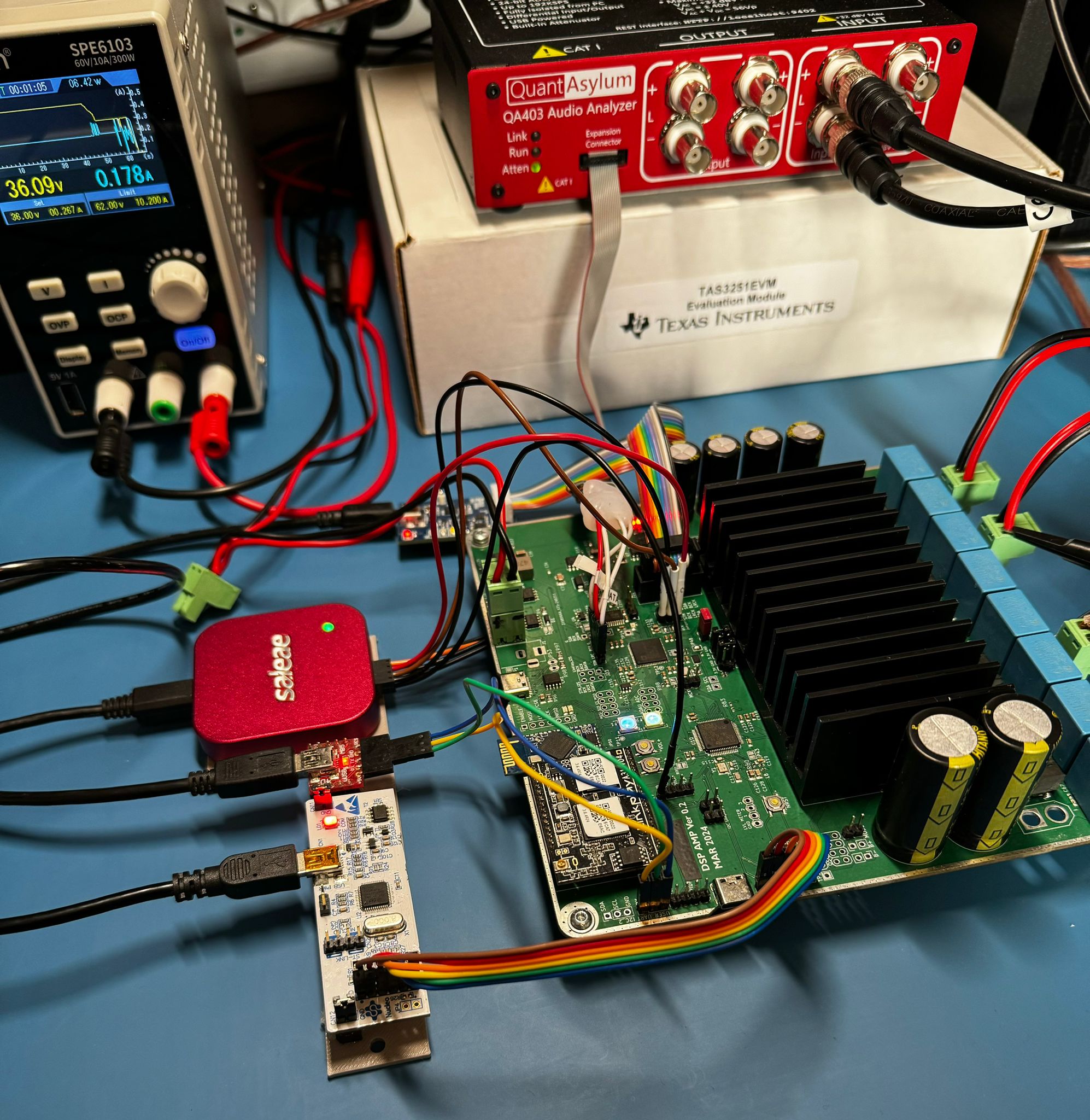

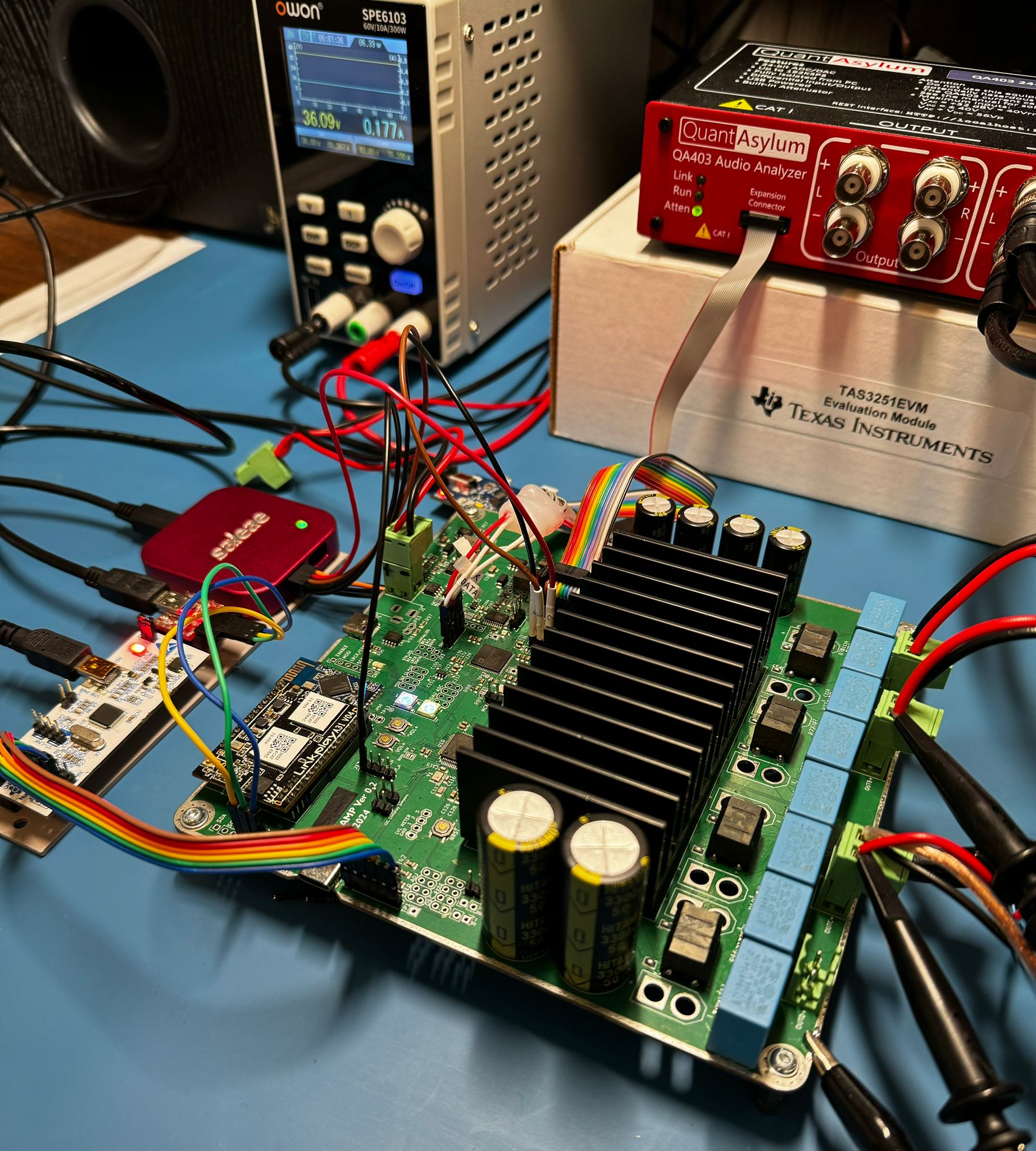

This is a prototype of our audio amplifier, which is based on the ADAU1452 DSP and two TAS3251 chips in the output stage. This setup provides a total output of 4x175W (or 2x350W) at 36VDC.
After several months of development, we now face some critical decisions, the most important being the viability of this device for mass production and the potential features to add or remove since this proof of concept.
This version is not the final iteration; we are still optimizing certain parameters. Most notably, the THD+N currently measures at 0.08% at 100W into 4Ohm and 0.008% at 10W into 4Ohm, with an A-weighted noise floor around 105uV. While these numbers are quite good, they do not fully match the TAS3251 datasheet. We are continuing to optimize the PCB layout, LC filter components, and PFFB.
We aim to provide plug-and-play functionality for this device, meaning users will not need to tweak the ADAU DSP and can select one of the pre-made use cases that are easily configurable and controlled via a user interface. For more advanced users, full access to the ADAU DSP will be available using SigmaStudio.
The main firmware, based on FreeRTOS, runs on an STM32F4 MCU. This MCU initializes and controls the DSP and amp chips, among other functionalities on the board. The audio signal path is also managed through the MCU, allowing for various measurements such as level metering and FFT. Additionally, the MCU handles USB audio input and the user interface.

2) We have tuned the components in the analog signal path and reduced the THD+N significantly. With proper utilization of PFFB and quality components in LC filters, we can now achieve THD+N as low as 0.008% at 100W. With the next PCB revision, that is currently in manufacturing, we expect this value to go even slightly lower.

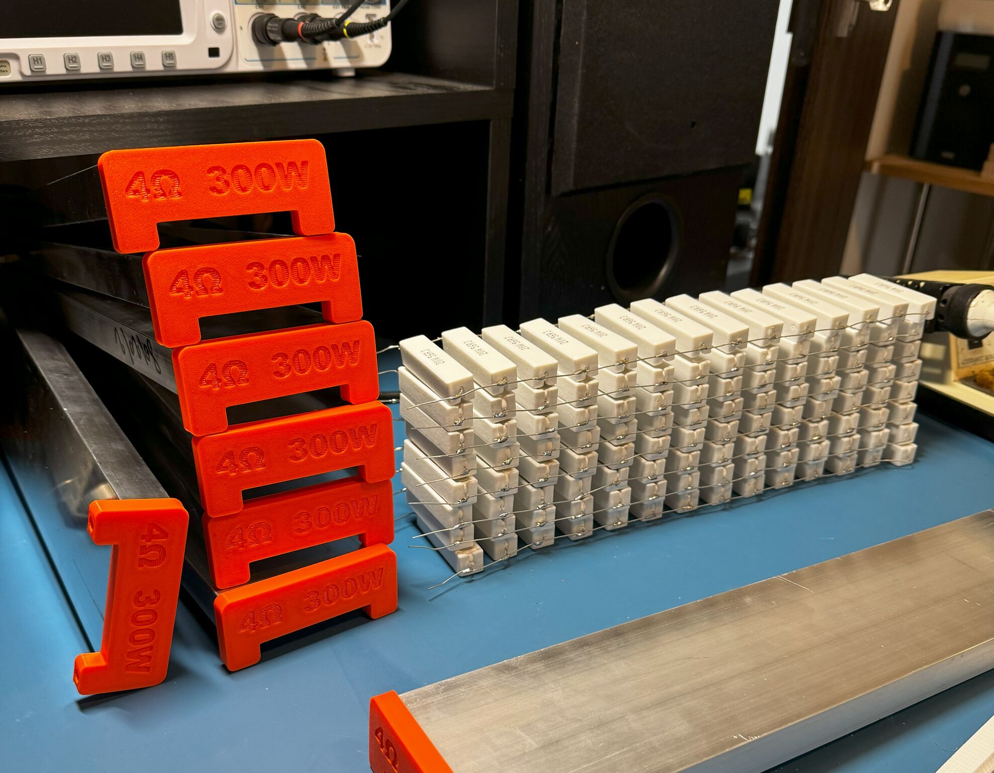

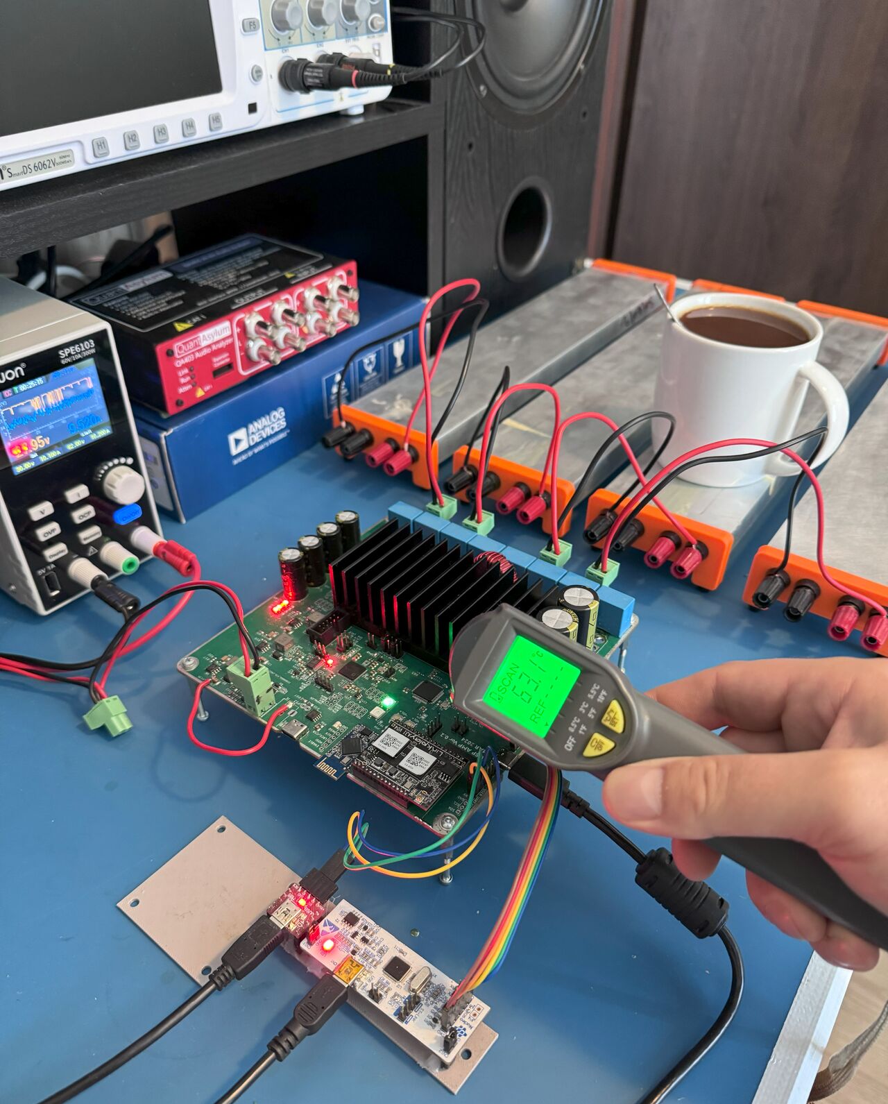

3) We did extended stress testing to verify passive cooling and the results are satisfying.

It was an experiment which turned out good. We used the components recommended by TI in their app note for TPA3251. We also tried different values of the components but the default ones yielded the best results. Compared to not using PFFB, the difference in THD+N is not so critical, few dBs I would say, but it is worth the low cost of PFFB components.
