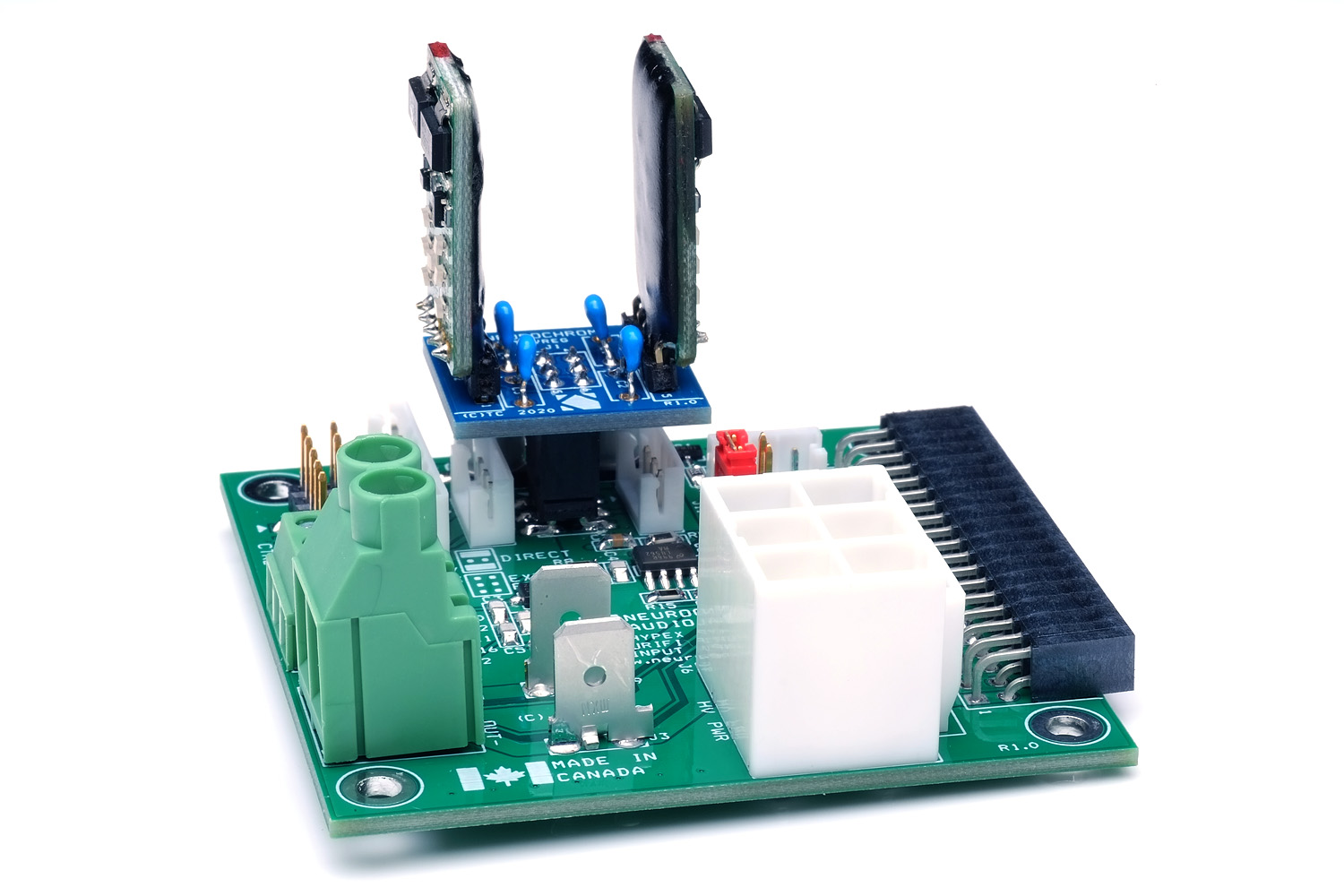

The Purifi 1ET400A / Hypex NC500 Input Buffer is exactly that: A buffer or gain stage intended for use with the Purifi 1ET400A and Hypex NC500 Class D amplifier modules.
The key features of the Input Buffer are:
The Input Buffer will be available by mid/late April. You can preorder yours and see the full specifications here: Neurochrome Purifi 1ET400A / Hypex NC500 Input Buffer Product Page.
The pictures show a prototype (green board). The final version will provide identical performance and be Neurochrome Blue.
- Sonically transparent as evidenced by the ultra-low THD, IMD, and noise.
- Differential (balanced, XLR) input, which can easily be configured for single-ended (unbalanced, RCA) operation as well.
- Jumper-selectable gain: 0 dB and 13.2 dB for a total amplifier gain of 12.8 dB and 26.0 dB, respectively, when used with the Purifi 1ET400A.
- Gain can be further customized by adding a resistor (1206 size SMD and leaded/PTH supported).
- Plug-and-play connection with Hypex SMPS1200 and future Purifi power supply.
- Opamp power supply: Use the AUX supply provided by the SMPS1200, or add your own regulator. A small daughterboard with support for the Hypex HPR/HNR, LM7812/LM7912, and LM78L12/LM79L12 is available as an accessory option.
- Status indicator LED output (NC500: CLIP and READY; 1ET400A: READY).
- Supports power supply shut-down in the event of amplifier failure when used with the Hypex SMPS1200 power supply.
- Speaker output is provided both on 6.3 x 0.81 mm quick-connect spades and a terminal block accepting up to AWG 10 (5.2 mm2) in size.
- Gold plated 4-layer PCB, 63.5 x 63.5 mm, RoHS compliant, Made in Canada.
- The buffer can be disabled by removing two resistors. A three-pin connector footprint provides direct access to the Purifi 1ET400A / Hypex NC500 input.
- A two-pin connector footprint provides access to the remote sensing pins of the Purifi 1ET400A / Hypex NC500.

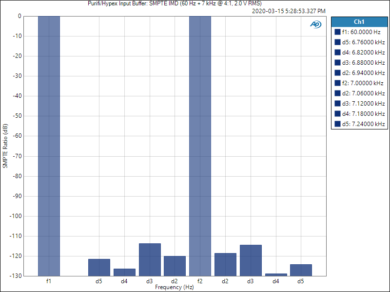

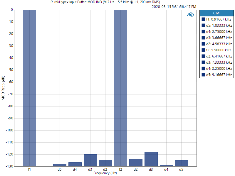

Purifi_Hypex Input Buffer_ SMPTE IMD (60 Hz + 7 kHz @ 4_1, 2.0 V RMS).png26.5 KB · Views: 592
Purifi_Hypex Input Buffer_ MOD IMD (917 Hz + 5.5 kHz @ 1_1, 200 mV RMS).png26.3 KB · Views: 518

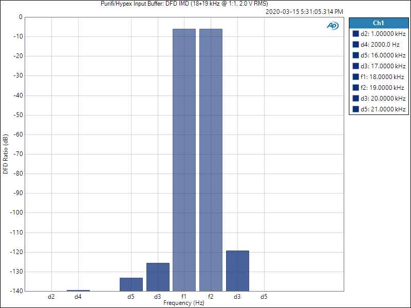

Purifi_Hypex Input Buffer_ DFD IMD (18+19 kHz @ 1_1, 2.0 V RMS).png23.3 KB · Views: 537

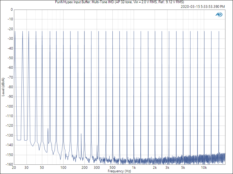

Purifi_Hypex Input Buffer_ Multi-Tone IMD (AP 32-tone, Vin = 2.0 V RMS, Ref._ 9.12 V RMS).png56.2 KB · Views: 587

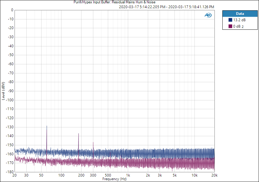

Purifi_Hypex Input Buffer_ Residual Mains Hum & Noise.png53.8 KB · Views: 567

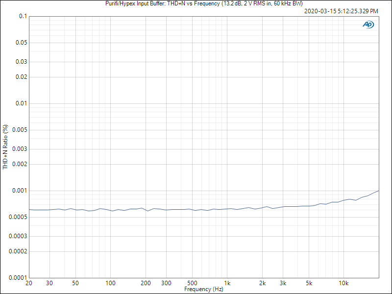

Purifi_Hypex Input Buffer_ THD+N vs Frequency (13.2 dB, 2 V RMS in, 60 kHz BW).png25.1 KB · Views: 2,203

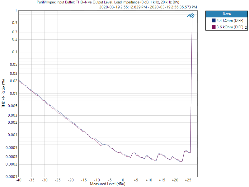

Purifi_Hypex Input Buffer_ THD+N vs Output Level, Load Impedance (0 dB, 1 kHz, 20 kHz BW).png33.5 KB · Views: 2,310

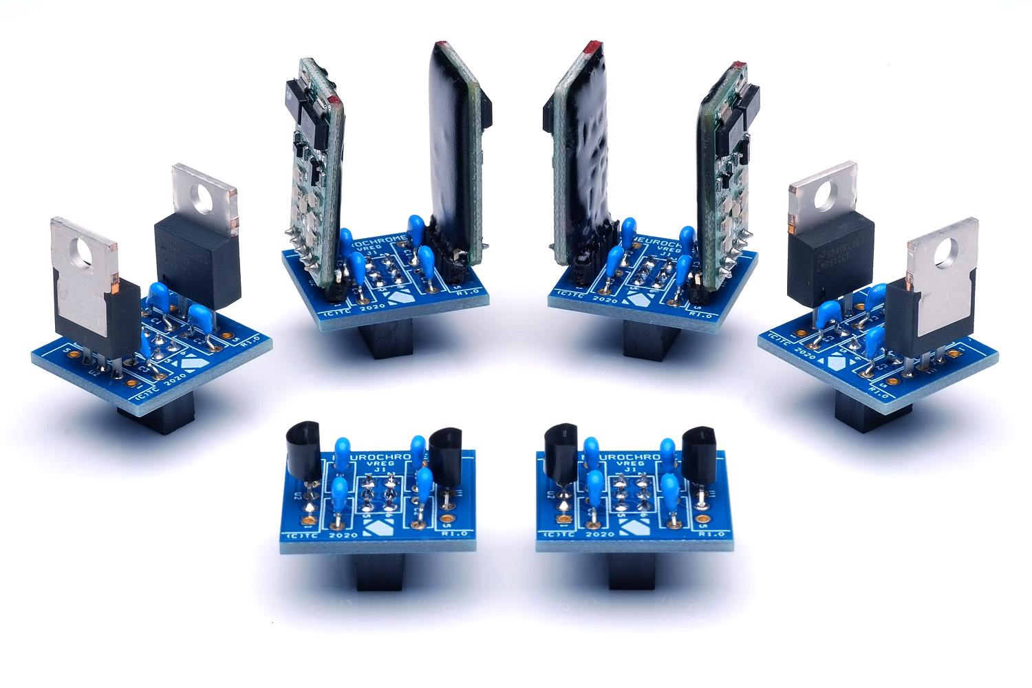

Interestingly, the Purifi spec sheet says it takes 9.6 V RMS to drive the amp to clipping. 9.6 V RMS -> 13.6 V peak, which is beyond their own spec if a single-ended source is used. This means a single-ended source cannot drive the amp to clipping.
Just for reference: 9.6 / 4.57 = 2.1 V RMS, which would indicate that a gain of 4.57 (13.2 dB) is about perfect for single-ended operation. Those who use equipment with differential output would benefit from shaving 6 dB from the gain.
I think this boils down to whether you really, really want the last picoBell of power with a single-ended source. 2.62 V RMS, single ended, would result in 343 W. With a differential source you'd get over 400 W. That may be a selling point for some.
Tom

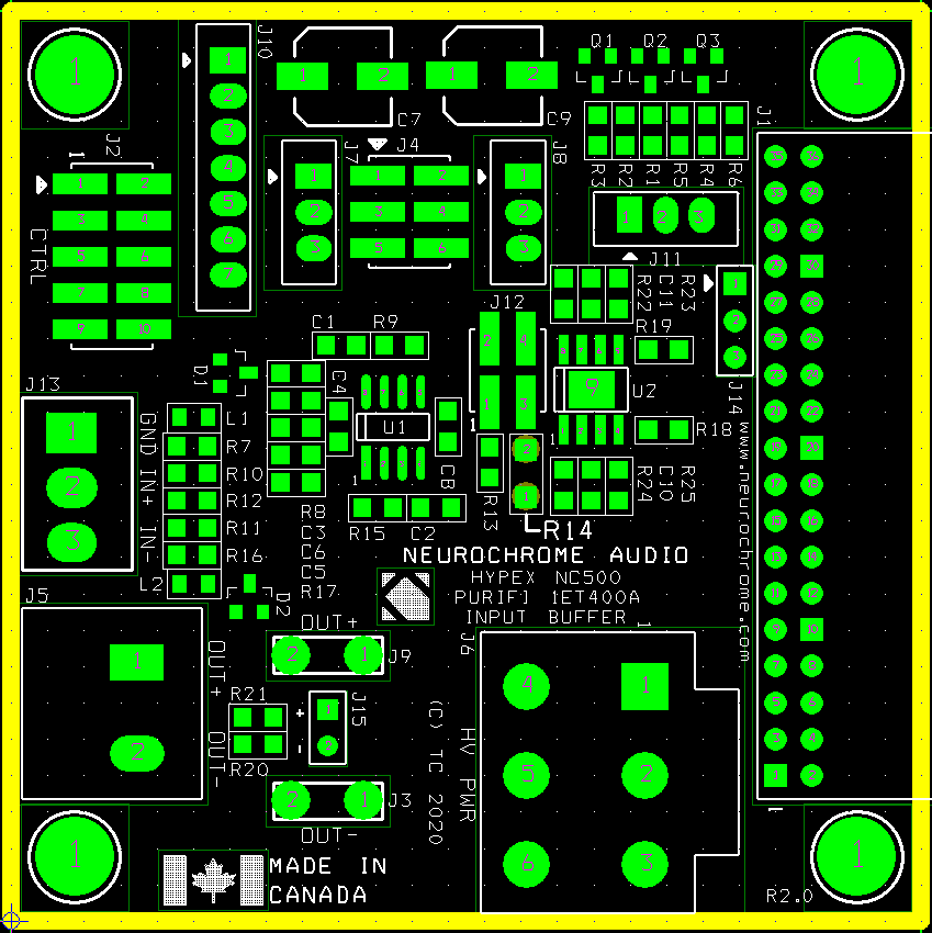

And just like that Revision 2.0 was born.
I was able to fit in a proper differential output in the Input Buffer layout. This means that those with single-ended (RCA) sources will be able to drive the Purifi/Hypex amp to clipping with a 2.0 V source without exceeding the input voltage spec on the Purifi modules.
I need to sleep on it and double-check everything, but I should still be able to hit the mid/end of April production target. I may have to increase the price slightly, but I need to do the math before I can commit to a new price. I will honour the price on all orders placed until I've done the math, i.e. order now and get your Rev. 2.0 Buffer at the current prices.

One note also - the above measurements are into 4.4k and 3.6k but I measured the impedance to be 1.58k here. Or does your 3.6k mean that there is a 1.8k resistor in each positive and negative input leg?
The input impedance of the Purifi 1ET400A is specified to 4.4 kΩ differential (2.2 kΩ from each input to ground). The Hypex NC500 is 3.6 kΩ differential (1.8 kΩ from each input to ground).
Similarly, my 4.4 kΩ differential load was comprised of two 2.2 kΩ resistors, one from each input to ground. The 3.6 kΩ load was comprised of two 1.8 kΩ resistors.

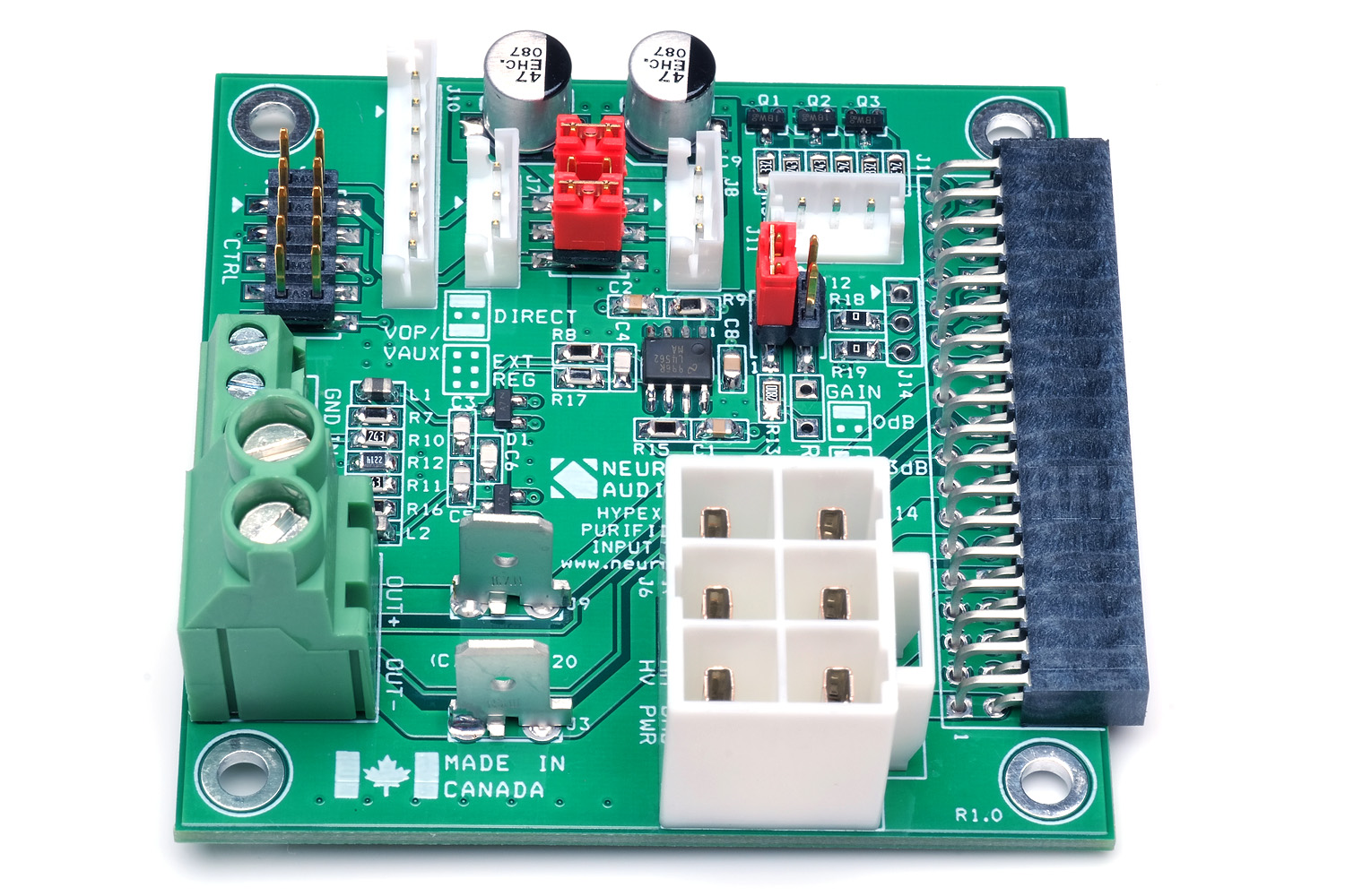

I am the lucky owner/tester of two rev 1.0 prototype boards by Tom.
You can see them added to my Purifi/Neurochrome build here:
They work flawlessly with their buffer on (I only tried the 13.2 Db gain option), from the sonic point of view I did not hear significant differences w.r.t. the EVAL1 board, which means that they are probably both very transparent. I used the little daughterboard with two Hypex regulators on top.
These boards are really plug-and-play, so even an inept DIYer like me could make them work soon (we forgot to connect nAMPON to ground, so they initially they did not start, I then added a little jumper to connect the corresponding pins on one of the many connectors).
Later, I removed the two 0R resistors R18 and R19 that connect the buffer to the signal output pins, as you can see in the next pic:
I installed board-to-board pins on the provided holes and then soldered my Canare mini star quad to connect the output of the Universal Buffer. So my use of the boards is as a breakout board with space for a second regulation stage for modulator and comparator (I have a single Sulzer regulator providing ±18V, and then a pair HPR12/HNR12 per board bringing it down to 12V).
The result, in its fully over-engineered glory is this one
A couple more pics of the build, with its light blue plexiglass cover:
and
These boards are mostly for people doing monos (or three, five... channel amps), stereo builds with the two channels far from each other, or (most importantly) for people with single ended sources that want to have a proper and real differential output as an input to the 1ET400A modules (the latter feature is not present in the rev1.0 boards, but I only have balanced sources). None of these is my use case, and I could have continued to use the FE02 boards with bypassed buffers. But I could not pass the opportunity to help a designer that likes to do Engineering. Done. Right.
Among the cute features: the LEDs are on harnesses, with JST B3B connectors, so one can easily bring the green LEDs on the front of the amplifier, signalling proper operation through holes. I did not do that but I am keeping the LEDs in the amp.
