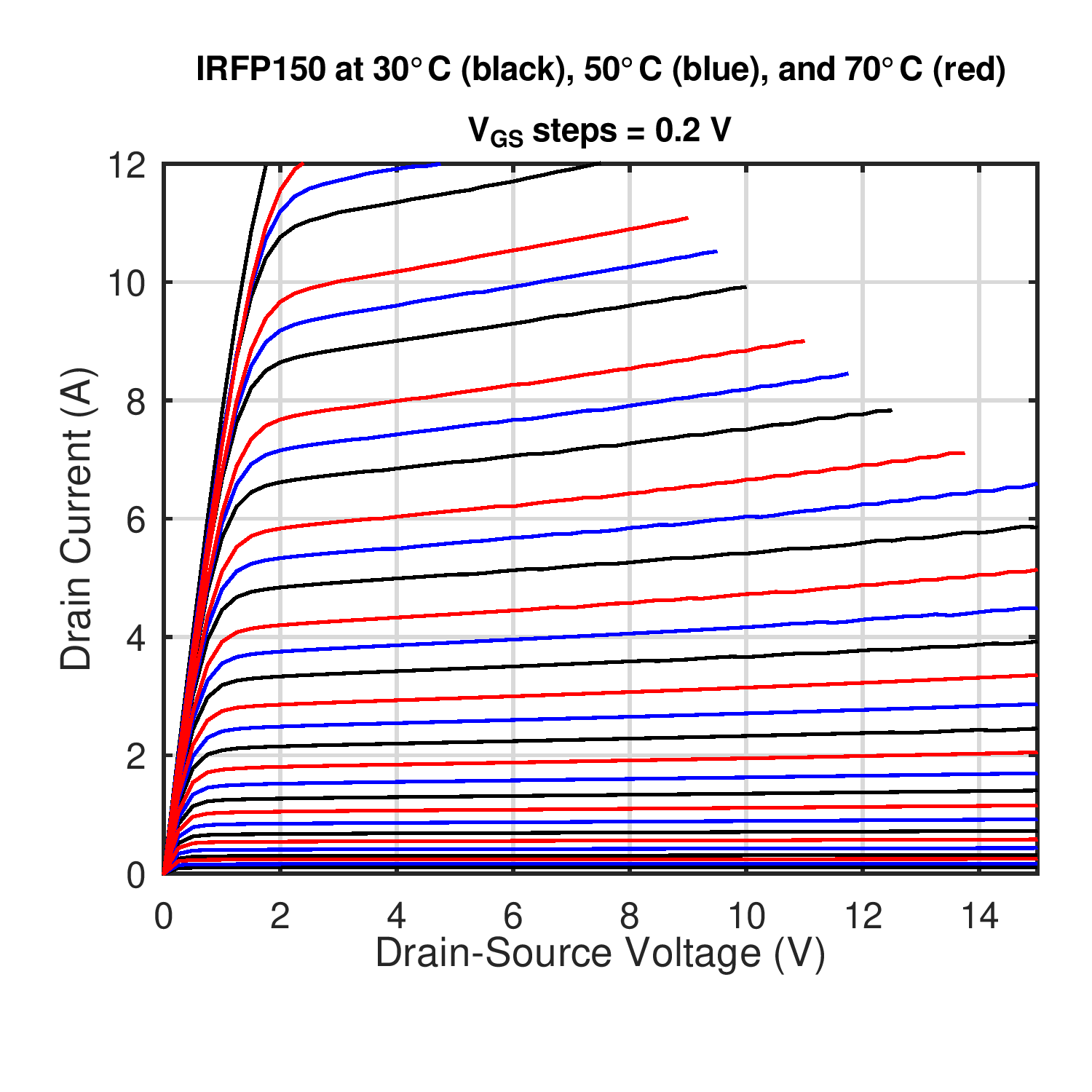

My personal interest with the curve tracer is to add a controlled heater block that allows tracing power transistors/DUTs at controlled temperature conditions. The idea is that the the program regulates the temperature of the DUT using a temperature sensor and some heating elements (power resistors). The curve tracer will only take readings from the DUT if/when the DUT temperature is within a predefined tolerance of the target value.
I added this and the items from the above posts as feature requests to the source code repository at GitHub, so they are on the todo list. That does not mean that I promised to implement them soon ;)
I played with the heaterblock idea a bit. It works! See attached plot of an IRFP150, which I traced at constant 30°C, constant 50°C, and constant 70°C.
Sure, a transistor could be used as a heater element. However, there needs to be something that makes sure the temperature of the heater block remains constant even if the DUT is dissipating heat into the heater block.
I used some power resistors bolted to the heaterblock. The resistors are driven by a power supply that is controlled by a PID controller implemented in the curve tracer program. The PID controller reads the temperature of the heaterblock using a DS18B20 temperature sensor and adjusts the power supply output such that the heaterblock remains at the desired temperature.

You still need to consider the time needed for the PSU(s) to read the voltage and current values, and to transfer these values to the computer. That's easily a lot more than the 10 ms you are suggesting, so the FET switch needs to be on for much longer, and self heating may still be a problem. Oh, and we'd need yet another USB/serial interface that controls the power FET switch. I am not sure this is the way to go.
What I did to solve the self-heating issue was to mount the DUT on a block of copper with a controlled (fixed) temperature. The copper block has a temperature sensor and some heater elements that allow setting the block to just about any temperature you want (as long as it's above ambient). The PyPSUcurvetrace software controls the temperature of the copper block during curve tracing. If the temperature goes out of tolerance, curve tracing is stopped until the temperature is back where it should be. Works like a charm!

I see a potential issue with the heatsink/block. Even when temperature-controlled, the junction temp of the DUT would still climb, possibly significantly, during the test period.
That's out of your control. You can increase test time to let the junction temp stabilize, even calculate it, but then you're back at square one, too long test times.
