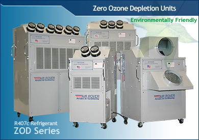

Ive been wondering if you could get away with leaving the side vents open and drawing indoor air.
Hear is a picture and web site for some commercial units that do the same, to provide you with a little inspiration.
These things typically run a single large house into a ceiling plenum or out a window and spew cold air out the little houses on the front.
They either pump condensate out a house or have a bucket with a float switch attached to catch the condensate.
I hope you have a big enough electric circuit for that puppy. It would be a shame to have an electric fire while trying to stay cool.
You have me wondering about using a $100 AC unit with a power inverter to cool my 87 Jeep Cherokee. Its an old beater and not worth the $900 gamble for the new evaporator that might get the AC unit working in it.
http://www.airrover.com/
