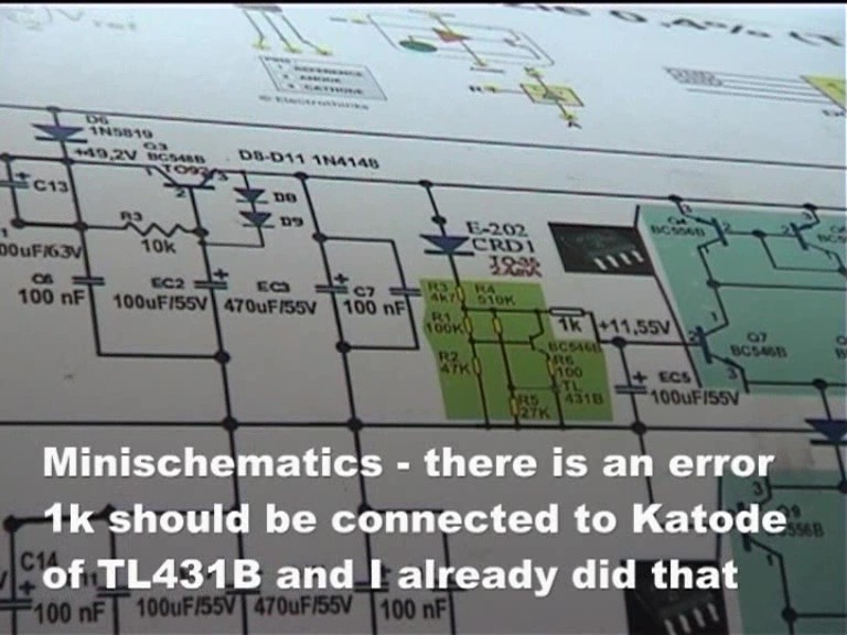

Sigma 22 is too complex in order to make profound modifications. I soldered today another 2 Q17 motherboard, the 4th one I'll finish tomorrow then I'll test each of them. Just to be sure that 4 modules are ok and work good at 59V. Then I'll return to Sigma 22 and add the TL431 and see if there is any improvement in precision (step 2). It is important to know this before going into further modifications. Maybe I might decrease the 10V difference from input-output ... that could be also important (step 3). Step 4 would be 5 amps test on both rails simoultaneously as well as independently. If the drop out would be less then 1V, then Sigma 22 is worth having in a miniaturised version. I'll keep you updated, Stef !

Ok, need more tests until then, but I'll make a dedicated thread. I don't have a kicad diagram and I barely work with any software... it is difficult for me. Let me try first the TL431 tomorrow morning to see if it worth adding on the schematic.
Hi Stef

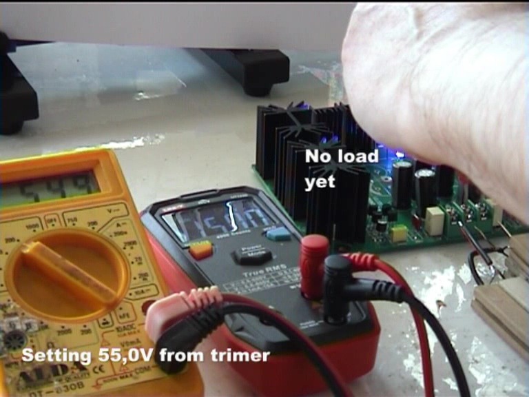

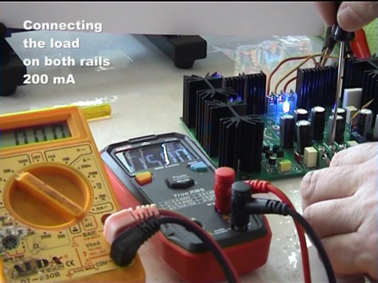

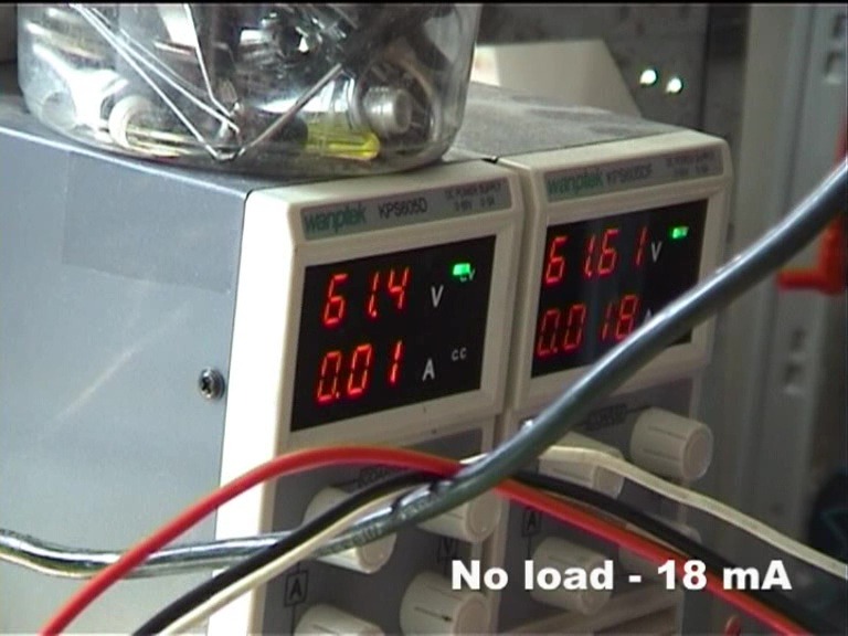

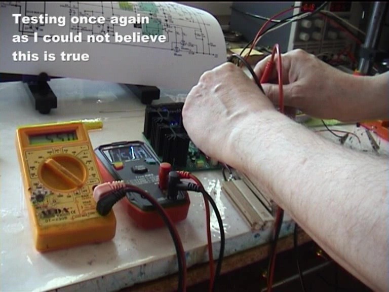

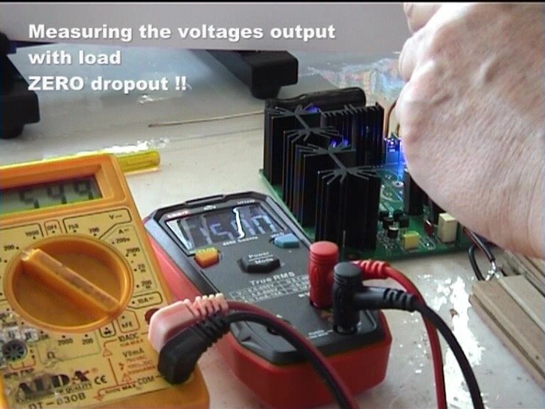

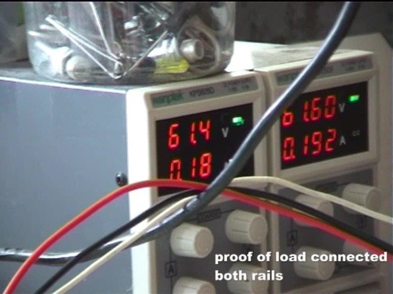

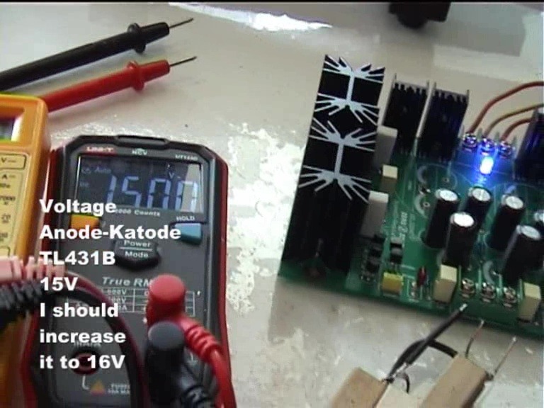

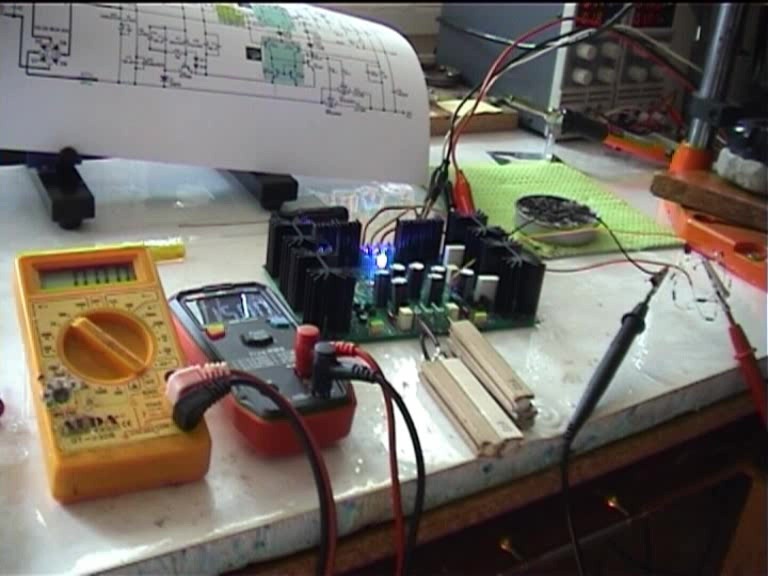

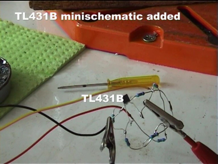

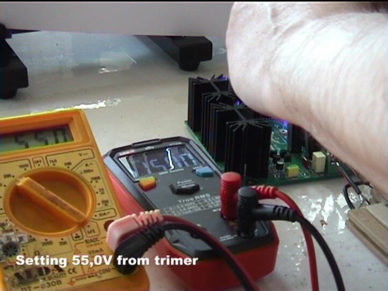

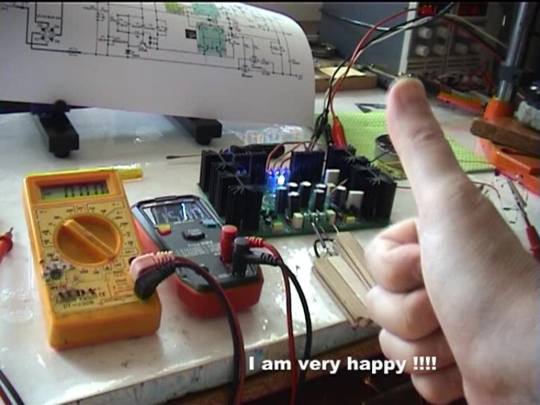

I have some wonderful and very hopeful news for you. I have tested the circuit TL431B.
I have also made a video and extract some photos.
This time is zero volts dropout on 61V input and 55V output. And this time I reduced the difference input output voltage from 10 to 6Volts !!
Proof attached with english text inserted on each frame.

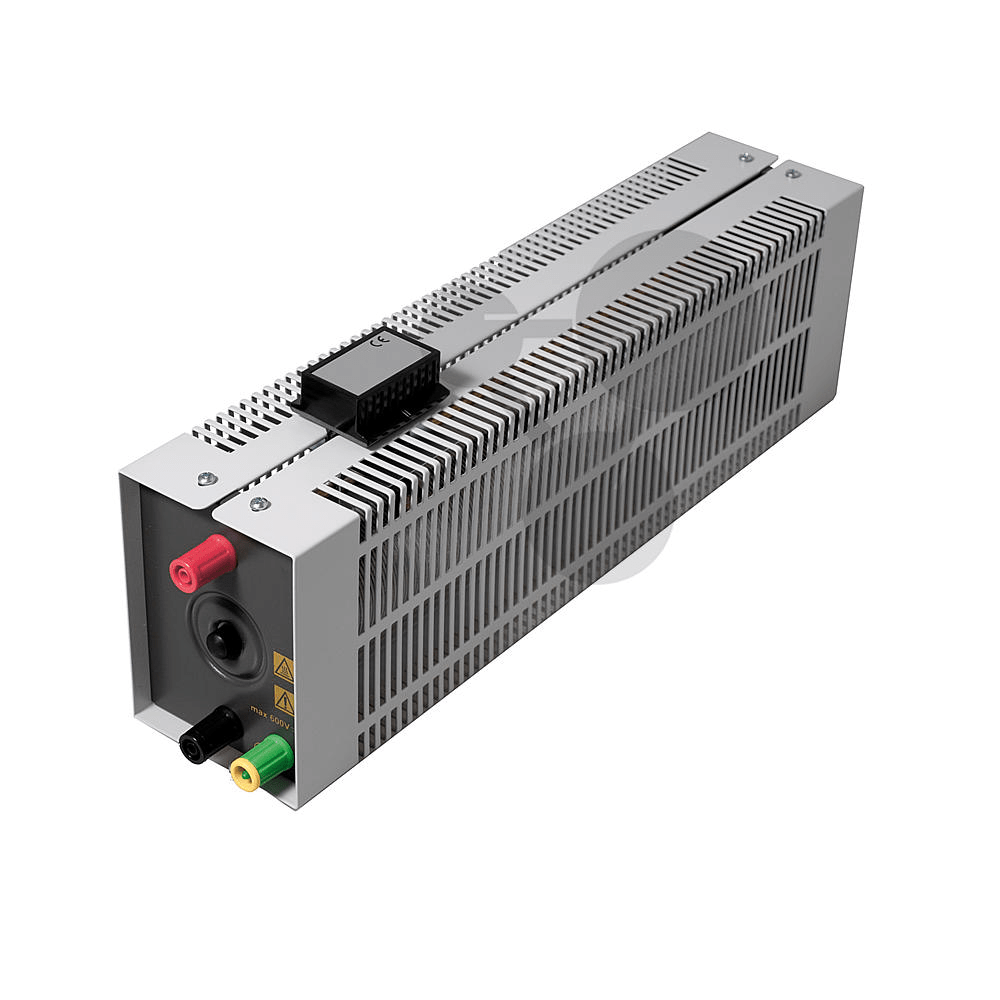

Next, I'll try to visualise the microvolts ripple according to TL431B producers, and then go to a university lab in order to test from 1 to 5A continuous load, using a powerful variable reostat (a very big 1 meter long potentiometer).
But I am already very happy about this morning result. The photos are in order from left to right, and top to down.

Don't forget to take your thermometer when you go to play with the 1 meter long potentiometer. 😉
I have a portable minivideocamera with IR light rase and show on the screen ... I'll borrow the reostat from a laboratory for few days and then I'll return it back. Just to see how it works and variable amps ... and how much voltage drop I might encounter ... or not encounter, hopefully ...

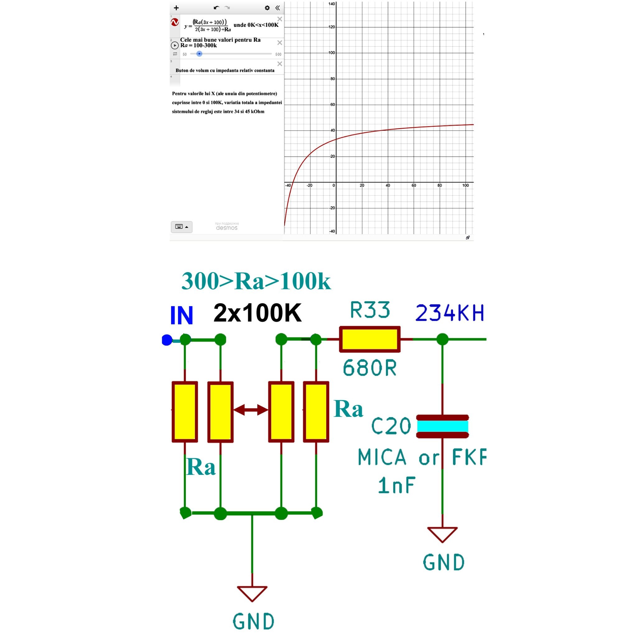

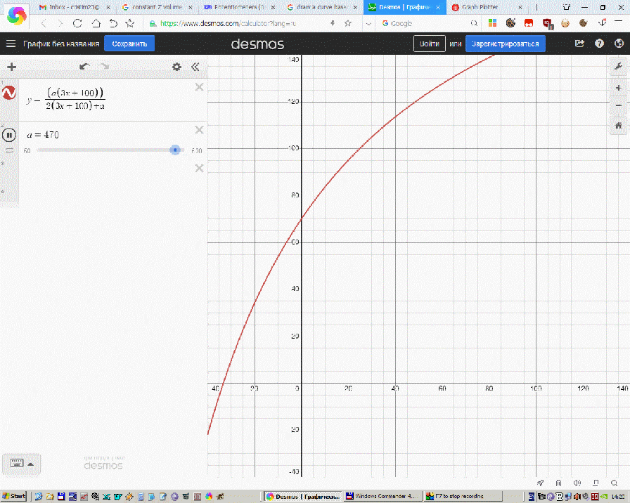

I tested a stereo Q17 modules with a newly improved constant Z quadruple potentiometer for stereo signal.
I searched an online formula graphic calculator, I have input the formula for the schematic (100k resistor and 100k double potentiometer) and the graph show at the intersection with the vertical axes, that the Z is ALMOST constant ... actually very small variations from volume zero to volume maximum.
Here is a video test with music (link for download 7 days: https://we.tl/t-jw0vtyPhea
