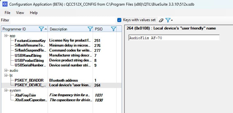

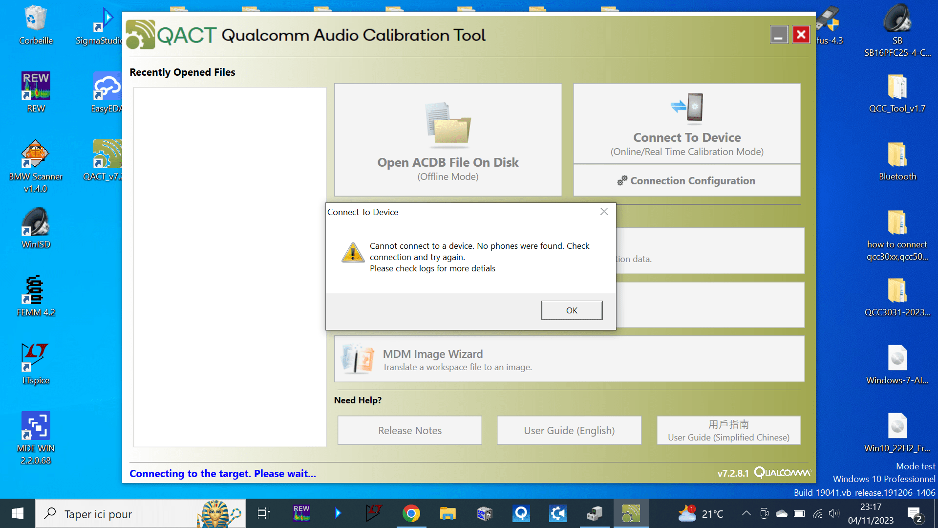

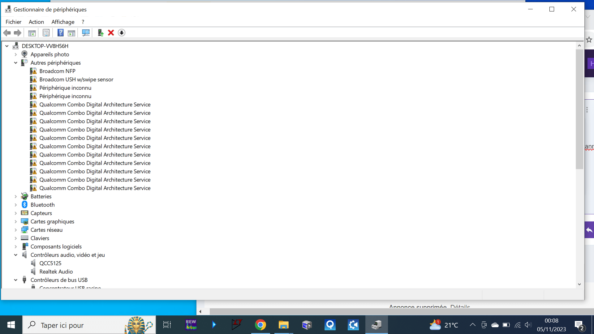

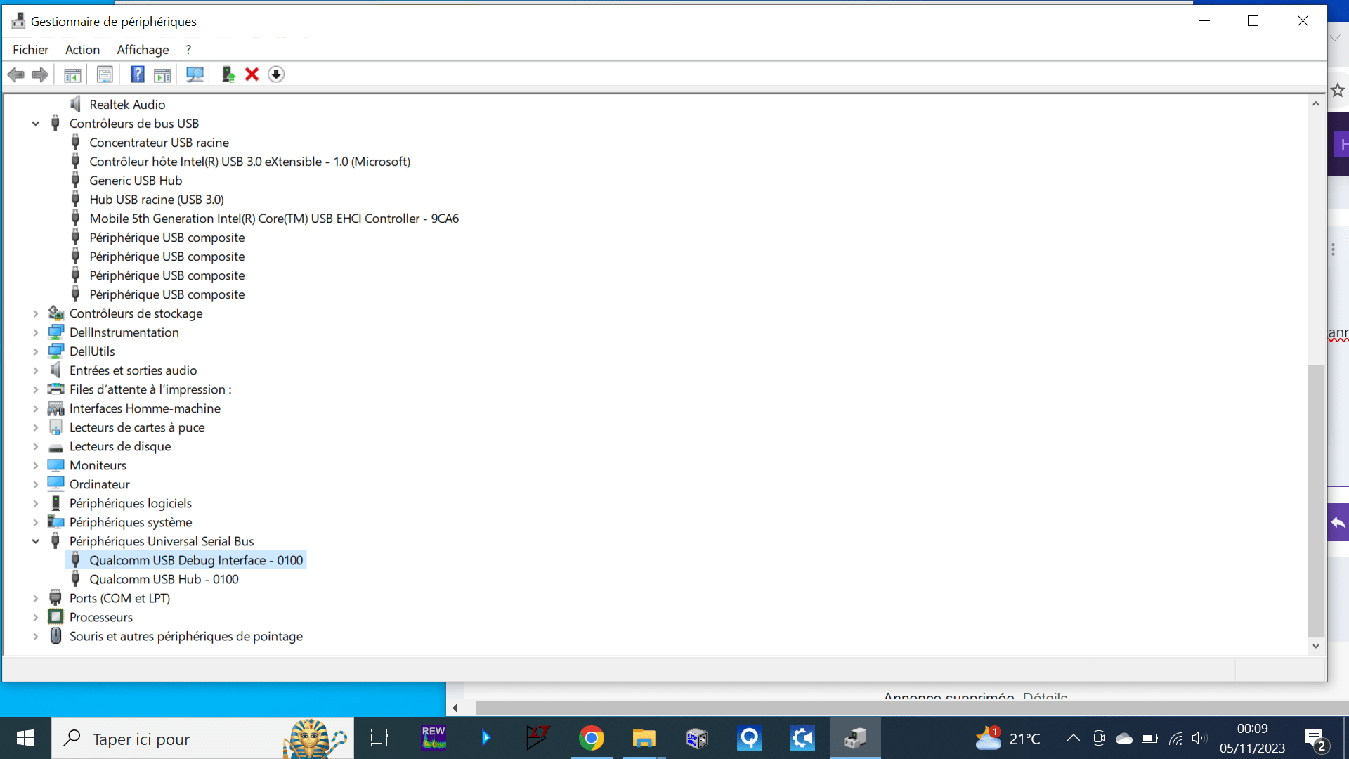

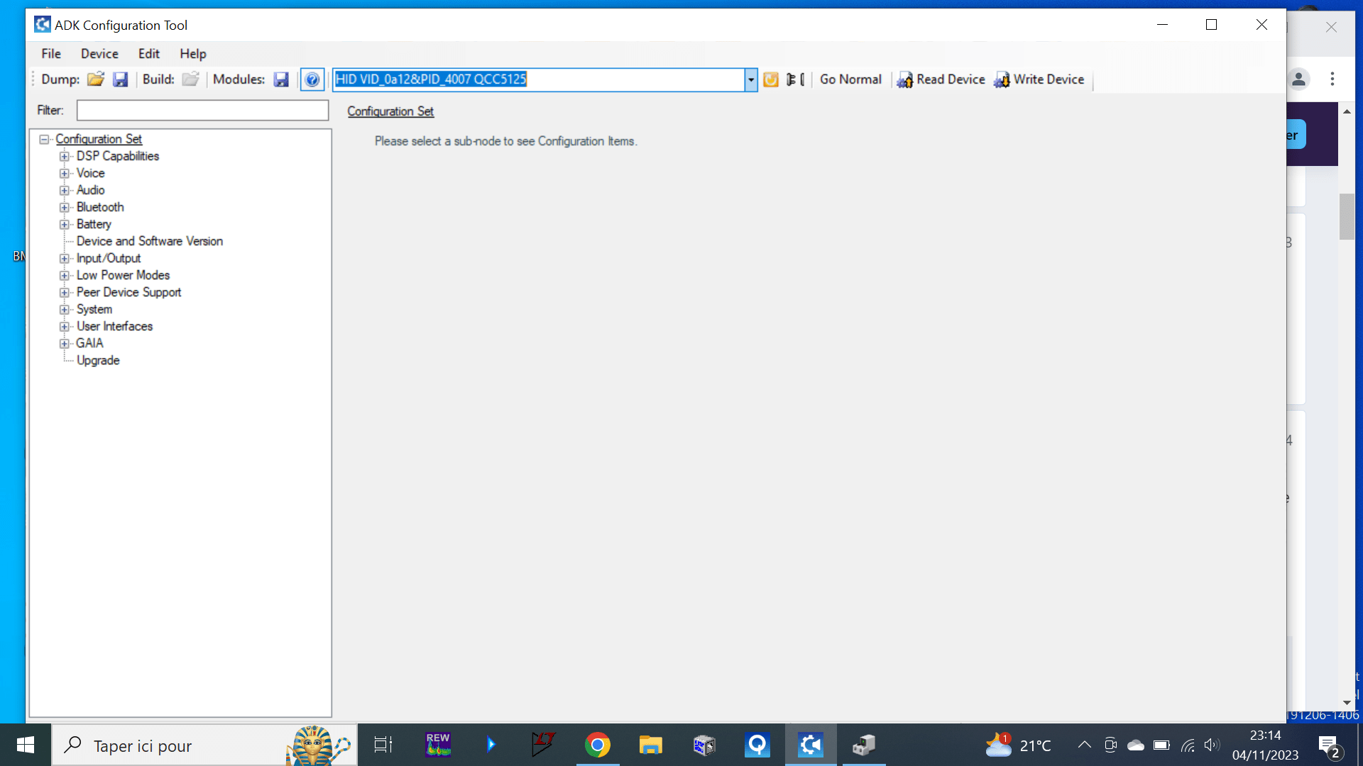

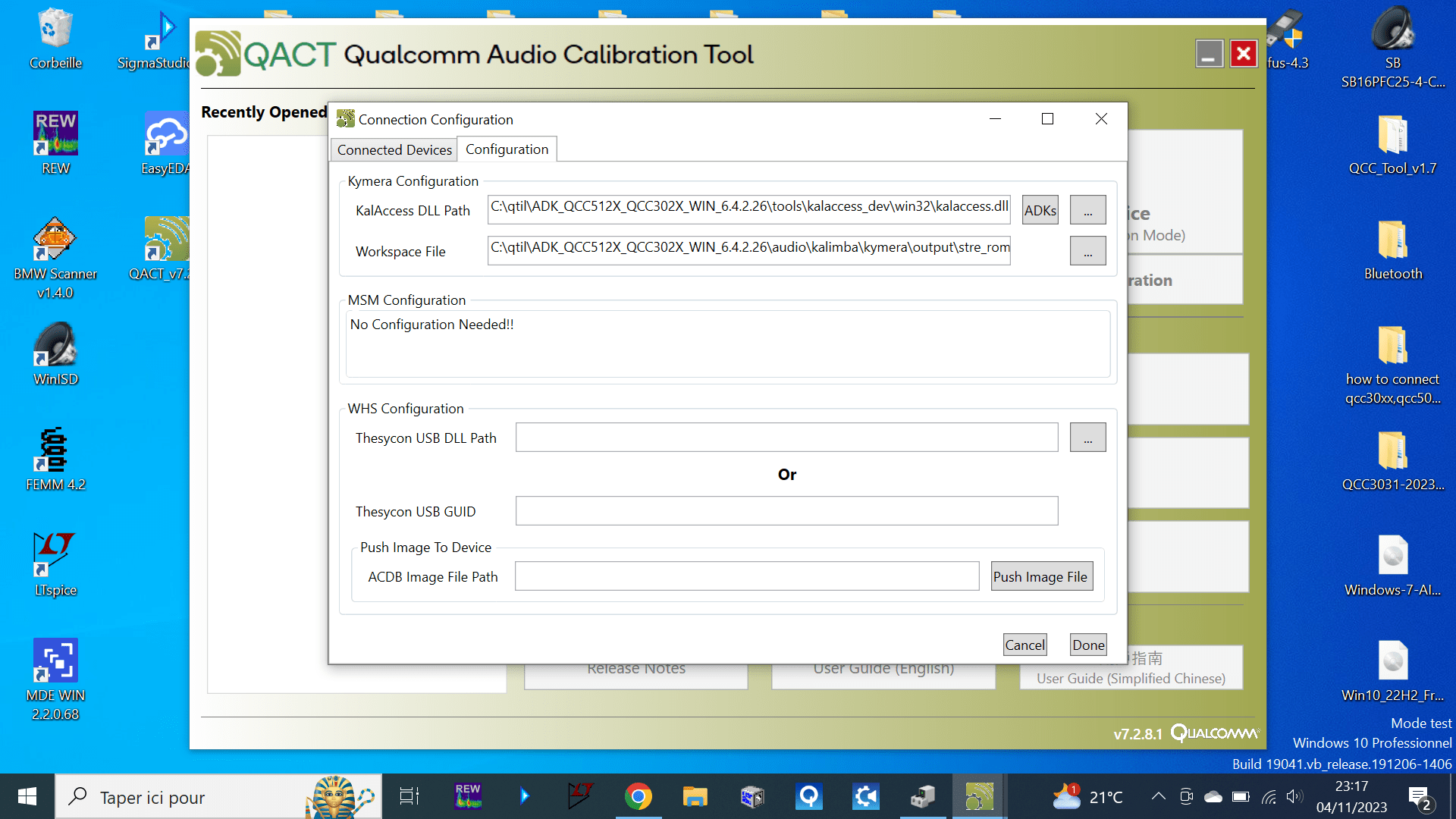

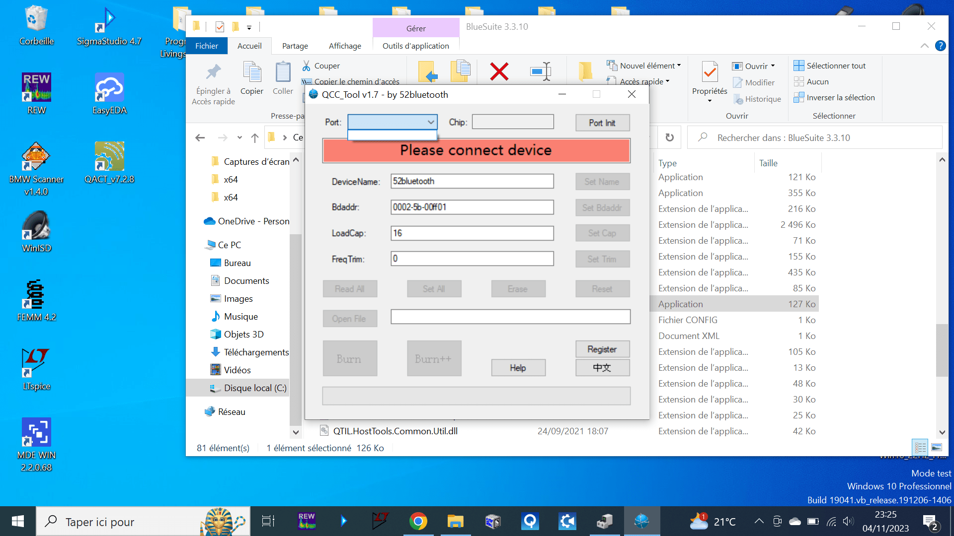

Do someone can help me with usb connection with qcc5125?
Drivers seems to work, I can see the qcc5125 in the ADK Configuration Tool and can configure it,
but I cannot connect to it in qcc tools to change name, nor in qact to configure DSP.
You will find screenshot of the differents involved windows.
Thanks a lot
Hugues
View attachment 1231058 View attachment 1231059 View attachment 1231060 View attachment 1231061 View attachment 1231062 View attachment 1231063

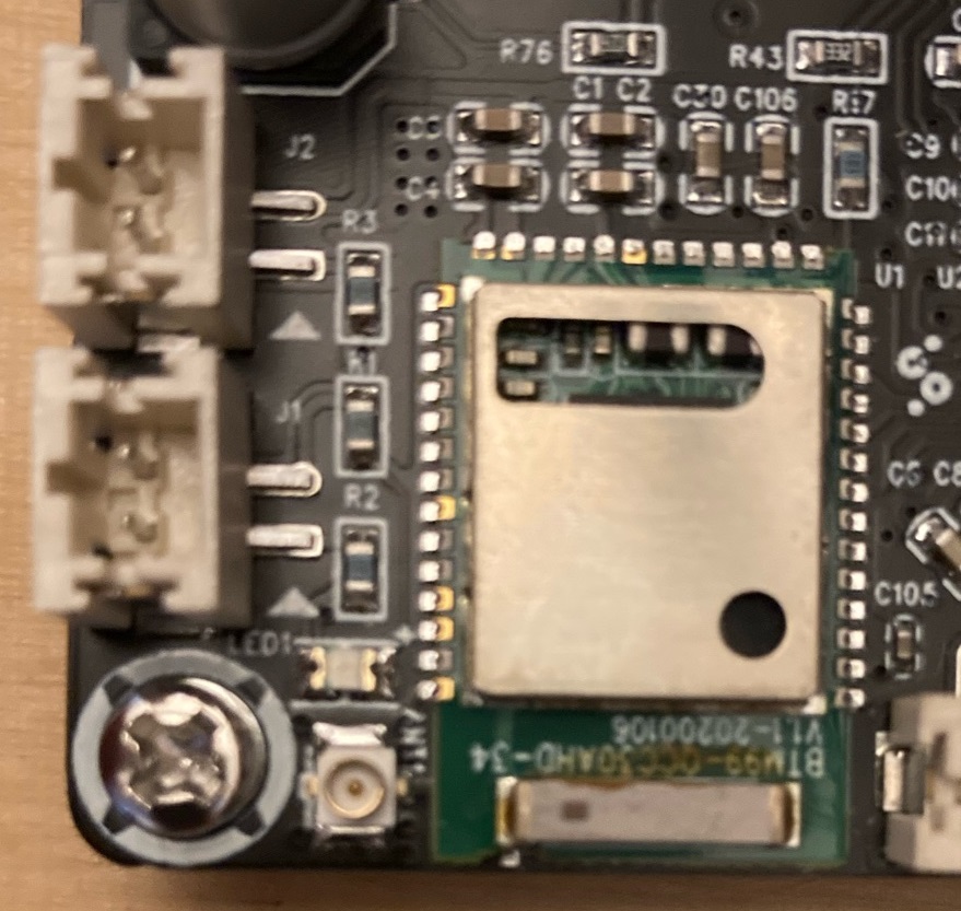

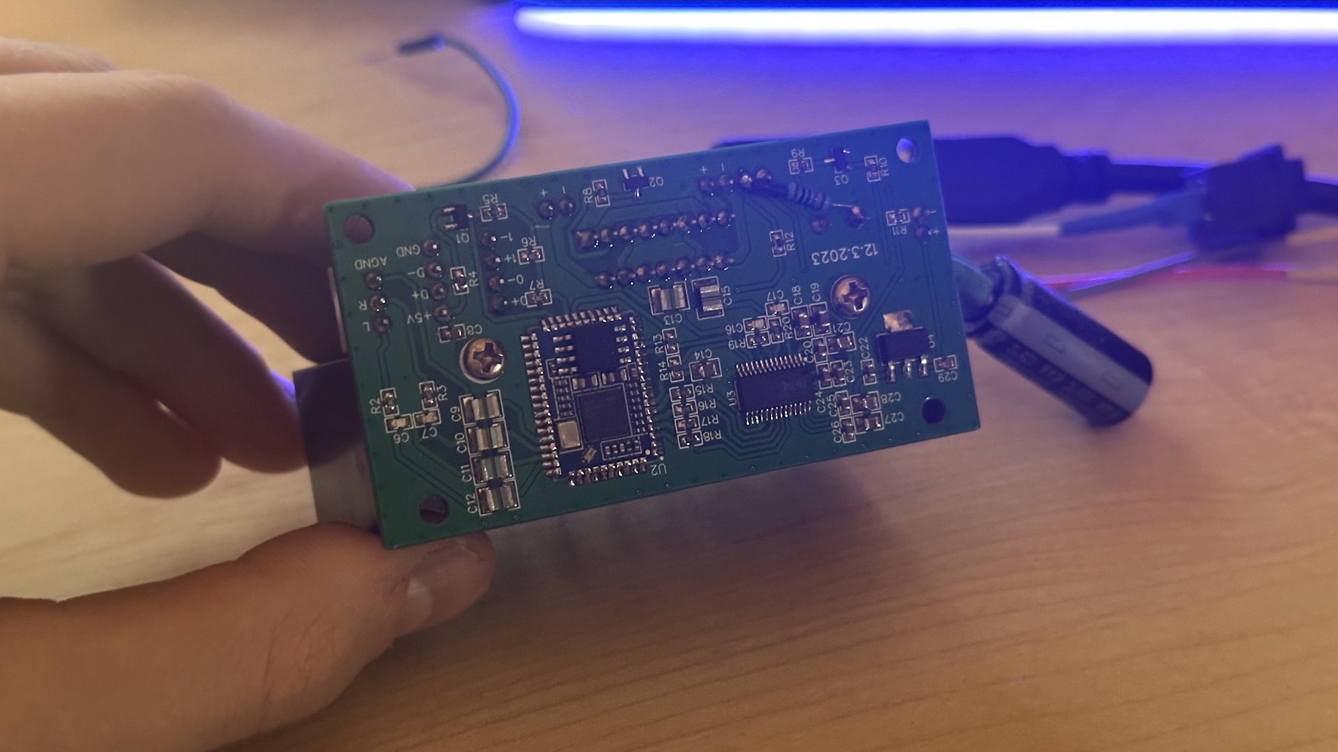

Hi I'm finding this months later,
I'm using the Wondom JAB5 (aka Dayton KABD 4100), and trying to change the name of the bluetooth transceiver, as you did with the qualcomm chip earlier in this discussion.
Wondom hid the name of the bluetooth chip but on the Dayton one you can read BTM99-QCC30AHD-34, and their website tells it is Qualcomm so I'm guessing the green chip is based on Qualcomm's QCC3034 but I can't find what that particular green chip is, to find a pinout and program it with QCC Tool.
Would you have any idea of what that chip is or where I can find the pinout?
@batttoleo If all you want to do is change the name, try the android app in post #121.
Have You had any luck contacting Wondom?Hi,
thanks a lot for your reply.
It will be a game of patience to find out which pin is which
I allready asked Wondom, let's see if they mind sharing it. GND will be pretty easy, maybe VCHG too, the other ones will be harder to find without reply from wondom.
F.
I'm guessing no, since (I think) they sell the renaming and are not very responsive on this subject
Tested but it seems to change only a software name or something, because its bluetooth name is still WONDOM@batttoleo If all you want to do is change the name, try the android app in post #121.
@batttoleo I don't know, maybe there is some kind of firmware lock? It works perfectly on the boards I have. Type in new name, click "SET NAME", then click "REBOOT EFFECT". It immediately goes in to pairing mode with the new device name.

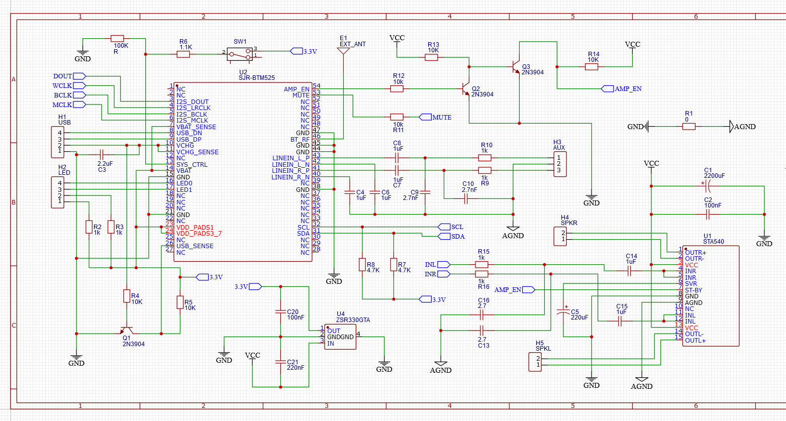

Hi all,
I have a QCC5125 (BTM525) and it is not turning on. The USB isn't being detected in Windows 11 device manager either. The LED will turn on when I flip the switch for SYS_CTRL, but it is very dim and it remains on until I unplug the device from power. I probed the 1.8V pin when given power and I get 1.795V, so the internal regulators are working, it just refuses to boot. Please let me know if there are any mistakes in the hardware design below!
Schematic design:
