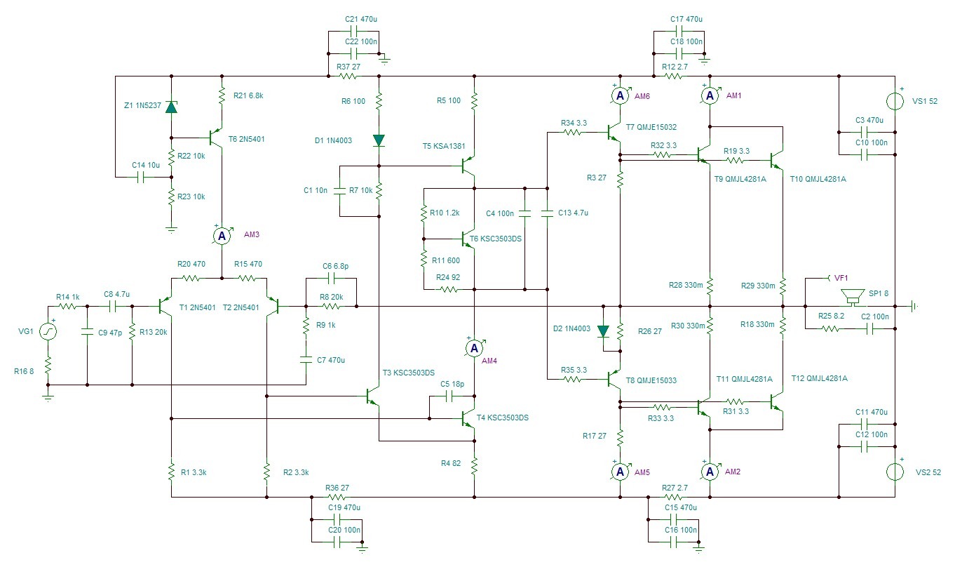

I can and have made some changes
Stability is tradeoff as always with THD numbers / slew rate etc etc.
I lowered differential degen R20, R15 to 180, was high at 470 before to get such High Ft output section
to be stable. I was trying to keep slew rate high but raised C5 to 22p for not much difference and got THD1
distortion rating. To be where I would expect it to be with this topology. Around .001 to .008 typical
Also had to get current of T7 and T8 to match, otherwise typical Quasi behavior
and you can have stability issue at high frequency, or AC current sharing of output
transistor can be uneven. And with Quasi even if DC offset is pretty as can be.
AC current sharing is not equal in output section, Its just how good are you, and how close
you can get. Any ways by changing R3 and R26 and R17. To different values to balance
current of EF and CFP sections. And this also resulted in more stable high frequency.

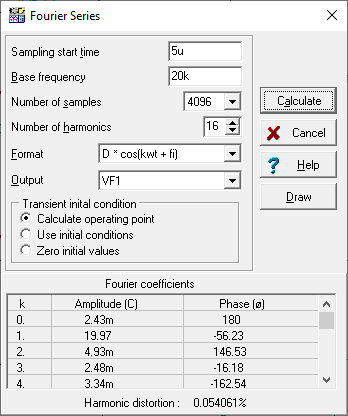

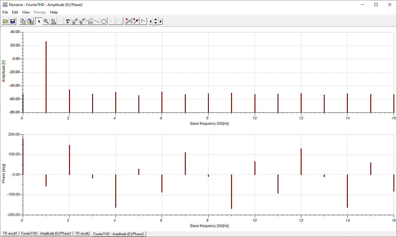

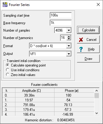

Here is new schematic with DC current values shown
And yes Differential is using only 1ma NOT 2ma like normally seen.
And yes it has Degen like not normally seen. Because it is 35 Mhz output
devices and it is stable amplifier.

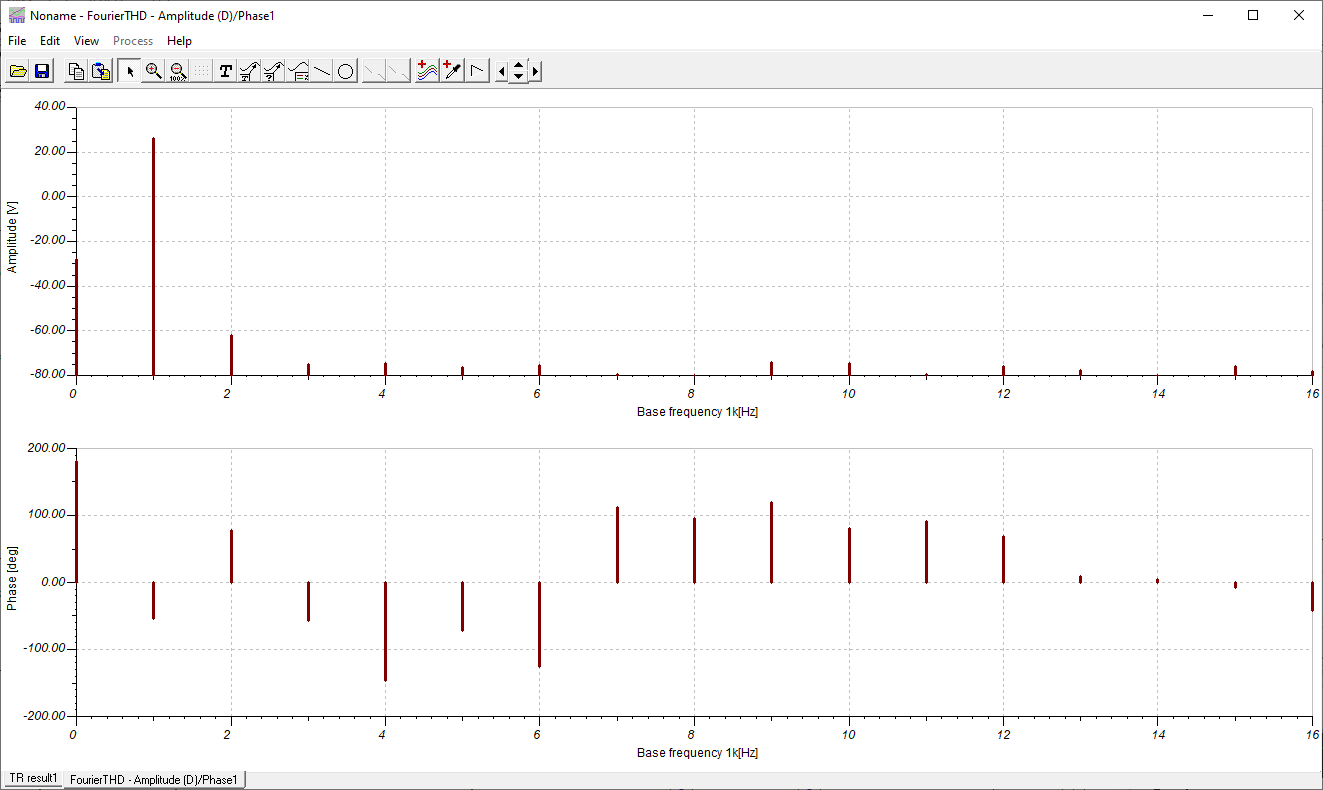

THD1 (1 kHz) with 1 volt RMS input .004%
With good Quasi , yes strong 2nd Harmonic profile
THD20 ( 20 kHz) with 1 volt RMS input .05%
Second Harmonic still high with typical higher 3rd harmonic at higher frequency

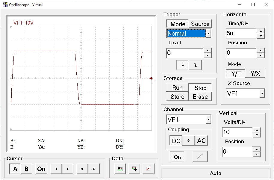

Square Wave at 22 kHz

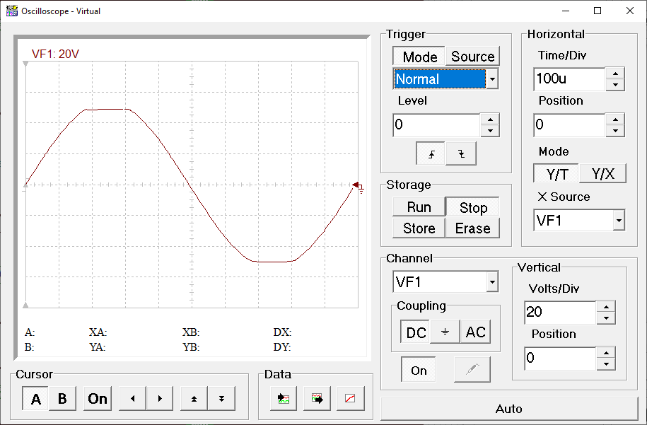

Sine clipping behavior at 1 kHz
As you see lower Quasi rail clips well as expected with added
Baxandall Diode. Slight Rail stick on positive portion is not Output
Section. That is typical of Hitachi style balanced Vas.
If R7 10k is raised to 12k or 15k then rail stick is reduced/ removed.
But THD and Vas balance will be pure garbage.
No way to change and typical of simplified topology.
You would have to add mirror and current source.
Or about 4 to 6 more transistors. So = Ignore

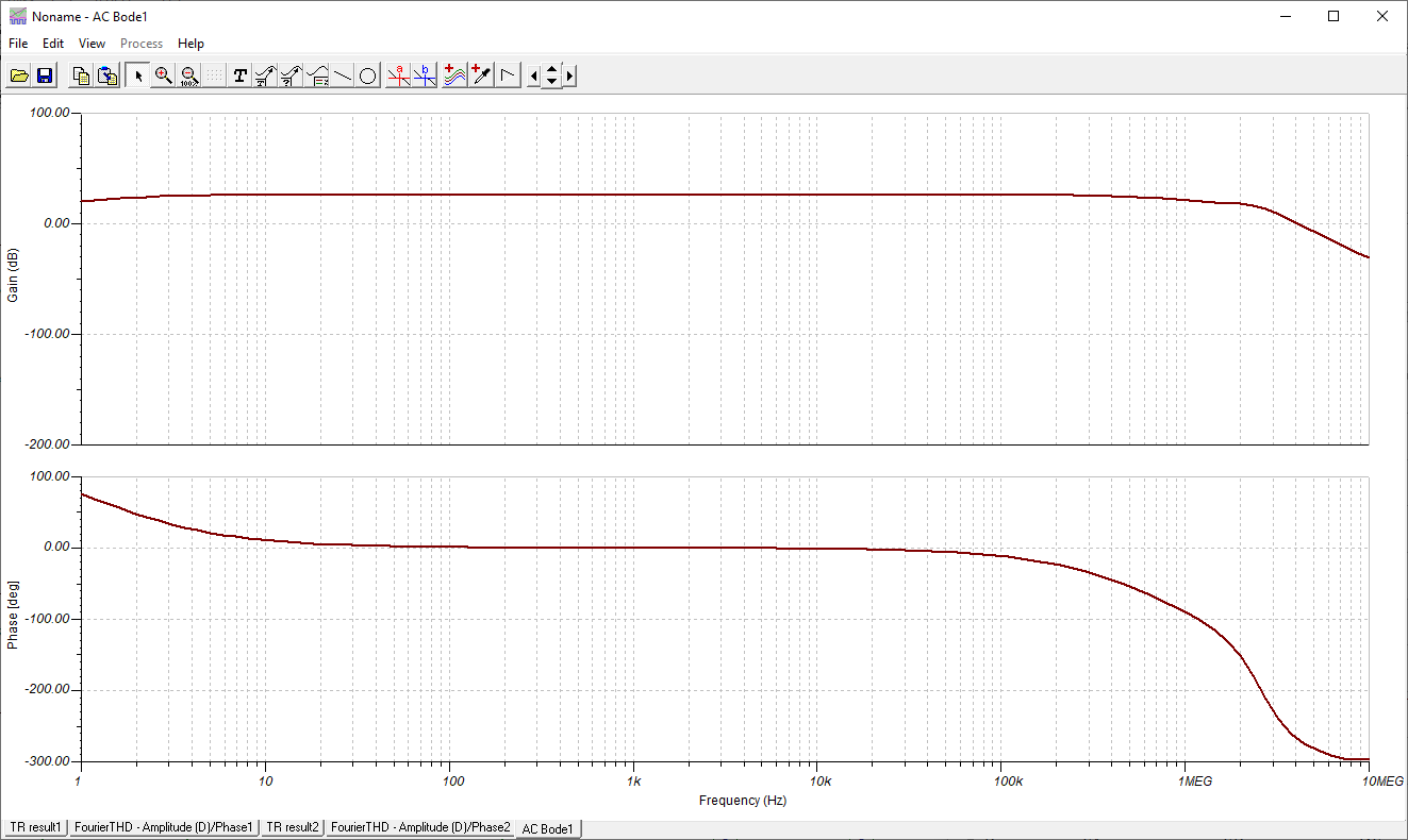

AC transfer
AC transfer
Greetings, I would like Mr. WhiteDragon if I could simulate something similar with a mosfet N output but keeping it very simple like the original Hitachi and in that same voltage range between 35v and 50v, as simple as this Kenwood
Nice bit of analysis of the design. Interesting read.I can and have made some changes
I wonder about the lack of any SOA protection though. Seems a bit risky that user error may cause failures.
BTW what sim tools are you using? They look interesting.
Simulation / Spice tool used is TINA_TINice bit of analysis of the design. Interesting read.
from Texas Instruments
and Agree , Output inductor could be added
and also " emitter" resistors are already in the " wrong"
place. Because for VI limiter to be added.
They would need to be in position shown. And flyback diodes
added.
Far as thermal, I love 6 packs of output transistors.
This case I just doubled it from 1 output pair to 2 pairs.
For thermal and even 2 ohm loads. Just go 3 pairs.
I dont like to rely on the superiority of modern devices.
Surprised nobody mentioned 350 volt 4281 transistors
being " overkill" for 50 volts rails.
But if you were boiling the outputs at 150c
I believe SOA for 4281 is still 100 volts.
So 3 pairs and VI limiters be good.
For MI ( musical instrument) or live audio
DC protection relay would be mandatory
in my book.
