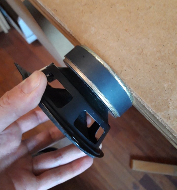

I did enjoy the open sound of the racer on the stand and look forward to hearing my other drivers mounted so and new respect for the various open baffle designs floating around the forum. It is a nicer rendition than ported or sealed and will be looked into further with a pair of upcoming Randytion two-ways 😀 for my desktop

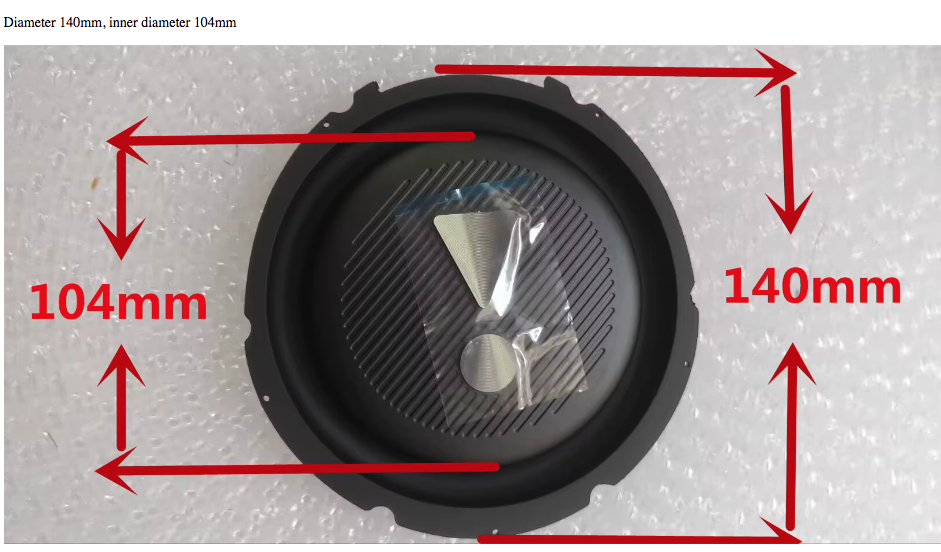

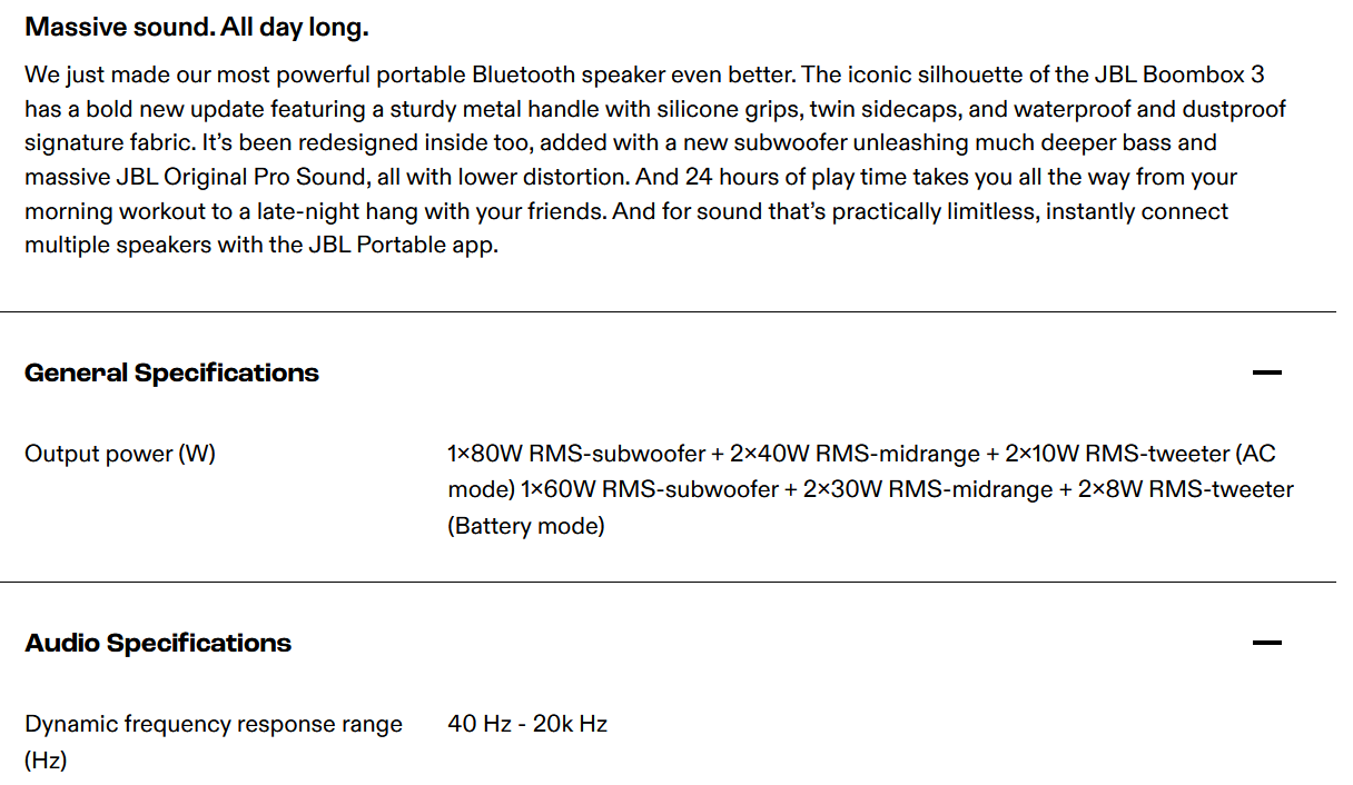

Yes, the BB3 and a Harmon boombox replacement drivers are offered on Ali and the basis of a lot of cloning and PR cabs but mostly without much in the way of acoustic modelling and suchThere are a lot of social media ‘reels’ using these drivers with passive radiators in blue tooth boxes I noticed? I tried to link a couple with no luck

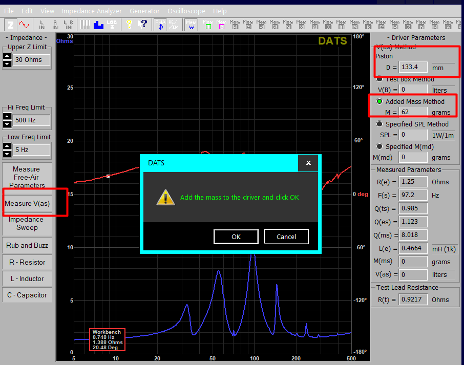

Will pull the broken in T/S on this driver as soon as my new desk/bench is finished

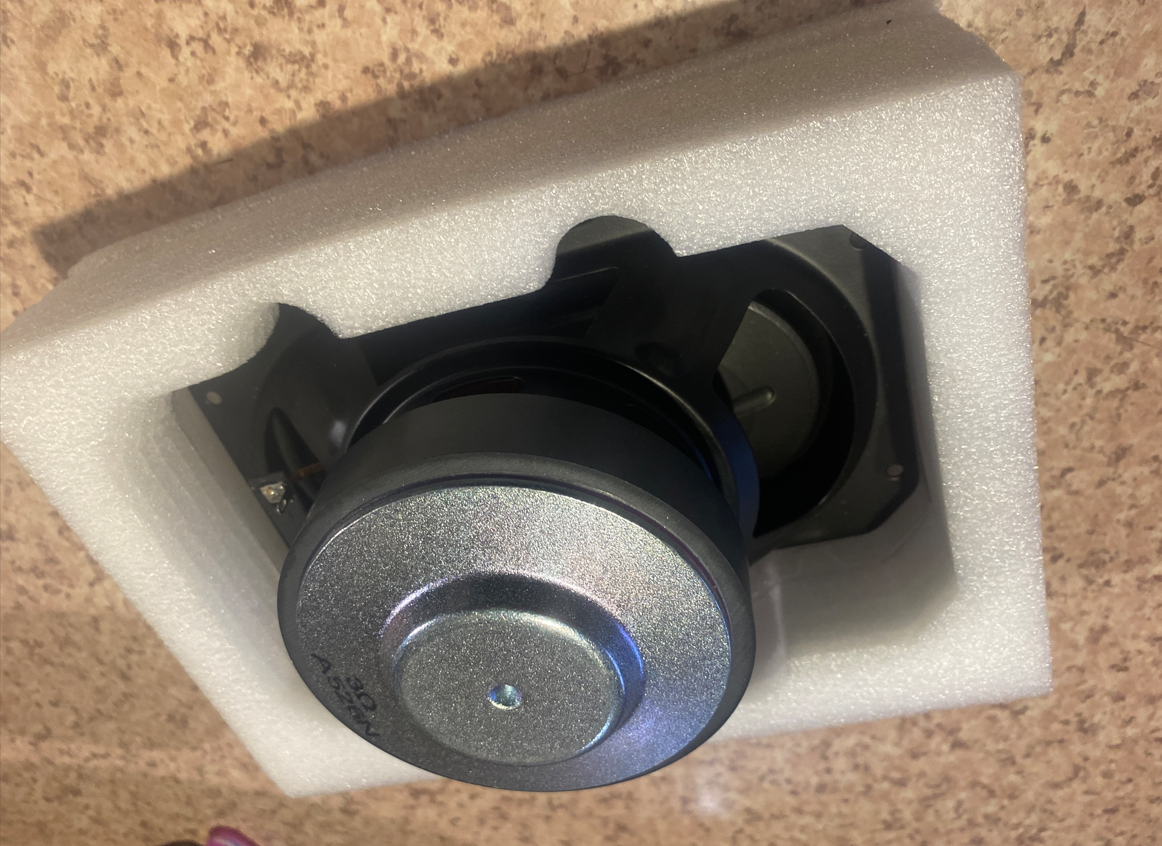

I had to place my Dats and some other gear as securities against a loan for urgent car repairs some weeks back, but today have managed to get them all out and can get back to working with this driver. Have also acquired a commercial portable speaker that seems to run this driver. This will be good to test my DIY efforts against
