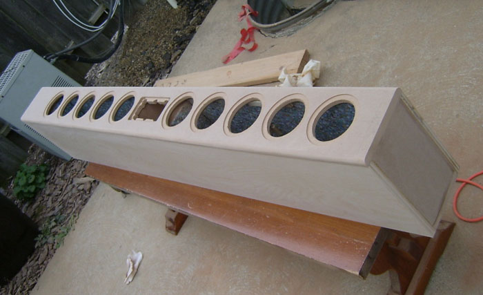

I was going to purchase a Radio Shack analog SPL meter in the near future to measure my room's bass and was wondering if this guy could be used to measure my recently completed line arrays? These are a budget set of arrays using (10) 4.5" Vifa TC11 woofers and a single Fountek JP-2.0 ribbon. I have them hooked up to my Behringer DCX2496 and after a quick set up I'm BLOWN AWAY! I'd like to be able to measure them and tweak their output with the DCX2496's built-in EQ system. Being they're only 4.5" drivers I have the boxes tuned to 65hz. While they sound very good, they are lacking a little in the low end so I'd like to make that as flat as possible.
For $39, do you think the analog Radio Shack is the way to go? Should I step up to the $49 digital one they offer? Or is there a better solution (like to keep it under $100) that will provide me with better results?
Lastly, how high will the Radio Shack meters go? I doubt they'll do 20khz but I could be wrong.
Thanks!
I'm also attaching a pic of the unfinished cabs so you guys can see what I've built! Not too shabby for a first time woodworker, eh?

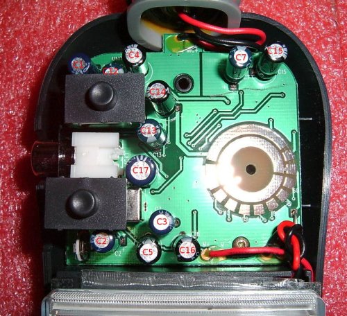

I just purchased a 33-4050 model (7 scale selector switch, Tandy catalog Q1461 here in Australia), and I have not seen any other models. I opened it up, and just from the description of the component values, I'd say it is different from the models described on Eric Wallin's site. The original values I see are:mazeroth said:The one used in the article is the 33-2050, while the one Radio Shack sells now is the 33-4050, and is $5 more than the one listed in the article. Can anyone confirm these are the same?
C1, C2, C3: 1 uF
C4, C5, C14, C15: 100uF
C7, C12, C13, C16: 22uF
C17: 220uF
C6, 8, 9, 10, 11, 18, 19 are surface mounted tiny capacitors on the rear side of the board.
So it would be good to know if anyone has information on the calibration of this model. It does have a trim-pot called "cal" (VR1) for calibration, but no instructions other than to take it to an expert for that.

oblong said:It does have a trim-pot called "cal" (VR1) for calibration, but no instructions other than to take it to an expert for that.
My Sonicshop SPLmeter arrived a few days ago (see previous posts of me in this thread), and it also has a calibration trimpot and the instruction to take it to an expert if nessesairly.
Since you mentioned the capacitors, I assume you want to calibrate it for maximally flat frequency response.
I believe the trimpot is for setting the gain factor(sensitivity) and not for the freq resp.
Maybe you know someone who has access to much better equipment and you can use that to create a correction curve?
