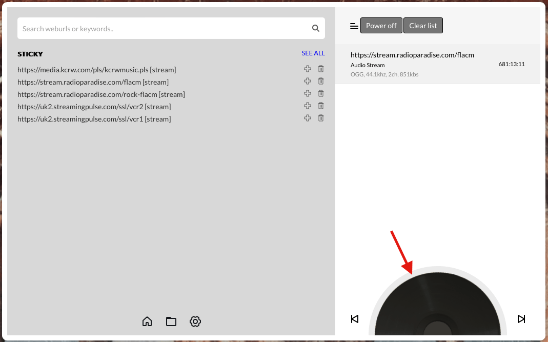

I’m using Randy purely for radio streams, not for albums.
What I’m missing is volume control via the web interface. Atm I have to do that via alsamixer in ssh.
It is possible to use mpd to control the volume.
I would like to control it via the slider in the bottom (see the arrow), or via an up/down control in the top right.
So, I need to alter the web page a bit.
For a front end developer that is probably very easy, I’m not one
I will try it anyway; if anyone is interested, please check my fork.
(Or, share your fork if you already modified it )
It’s a work in progress, so far I have moved the Power off functionality to the main page.
Other changes are removing changing the device’s host name on install and the google tracking.

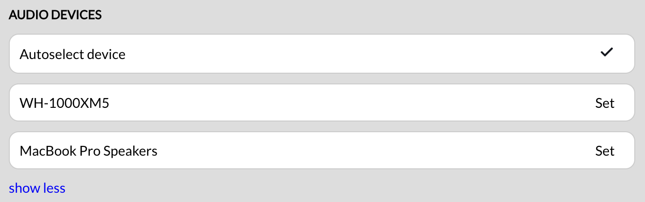

1. How can I use Bluetooth headphones?
-- There's some bluetooth libraries for RPIs I have looked into but they were a bit of a PITA at the time.
If you are installing Randy on an OS that already has bluetooth working then the connected device should appear under settings->audio devices, for example here is a screenshot from Randy running on my Macbook

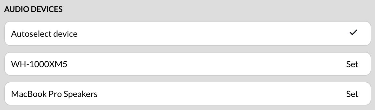

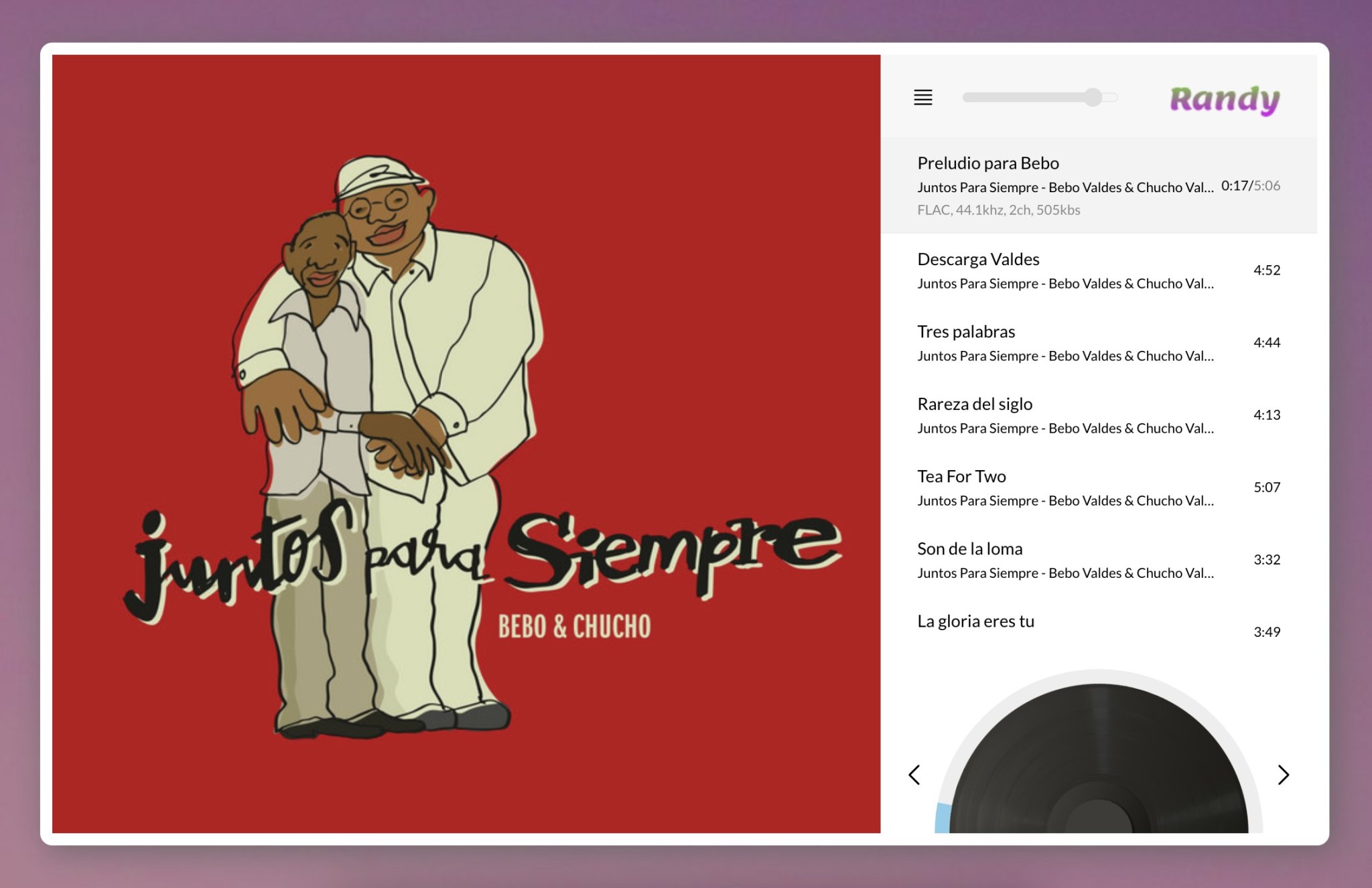

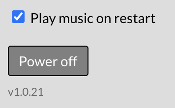

New Randy release v1.0.20 is out!
This release is dedicated to all those situations when music is playing in the background and your spouse tries to tell you something from the other side of the apartment, or you have a zoom call coming up and you don't feel like getting up and lowering the volume on your amplifier.Of course thanks to @PjVervoorn it also appeals better to headphone listeners which need an easy volume control.
Whats new:
- Replay Gain which has been there for a while but was never announced - thanks to @DRONE7
- Volume slider right smack on the top of the player - thanks to @PjVervoorn
- Some more code optimisations and fixes for the radio browser service
** Power off button didn't make it to the front page this time but can still be found under settings.
Things you may not have noticed about Randy:
- Clicking on Randy on the top left creates a new random playlist
- You can search radio station names and also try Youtube and a few other streaming site urls and try to play them
- When Randy can't find a suitable album cover it will load a random doodle
Enjoy,
Gideon
