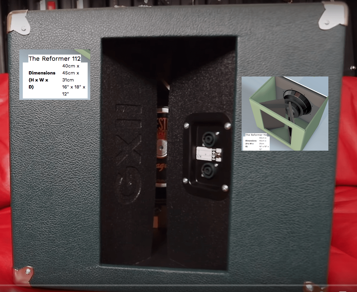

Rear vent/diffractor cab
No need to yell, I was polite with my misunderstanding. I thought the whole point was to show off the little cabinet, why bother with it otherwise? I still do not see much value in your waving your microphone around when you have one near field that I guess was there for looks. My comments still stand, an A/B pedal with comparable speakers in each cabinet would have been my way to go showing off my technology if I wanted to be taken seriously.
There were three cabinets there, the Upsetter 110, the Reformer 112 and the Radical 212H. We used the 110 to discuss the design, the 112 was the one demo'd and the 212H was discussed briefly at the end.
The nearfield mic was there because that's how Rob normally captures guitar sound. As Rob explained in the video, he suggested using the boom mic to demonstrate the variance in on and off-axis response of the cabs.
This was an impromptu video where I turned up with the cabs for Rob to review them and he changed his method because of the difference he heard vs a conventional cab. It was not a video arranged by Barefaced Audio to demonstrate this patent pending technology in laboratory conditions.

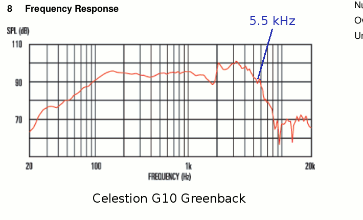

Amazing response from these drivers. They go up to 5000kHz & some even to 5500kHz Barefaced Upsetter 110
– Barefaced Audio
LOL, of course they are mistakes :D I'm surprised nobody has spotted them until now :(
@ alexclaber
It seems that you have actually produced something new/novel, even if it incorporates existing ideas etc, & should therefore normally expected to be granted a patent, & i hope you do :) But, as far as i've been aware for years, you are supposed to keep it secret until After the patent is granted ?
...up to 5000kHz & some even to 5500kHz...of course they are mistakes
I looked up the manufacturer's datasheet for the Celestion G10, and I would say there is no mistake - the G10 has quite a wide frequency response for a guitar speaker. See attached image.

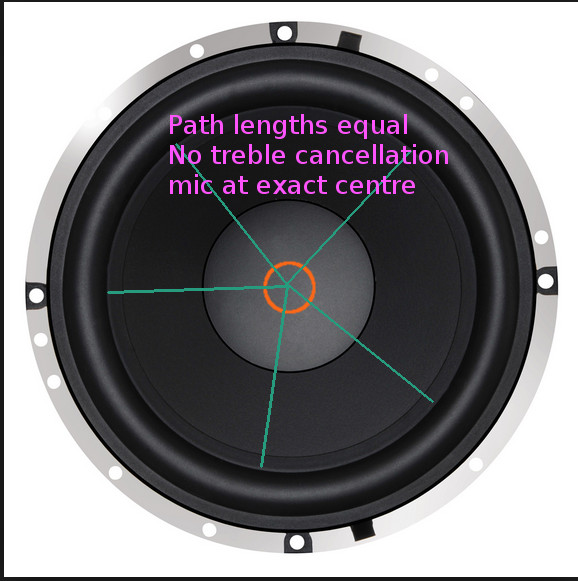

The simple proof that guitar speakers do indeed radiate their treble from most of the cone (and not just the centre) is in my previous post: IF most of the cone decoupled from the centre at high frequencies, THEN only the centre is radiating high frequencies, which means it behaves like a small tweeter, which means it produces wide dispersion.
But it does not produce wide treble dispersion. Ergo, our assumption is false. Ergo, the annoying treble frequencies are not being radiated only from the centre, but from most of the cone area.

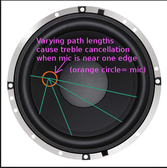

The "mic in the centre" experiment doesn't prove what you say it does - it leads to a false conclusion, which is almost universally believed by sound engineers (but that doesn't make it any less wrong.)
The fallacy occurs because most people think that when you point the mic at one spot on the cone, it picks up sound from just that one spot. This is simply not true - it picks up the sum of the sound fields from every microscopic point on the entire speaker cone, each of which has travelled a different distance to get to the mic, and arrives with a different phase-shift. In mathematical terms, the local sound field at the mic is the superposition of all the tiny sound fields generated by every tiny little microscopic area of the cone.
Now, when the microphone is positioned in the centre of the cone, every point on the cone is matched by another point equally distant on the opposite side of the mic (see attached image.) The signals from both regions are in phase, so you get reinforcement. So, when the mic is placed exactly in the centre, you get good treble response, as there are no sound cancellations at this on-axis location.
Now move the mic off-centre (second image.) Now, at treble frequencies, for many regions of the speaker cone, there will be a counterbalancing region on the other side of the cone that is half a wavelength further from the mic; those two sounds will cancel out as the signals are 180 degrees out of phase (destructive interference.)
The net result is a considerable droop in treble response at the location of the off-axis microphone. This treble loss is caused by destructive interference between sound from the differently-spaced near and far sides of the cone, and not because the edges of the cone radiate less treble than the centre.

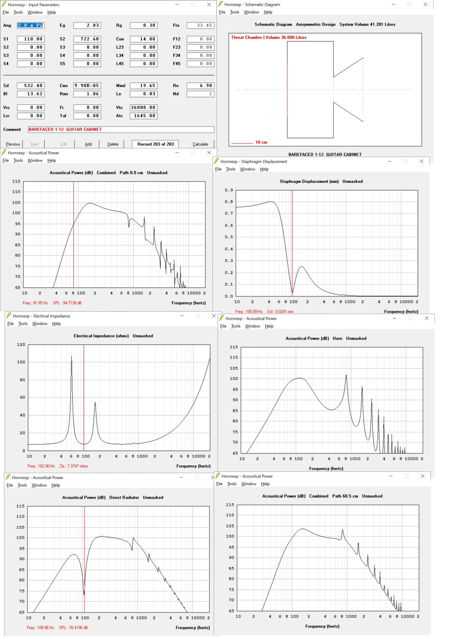

Apologies for reviving a two-and-a-half-year-old thread, but I was hoping to DIY an AVD-style cab, and I'm wondering what the target frequency is of the helmholtz resonator for these cabs, and how it's determined, i.e. Is it the same for say, all the 1x12 cabs, or does it vary based on the driver?
Alternatively, if someone who has one just wanted to give me exact measurements of a 1x12 Reformer, that would also work :)

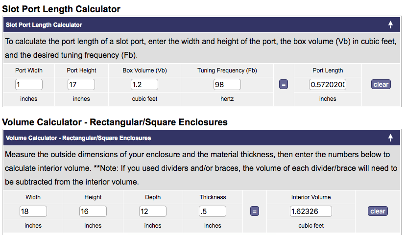

Made a quick and dirty estimate from the first port calculator that popped up, using the 1x12 Reformer dimensions, and a WAG on the cabinet volume reduction due to the speaker and rear flat sided 90 degree parabolic horn to determine the net volume.
Fb (Frequency of Box tuning/ Helmholtz resonance) looks to be around 98 Hz .
Low E on a standard tuned 6 string guitar is 81Hz.
Guitar speakers Fs (free air resonance) ranges from ~60 to 120Hz, 100Hz being fairly common.
If the speaker's Fs matches Fb, and it's VAS (Volume of Air having the same acoustic compliance as driver Suspension) is ~the net cabinet volume, the port will provide the most low end "boom".
The 1x12 Reformer net volume is similar to the VAS of many guitar speakers.
The tight suspension/small VAS of guitar speakers keeps them from "flapping" below Fb or when used in open back cabinets.
The box Fb will be the same regardless of the driver used, other than small deviations due to the volume the driver occupies, a deeper cone and bigger magnet structure uses more volume than a shallow cone with small magnet.
A larger cone volume will raise the Fb slightly, smaller will lower the Fb.
12" guitar speakers are around 100dB using 1 watt at one meter, 10 watts makes 110dB at 1 meter, 104dB at 2 meters, 98 at 4 meters outdoors. Indoors in a small room the level might have hardly any drop.
You could use a smaller driver if you prefer to distort at a lower volume, a 6" might be as much as -10dB less sensitive than a 12", sounding half as loud. That said, smaller speakers have wider high frequency dispersion, if setting on the floor with no tilt, the smaller speaker may sound brighter than a 12".
https://www.the12volt.com/caraudio/boxcalcs.asp#porsq
The port width appears to be the slightly less than the width of the Speakon connector, so just under <24mm, or 1".
If you blow the pictures up on screen, you should be able to easily duplicate this simple cabinet.
Anyway, this is all basic speaker design, not rocket science.
Make the slot wider, Fb goes up, rear dispersion narrows, thinner, Fb drops, rear dispersion gets wider.
If you wanted to be clever, you could make the port exit width adjustable using an overlapping plate with thumb screws into T-nuts.

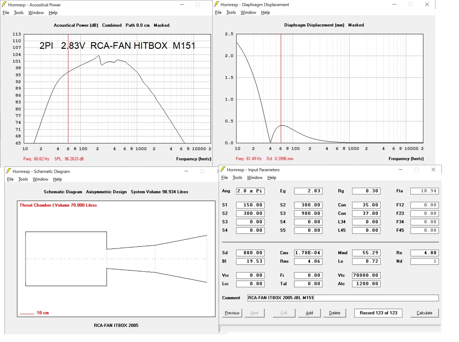

The little parabolic horn chamber is also a bandpass filter, boosting the rear midrange output, while cutting the highs. Lining the cabinet with damping material would reduce the high end from the horn.
Small changes in the cabinet will be similar to adjusting a tone knob.
Art
Appreciate the thorough reply Art! Based on your back-of-napkin math, it seems like the target Fb for all these cabs is around 100Hz, since that was roughly what I calculated from the smaller 1x10 design that's in the patent. Part of what was throwing me off was the fact that when I was trying to calculate the Fb of the 1x12, I forgot to subtract the volume of the AVD design on the back, which was giving me some numbers that were absolutely wrong, haha.
I was curious if the Fb was varied based on the driver's Fs, but I imagine that would be a nightmare from a production standpoint, so they're almost certainly all the same enclosures no matter the driver.
Regarding the back being a horn, at least according to the measurements published in the patent, the rear vent is acting more as a waveguide than a horn, so there shouldn't be any low-pass filtering, at least according to Barefaced.
