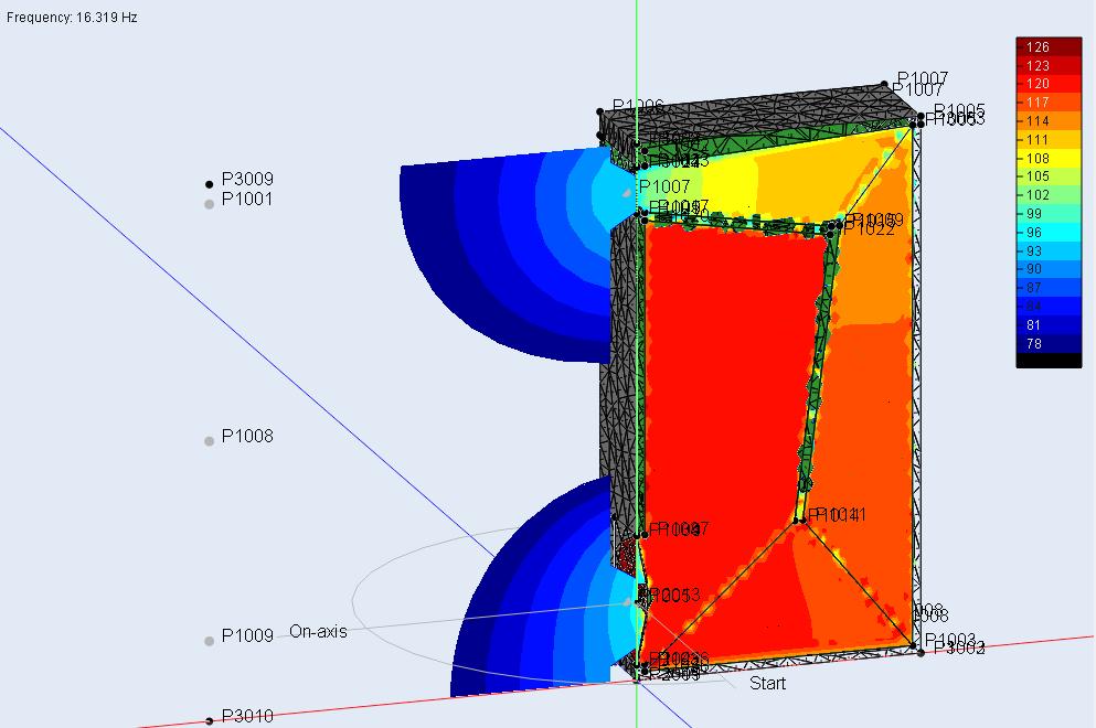

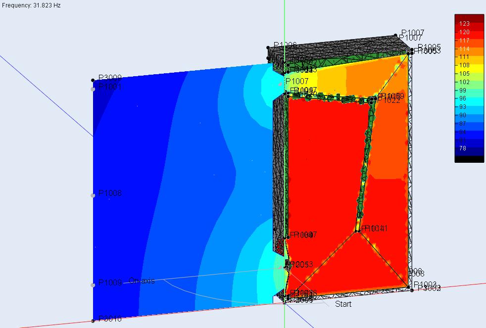

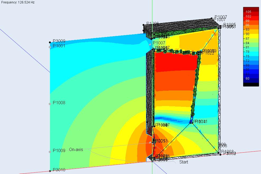

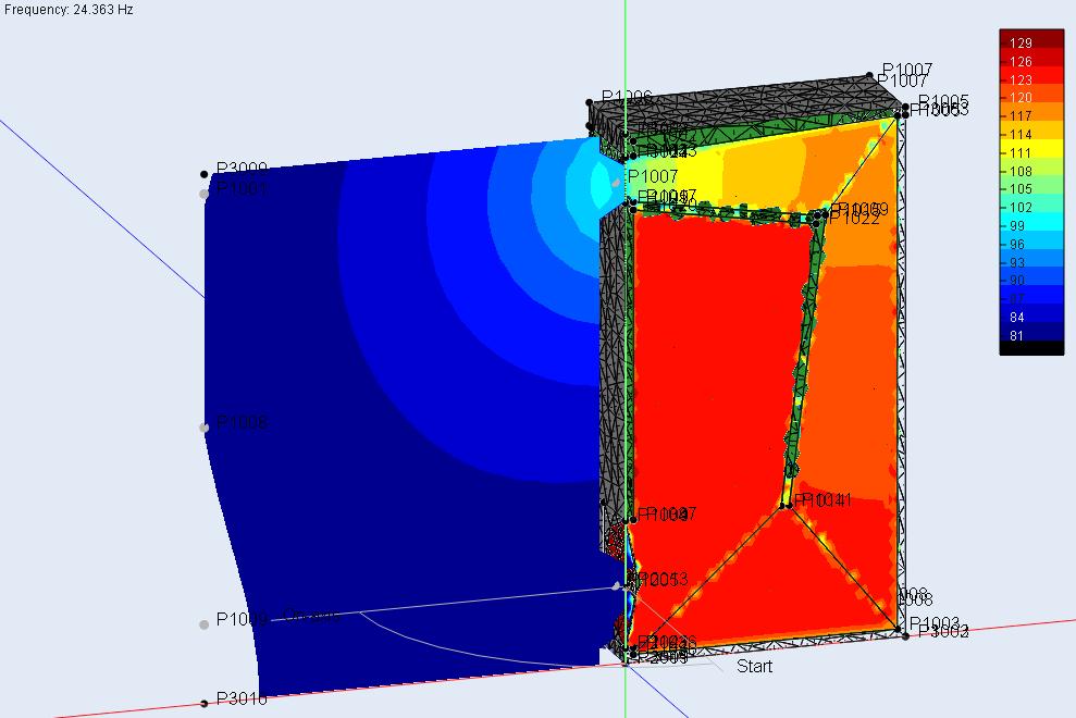

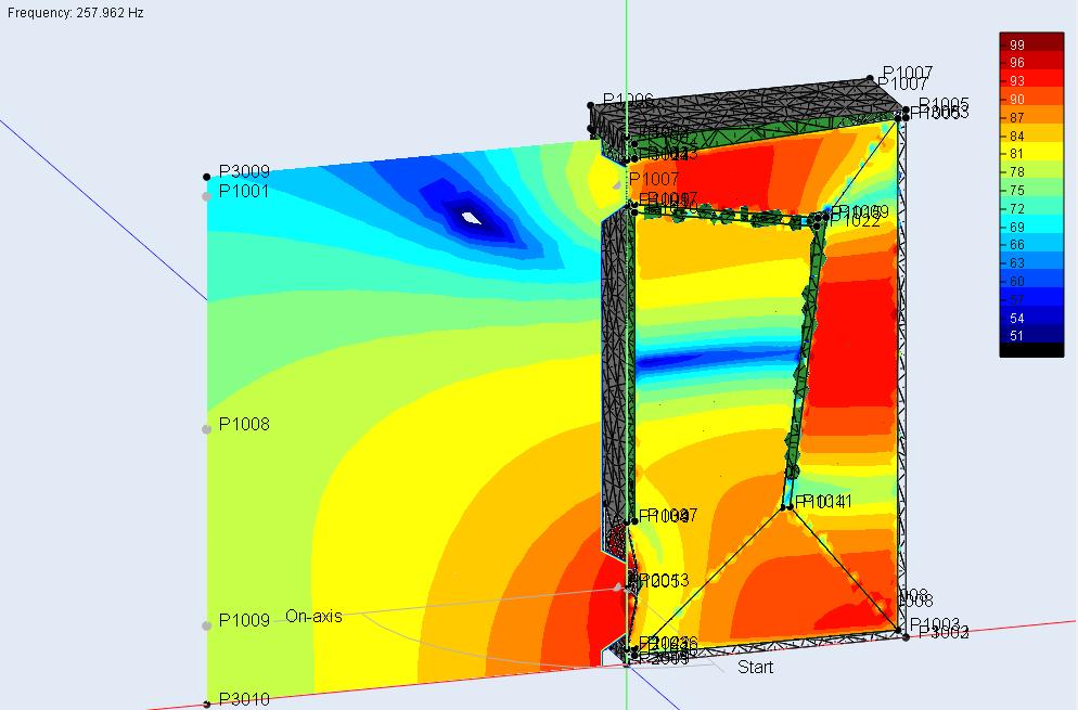

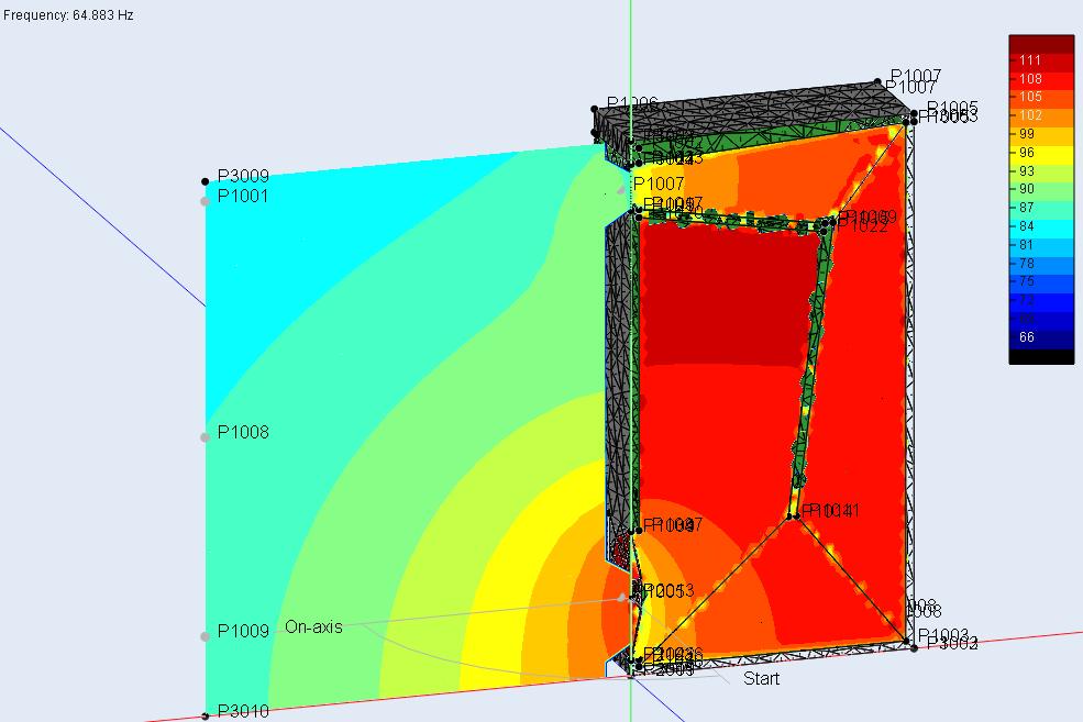

This is my first attempt at AKABAK 3, so be gentle. These are screen shots at 16, 24, 32, 64, 128 and 256 Hz. The enclosure was designed by Hornresp for an Offset Dual Kef B-139 Drivers. I took the parameters from HR and created an AutoCAD dwg. From that I created the Model in AKABAK 3 by hand. I largely used the JBL Back loaded Horn (Bogart) from the examples for help with the modeling.
