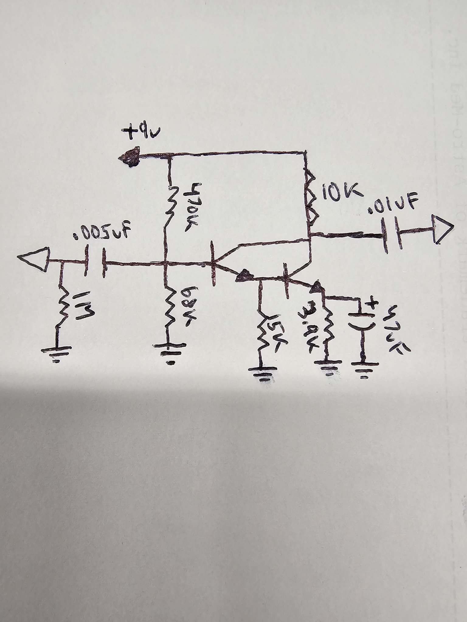

Hi all, time for my bi-annual post 🙂
I have been using the darlington rangemaster design for years in a Tony Iommi style boost pedal. I am noticing that maybe once a year or every other year I have to replace the MP44 soviet made germanium cans for seemingly no reason. As far as I know Tony never had to have the rangemaster serviced in the 10 years he used it, I am wondering if his was built better then mine or the cans were just swapped for silicon.
I understand germanium REALLY hates temp swings, I remember a long time ago I saw a circuit using a diode between the emitter and base (I think) with both the transistor and diode attached to a heatsink so the diode will thermally compensate for the bias but I forgot what that is called.
Is there a way to make this circuit more stable?
Here is the circuit (Ignore the way I bungled up the 10k) I replaced the volume pot with a 10k resistor since I always run it dimed anyways.
Any advice greatly appreciated.

The resistor values are so high and the supply voltage so low that there is no realistic way for the transistor to fail operationally. That said a possible failure mode could be transient voltage spikes on either the input or output connections that are causing damage. Adding a series resistor at the input and output might help with that possibility.
Reactions: JMFahey and benb
I would add a small silicon diode, 1N4148 or so, with its cathode connected to the base of the first transistor and its anode to ground, to ensure that negative voltage peaks at the input don't damage the base-emitter junction of the first transistor. I don't know if base-emitter breakthrough is an issue for old germanium transistors, but it certainly is for modern silicon ones.
Mooly, realistically that is a very good idea, however gain is not something I am willing to sacrifice 😛
Marcel, That is a very good idea and along the lines of what I was thinking. If I have a failure in the future I will definitely try to determine if it is the first transistor or both, as that is a very good theory.
I was thinking something like a 1k at the input and output which would have minimal impact. the output resistor rerally depends on what you feed this into but given the low value coupling caps the impedances all around must be very high.

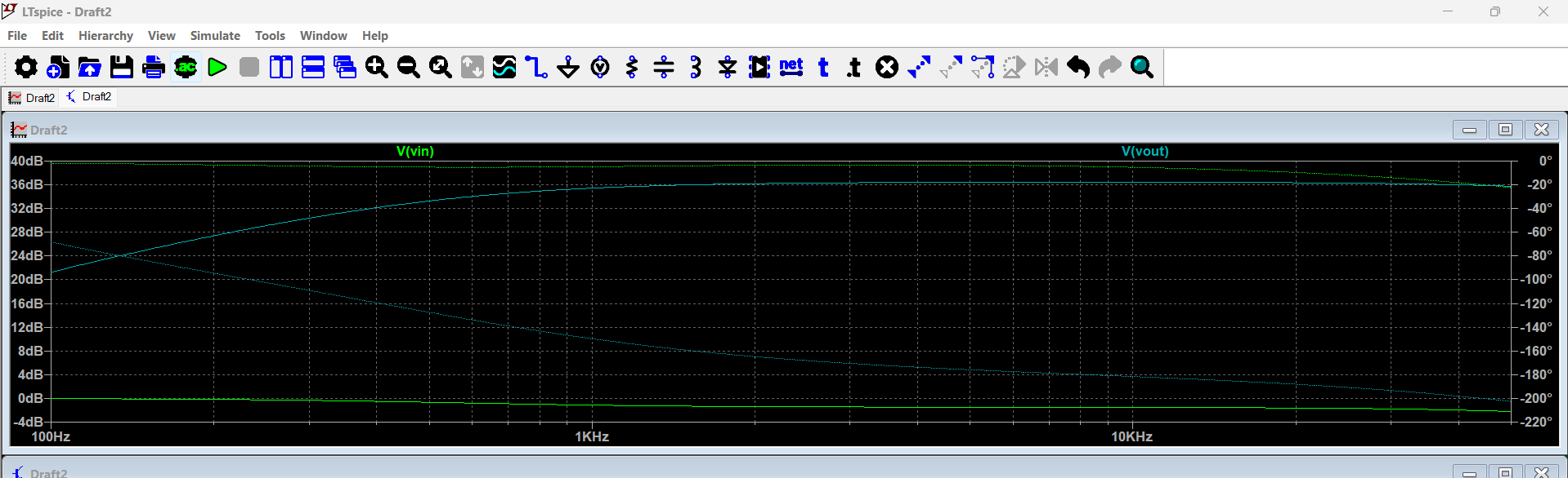

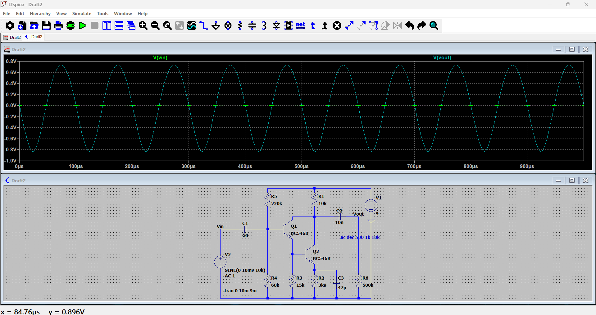

This is the standard circuit biased for silicon:
And the gain is about 38db:

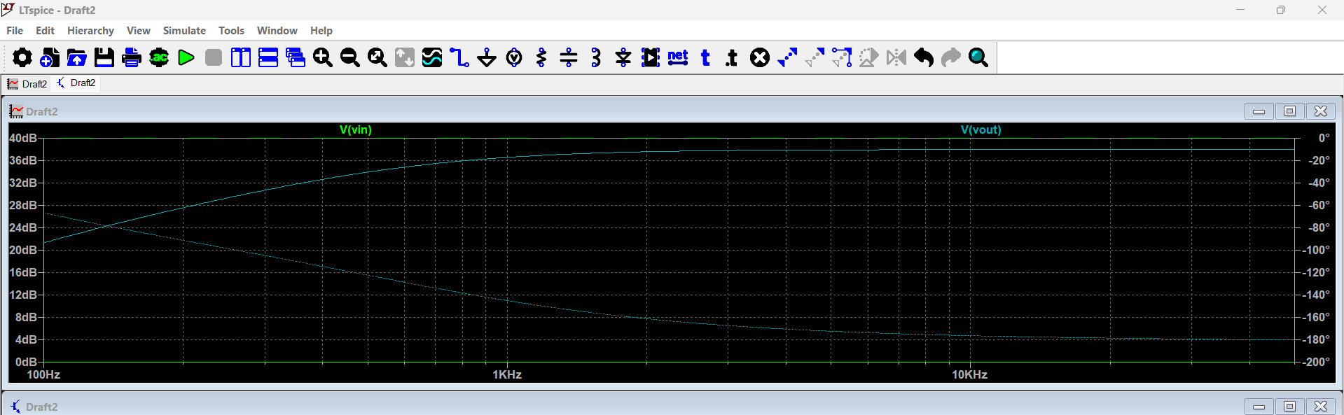

And with a 1k at the input gain is 37.8db:

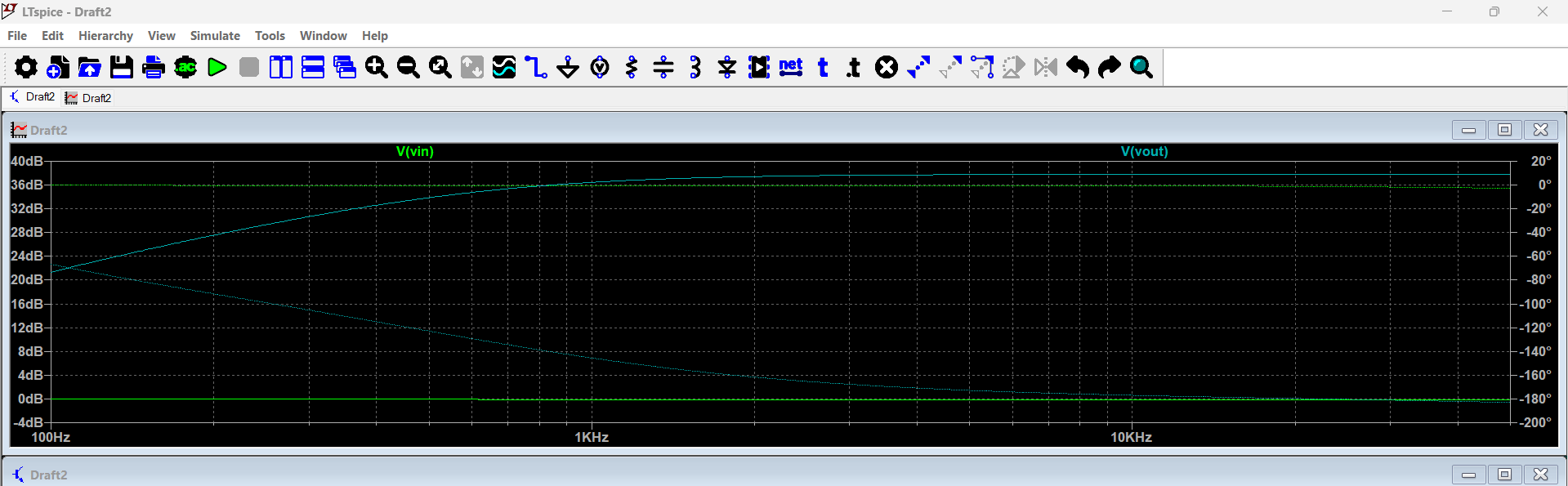

And a 10k at the input is still over 36db gain:
Reactions: JMFahey
Resistor isolation and diode clamping are both good suggestions.
I'm not sure if transistors have a shelf life, but germanium transistors have to be at least 50 years old. Plus if the seal is breached or the manufacturing process is substandard, they'll have a high rate of failure. Soviet manufactured in the 1960s or 1970s and the quality control is -????
You might try replacing one or both transistors with silicon. I don't know if it will sound the same, but it's worth a try.
"Overdriving" them is not an issue. As long as you're inside the SOA all is kosher.

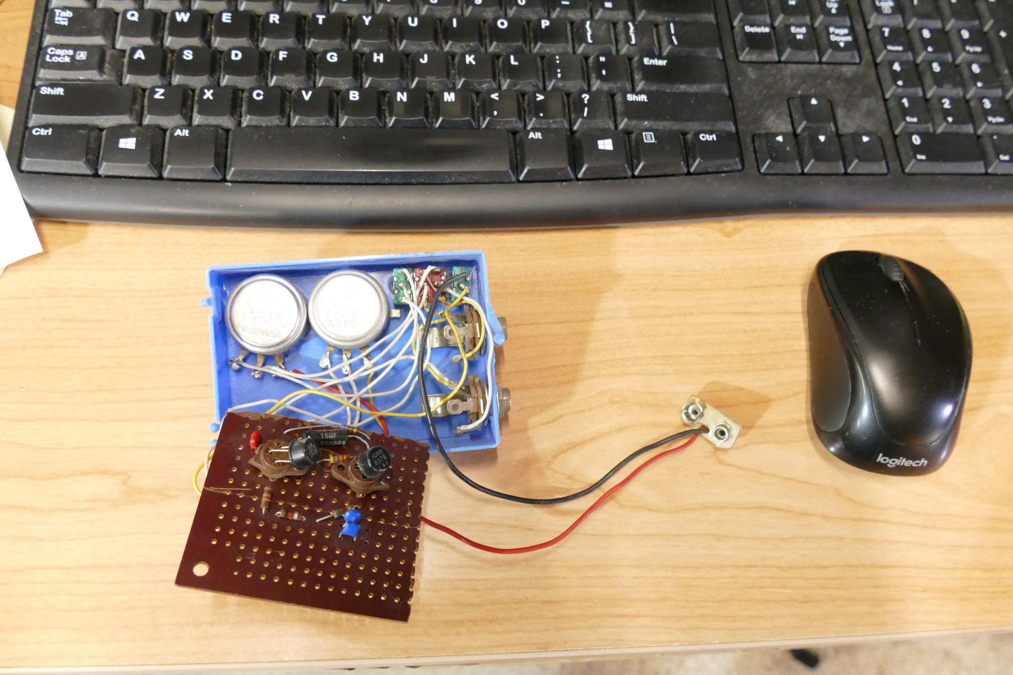

I built lots of clones of the Vox Tone Bender / Dallas Arbiter Fuzz Face back around 1968 - 1970. I used transistors scavenged from transistor radios and other low buck Japanese consumer electronics. I found two things that fry germanium devices, heat and voltage. Most of the transistors lifted from a device that ran from a 9 volt battery would work on 12 volts, but few survived much more than that.
Even those big fat TO-36 doorknobs that are found on the back of many early 60's car radios have a very low tolerance for overvoltage. I used them for small "booster" amps as a kid. I found that most would eat 3 X 6 volt lantern batteries, but few would survive 4. My trusty DIY test power supply back then was a big Lionel train transformer feeding a big selenium rectifier stack from a car battery charger and a couple of big fat caps.

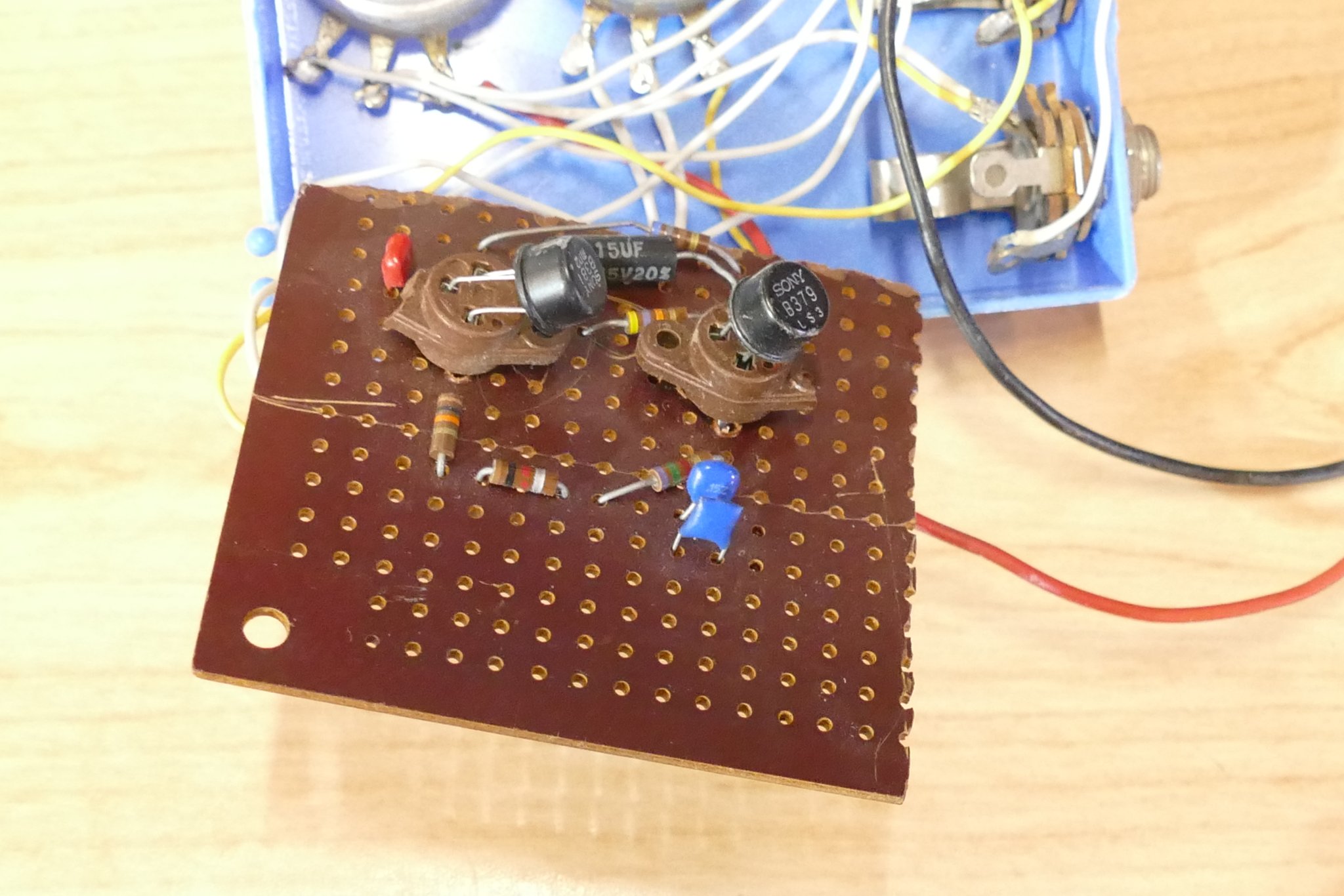

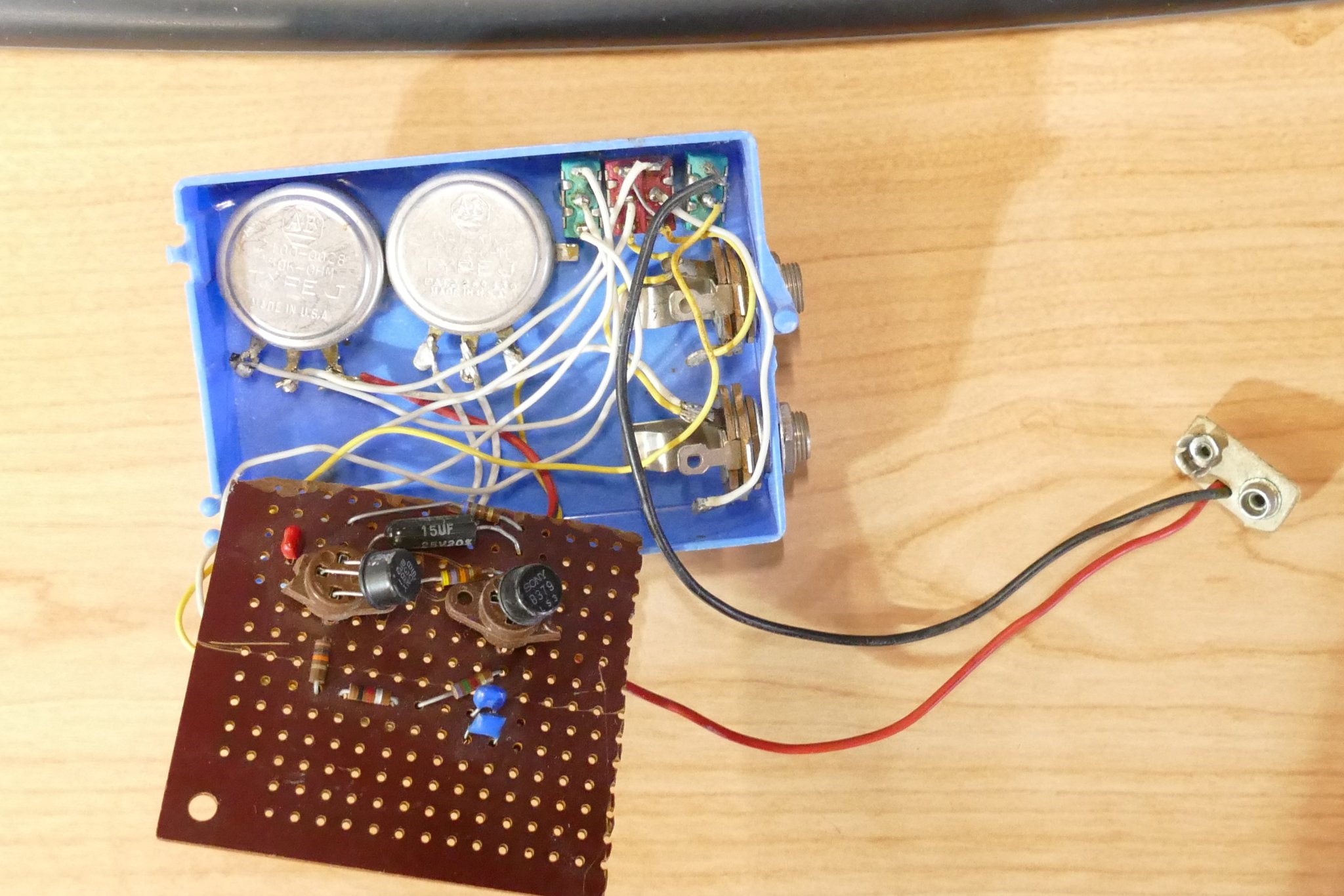

Here is the first Tone Bender clone I ever made. I built this one to see if the schematic that I had traced from a Vox Tone Bender was correct. When tracing the original I ran across a cap labeled 103. At the time (1968) I assumed 103 pF since I had never seen a cap labeled 103 before. I also used sockets for the transistors to test them all for best "tone." The later versions used "Bud" style boxes from the local Lafayette Radio Electronics store. Some even had relay switching.

True, Ge transistors are in general not as reliable as modern silicon ones. Some are going to be NFG just sitting in storage for decades. But if you run them into breakdown you’ll get a failure for sure so you do what you can to avoid that. And have spares on hand if you value the equipment.

Can't say i have ever heard of reoccurring germanium transistor failures in a rangemaster. Only thing i can think of is...
1. you are using a power supply and spikes are killing it
2. transistor is getting too hot during soldering and damage is occurring
3. Russian transistors are junk.
