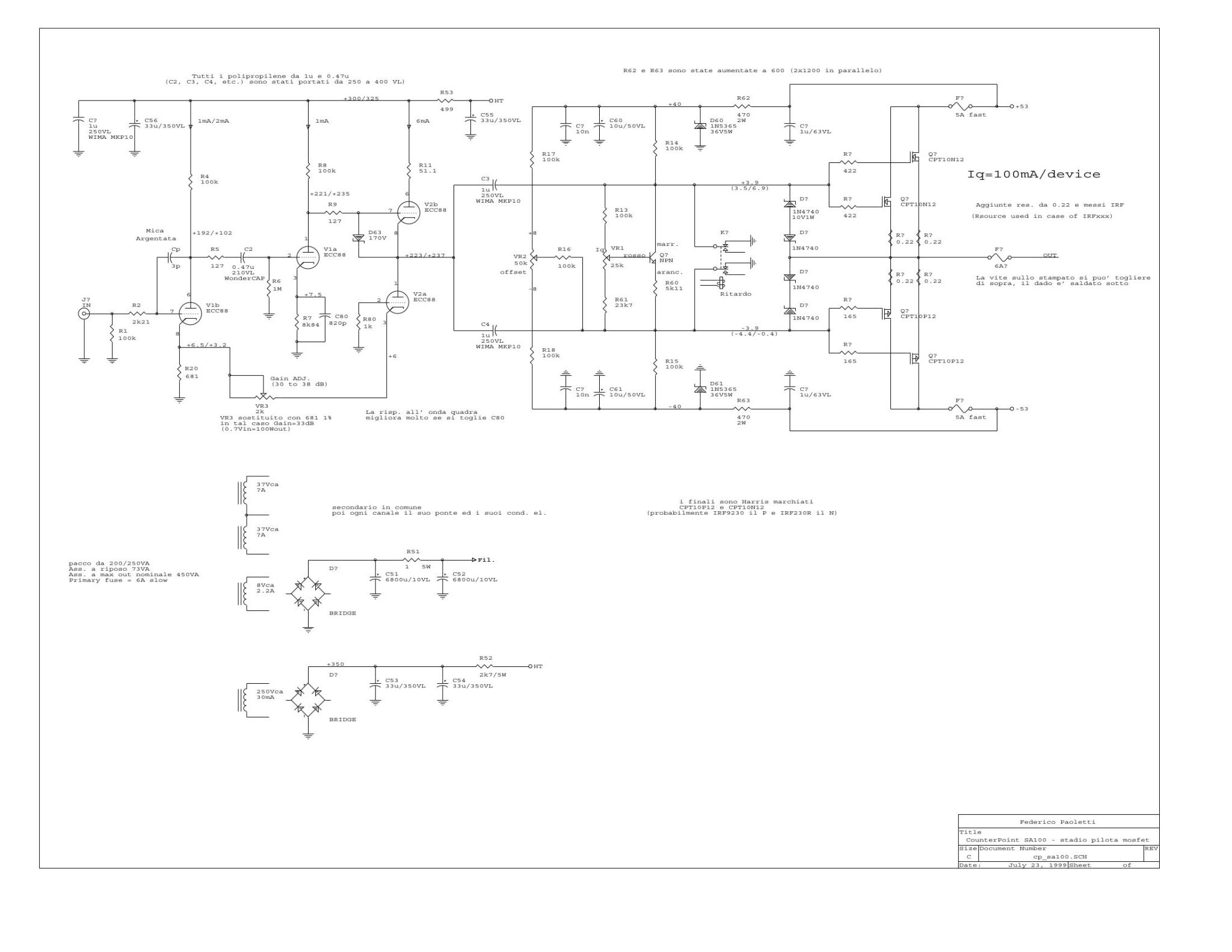

I have a customer's Counterpoint SA-12 that has blown output transistors. Looks like IRFP240 and IRFP9240 are the only viable replacements. But, close matching is required to set the bias to the recommended 280mV. (On a prior repair, I found it impossible to set the bias under 460mV because the matching was not close enough.) So, what's the best way to get matched quads of these?

"Bias" could mean the DC offset or the source resistor idle voltage drop, ie idle current??? The DC offset of most amps is a function of the input LTP but if this is that tube driven circuit there is no LTP and the MOS outputs are capacitor coupled from the tubes. The DC offset is set by a resistor divider, which is not difficult to modify for more range. The schematic I found is not symmetric and applies DC bias to the P-channels side (only), a design issue that should be corrected.
Oh, the design is symmetric, bias is also symmetric.The schematic I found is not symmetric and applies DC bias to the P-channels side (only), a design issue that should be corrected.
I guess you are talking offset correction
But to correct offset you need to apply a small voltage to one of the transistors, the other will stay "one bias drop" away from the other, no matter what.
Here it could be done on the N side or the P side, flip a coin.
There is nothing to correct , it works fine as shown 🙂
Offset network provides ample adjustment range, +/- 8V around center/ground voltage.
Your post is not clear enough.I have a customer's Counterpoint SA-12 that has blown output transistors. Looks like IRFP240 and IRFP9240 are the only viable replacements. But, close matching is required to set the bias to the recommended 280mV. (On a prior repair, I found it impossible to set the bias under 460mV because the matching was not close enough.) So, what's the best way to get matched quads of these?
Thanks.
1) bias and offset have already been confused in this thread, which one are you talking about?
2) where should those "280mV" be measured?
3) given that, we need the schematic.
Sorry, I assumed the schematic had already been posted to this thread. The SA-100 schematic that SteveU posted is almost identical to the SA-12, except for the addition of .22Ω source resistors. Since the SA-12 lacks these, bias current has to measured by breaking the supply circuit. Rather then inserting a DC ammeter as some manufacturers suggest, Counterpoint suggests removing one of the rail fuses and inserting a blown fuse with a 1Ω power resistor soldered across it and measuring the DC voltage across that. It says to set the bias to 280mV (corresponding to 280mA for both devices in that rail). Then, it says to adjust the offset to 0 (plus or minus 20mV). And then to re-check bias and offset after a few minutes.
Now, on a prior repair of a different SA-12, the MOSFETS were not closely matched, and the bias could not be reduced below 460mA. Once I installed a closely-matched quad, I had no problem reducing the bias to 280mA. So, considering the difficulty of sourcing matched power MOSFETS, what's the best way forward? Add .22Ω source resistors?

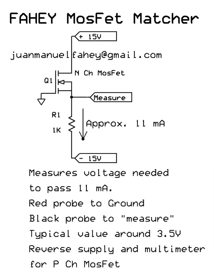

Trivial solution is to match them of course 😎
Feel free to change R1 to any value needed to pass whatever test current you wish.
That said, I match dozens of MosFets every Month for my Bass and PA power amps (that's why I designed and built this in the first place) and found that those closely matched at 11 mA track quite well at higher currents.
Of course coming from the same batch certainly helps 😉
Modern semiconductor production from one of the big players (Fairchild, ST, IR) is incredibly consistent
https://www.diyaudio.com/community/threads/how-to-match-mosfets-inexpensively.408242/post-7577442
Reduce R13 (~100k?) or R60 (~5.1k?) and you should be able to reduce the idle current to zero. I'd add a shunt resistor to one of these that is about 5x (~470K||100K=82K).
Note that this bias circuit is a bit dangerous because a corroded bias pot may go open and over bias the FETs into destruction. A quick fix is to connect the pot slider to the top pin.
The 0.22 Ohm source resistors may be a fix to reliability issues since it will improve the thermal stability. I suspect the maker added these for that reason.
