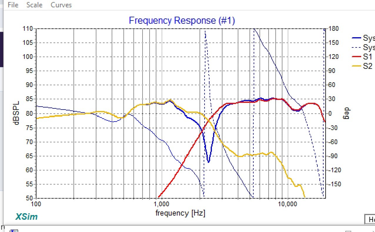

And here are the new measurements (red being the tweeter and orange the woofer)
I have been fiddling with some xover designs in Xsim and I am slowly getting there, but that baffle loss I am getting around 600hz is giving me headaches. The baffle is quite narrow at around 165mm (6.5 inches) and as you can see in the graph, between 1.1k and 500hz, almost 10db is lost. Is this normal behavior or should I be worried? If I am to flatten it out, I am guessing the sensitivity of the speaker is gonna suffer a lot, am I right? (Mind you the cabinet is not properly sealed right now, there are some air leakages here and there because of all the cables and what not. But I am assuming it shouldn’t be a problem at these frequencies.)
I will be updating my progress along the way but as a beginner, I'd love to hear what you people have to say about this project and the baffle loss particularly.

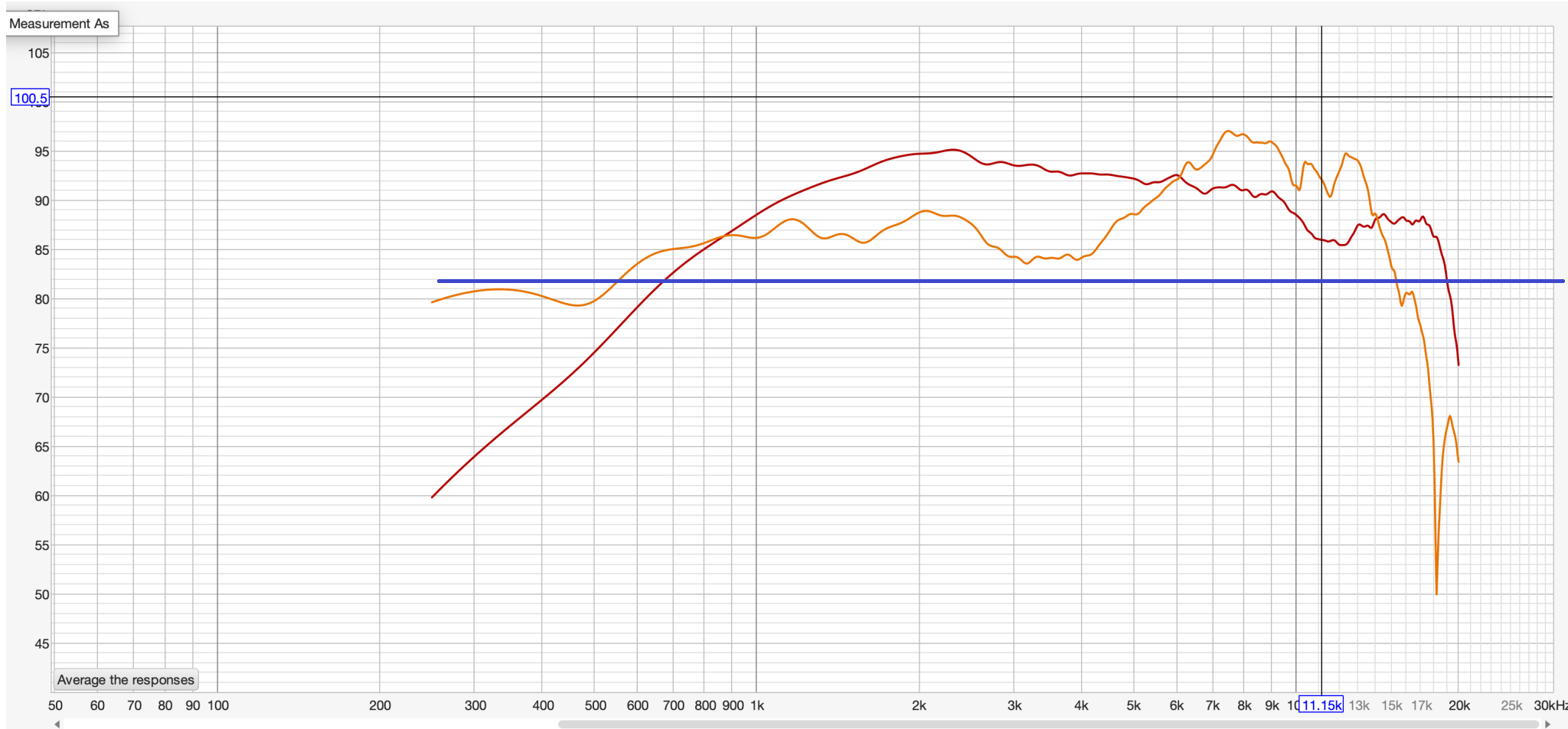

You aren't losing 10dB due to baffle loss. that's impossible. 4 pi (360 degree) to 2 pi (180 degree) radiation has a "Gain" of 6dB maximum. If you are going by the woofer's response in the 4KHz region, that's woofer breakup (not baffle step).
The midpoint (-3dB) frequency of your baffle step losses can be calculated via F3 = 115 / baffle width (in metres). Assuming your baffle is about 170mm wide, baffle step F3 ~ 676Hz.
Baffle step "Rise" (going up in frequency) is a gradual phenomenon. It's not just a single frequency thing.
Most speakers don't need a full 6dB of baffle step compensation. Often 3 - 4dB is enough. assuming you are using the 8 ohm version of the SB15NRX - which is 86.5dB sensitive after baffle step, you'll be targeting a system sensitivity ~ 82 - 83.5dB (allowing for 3 - 4.5 dB baffle step losses). So you on axis response should be around this.

Those driver responses look great. You are getting a 6 dB boost in the low end of the tweeter from the waveguide, just as expected and there is a 6 dB baffle step at around 600 Hz. All normal. Crossover at maybe 2000 Hz. You will want to compensate that low frequency rise of the tweeter. A series capacitor will do that, in addition to a 2nd order or 4th order crossover.
I am rather going by the peaks around 1k and 2k. After carefully inspecting the factory specs of the driver, I realised it loses almost 5 db from 1k down to 700hz. So I think it makes sense that the total loss between 1.1k and 500hz is almost 10db's.
If you only want to use your gated measurements for crossover design (and not do a quasi-anechoic " full range" measurement on the woofer), you'll want to target the blue line level as your system response:
Yes, both drivers are 8ohms. I am indeed targeting the blue line that you indicated, but in that case I am a little concerned about the loss of sensitivity as you mentioned. I am listening at moderate to soft levels, from a 3.5 meters of distance (12 feet), but my amp is a poor little Marantz from the 90s which can only deliver a modest 40watts per channel (at 8ohms). Even though I am planning to get something with more juice, I still want to be able to drive the speakers comfortably until I am able to make that purchase. Maybe I am worrying too much about it, but don't you think 82-83db sensitivity would be on the low side for such an amp?
Yes I am also happy with the reponses, especially when I compare them with the previous version's FR The best crossovers I could put together so far were around 2-2.3 kHz as you guessed. It's not the easiest thing to deal with a waveguide's response on top of such a huge woofer breakup, but I believe I am getting there slowly. I'll try the series capacitor too, thanks!

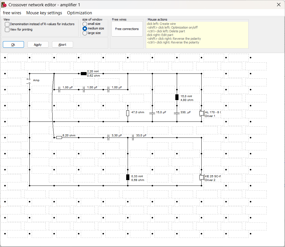

If you have time to put into it, have a look at Visaton Boxsim free software. The example design in that software uses drivers very similar to yours, including the waveguide. So that example crossover architecture may work well for you with value changes. The boxsim software has an automated optimizer that will change the component values to produce the optimal crossover performance for a given schematic. To use it with non Visaton drivers you just have to load either the TS parameters or load the .frd and .zma files into a project. Unfortunately those can't be saved into the driver library, so you just copy a project file to use them in a new design. It's one of the most complete freeware speaker design programs and well worth learning. https://www.visaton.de/en/literature-software/software I believe the added capacitor after the high pass filter, 33 uF in the schematic, is used to flatten the waveguide low frequency rise in response.
Just need frequency response files and impedance curves
to work something out. FRD / ZMA
Thanks for the recommendation, I'll try to find some time to have a look at it, I am not having much fun with Xsim to be honest...

Here is a crossover design I put together:
I am getting quite a null in reverse polarity (should it be better?)
The overall response looks kind of satisfying, but I am concerned about the woofer's persistent break up. I was able to knock it down with a 3rd order filter but then I had trouble getting the reverse null. Do you think it's fine if I leave it like this or is it going to be audible?
