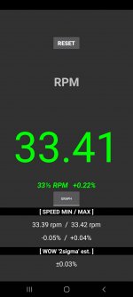

I've been measuring wow using my phone app (not the best option I know) at two different times of the day. One at 1:30pm. (Peak hour, dirty electricity) and 12:30am (cleaner power) over 2 or 3 days.
Pretty consistent results:
1:30pm
0.09% 0.10% 0.9% 0.09% 0.11% 0.10% 0.05% 0.07% 0.10% 0.10% 0.12% 0.10% 0.12% 0.08% 0.05% 0.09% 0.07% 0.10%
12:30am
0.04% 0.08% 0.06% 0.04% 0.08% 0.03% 0.05% 0.05% 0.09% 0.03% 0.07% 0.08% 0.08% 0.06% 0.04% 0.05% 0.03%
The table runs more stable at night. I wonder how much better measurements one could get with a Hanze power supply hmm..

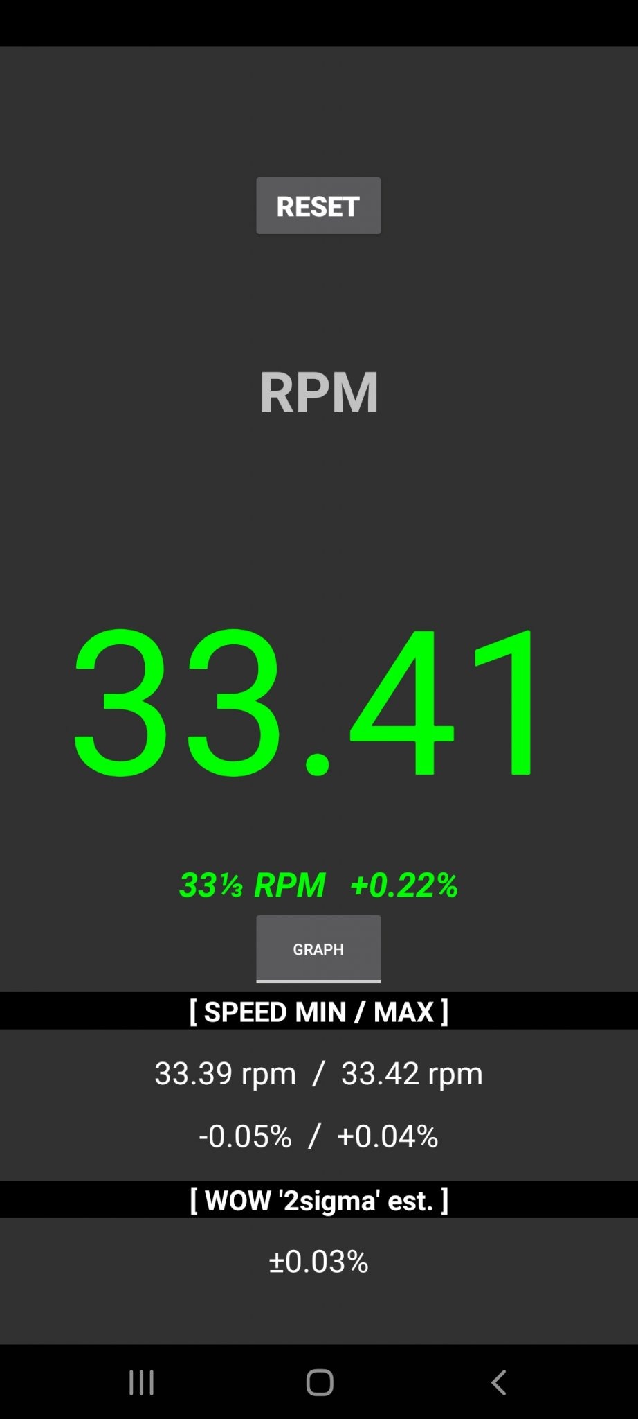

Anyway take a look at this picture.
I'm not sure how precise the gyroscope in my phone is but the Thorens seems to measure much better than the 400k OMA and the 500k TechDAS TT in terms of speed variation. Wow also in the same ballpark. You can see the graphs on the Stereophile reviews.
Am I missing something here?
(PS: I know this is one of the better measurements but i'm expecting this consistent kind of performance once I feed it with the proper undistorted AC)

Hi Bruno,
I would be interested to know how you use the gyroscope in your telephone.
sincerely,
Ralf

re: speed accuracy and consistency. To keep in mind is that we are dealing with a design that comes out of the 1950's. In Joachim Bung's book "Swiss Precision" 2nd ed. I found a page that explains a factory bulletin #212 published by Thorens in 1959. The in-house measurements reported a wow and flutter of 0.10% wow and 0.07% flutter per NARTB std 1.11. Per NARTB std. 1.12 rumble (unweighted) was reported at -38dB.
The idea I take from this is that we can do some things to enhance or improve the performance - yet - the hardware in that machine comes out of the 1950s. Personally I wouldn't be too concerned about obtaining an absolutely accurate 33-1/3rd rpm figure while using a cell-phone tachometer app that spins the phone on your platter. Better off just looking at the strobe, btw.
