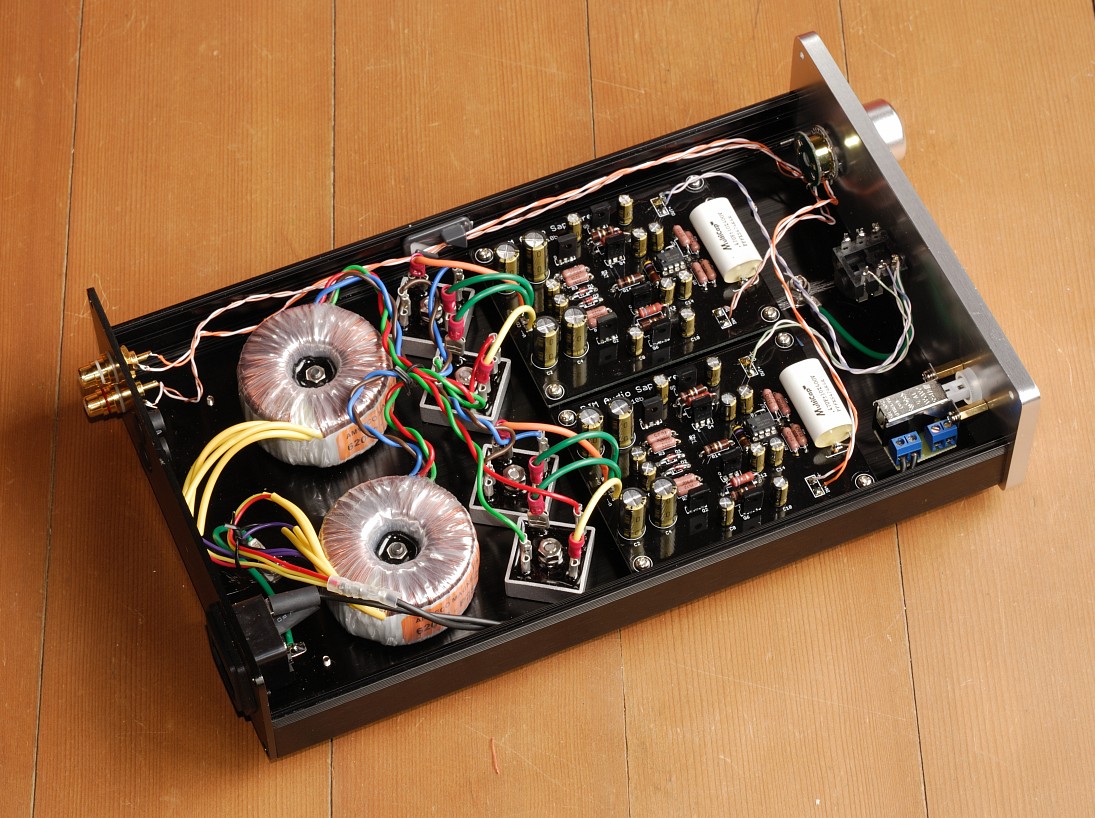

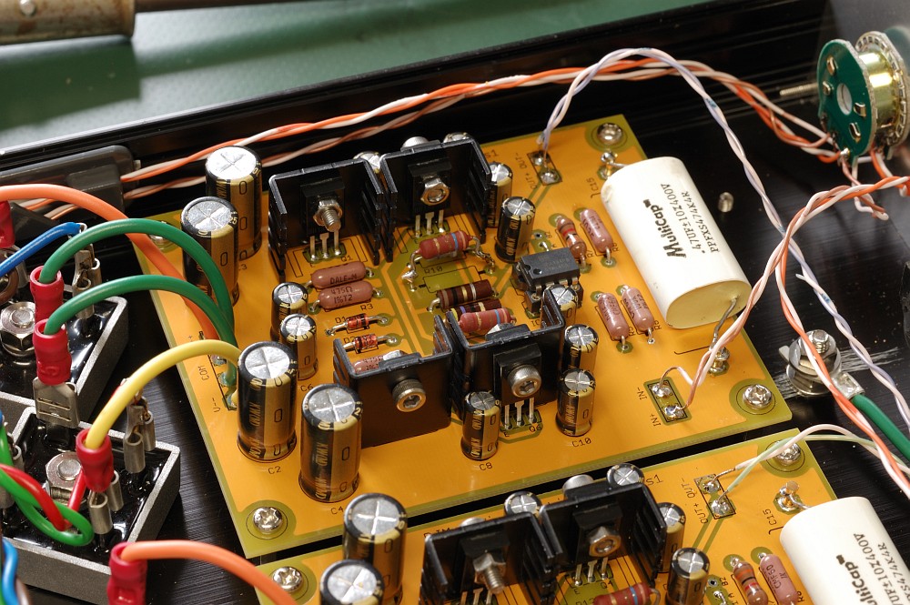

So, this afternoon I put my 14s1 Sapphire on the bench and gave it a thorough going over with the voltmeter. Before I post some photos and lose your attention for good, let me post some numbers and comments.
- with the rev 14 layout, putting the output and driver transistors on the same heatsink, I solved the "reverse thermal runaway" issue that, in the rev 10 prototype, caused a significant reduction in output bias. I'm getting within 10% of the worksheet values, that 10% difference is most likely because the calculation assumes the devices are at the same temperature when in reality the drivers are a little bit warmer as the thermal coupling is not 100%.
- every other test point is spot on.
- in my build I have R10,R11 = 360 R and R6 = 13k. All other values as per the BOM.
- Talema 62062 transformers, but I'm running on 100 VAC line (Japan) so the effective secondary rating is 10.7 V rather than 12 V.
(I adjusted my version of the worksheet to reflect those changes before comparing the measured and calculated values)
Unrectified DC is +/-15.7 V. Regulated voltage rails are +/-10.8 V.
Measured driver current is 28 mA [calc=measured]. Measured output bias is 19 mA [calc=measured*1.1]. With my HD600 headphones, 23 dB gain and 64 mW of class A output power (calculated).
-The only surprising thing, to me, is how hot things got. Total heat for the stereo amp is 5 W, 0.5-1 W per heatsink. Overall the whole case gets comfortably warm when left on for a while. The heatsinks with two transistors against them are just cool enough to be able rest your finger against. Probably about 55 degrees C, or 20 C degrees above ambient (it's still hot here). My conclusion is that I would not want to increase the bias currents much above what they already are without a complete rethink of the thermal design of the amp.
Final word: Sapphire rev 14 works as designed, and is pretty well optimized at the current circuit values.

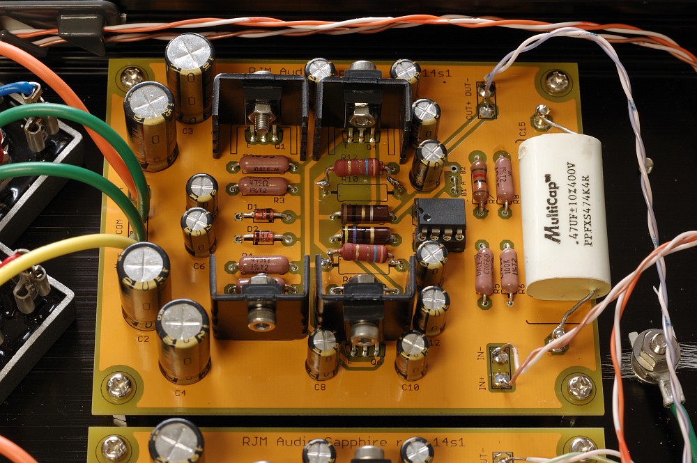

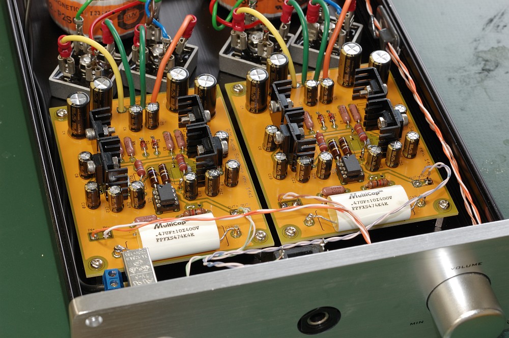

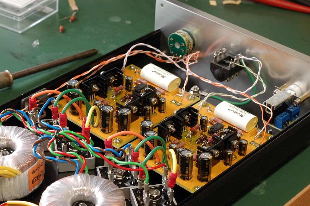

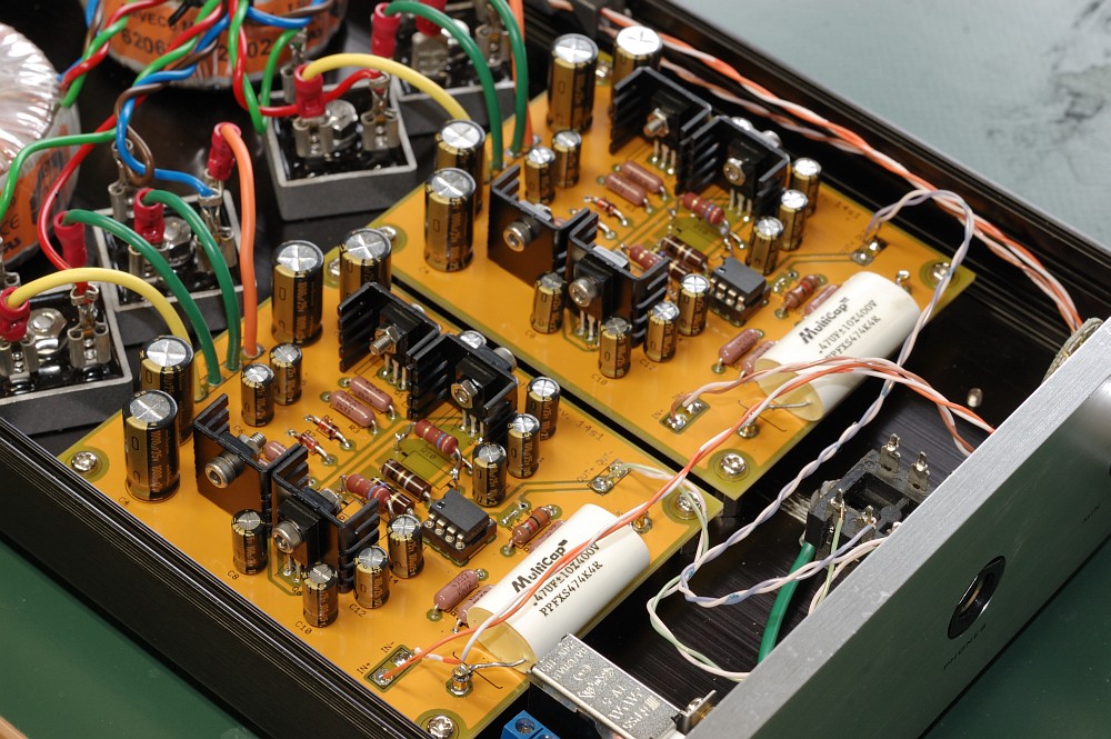

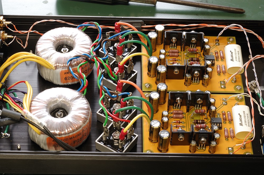

Sapphire Desktop Headphone Amplifier
(after fitting the new rev 14 boards)
- R6 is 13k tantalum, I grabbed them at hifi DIY store in Osaka.
- R10,R11 is the 360 ohm resistors from my proto built and were spliced in there after I mistakenly fitted 330k ohm resistors in there by mistake.
- The heatsinks are the wrong size, but they'll do until I get the new ones.
- The bridges, for the record, are 400V 50A each. :)
[Nikon D40, Ai micro-Nikkor 55mm F3.5]
