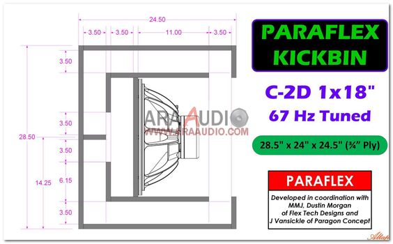

But the game isn’t over. Paraflex Aint gonna get nowhere soon without competition… there’s only one thing that beats a paraflex . And that’s a proper ROAR.
Walking a fine line but stirring the pot nevertheless. I got them both and I got to say ROAR has gott an Ace up its sleeve. It is naughty but nice. Paraflex is helter-skelter its spot (or can be) on Very little margin for error before it quickly dropping off a cliff of destructive interference or ring a ding ding ding all over (exaggerated somewhat but based on real world experience and the not so lovely sound of it or the room nodes stirred up with it . Sonic casserole of tambourines and annoyances often full of gaps and nonsense..
Nobody considered the driver offset as an asset in all those and compliment to the folding . -nor was it necessarily convenient for the needs of the design or able to see it in a simulation to - nevertheless that’s where it’s hiding a glorious secret in the never ending alignment of waveforms and super position within the design. these things are monsters, and between you and the circle O man they can come full circle no pun intended 😝 !! look at the parallax angle of the speed of light in radians versus degrees and as circumference of a circle as a distance and apply to the closure (from closed ends and spacing ) look at offset driver positions. That’s where TL forgot to look, they just guessed at an odd Harmonic and left it as such since that that was only the beginning and there’s two sides to play with. Synchronicity is real even when it’s polarized.

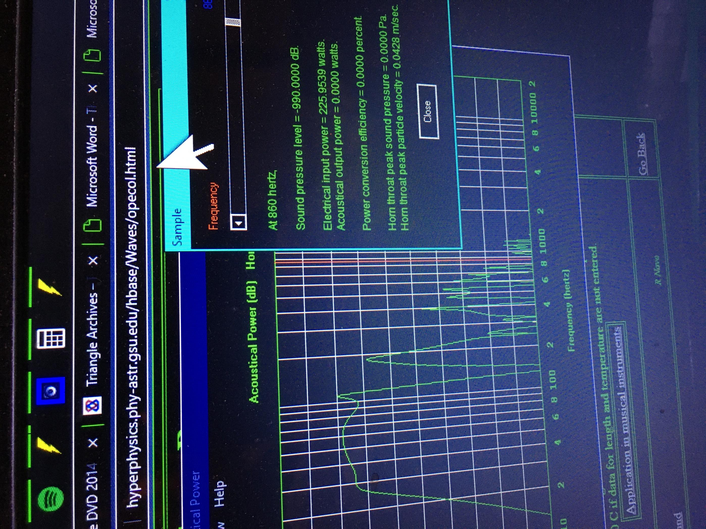

There’s a perfect pattern in the 8th order of qw functions in physics (dimensions of a sphere surrounded by Spheres that share all sides as a ‘kissing point’ that are the same sizes (perfect ) . It’s 860 over and over and over and over forever. Just like the sun is it’s also then seen at Saturn as the logarithmic scale on 860 forever to the end of the universe just like this

(Add this to that ^^^ and take it in slowly Or else it just creates headaches or stomach cramps trying to ;( laugh out loud) actually a function of Distance over time in the way that those are both interconnected and can be seen in gigantic amount in space or astronomy as red shift or the ability to age or distant stars from incredible amounts of time and space distance away in the same way that function is occurring and available to observe in all of the subwoofers types especially specific fourth order and then also Roar and Paraflex which expose it quite nicely when used appropriately and accurately.
You have not milked the turnup completely therefore you are missing a detail that is incredibly important in everything and once exposed it really really shines as it should have long long long ago because it was obviously discovered in a long long time ago and used for whatever reason by the Egyptians and left for us inside the pyramid to decipher in math by the dimensions of a room in there called the kings chamber that chamber contains all of the roots so to speak of parts of a circle that then represented in a rectangleOr cube in 3-D versus 4,5,6,8 d and trans into the circle as then spheres in multiples on top of one of them.
This has nothing to do with anything except the sun and light and sound on earth. What you utilize that and then of course incorporate your CSA and your details to which you must satisfy that driver with its needs and VAS and QES etc. you have created a system that if all of these things exist and folding included presents the same intervals and not at random or bogus shortcuts there is a simple answer to all of us at the end it’s dividing 360 into 12 or 24 parts but it gets incredibly confusing when you go to explain how they all come together and work but there’s a short list of things that are easy to see very hard to grasp because you can’t grasp spiral trigonometry in multiple dimensions and chopped the hurdles from light to sound that easily obviously including time domain and intergalactic quantities of parsecs as how they relate to the second on earth. But if we skip all of that and go straight to the meat and potatoes we find 86400 seconds on earth in 360° of spin is a day which is 24 hours and +43200 seconds is 12 hours but only exactly that twice a year on two days otherwise that drift to a longest day and shortest day which themselves have exact amount of seconds in them.
All of that information in the details of itCreate the absolute perfect roar or the most perfect possible Paraflex meanwhile they have the same affect on a plain old transmission line versus an offset driver transmission line which also incorporates the same exact thing in its own way which is nothing but the 0 to 300 in 360° which exposes the 365.238 in 360° which in Paraflex creates the absolute requirement of a 13th part on the 12 that it is segregated into if breaking it down into 30 cm in 360. There’s two sides fed into one making 3 abd 9. If you do that with the correct CSA for the correct driver and the correct conditions you get A CSA change they can only occur in one place and that’s at 180 otherwise from 0 to 180 and 360 all the way back to zero you must have the same or a double or or a ratio that allows those two to coexist only split at 180. Therefore when you get off the exit which will be the 13th part or L4 five in response will show you at 860 hurts and 8600 hurts and 18920 Hertz, Something that only that can because that represents something more important than anything at the end of the day as it does in the details of this and what you get is exactly the same precision or exact us in alignment that created the same thing in the mass of the planets in the solar system is done with the same exact application in math.
It might sound confusing it might not make sense that’s because nobody’s looking instead they just searching for an answer that is a quick buck or creates this certain type of condition that only a small box is needed for? Well too bad because all those conditions and restrictions and compromises are only a little bit away from a really really great thing and that thing is a mathematical absolute created by the parallax angle of the speed of light or an arc seconds of the speed of light as a radian is to 360° Can you see those numbers and what 240° represents is also the part of the volume of a sphere equation which only the radius than changes cubed.And that’s the eighth out of 12 numbers that make up 360 the ninth would be the exit on a pair of flex which is 1 1/2 of the 30° were both drivers are entering from either end zero and 360 and if you look 30° from 240 is 270. And 30° the other direction is to 210. 210 is 3.6666. Just like 180 is 3.1428571428… And 360 is 6.2857142857… Those numbers and 30 which is 3.6 6666666÷7 and number one of the 12 parts of the circle is put into pi pieces expose 24 pie pieces which is 2619 and then 15° and also the golden ratio was 1000 or 1/10 or one part missing. Oddly enough someone’s in there you find 36528095238 is a year currently on earth but it has not always been that way and all of this represents in a much grander scheme and broader look at it out of band with and far far above and far far below those numbers and frequencies you will see the numbers create the expansion rate of our universe and deeper into that you will find numbers that represent 186,000 as the speed of light even though that’s the same thing as 299792458 in kilometers versus miles those numbers will converge in the opposite direction as does the golden ratio when starting at one and moving upward in the Fibonacci sequence. Those numbers are weird those numbers are goofy and they’re all over the place they don’t even make sense half the time and it’s awkward but if you dissect that to the microcosm or take it to the macrocosm version of them they are crystal clear evidence that those numbers are within and describing the pattern even if not quite exactly what it’s really really taking place in physics at the highest level meaning smallest molecular one neutron in Dead center of the sun to one helium in the dead center of the sun as fusion begins 1 to 4 so does quarter wave as a function of physics which will not reach the surface of the sun for some 20,000 years possibly however the moment it leaves the service of the sun for some reason and in someway it is instantly and only 500 seconds or five or 50 depending on what way you wanna look at it arrives at your face as warm but nothing ever moved nothing ever happened until of course it was in our atmosphere where the shake rattle and roll of air particles began amongst other things. And all the sound boom is is the release of oxygen photons from the dropping of its electrons back into their spot as valence orbits that makes thunder. This is all intertwined into what we can see in a quarter by piper distance and set it up that way and in a roar or a pear flex it’s a compounded version or a similar device which in a offset driver entry quarter weigh pipe exposes add an exact number feeling of the void of the three times the 1/4 waves function of the main waves numerical collision of 360 or 270/90 that we’re working with at called phase. 1440° is for spoons of 4 90° parts and what have you? 176÷7. Which exposes the first of many errors it’s subsequently in circle math which are not errors they are points to note things occur in an expanding sphere. 176 versus 175÷7 is 25 versus 0.142857… If you use these numbers in the right way they explain everything they don’t just look awkward or look like a pie that’s not supposed to be the right pi, because the difference between the 22÷7 pie and the pie as in zero3.141592… Also represents something very important if you look closely and dive even deeper you’ll see that represents a number which looks like 1/8+ a little extra as well and well that might mean nothing it certainly is peculiar and if you wanna take a stab at that one there is an endpoint that makes sense in any of these numbers will you keep chopping them up in quarters or take 1/7 and multiply it times 7×7×7×7 and the next shortcut to the big bang number is the fact that if you do that 11 times what number do you arrive at? And what number does it take to be makes 0÷7 not zero? Or negative number that’s relevant those steps 1-7 In one sevenths express numbers that then expose the parts of pie as 1122 3344 and so on but Within that is the transfer of numbers 2° on a circle where you will then see the number of spins exposes another cycle on top of the cycle in the numbers game that plays out further and further 25 5075 100, 400-1600?? 1609.142857 is that number now there’s a correction for that many spins from that 1600 in the much much bigger math of super circles and circles in the same way that the procession of the equinox of our own planet is 25920 and it’s quarter weigh function is 6480 just like a season is to a year neither of which are based on 360 if you are going to get the correct number for that and you can see in science and Astronomie they have now shown that the procession of the equinox is not too 25920 it is slowing down and all of that is represented in these quarterly pipes already these numbers already do this if we look and see and tune around 30 cm in 360 and split that up with a 30 cm offset driver entry in Paraflex or Roar to the part of the next remaining piece that you’re going to applyBe at the other side the driver in a compound entry or the other side of a driver in a series entry the back wall for pressure face as opposed to the other direction towards the exit or towards the next driver which would be the exit in the CSA change represents something that in math and physics and everything is in all of this exact same way it spells it out when you see this when you look at 860 or 8600 or 18,920 Hz and everything in between at that interval of 860 when and if those all lineup you have done the appropriate math and C essay to find the answer to whatever that is? I don’t know but you got admit it sure looks kind of nice on the rescreen as a response doesn’t it and it sure looks like something simple to build if you ignore the turns as some kind of advance centerline method with the paved instead you use the parallel walls as your distances and forget the final tuning as it’s somehow not as important as reality is in between what you do is what you get and what you want to be looking at if you’re really ever going to get something worth something?
75 is 7.5° 150 is 15° 300 is 30° and in a circle and in sound or whatever you Gotta do to make a subwoofer suddenly got really really really matters that’s 30° just keep poking out and never ever fails to deliver the most beautiful response if used appropriately and expanded at the right place at the right time appropriately no flares no nothing until after The fact and that would be an established cycle of a quarter wave already so the system has like a fundamental reference of which to build from because the roar can clearly so can the Paraflex be flared after that convergence occurs but anything before is just a disaster as it is and would be in building up a proper harmonic set for a quarter wave function which is more important than any of this nonsense or horns or bottlenecked bass reflex whatever that’s fineBut it’s a shortcut and it is preventing anyone from seeing anything that may well be better than all of it and always has been in physics and math medical reference what is there to see in there to use it and I can’t stop doing it that’s all I do is never even tried to put Perflex in raw into my mid range and by way of matching the subwoofer below it by the same ratio as the frequencies to which they play but centimeters of each of those 12 parts is reduced proportionately back not unlike the 1.5 or 3 is to octave that then is now a steppingstone from 32 Hz in 30 cm parts and it’s not;(It’s not necessarily exactly 32 Hz mind you there is a window of opportunity to keep That 860 relationship in check but when you are and then you build backwards off of that whatever you’re doing is working out perfectly in the frequencies above because that’s what you’re looking at and then below it would seem the infrasonic version can step in at 16 hurts her so another threshold piece of whatever reason in making sound as you can clearly see making 16 hurts with a street corner a pipe is all but impossible if not sitting right on some type of border that only can be best and buy a reduction in CSA or a cheat? Clearly a mass loading or a bass reflex type action, which you can only get away with a little bit and then one way that racial is expressed in the Perflex or the roar somewhat if a person chooses to put the required two or four drivers into the system in order to create that obvious situation and driver offset needed in all of this and also oddly enough a most wonderful week and awesome balance if horizontally opposed to the system as well and in general you’re creating a monster of perfection in reflection that is a sonic erectionPossibly the most excellent thing there is and in very well be may be its connection to the math and physics of the sun and light and numbers and time to time he’s in all of this once you really take a look beyond the little speaker making microcosm that forces us to miss out on the big picture of that creates this??

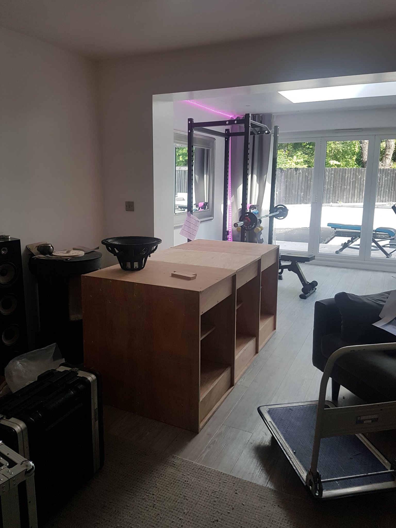

I built a prototype and I have to say its very impressive. I'm using a Faital Pro 15HP1060 Driver.
Firstly, Its a pretty big unit. I made this out of hardwood faced poplar core ply. After using a website to auto generate a cutting sheet on 8x4 it is indeed the best part of 2 sheets with just under 20% wastage. I calculated the cab weight to be about 48 kilos unloaded (versus 58 in birch ply) and it actually came in at 48.8.kgs
The poplar ply. This came from Jewsons. I opened a cash account before purchasing and they gave me a decent discount so each sheet was about 50 quid including VAT. bargain. However, the quality is not that great. There are some voids, bits where the layers are not glued well, and once it was cut some panels were a bit warped and took some brute force using various clamps to get them straight during assembly. I really could have done without that and it was super annoying and put me off using it again. I'm not sure another 10kgs of weight using birch would make much difference to how easy it is to move about. Birch is by far superior quality ply but I cant seem to find anywhere selling it that isnt ridiculous money. I might be stuck with the poplar ply for now.
The sound, well. its loud and very very punchy. I added an EQ of -5db at 90hz (Q 3) which gave what I thought was a better balance between the mid punch / and the low end, otherwise the mid punch was just a little over powering (personal taste, perhaps). Crossover at 110hz 24db. Then, I A/B compared it with my existing subs (same driver, much smaller cabinet) using various tracks, mostly techno. I don't think the low bass tone is quite as pure / deep sounding as my existing subs but Im not sure this would matter at war levels. To get my existing sub to match the output of the roar I had to push the gain up about 4, 5 db and even then it didnt provide the same chesty punch. There didnt seem to be any power compression when cranking it right up as far as I could tell, even producing a 40hz ish bass note the thing just seemed to get louder as the gain was pushed up to the limiter on the amplifier.
Overall I'm really happy with it. Whilst they are big and a 2 man job to move around the output from this unit is just the job and entirely worth it. Just got to to get another 3 made ready for an outdoor event next Saturday.
