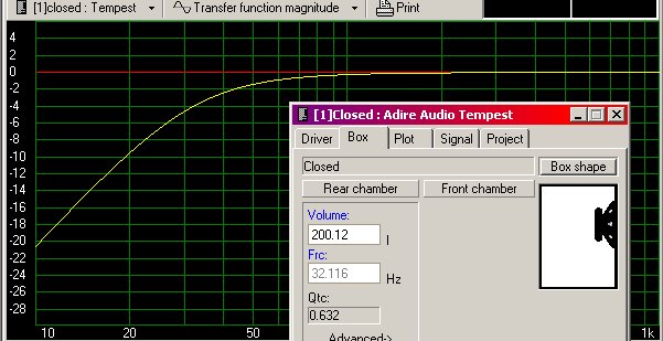

I've read of some people claiming that as there are losses due to air leaks, non solid walls etc, as JohninCR stated, that an ebs type ported sub is a much better match for real world flat response. Indeed if I was to ebs my tempests I probably wouldn't need to eq them (for boost at least - only to flatten)

With the ~recent availability of ~inexpensive, space efficient, low Fs, high Xmax drivers and ~inexpensive amps/EQ, a number of small sealed cabs EQ'd flat makes much more sense to me than one or two expensive/super high Xmax drivers driven with amps whose wattage rating rivals a small town's power station, or a fixed multiple driver IB unless you have a suitable large space to install it and SAF issues that dictate a hidden sub system.

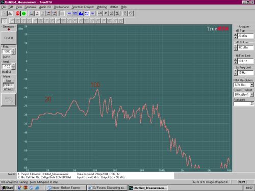

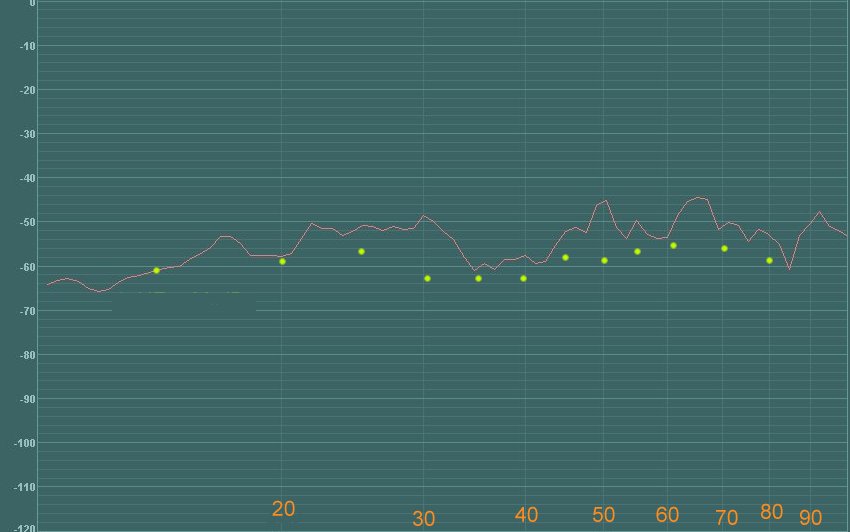

Do you feel that RTA'd pink noise is the best measurement technique for the bottom octave? I've never been able to match 1/30 octave warbles to 1/30 octave pink noise RTA, and haven't any idea which is more accurate.
Ordered the stryke test cd just after I replied to this. Just arrived.
Pink noise versus warble tones/spl meter readings.
Not bad - the curve does follow. Ignore that the pink noise is above the spl plots. Just used the 15Hz reading as a 'zero' for both. Should have used 60 / 70 Hz really. Only 30 Hz is way out...
Cheers.
Rob
