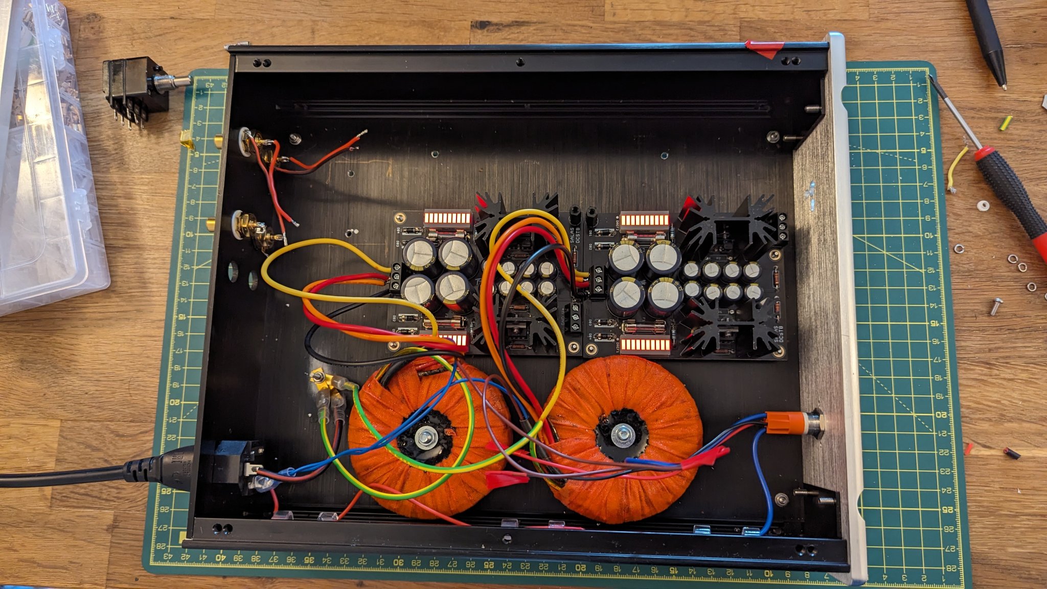

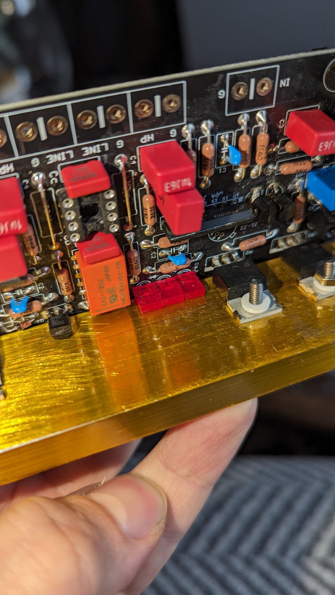

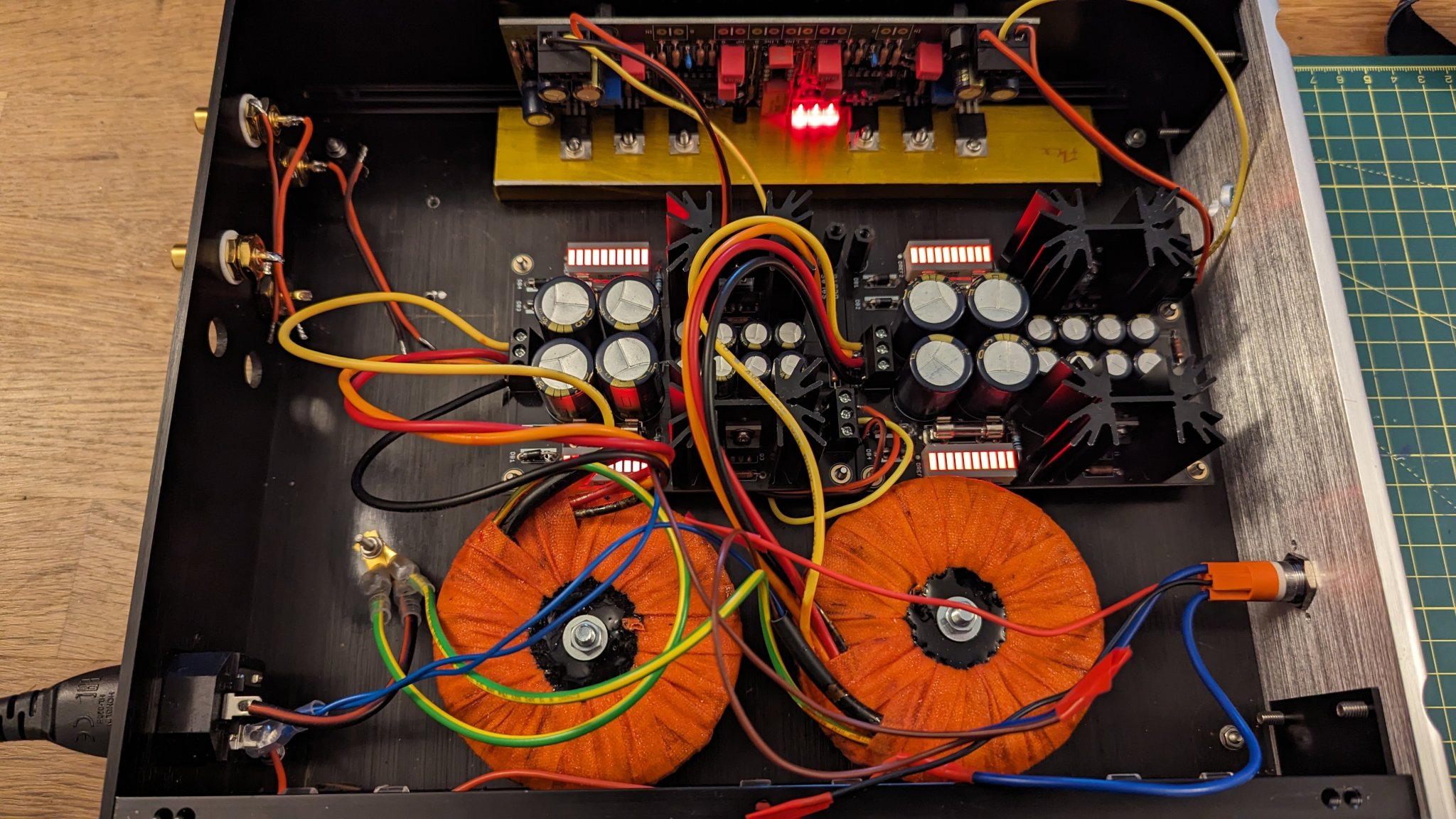

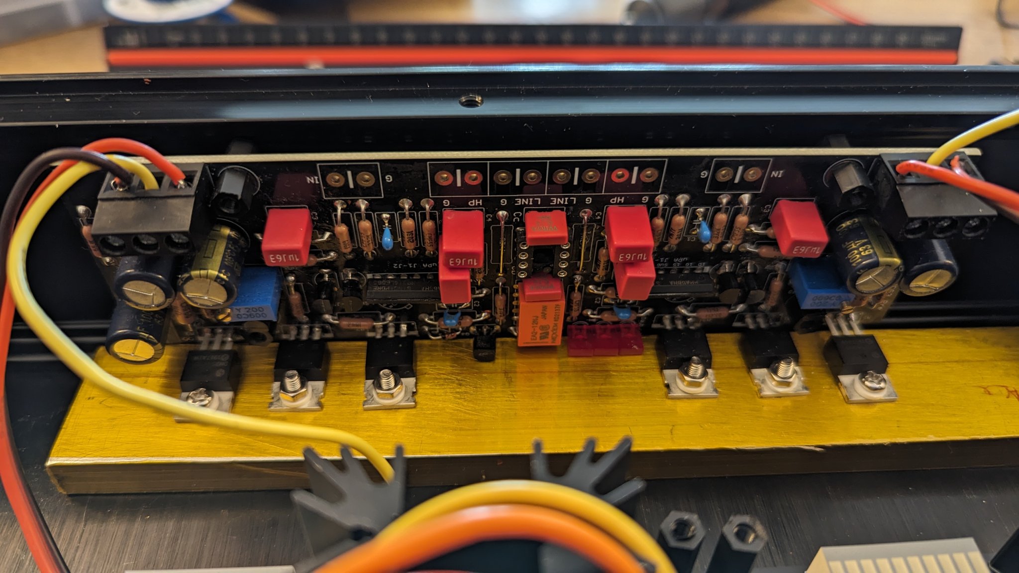

Proof :D
Reactions: 1 users
diyAudio Chief Moderator
Joined 2002
Remove them carefully and reverse them. Don't dwell long with the iron. Help rework with solder wick if you got, they are sensitive. Unless you got some spares. While you are at it inspect both sides for dirt, flux crud, solder bridges, missed joints, dull joints, suspect strength joints, weak pins etc. Canned air, brushes, Kimwipes, Isopropyl Alcohol (IPA) are your friends.
